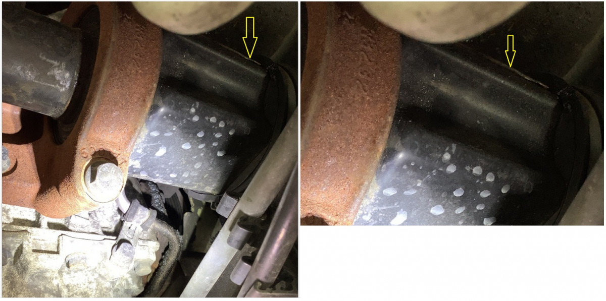

This week, routine annual inspection at local shop (for DMV purposes) showed grease leak and the photo sent to me showed this.
Minor grease leak I can fix by tightening the Oetiker a bit further when I visit my kid but the photo seems to show
a longitudinal crack (YELLOW arrow)..
Questions for the axle gurus:
1. Is this visual illusion or real?
Sorry I don't have a better photo.
2. Does anyone have a pass side axle and look for me the factory casting (this is factory Volvo axle)?
3. Has anyone ever seen a longitudinal crack like this?
Thanks!

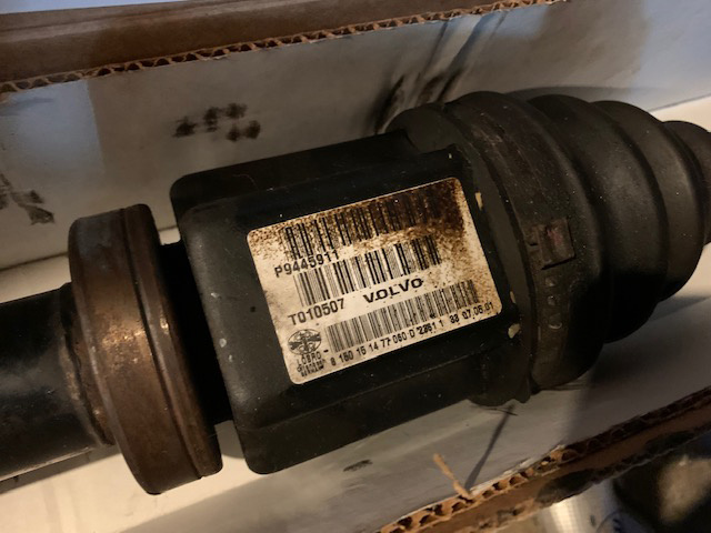

Clean cast with no visible surface issue.cn90 wrote: 12 Jul 2021, 14:58 Questions for the axle gurus:

If the CV joint housing has a crack you will have grease everywhere

I will have my kid take the car to a Volvo indy shop for inspection soon and keep you guys updated.
However, looking at photo provided by xHeart above and compared against my original photo above, it looks
like the YELLOW arrow is the side view of the factory sticker (that says "Volvo") gently lifting off.
Just a guess.
I will know later bc I have never seen a cracked casing in the tripod area.
Just a guess.

It's likely a scratch, not crack.
Also CV boots on later GKN axles were found to have some sort of a breather built-in, or rather a compensation for volume expansion.
What I found to work best for me on older boot is to collapse it lightly before tightening the clamp, i.e. it has some vacuum in cold state. Grease/air heat up quickly inside the boot and expands to a near zero pressure. Don't see any grease after last repack ~1.5 years ago.

Update,
Finally have time to visit my kid in college.
As it turned out, the photo showed the GKN label slightly lifting off a bit, giving the impression that something is wrong,
but nothing is wrong.
The tiny amount of grease that flew off, no issue.
Maybe I overfilled the inner boot with grease when I rebooted it and a bit of grease leaked out.
I checked the inner Oetiker clamp: it is nice and tight.
I wiped off the tiny bit of grease the flew off.
Will observe it but do NOT expect any issues...
Anyway, all is good now, thanks all for your thoughts...

- Posts: 36145
If that housing cracked , it transmits all of the engine torque , so it would fail spectacularly.
Glad it was just the label.
