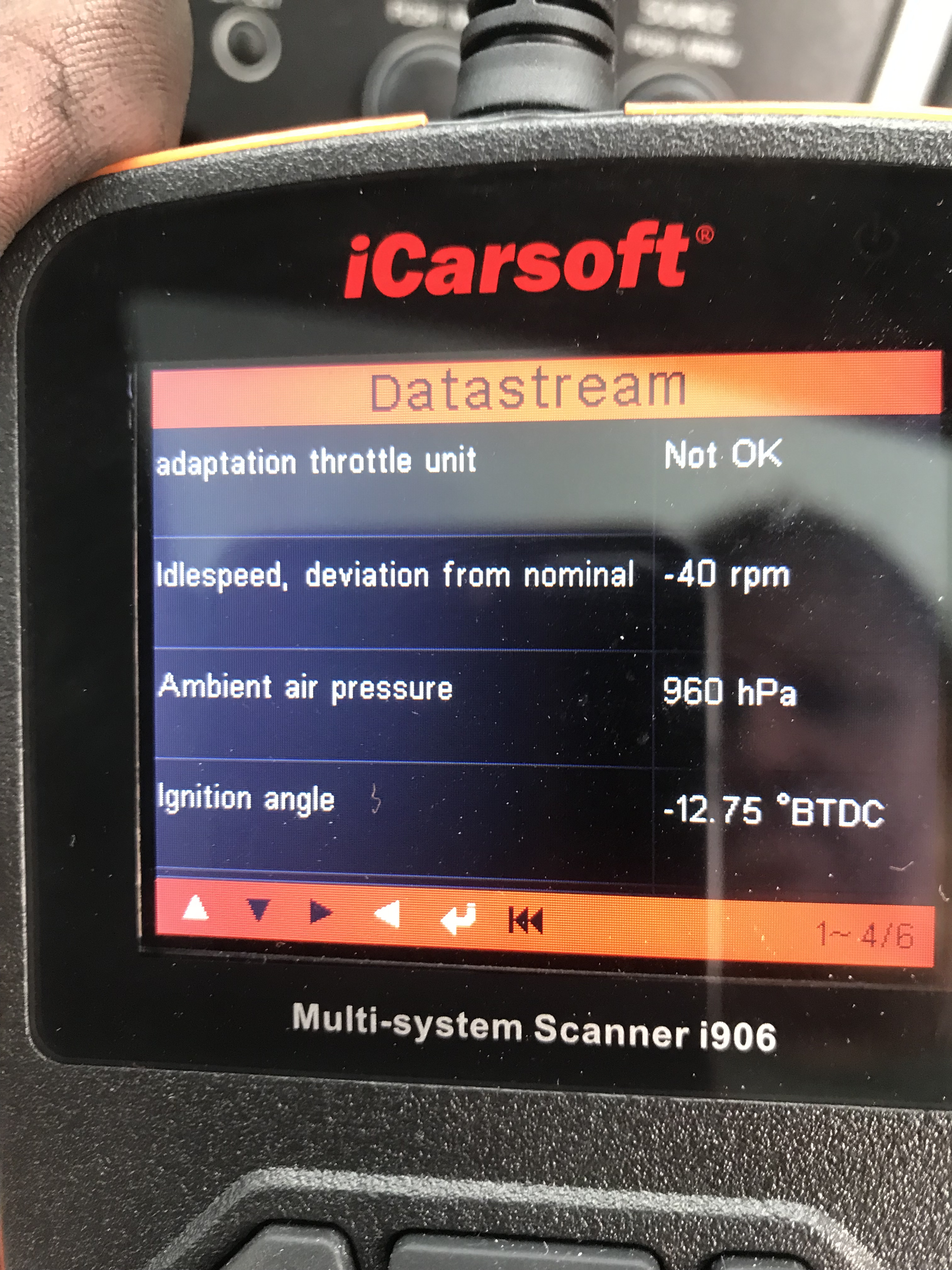

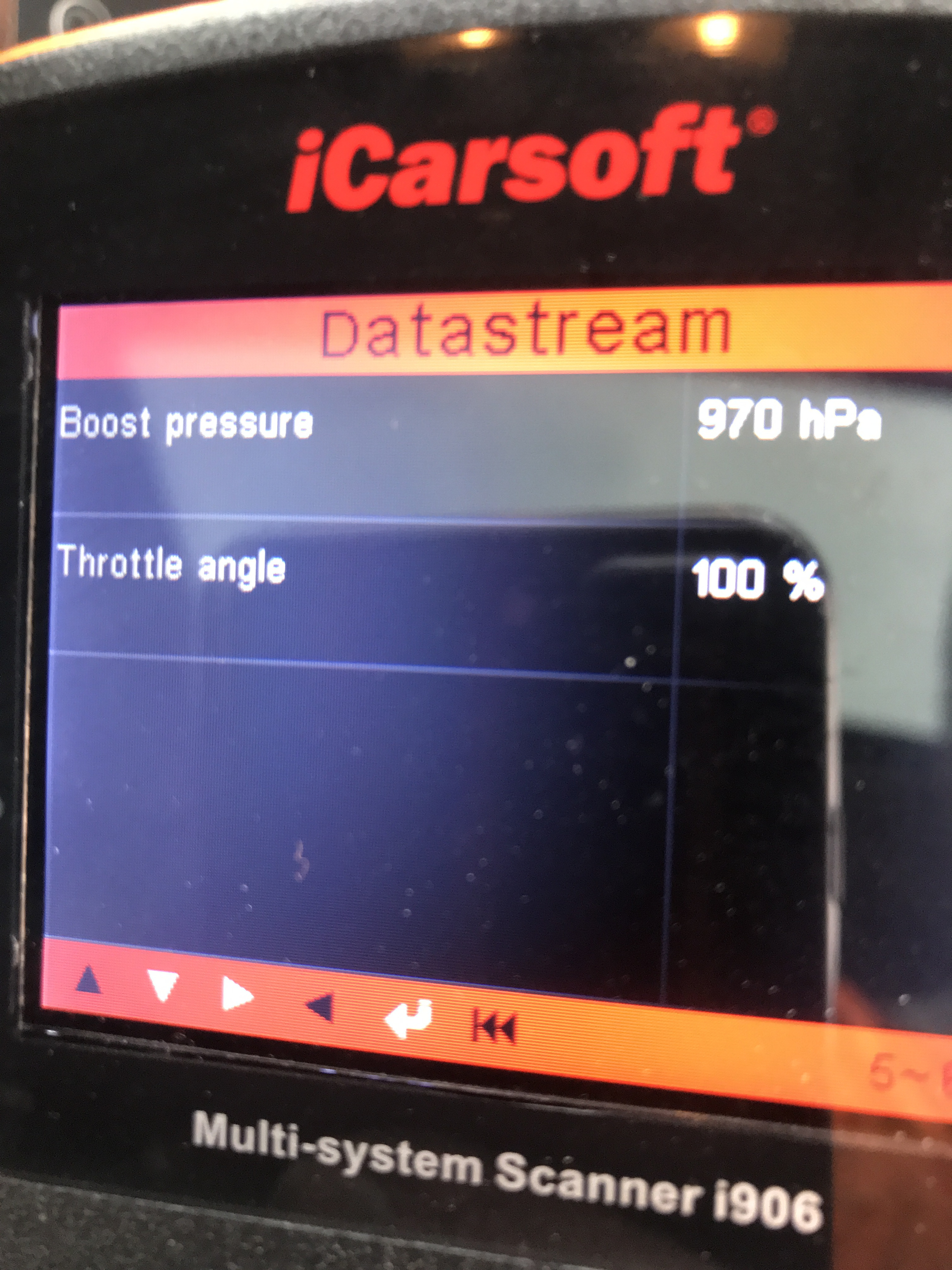

Hello , so I replaced the PCV system today. Started the car and it runs, but with idle pulsing 1000-1100. Sorry if this exist already I’ve been searching all day and can’t find any new material plus I’m freaking out and don’t know if I can freak back in…
Ecm 9200 TP sensor faulty signal
Ecm 921c Throttle unit potentiometer 1 signal too high
ECM 922C throttle unit potentiometer 2 signal too high
ECM 92CC throttle unit signal too high
Fault codes all point to TB with codes
as above - suspiciously all signal to high.
Would not disconnecting the battery whilst disconnecting/reconnecting the ETM mean I have to ‘adapt the TB’ thru Vida(which I don’t have).
When I unplug the TB same codes with the addition of ECM-922D potentiometer 2 signal too low.
I cleaned the throttle body when it was out - did I kill it ?

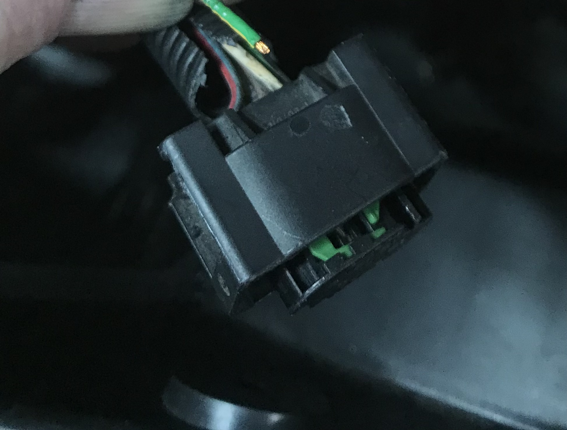

First time I did the PCV service on my 2002 V70, I had almost identical symptoms. Turns out I was a fit ham fisted when I reinstalled the cleaned out TCM. I had bent a pin and the throttle module was not communicating properly. I thought I was really s####ed but after straightening the pins all was fine.
I guess it is unlikely that you are as clumsy, but perhaps worth a look.

Gold star on ljsommar1’s fridge - wire had broken inside etm plug - found doing continuity tests from ecm to etm plug.
