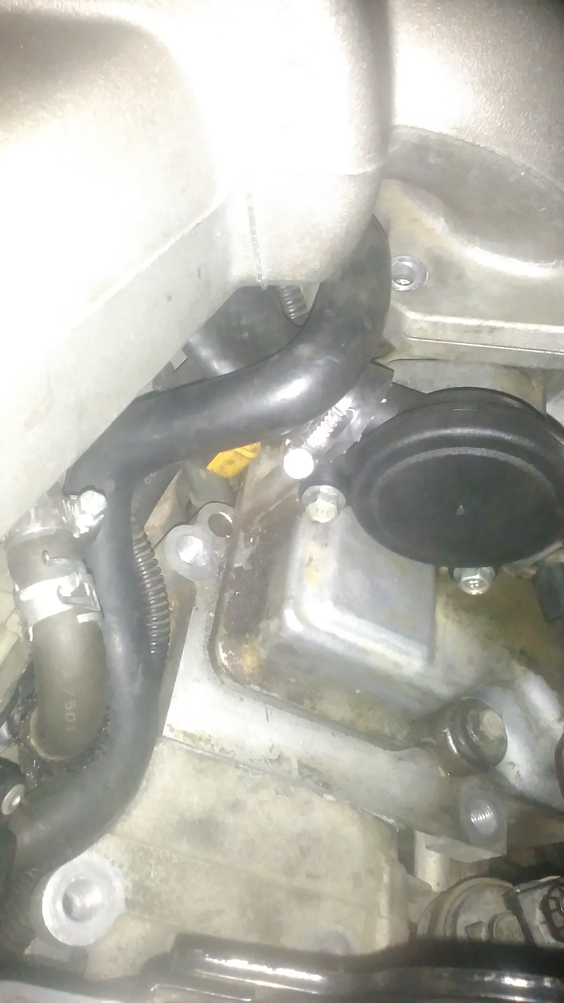

Still don't know why the PCV hose is sucking flat,
Perhaps it's not the genuine hose,
But everything else seems to be.
It does pull crazy vacuum which does seem odd.
Wondered if perhaps the stock piece has a restrictor or something in it,
Have never seen such a large, approx 1 inch PCV hose before,
On any other vehicle.
It's the hose that goes to the manifold by the looks of it,
That is sucking flat.

Photos would help folks help you identify that "flat" hose as well as the source of the leaks. PS pump probably needs replaced (FCP appears to be selling an o-ring kit to repair a leaking pump, have not seen feedback on that yet).

Post by ozxc90v8 »
It's the hose that goes from the PCV to manifold,
By the looks of it.
A bit hard to see there,
but can sort of see it's sucked flat in the pic.
