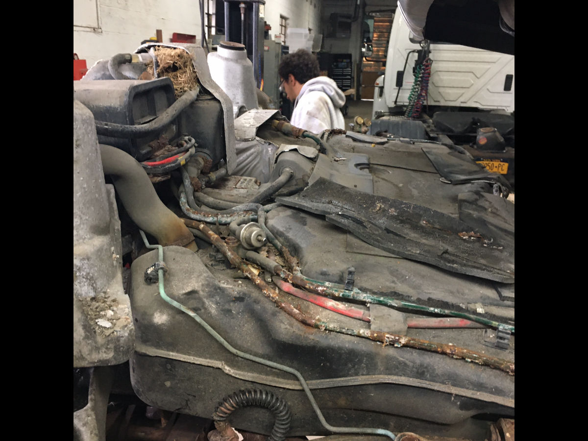

That is very useful. I will be pissed if it is anywhere at the rear as little of the evap system is accessible without dropping the whole rear subframe..................Been there and done that. Never want to do that again!

Well it came back again. Why am I not surprised with this PITA car??
I'm thinking the smoke test is the way to go. Hoping it is not a mouse been eating the new hoses installed when the subframe was out 4 years ago or so as some have now gone extinct. That and to replace any requires dropping the rear sub-frame/fuel tank again.
On AWD cars, has anyone found a common place for the hoses to fail for minor leaks? I guess I will start at the front where the small plastic hose starts at a valve on the radiator/slam panel and work back from there.
