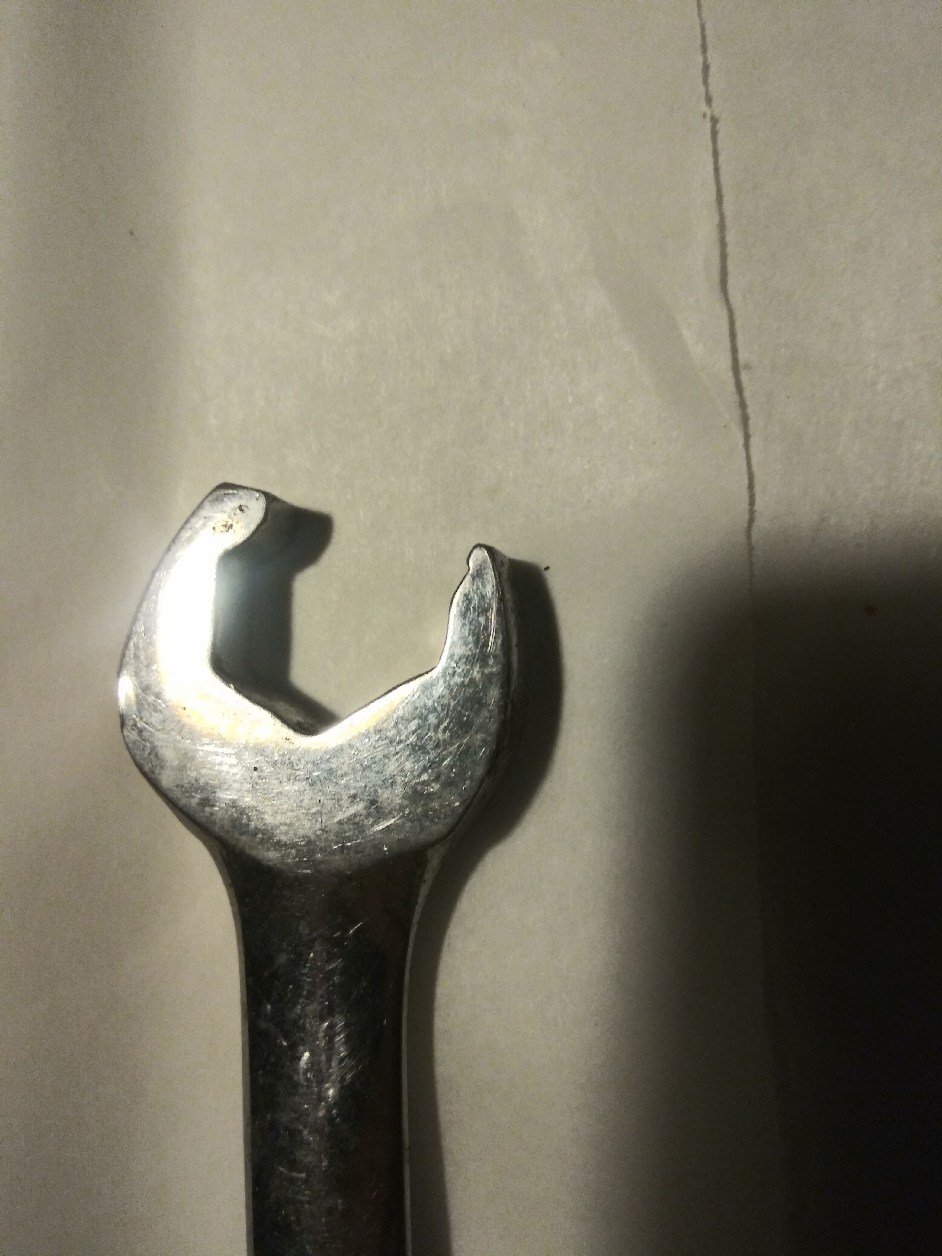

It is the one thing I have wanted to do but have NEVER yet been able to successfully do on a V70: replace the brake hoses. Today again I gave it a shot, but those lines will not budge, bracket-side. I can get them out of the caliper side, no problem.
I did not go so far as to round the nuts off today as I have done in the past. The flare wrench, though (I have tried yet another brand) is once again stretched out. Have been putting penetrant on them for a week in advance. No dice. Those damnable flare nuts on the brackets do . not . move.

I have successfully replaced brake hoses on my 2001 V70 at about 190K miles. Mine did not have excessive corrosion on the parts. I used SK flare wrenches. They are thick and rigid. As I recall, one end of the connection is effectively locked from rotation by the bracket (the steel tube end I think). On these connections, I like to fit the wrenches with about 30 degrees between the two wrenches so I can squeeze the wrenches together to loosen and not have to apply counter torque to hold.
I see no danger to using a moderate amount of heat as long as you flush the brake fluid afterwards. Do not burn through the hose and start a fire.

You can try heat treating the flare wrenches, harden then temper to reduce brittleness....see youtube.
But I think the problem is lack of mass.
I have some flare wrenches that cannot open up, they only grab the nut on one side and pull it around.
I've never had these not work unless the line binds up and twists but the nut still unthreads.
I've asked on tool forums what they're called and they just say flare wrench, but they're obviously different from the typical design.
Never been able to source them.
