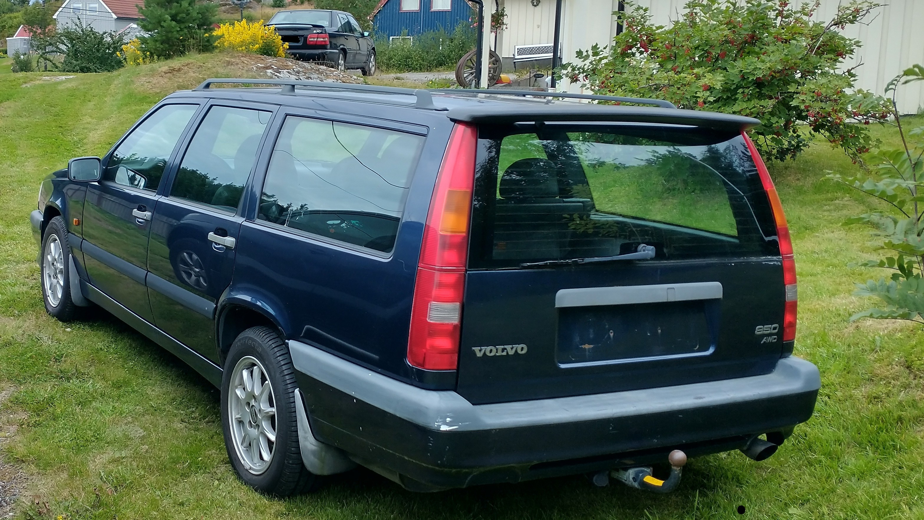

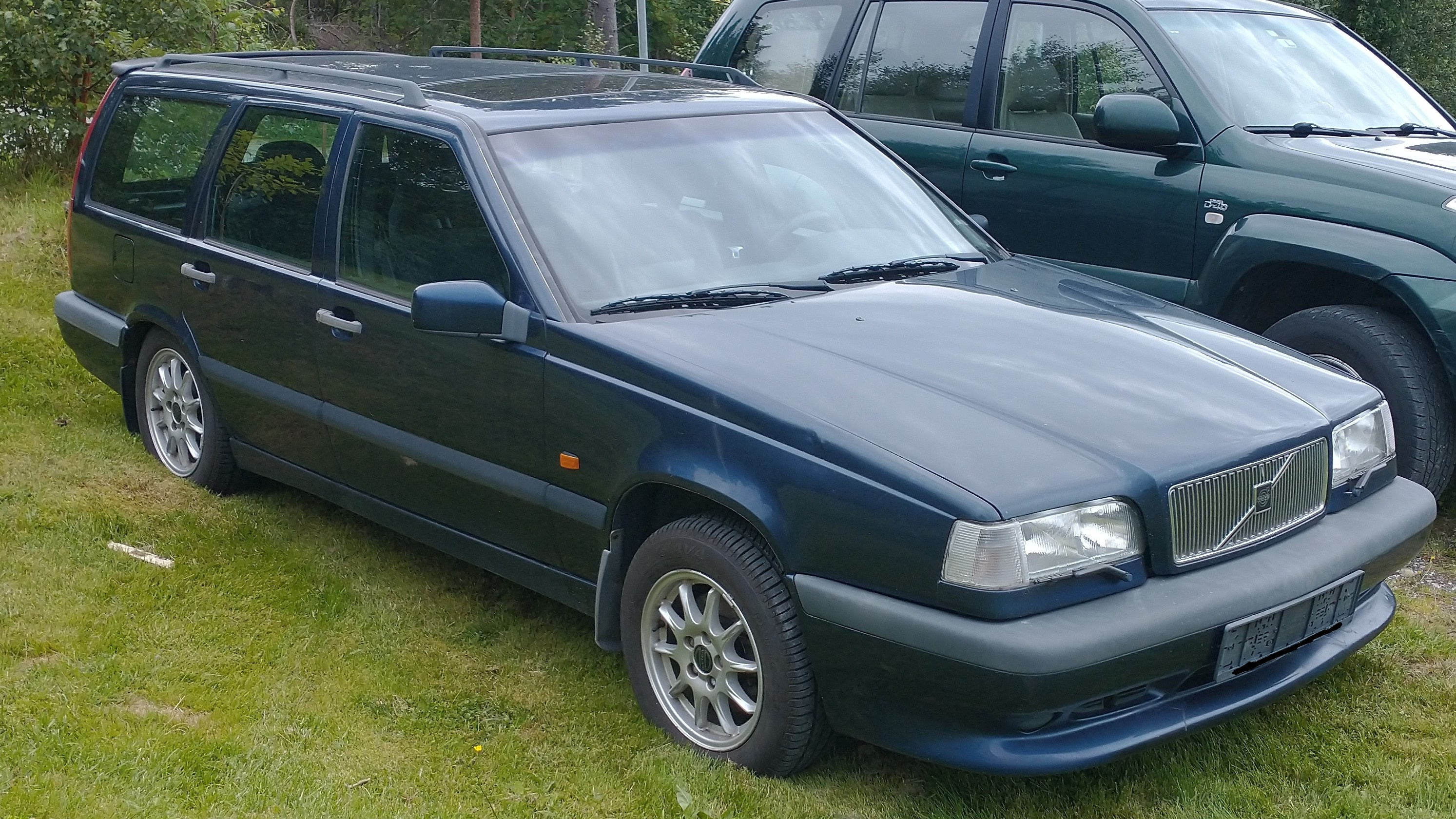

While my main Volvo is an S70, I recently acquired an 850 awd model, 1997 year as well.
The dealership has been helpful in getting parts like timing belt and accessories. (poor 850 has been sitting for a few years, almost turned into a rwd car by the previous owner) When the dealership gave me 0w-20 engine oil however... I thought that oil is way too thin for this B5254T engine?

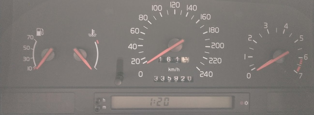

Ah, it's got about 208,731 miles. Over 200k miles of small, cold, and short city trips. Probably. I usually go for a longer drive in the weekends, in order to get the engine thorougly heated up. My daily driving consists of 10 minute 3.1 mile long trips to work. The cars barely have time to heat up. Same story with my S70, if not worse. Very short trips to the grocery store, only 0.5 mile long, in these past 20 years.
