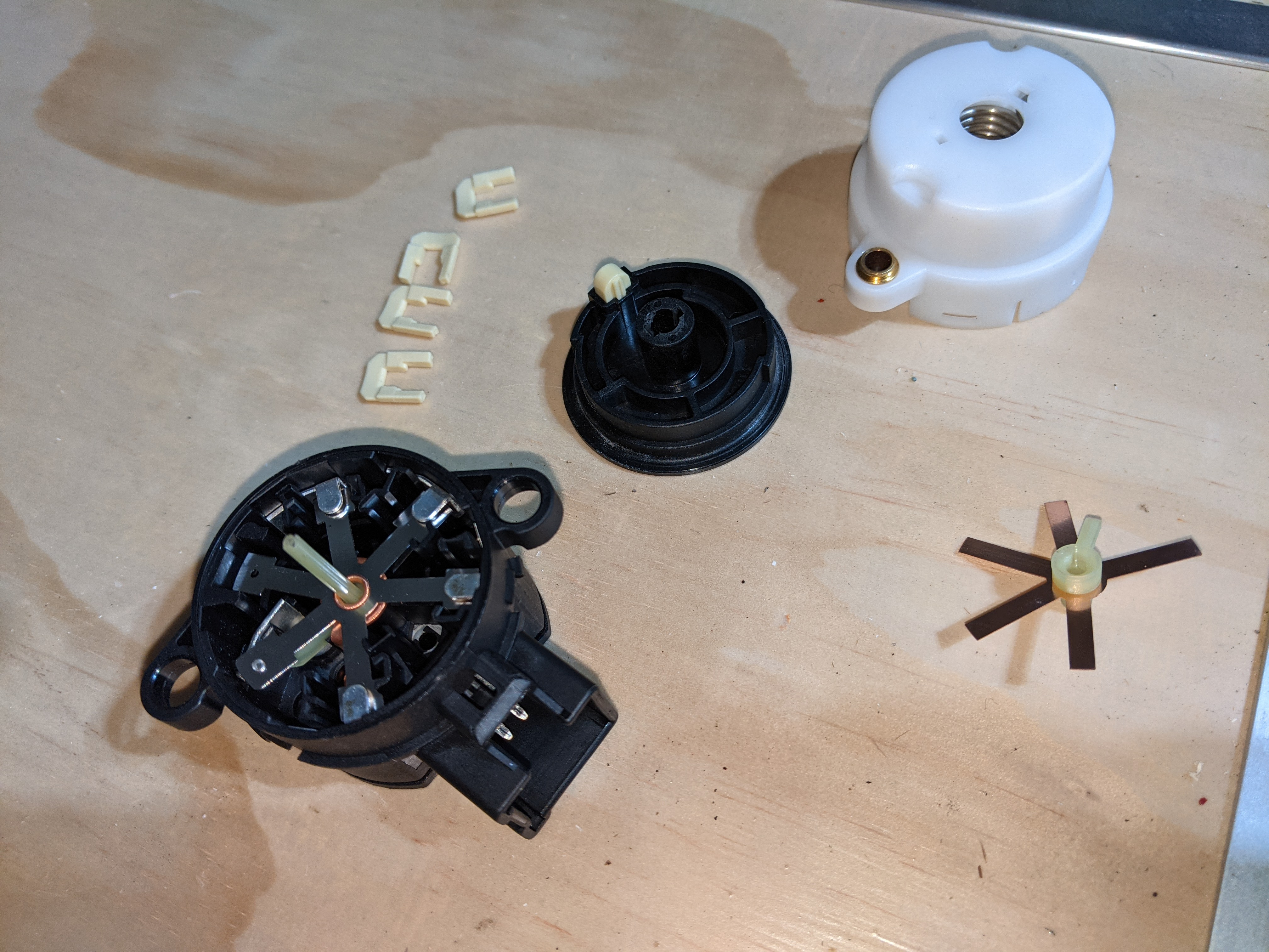

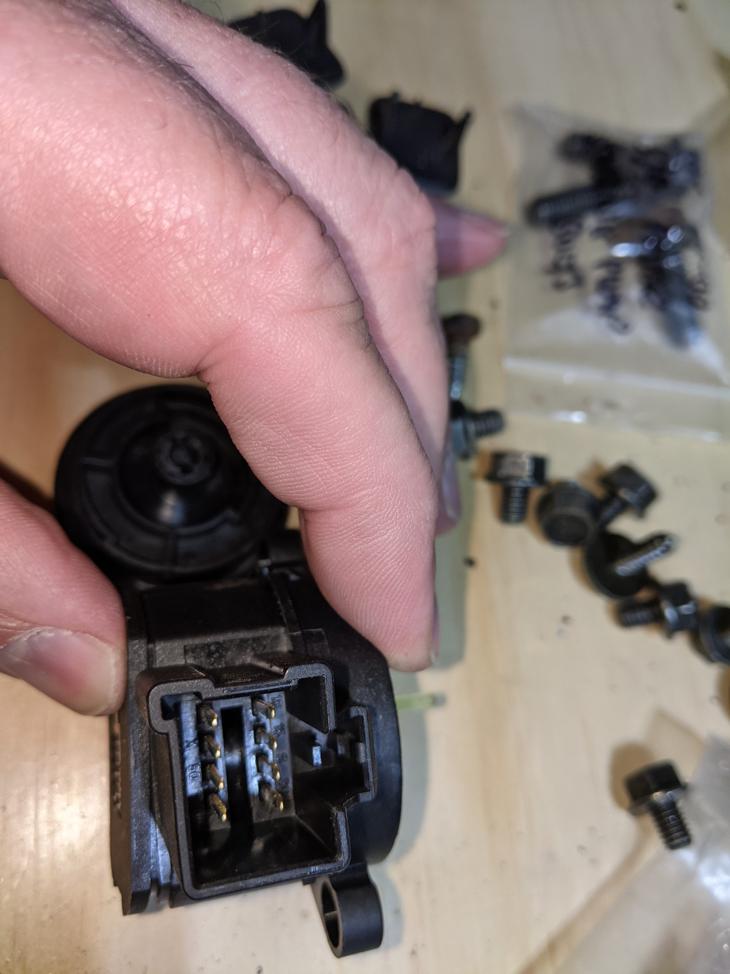

My conclusion is that the hidden wiring must have fused or melted internally within the body of the unit and I don't plan to take this apart further. I have attached pictures of the dis-assembled unit below:
Ignition switch components

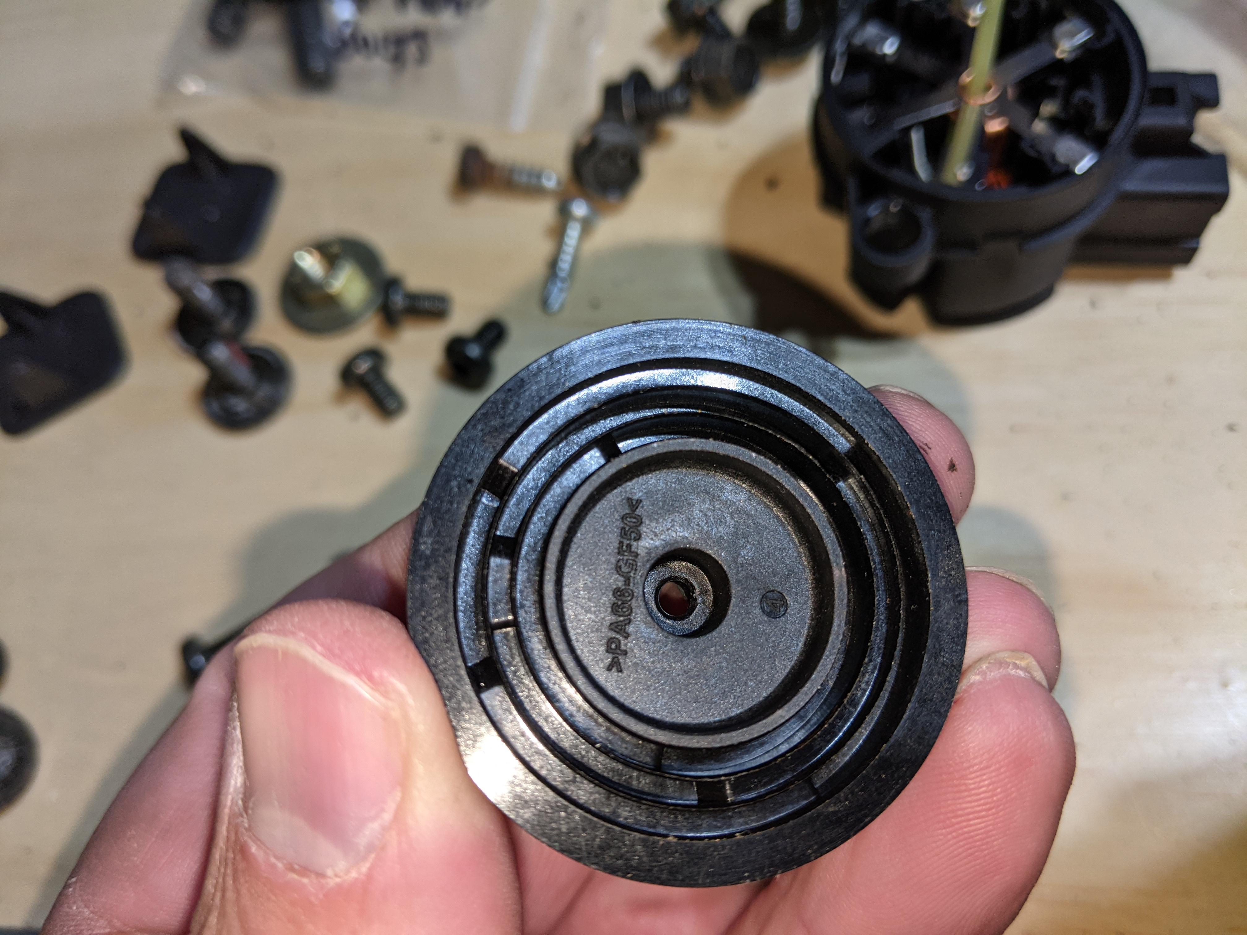

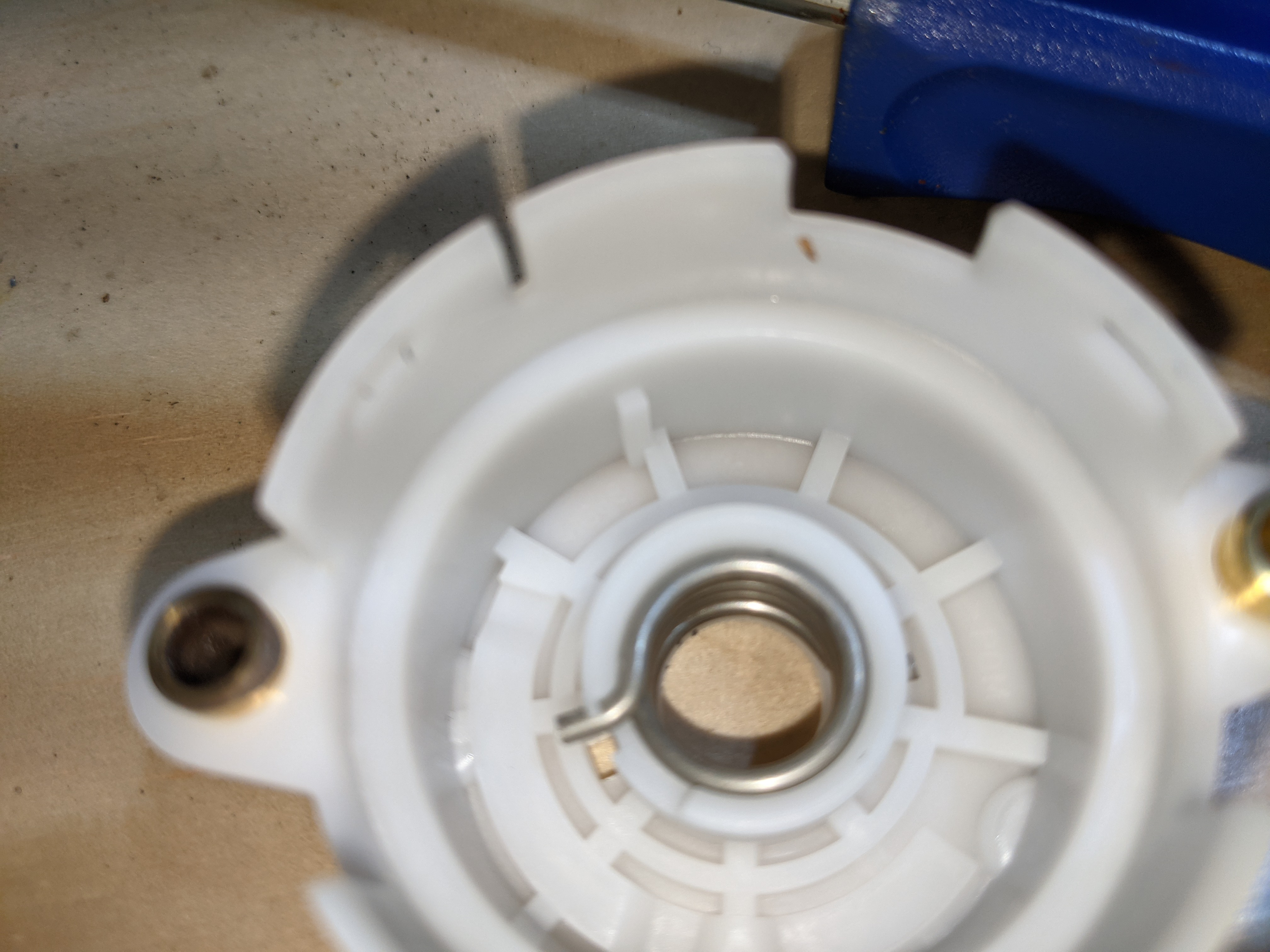

Interior of cover - spring return
The spring in the cover is what returns the key from POS III to POS II after starting the car.

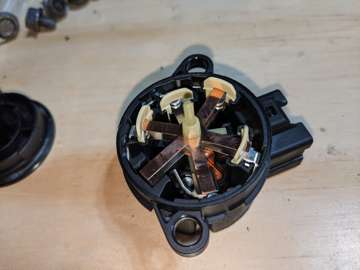

Mechanical portion of the switch

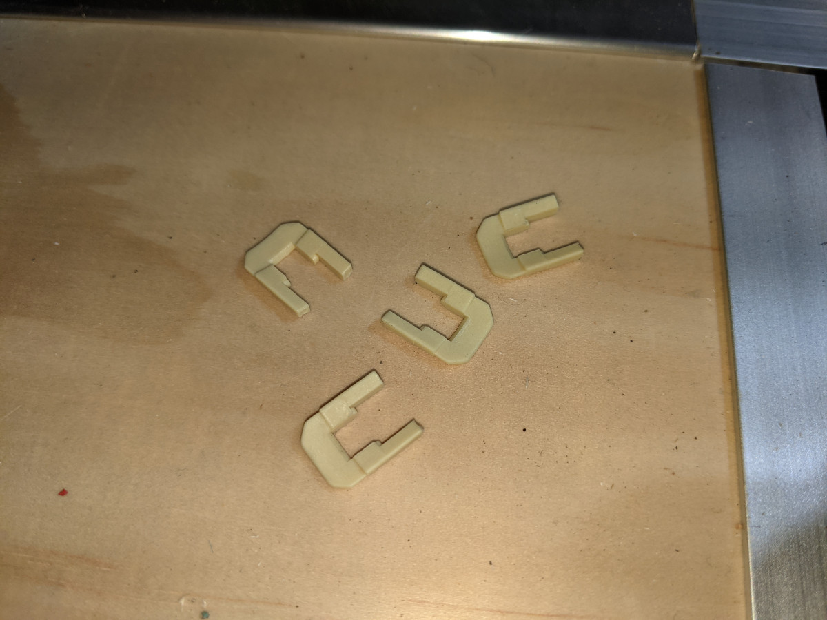

The ivory colored plastic pieces are pushed down by the cover above then in turn as you rotate the key in the barrel. That closes the contacts at each position.

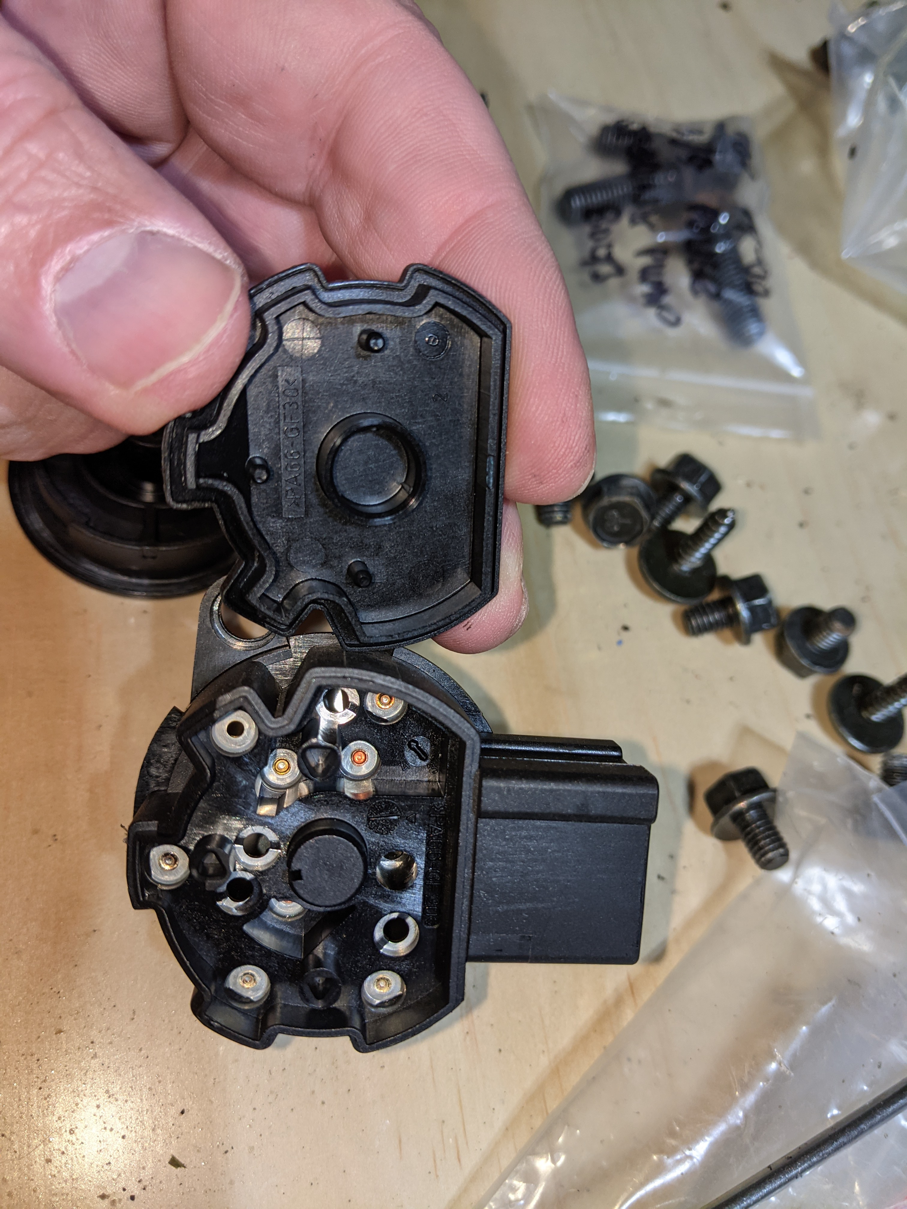

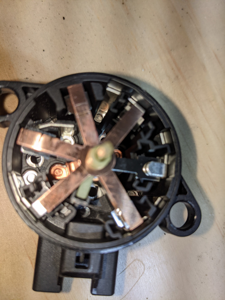

Electrical mechanical pins at inner base of switch
Base cover removed from switch
Electrical pin outs to wiring harness connector

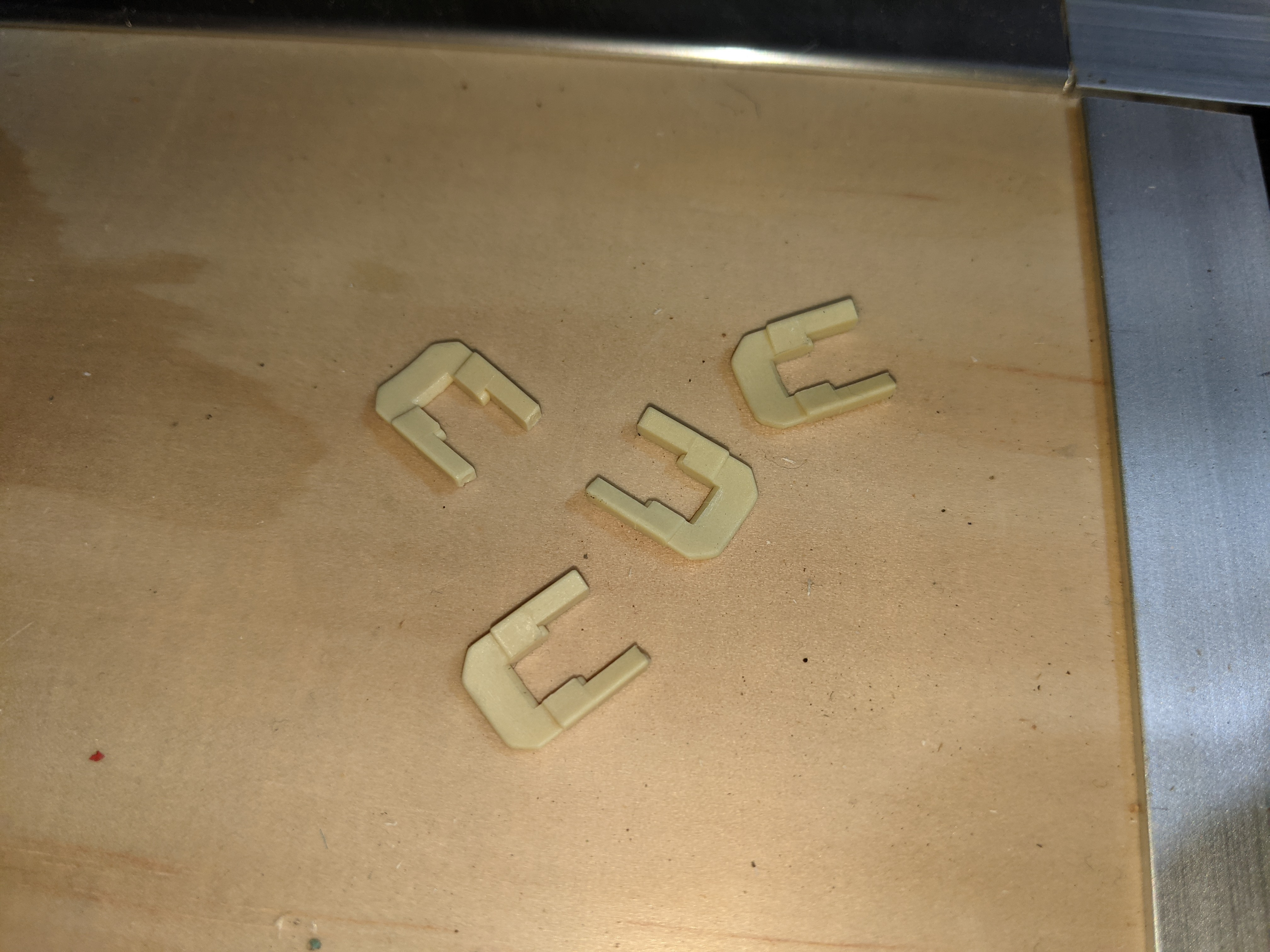

Sliders to push contacts to closed position

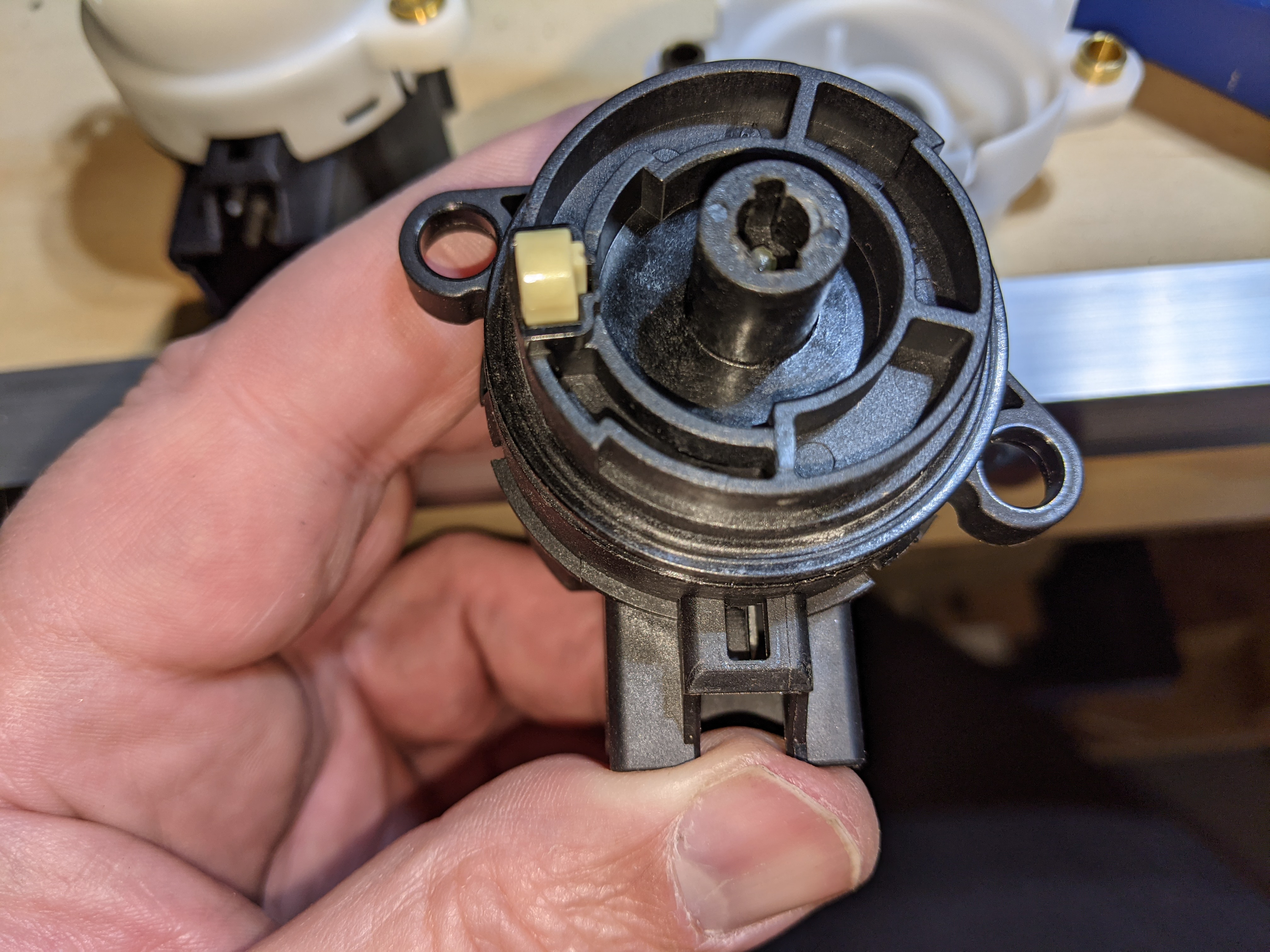

Cam cover lower side that pushes on the ivory sliders
Topside of cam cover
On the top side of the cam cover if you look carefully you can see a slight inward movement of the outer ring. In that a small protrusion in the cover sits to control the amount the electrical switch can move.
