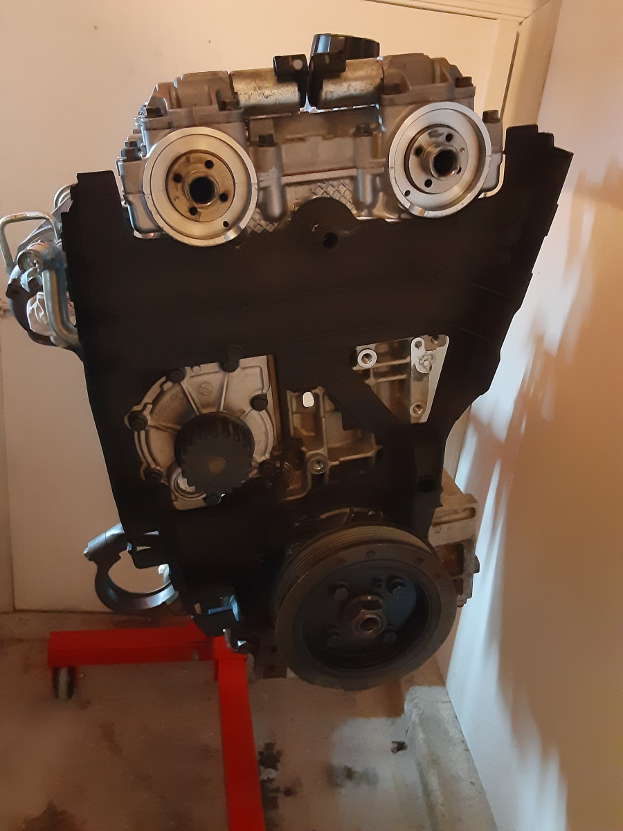

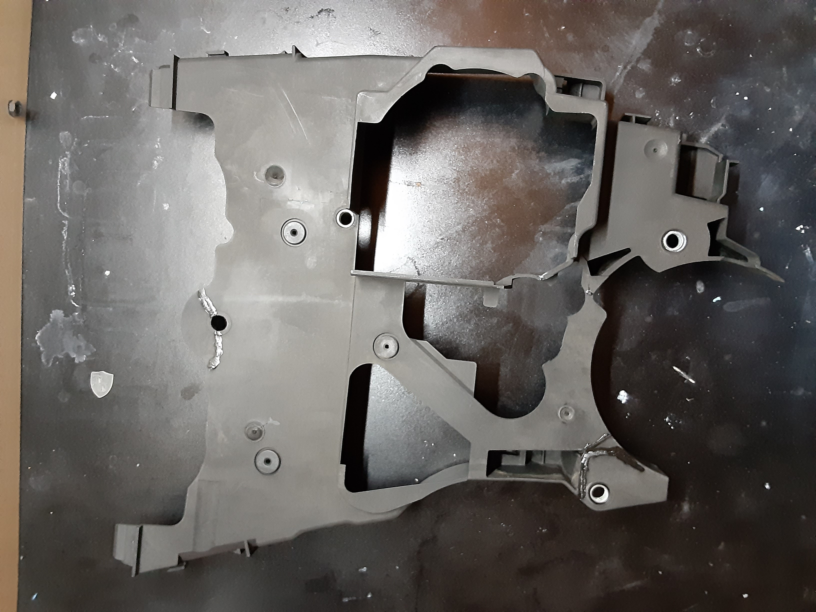

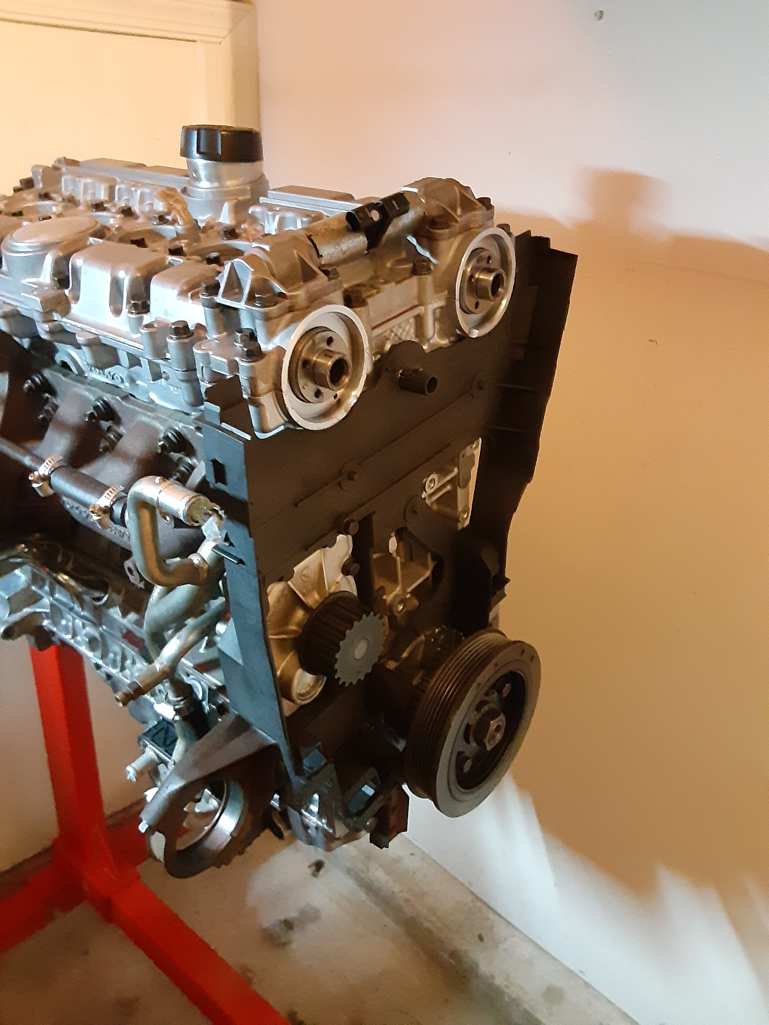

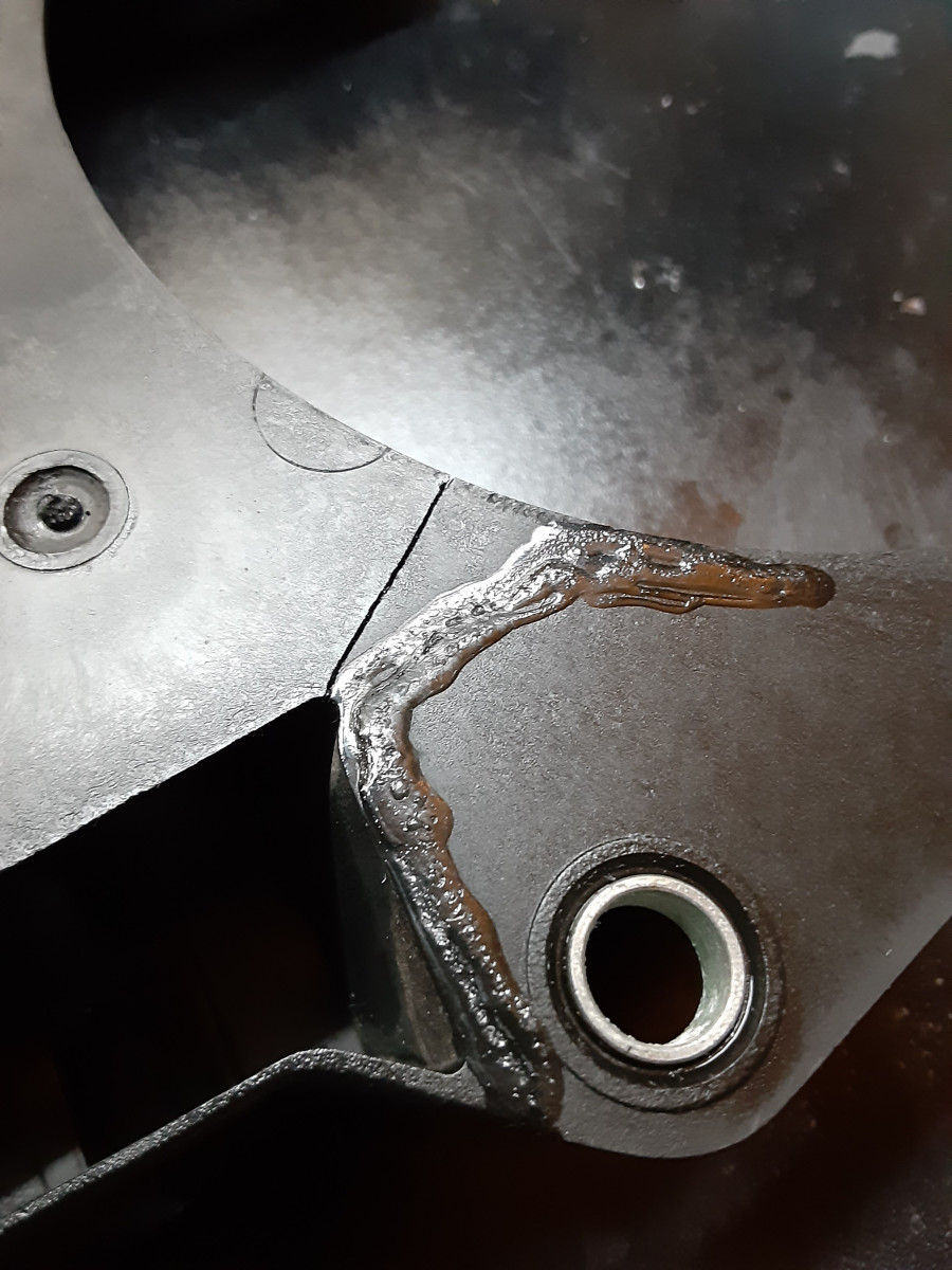

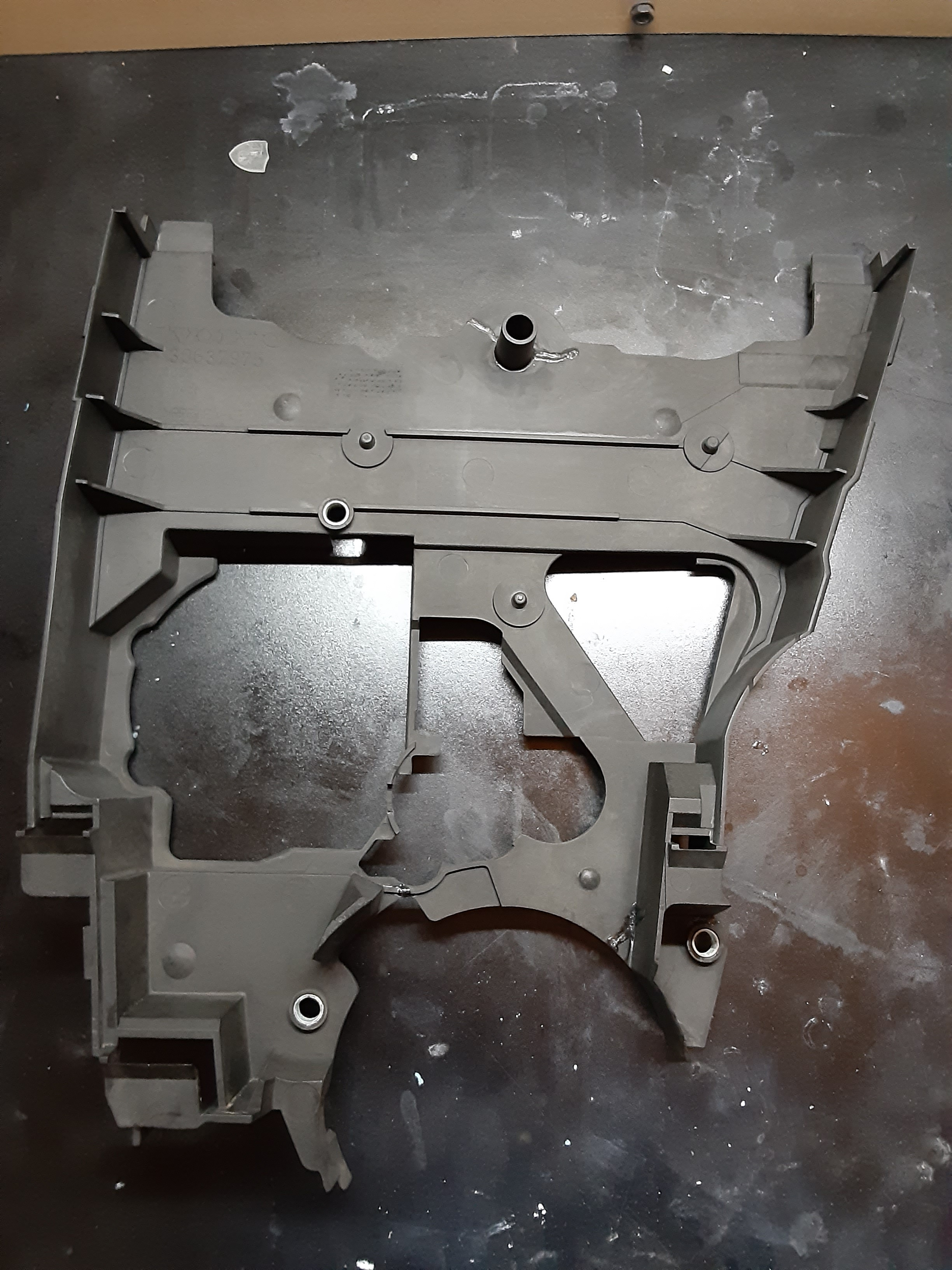

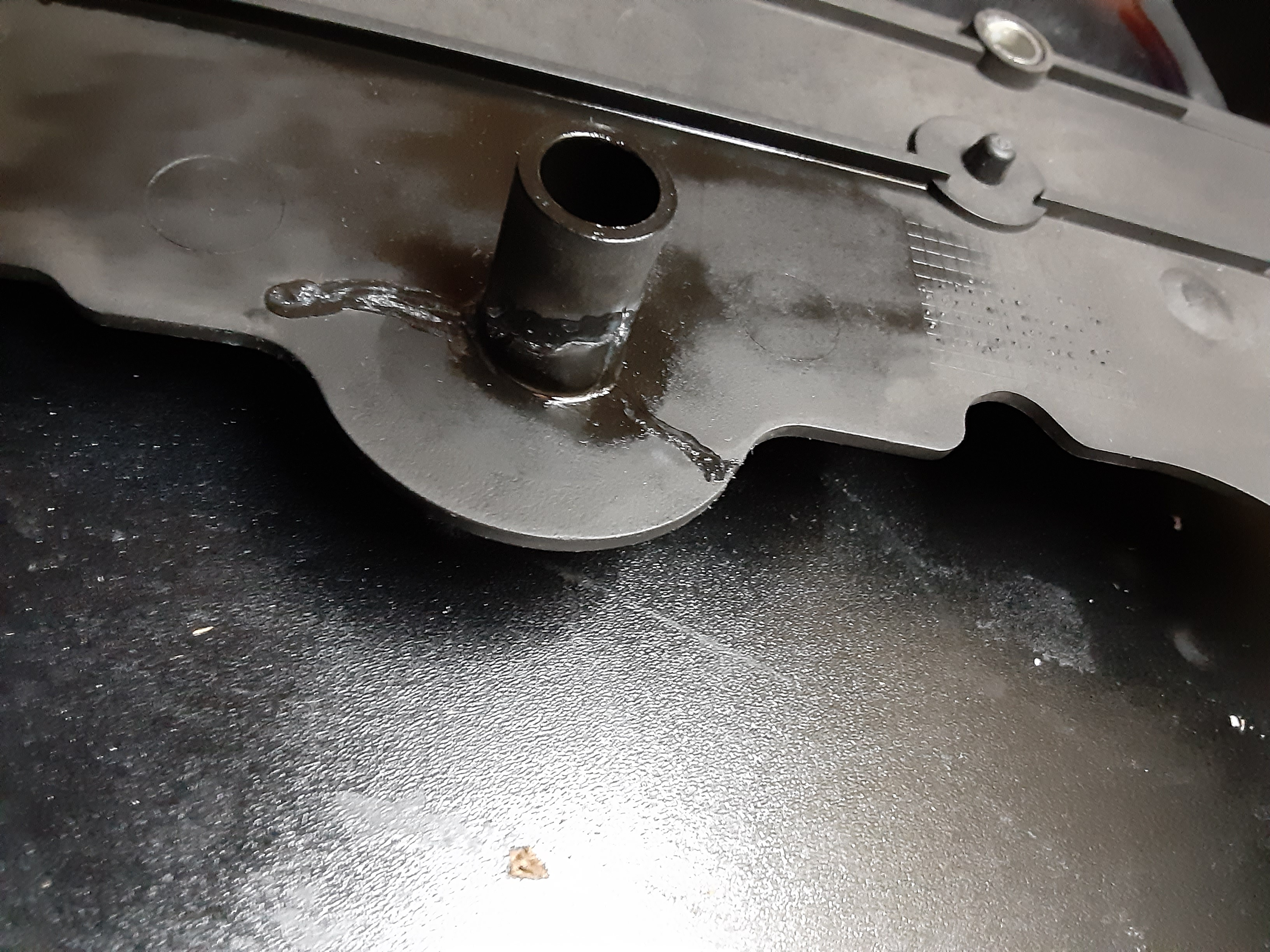

Added the front cover backing piece.
Had to glue a couple of cracks, but it's ready now. Clips and all.

ZionXIX wrote: 22 Sep 2021, 20:47
Nevada1906 wrote: 22 Sep 2021, 19:39 Added the front cover backing piece.
Superb work. You are doing exactly what Ive always wanted but never has the time to do it. By the time I get around to rebuild my parts car engine, there probably wont be any rebuild kits left.
Hey, thanks! Just doing what I love!
