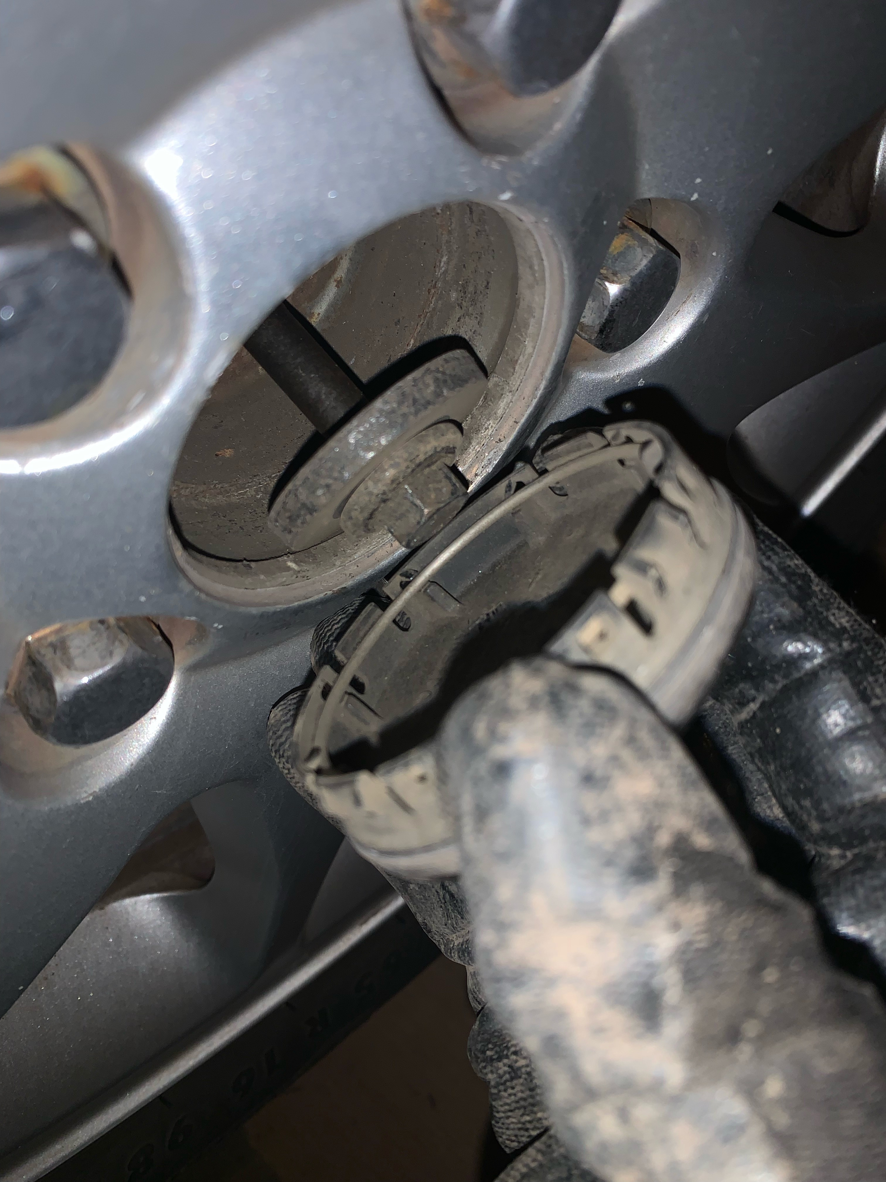

I might have found something. Or is this normal?
I checked the passenger side front, and it was still inserted but only finger tight. Re-torqued each one to 35 Nm plus 90 degrees, drove it 10 miles, no codes or ABS lights. So that seems to have fixed it.
I'll get new axle bolts, I know those are torque-to-yield, but tightening the existing bolts gets the car back on the road until new ones arrive.
I checked the rears, they were tight. Then I went to my other P2, 06 S60 R, and found the same thing, rears were fine but fronts were only finger tight! Nope, no recent service, axles have not been removed on my watch except a while back I had the passenger axle out on the S60 R when I changed the angle gear. So maybe that one is my fault but hard to explain the other three across the two cars.

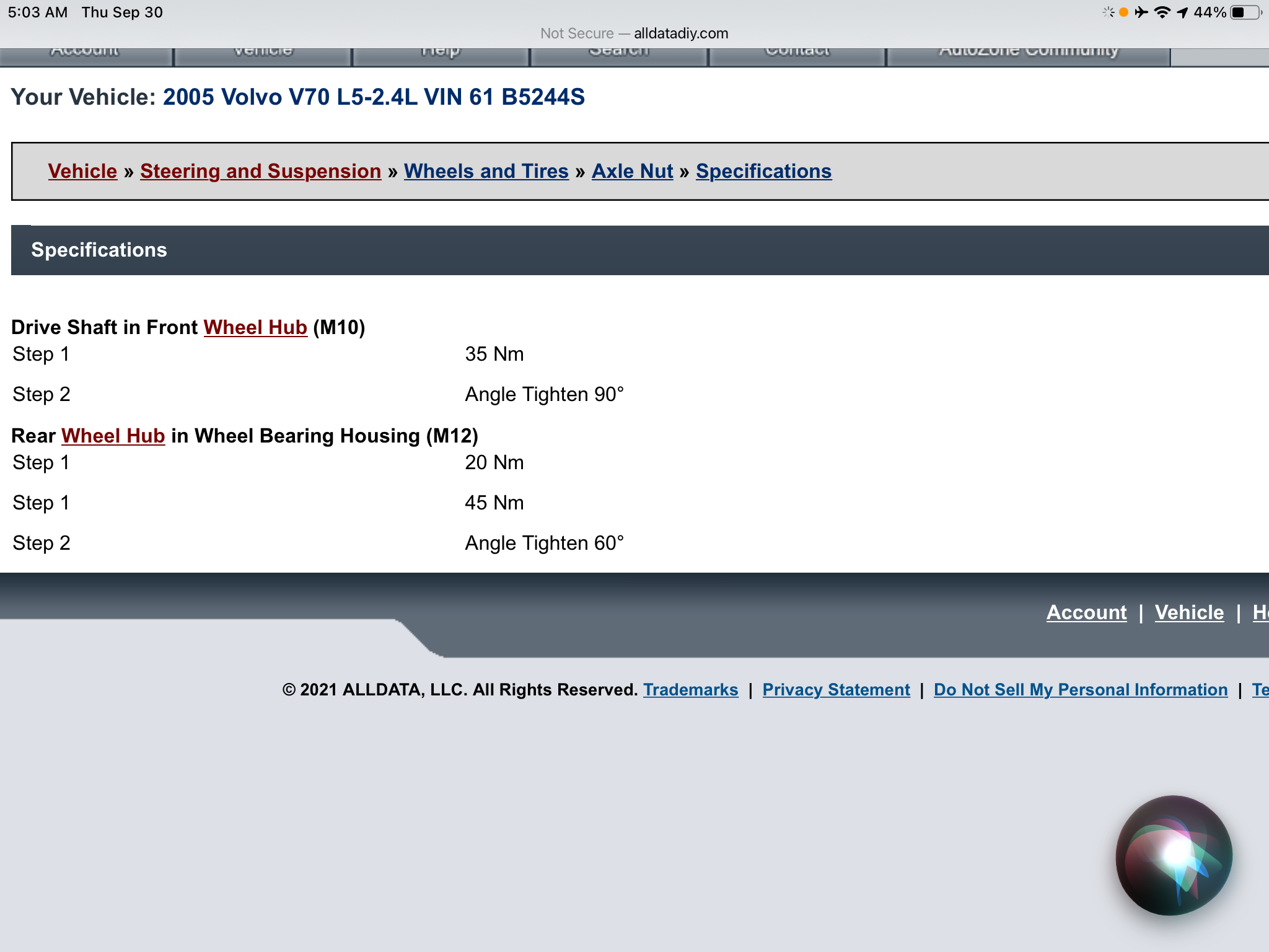

Those are not torque to yield and the torque is relatively low, too.
Standby for the number. Volvo does say to replace them with new on removal.
It’s a normal for a DIY forum, yes. Not for operation.
