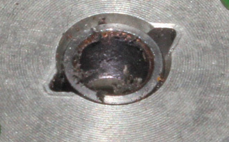

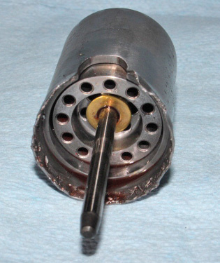

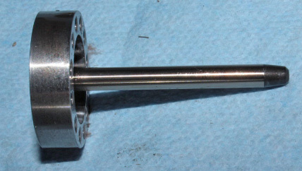

Here are some photos of the solenoid that was sticking. The dark crud on the bushings is not dirt and grime build up it's a coating on the bushing. There maybe some dirt and grime embedded in the coating but it's primarily a coating on the bushing.
