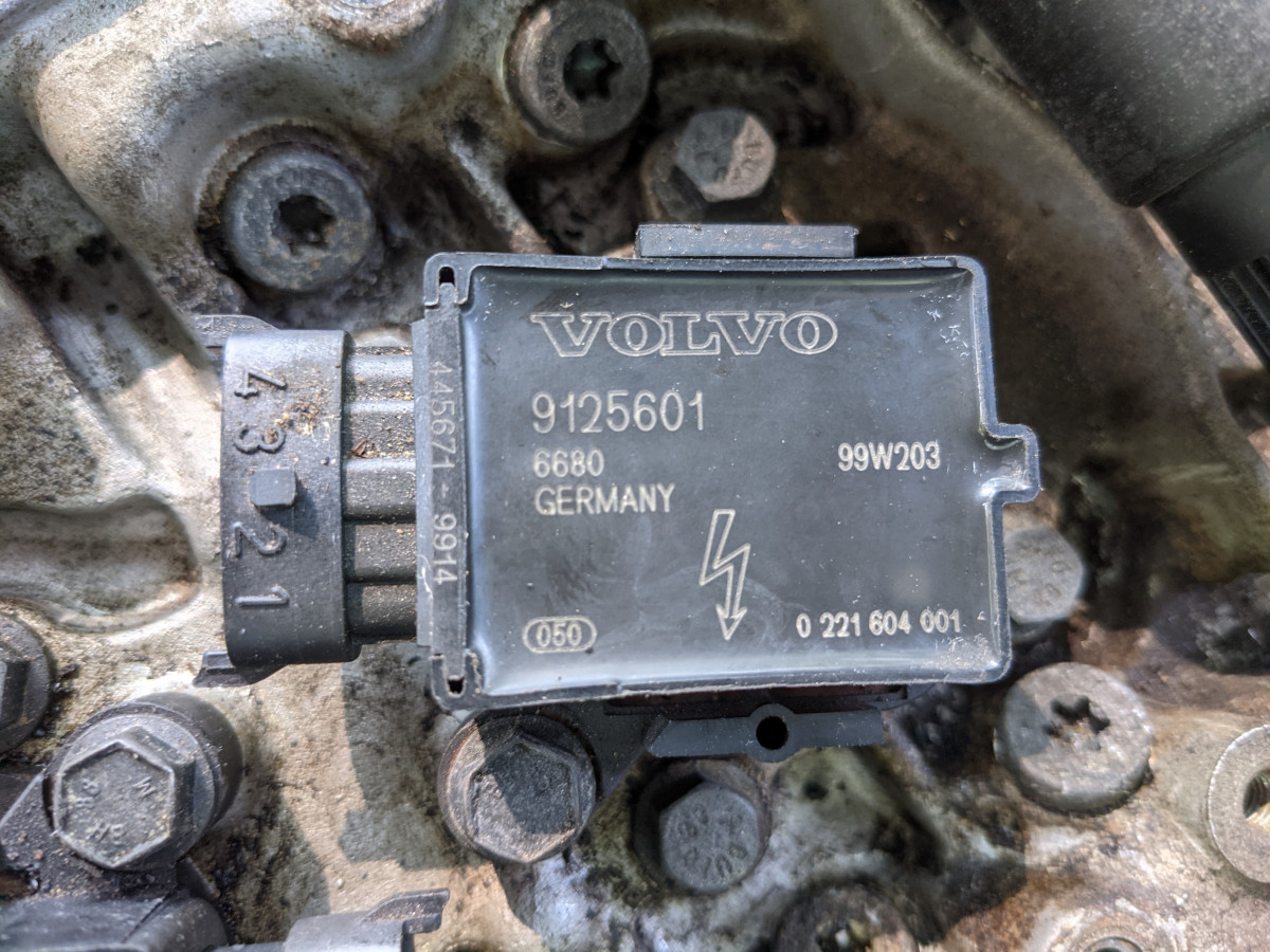

Thanks everyone. I'm wondering about this because the owner of Geronimo said the engine might have been swapped. It seems like engines in 1999 and 2000 are interchangeable yet their subtle differences may affect ordering parts.
I just remembered that the coils are all dated a month before the body sticker's manufacture date. Since they nearly match, it's probably the same engine. The coil date code is on the right side of the coil top, something like 99W203 meaning "1999, week 20, day 3".

If someone did an engine swap , they would likely bring the coils over, but 350k on coils is impressive !!
