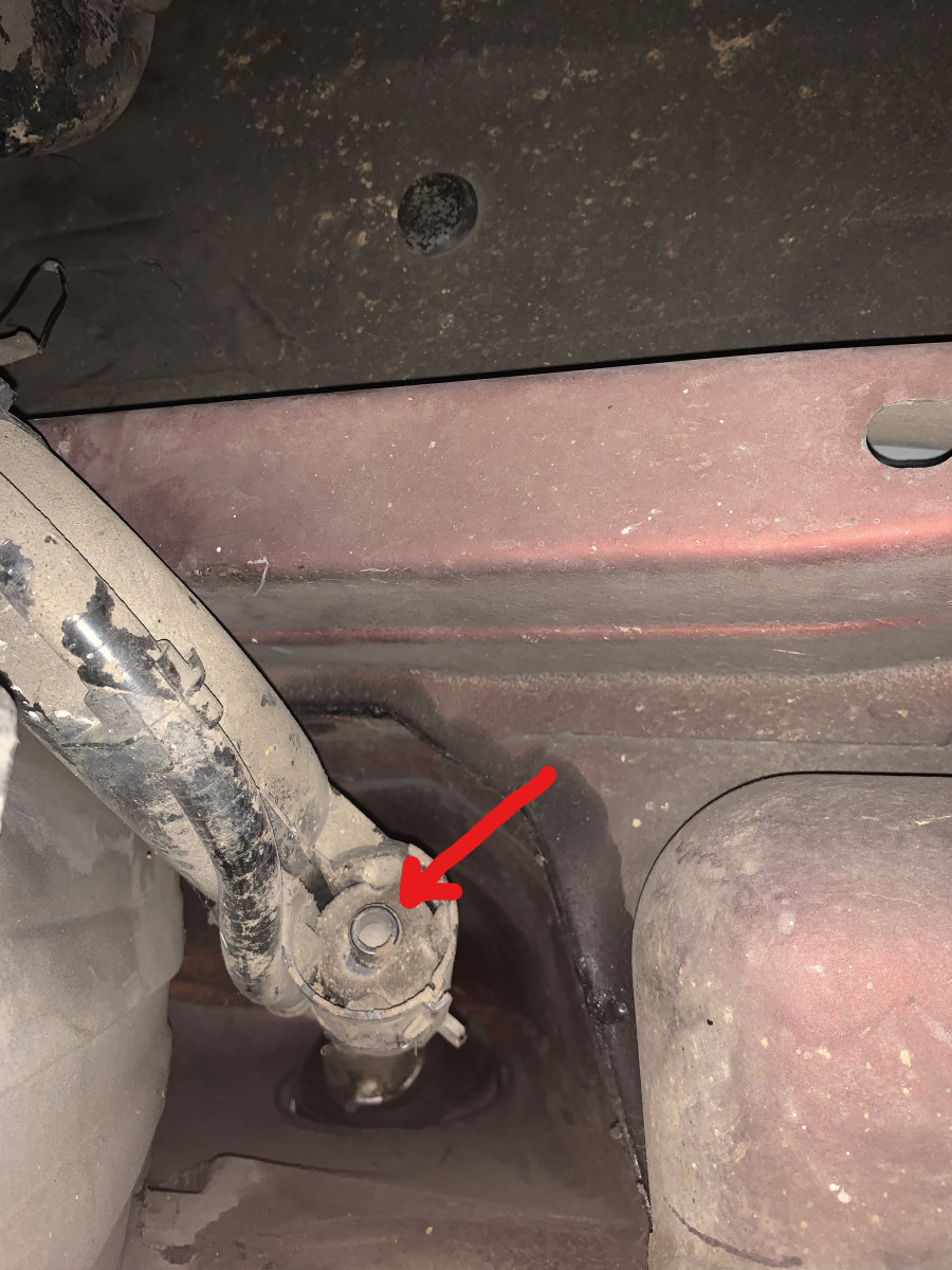

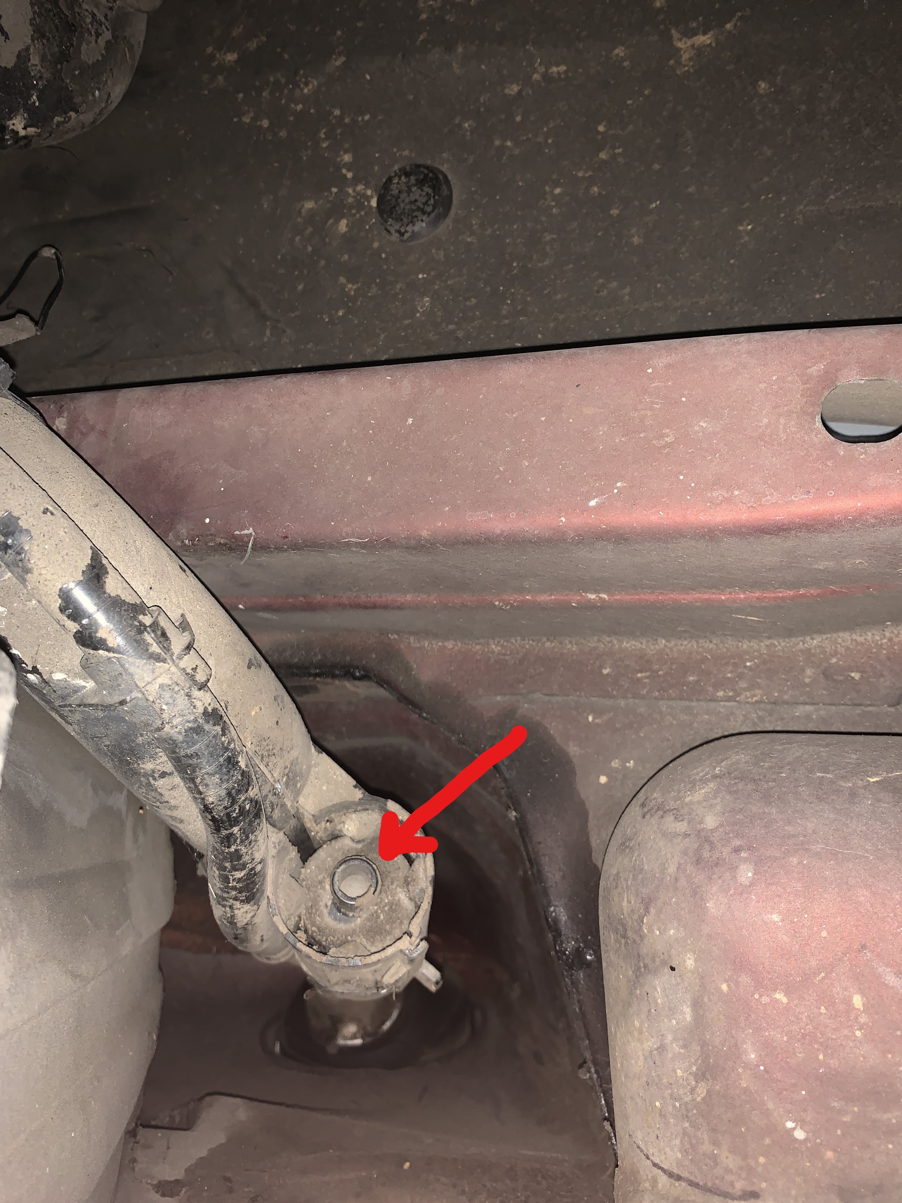

I finally decided to smoke test my car for the P0455 code that never goes away. The only place I could see anything escaping was this breather piece on the filler neck, which (if I'm not mistaken) should be a vent. I'm not sure if it should be closed off with a check valve of some sort, so please correct me if I'm wrong here. I'm going to try to investigate this further.
I couldn't see any leaks coming from the top of the tank, but that doesn't necessarily mean I wasn't missing anything. A hose could have been pinched when I installed the tank, since it's only been in place for a few months now and the code has been present since then.
The evap/fuel tank setup on this car is from my '98 V70 GLT, so that's the evap system I'm working with, with the charcoal canister mounted near the fuel filter. I added smoke to the system through the vacuum tee at the fuel pressure regulator, which is next to the filter (not the same setup as the '98 GLT). Yeah, I know, it's a bastardized setup, but electronically it's the same as the 2000 V70R should expect. I will also check for function of the evap components on VIDA, but I'm expecting everything to function properly.
Anyway the point of this thread, can anybody confirm that I should see leakage at this breather when smoke testing the evap system? I would think that the car would pick this up as a leak, but as I mentioned, it might be blocked off with a check valve.

A breather would open when the tank pressure is less the atmospheric pressure, to prevent a vacuum when fuel is being pumped out. If you are pumping pressure into the tank you would expect it to be closed. If it does not close when the tank is pressurized it would fail Leak diagnostics. Leak diagnostics work by sealing off the tank and measuring how fast the pressure drops.bmdubya1198 wrote: 27 Oct 2021, 10:12 Anyway the point of this thread, can anybody confirm that I should see leakage at this breather when smoke testing the evap system? I would think that the car would pick this up as a leak, but as I mentioned, it might be blocked off with a check valve.

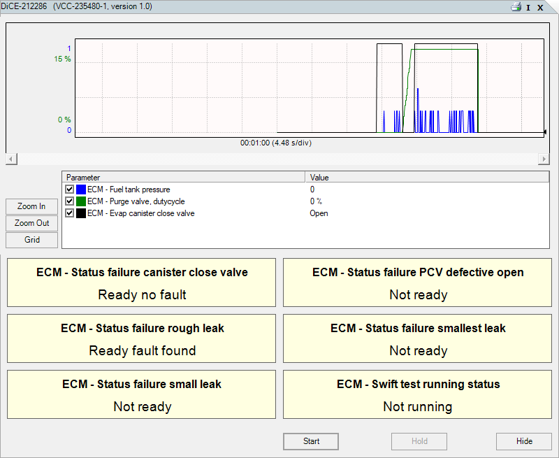

Tank pressure bounces between 0 and 0.25. At idle, it stays closer to 0.25, occasionally bouncing high when I look at the graph. When I tried to test the evap close valve (next to the fuel filter), it didn't do anything. Voltage at the connector checks out, and resistance is exactly the correct spec, 17 ohms. I have a feeling that the valve may be bad.

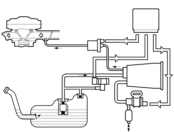

I am trying to remember how the FWD system works. I am probably wrong, but if I recall correctly, the pipe to that vent comes from the roll over valve? So if that is correct, then the roll-over valve should be shut when the emissions test is running and that would make any valve up there immaterial to the P0455.
It could be the roll-over valve that is not working. That is where Vida should help as Rick suggests.

It could be what you're referring to as the rollover valve/leak detection pump, part number 9486016. #9 in this diagram https://www.volvopartswebstore.com/show ... evel=24667

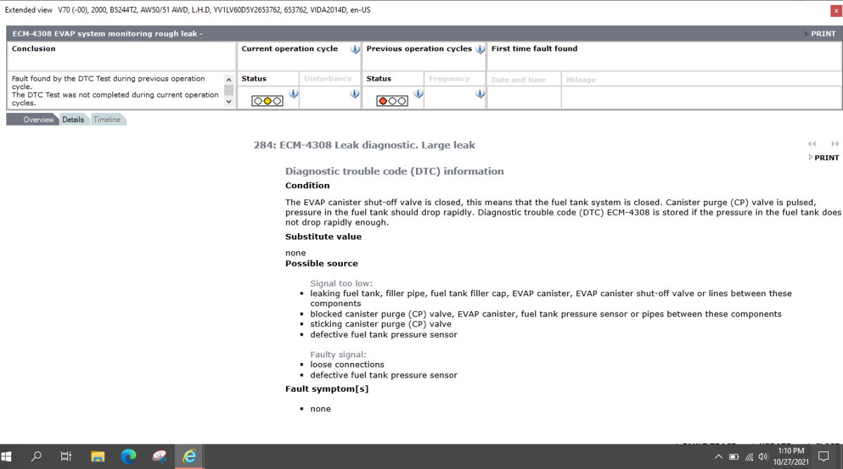

I ran to the junkyard earlier this afternoon and grabbed one, that's definitely working now. However when I run the test in VIDA (under fault tracing for the code) it still shows a rough leak. Looking at the graph, there should be no fuel tank pressure with everything open, and it bounces back and forth between 0 and the peak.
I noticed while running this test that when the canister purge valve closed, the car stumbled very slightly. May be normal, or it could possibly be a vacuum leak on that hose. I couldn't see one yesterday while testing, but I'm going to check again anyway.
I'll post the log and the code description below.

And just to add it in, a diagram of the evap system.

Leak Diagnostics is carried out as follows:
1. The EVAP canister shut-off valve and canister purge (CP) valve are closed and the fuel tank system is now completely closed. Note: Canister shut-off valve is normally open (Turned off, not grounded ). Canister purge valve is normally open (Turned off, not grounded ). To close both you ground the canister shut-off valve only.
2. Pressure in the fuel tank should be stable. If pressure drops the canister purge (CP) valve is leaking.
Note: this assumes the rest of the system is tight. It could be the hose to the (CP)
3. The EVAP canister shut-off valve opens, the tank system is open. The canister purge (CP) valve is pulsed and because of the negative pressure in the intake manifold the engine starts to suck air through the EVAP canister. Because the EVAP canister shut-off valve is open the pressure in the fuel tank drops slowly. If the pressure in the fuel tank drops rapidly the EVAP canister shut-off valve is clogged.
Note:If the canister shut-off valve/vent is clear, Air will be sucked through the canister vent. If the canister vent is clogged Air will be sucked out of the fuel tank. Path of least resistance.
4. The EVAP canister shut-off valve is closed, the canister purge (CP) valve continued to be pulsed, pressure in the fuel tank should drop rapidly. If pressure does not drop enough there is a large leakage in the fuel tank system. A diagnostic trouble code (DTC) will be stored.
Note: Fails if it sucking air from somewhere other then the tank. This is ECM-4308
5. The canister purge (CP) valve is closed, the EVAP canister shut-off valve is still closed, there is negative pressure in the fuel tank. The negative pressure (A) in the fuel tank has stabilized, if pressure starts to increase too quickly, this indicates a small leakage in the system. A diagnostic trouble code (DTC) is stored.
6. The EVAP canister shut-off valve opens, the EVAP function is enabled and the diagnostic test is finished.

Because you are getting ECM-4308, Large leak #4 above. Disconnect the hose between the Fuel tank and the Canister at the Canister end. Inject the smoke into that hose. Look for leaks in the tank system.
The Values can be checked with a vacuum pump and a 12V Voltage source. The Vacuum pump from a brake bleeding kit will work.
