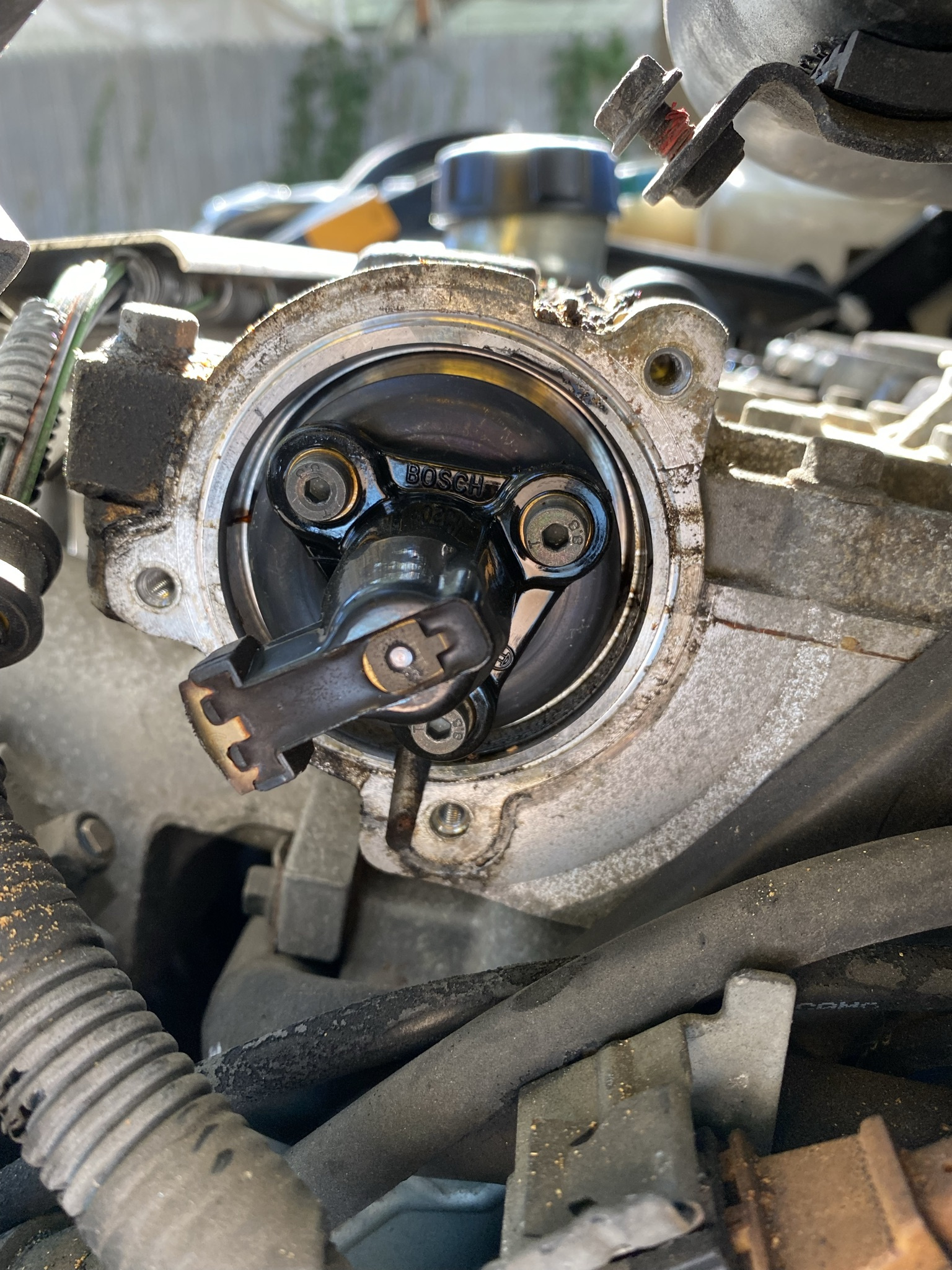

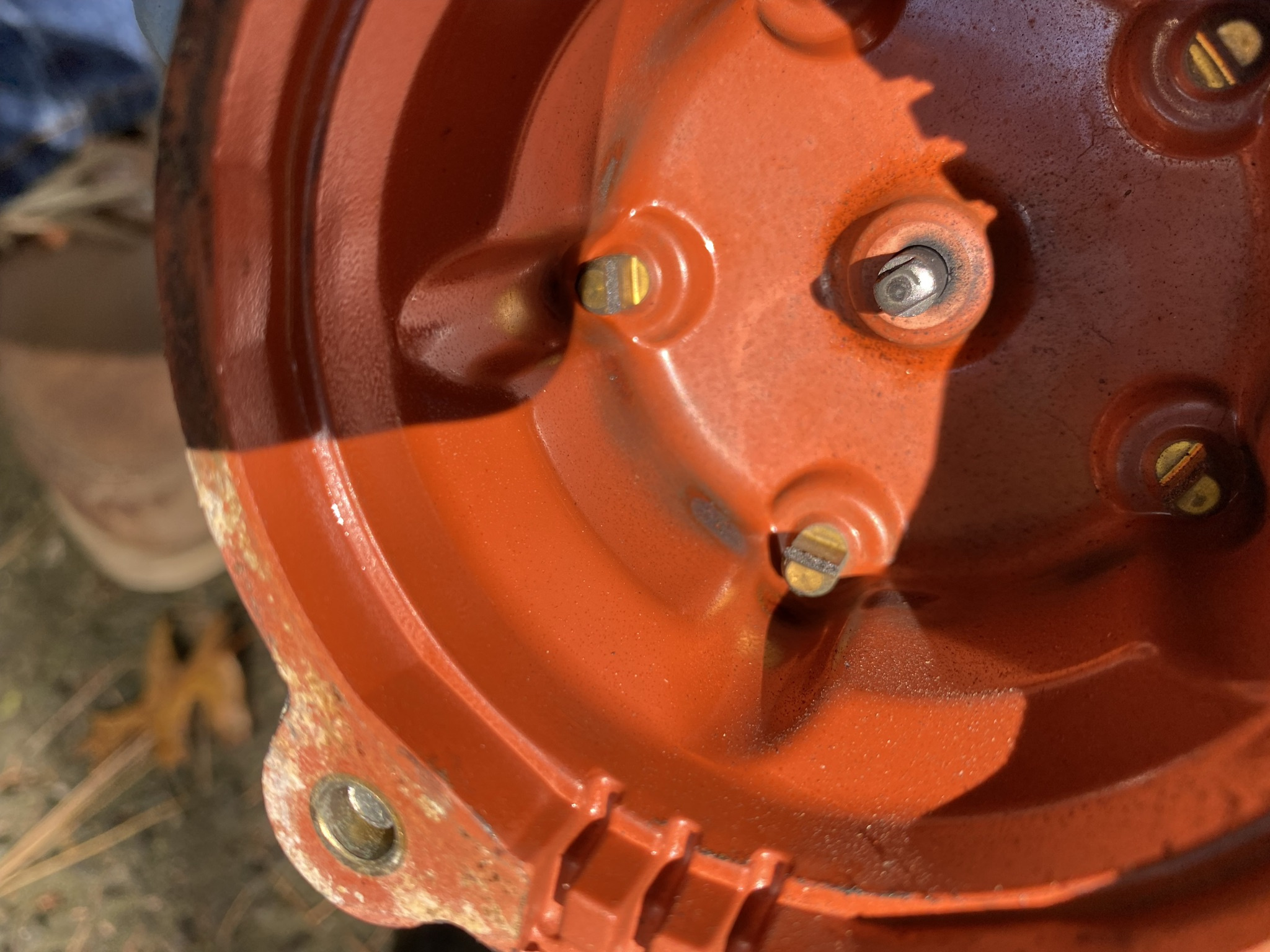

Pull off the distributor cap and let’s see pictures of the cap and rotor. Spark at coil won’t be useful if it doesn’t make it to the spark plug
Example of shot parts….
- Posts: 36137
- Been thanked: 4064 times
You will need a longish 3mm hex key to get those rotor bolts off, bit of an oddball size
