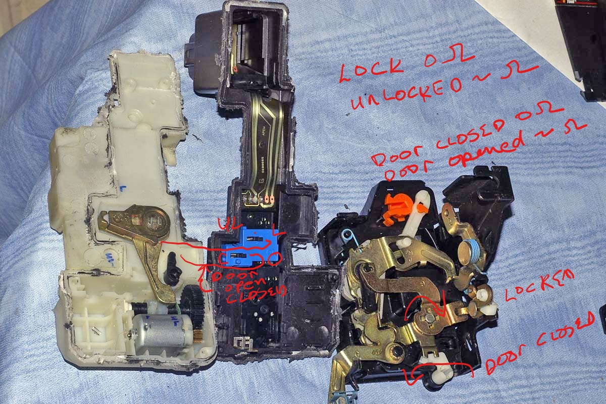

From the video it sounds like the other doors are unlocking and the one door isn't, which in my experience is the problem is with the door latch/lock assembly for the door that's no locking or unlocking. The problem (I think) is usually due to do one of two micro switches although it can be other problems within the sealed assembly, such as a little motor or linkages. I had a metal linkage arm break in one my car's lock. For the two sliding switches; one switch is for the door open/close position and the other switch is for door lock/unlock status. You can't really get to the switches to clean or replace them so a whole new lock assembly replacement is required. For my 2001 I've replaced these lock assemblies in 3 of 4 doors over the years. I've had pretty good luck with the lock assemblies from the salvage yard.
InkedV70 Rear Door Lock Assembly001_LI.jpg (1.95 MiB) Viewed 740 times
