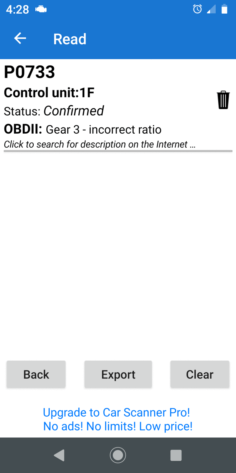

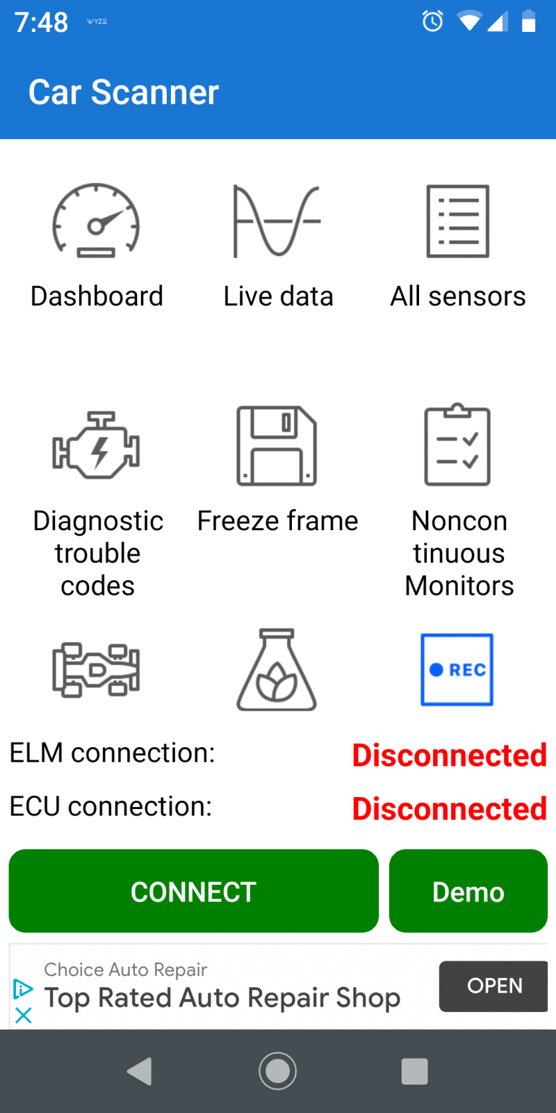

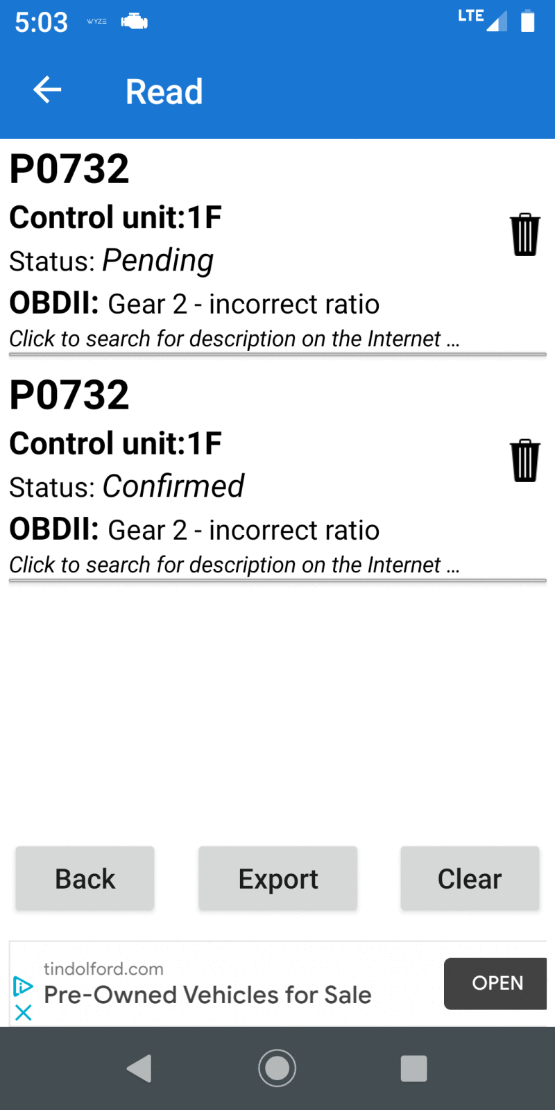

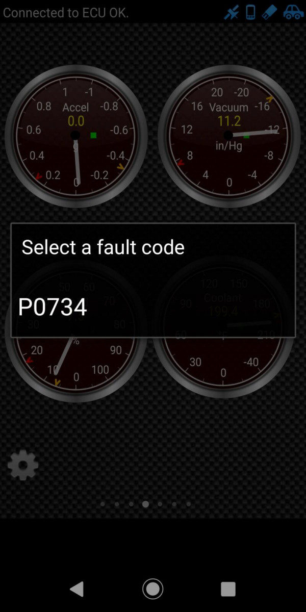

Got codes in every gear even driving in manual mode. If there is a slight grade in the road I have to nurse it or go to lower gear and higher revs or not enough pressure and starts slipping. If you don't have an OBDII use the free Car Scanner software and a mini OBDII dongle from Amazon. The free Torque Light software has minimal functions.
Due to the Car Scanner software ease of use I am able to safely clear the Limp Mode on the fly, taking a screen shot before doing so.
There are many to Wifi or Blue Tooth dongles to choose from. I've lost two and recently purchased 3 and never had any issues with any.
https://www.amazon.com/Mestart-OBDII-OB ... X8V6&psc=1
