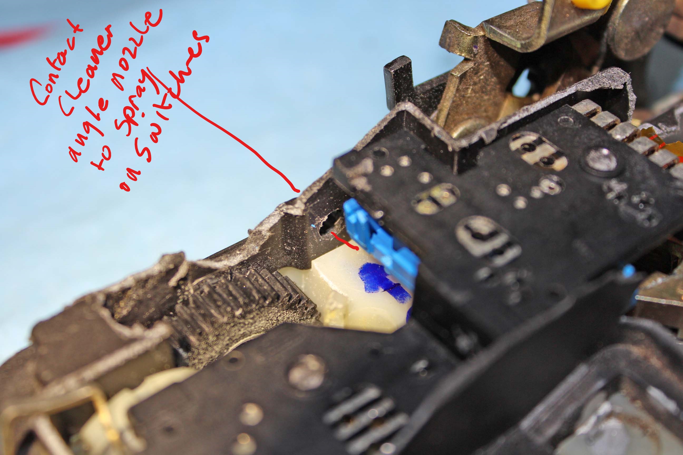

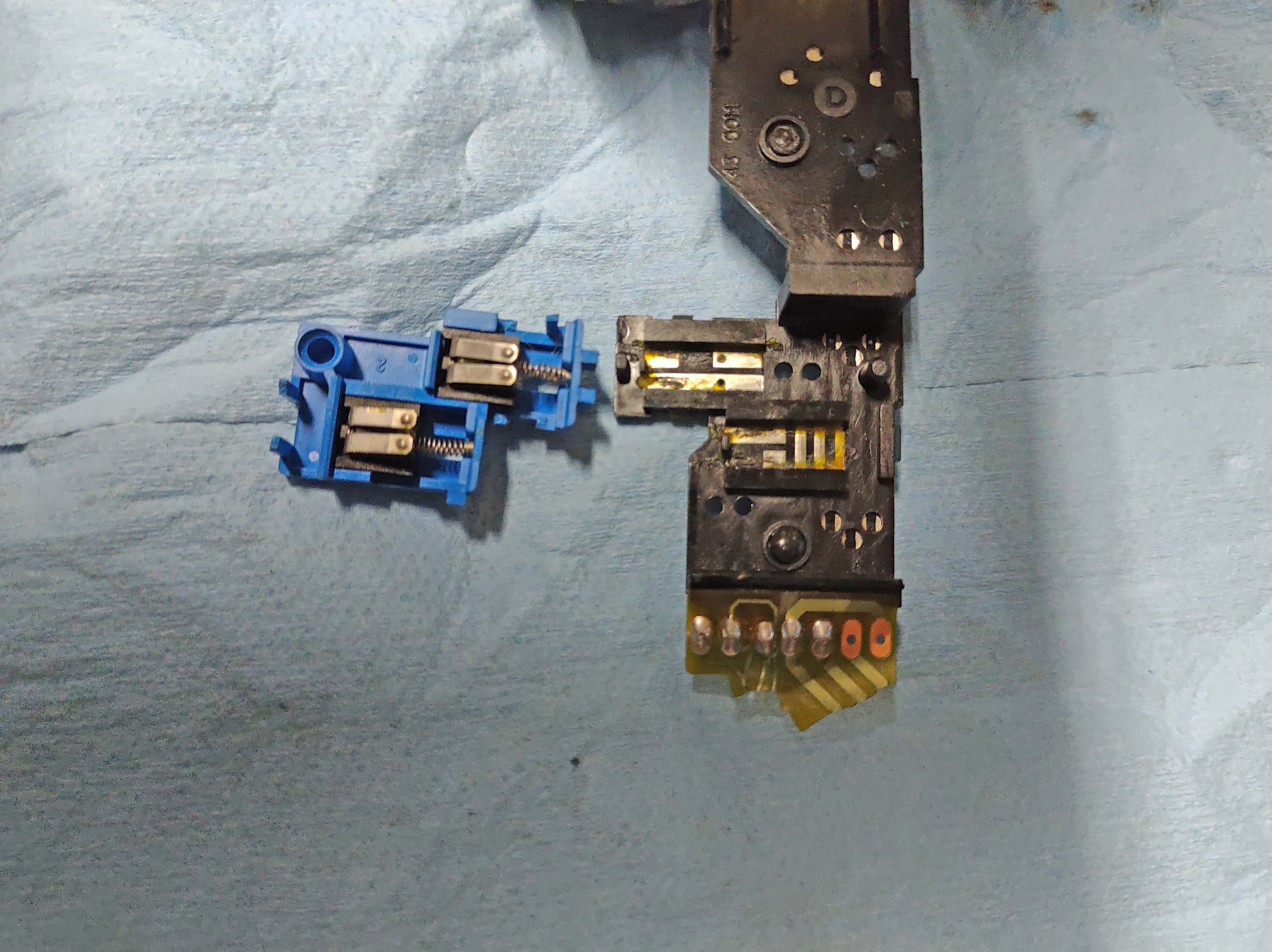

It's tough to get to the microswitches for spray cleaning and although I haven't tried this yet I did pull (broke apart) a door lock assembly apart to see if a hole could be drilled to get access to switches (see photo). It may be possible to get some electrical cleaner in there but you still have to pull the lock assembly out and drill a small hole for access. With my car I've had to replace three of the four door lock assemblies over the years, two for switch problems and one with a broken linkage.
Volvo door lock switches.jpg (926.4 KiB) Viewed 1465 times
InkedVolvo lock with cleaning fluid access hole_LI.jpg (2.1 MiB) Viewed 1465 times
