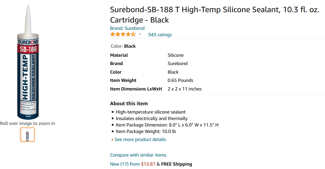

Surebond-SB-188 T High-Temp Silicone Sealant, 10.3 fl. oz. Cartridge - Black
Posting not recognizing Amazon links at this time so here is the picture
The air baffle box in the 2003 GS300 will all crack, disintegrate and in time split in half due to heat as it above the exhaust manifold. The car will have flat spots when accelerating from drawing excessive air. I used this to reattached both sections and to cover the box in it's entirety with it. Drys fairly fast to tack and will be rubbery when cured. Used in April 2020 and has held up and no flat spots during acceleration.
