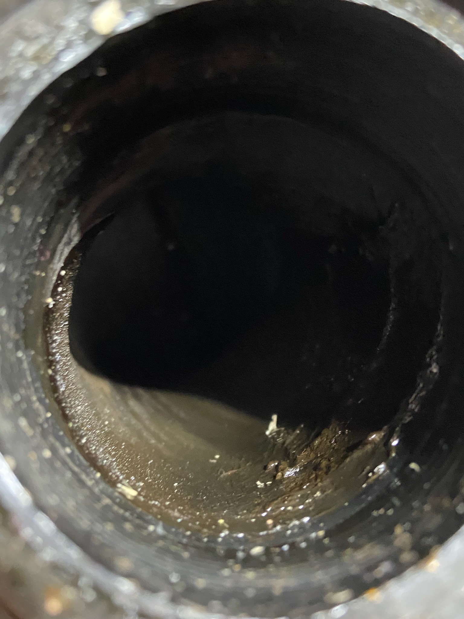

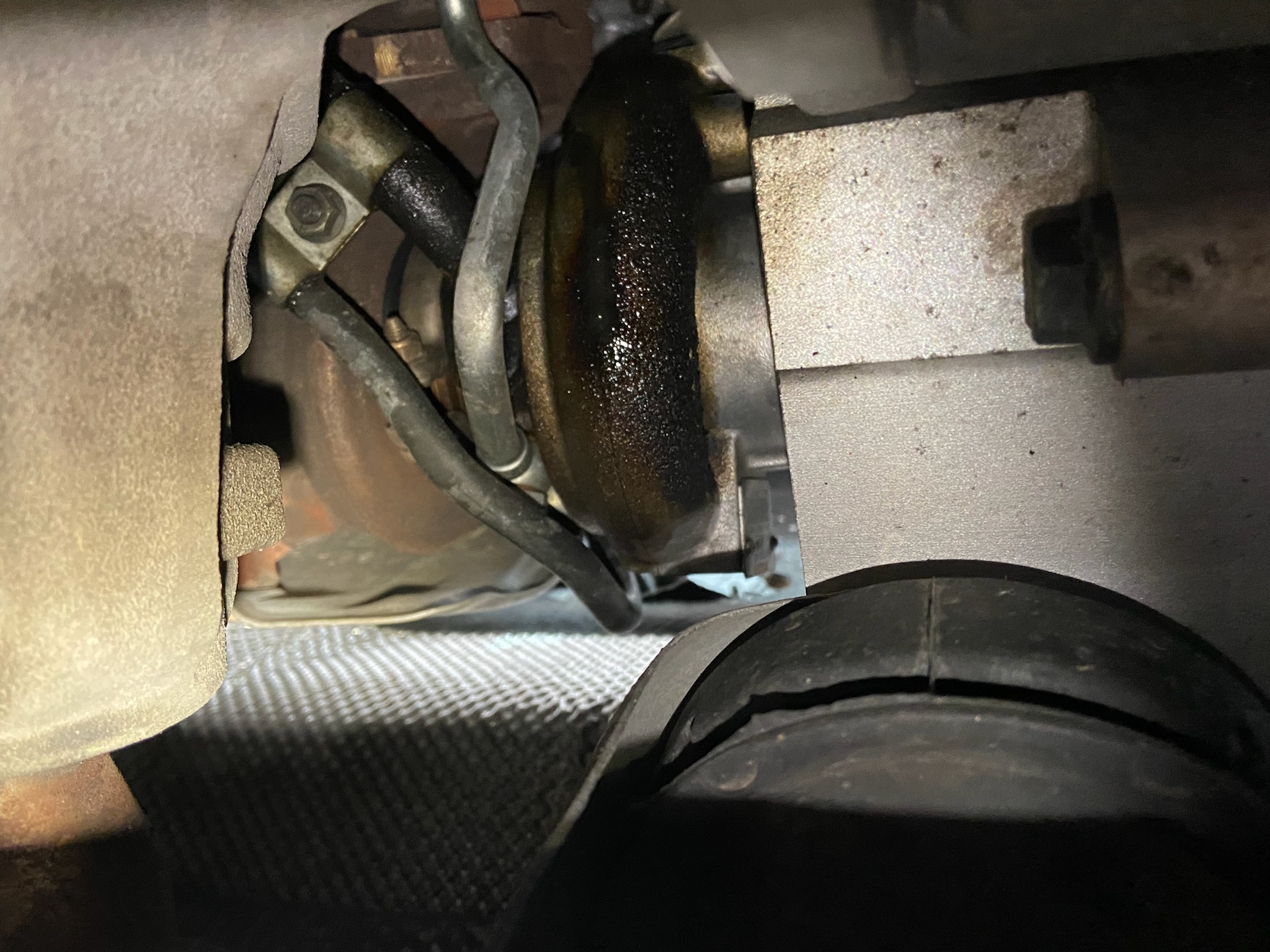

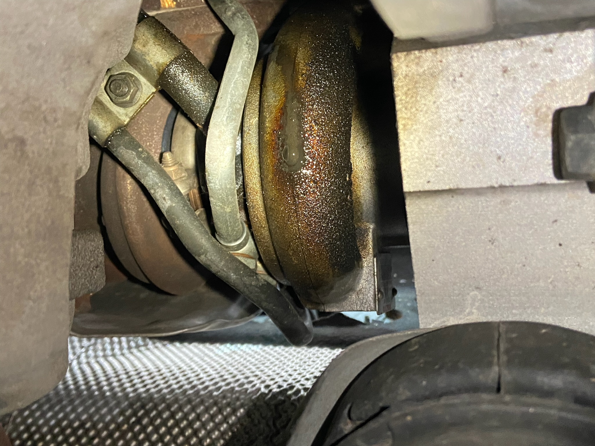

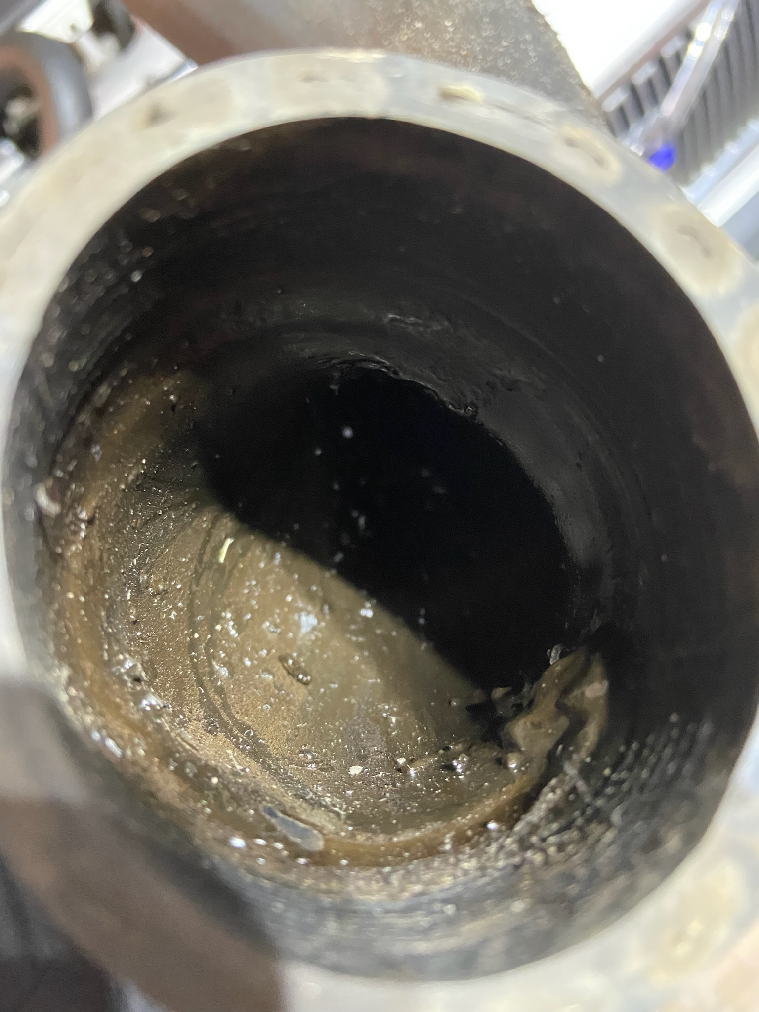

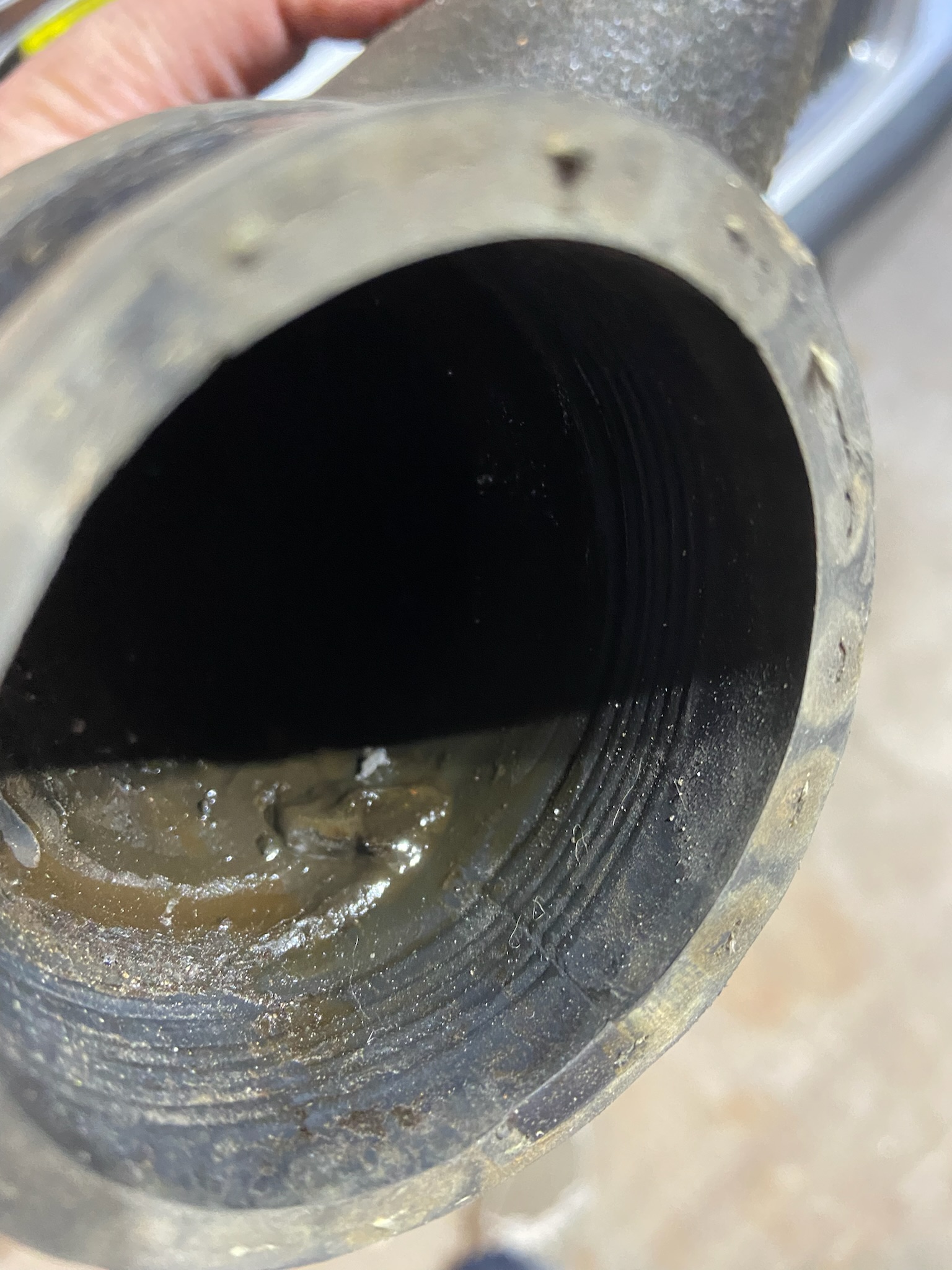

Like mentioned it’s a great condition ‘04 V70 2.5T AWD 132,XXX
Went to change a few hoses and take turbo out to change coolant seals/gaskets and found this:
I showed the condition of the turbo leak so you are seeing what I am. The slurry between the charge pipe and intercooler is all grease no metallic anything. Obviously you would think I am eating oil but NOPE!!
This hose is original and permeated horribly. These pic’s of slurry are shocking because this does not represent the condition of the engine/car….in no way would think it came from my engine!!!
I did not take turbo out because wanted to do research, if it’s failing soon and needs XYZ then I didn’t want to remove it twice. I did the glove test and there was negative pressure at idle(was rushed so didn’t bump throttle). Was planning on full PCV service in spring but can do now if needed.
I am the second owner, first owner was major car guy and this was his baby. I have exacting notes down to every wiper change.
Any thoughts would be appreciated.:-)

Not too bad, they're messy so..
Wipe it out , continue to use quality synthetic oil at proper intervals.
If you visit a salvage yard snag a decent pipe coupler for future use.

I replaced with new and I only use Schaeffer synthetic, I try for only the best(most of the time:-)
No codes on VIDA so I guess I’m just going to clean it all off and see where it leaks from and do the coolant gaskets next break in the weather.

My turbo looked similar to that, but never dripped on the splash pan. Last year I wiped the turbo off with carb cleaner and one oil change later, it stayed oil free.
