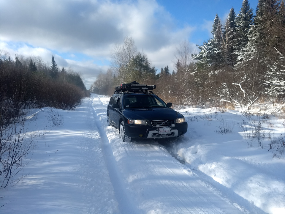

Post by vtl »
This is at XC70's max: plowed thorough about 10" of snow before it started to high-center way too often and make me beer-thirsty.
