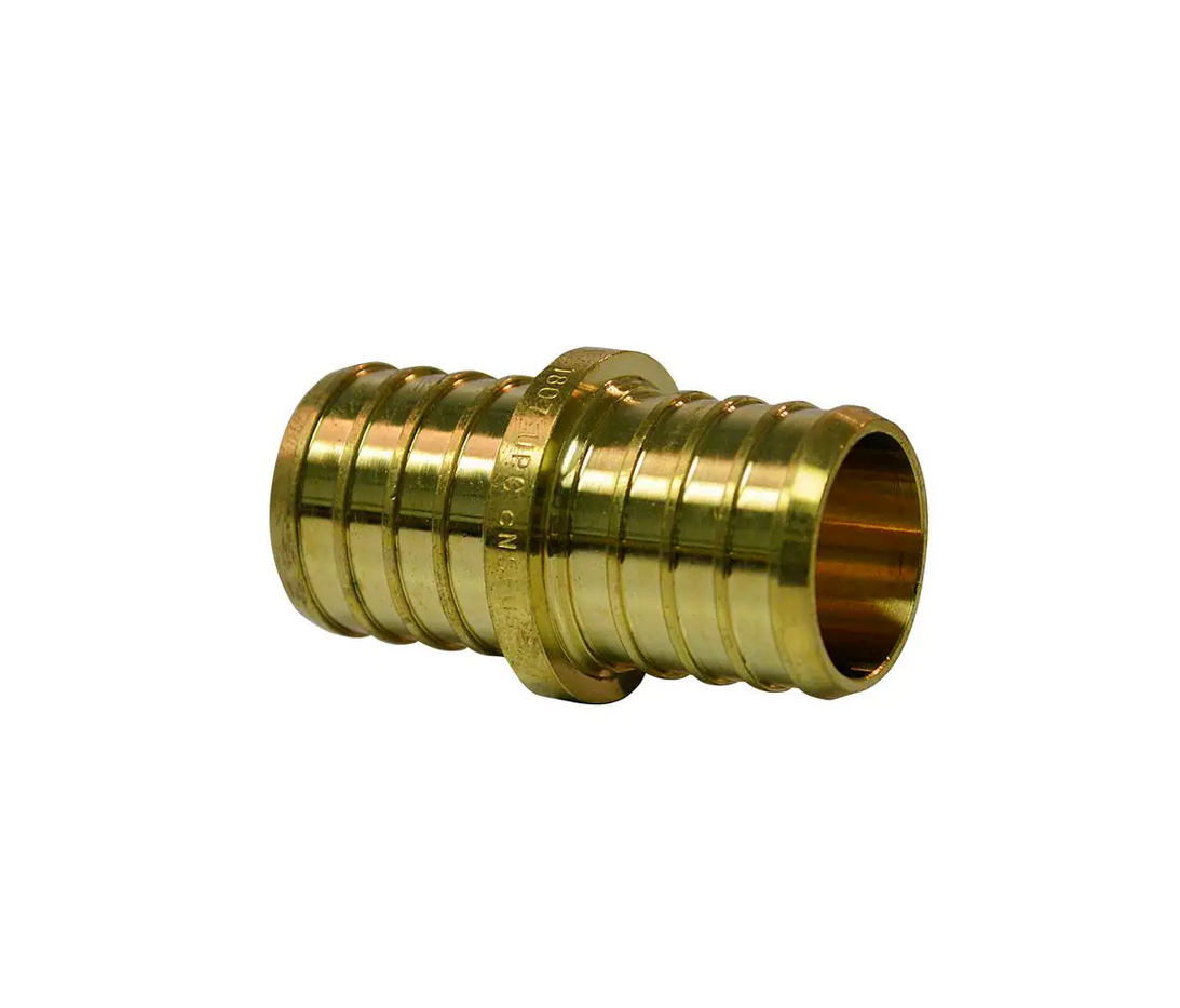

Before replacing however, go to the big box stores and get yourself a coupling and bypass the cooler. Weather is cool so no harm to the engine as the car will warm up quicker which is not a bad thing. Clean the coolant reservoir and see if the oil issues stops or dramatically lessons as there maybe some residue floating around.
https://www.homedepot.com/p/1-in-Brass- ... 92#overlay
Brass Barbed Coupling.png (452.39 KiB) Viewed 2760 times

Do you have the turbo or NA? Couldn't find info on oil cooler on IPD or FCP for NA. Can you confirm the oil cooler is in the rad or were you thinking trans fluid from rad leaking? Regardless, if you can bypass whether by rubber hose or barb coupling it will help with the troubleshooting.
