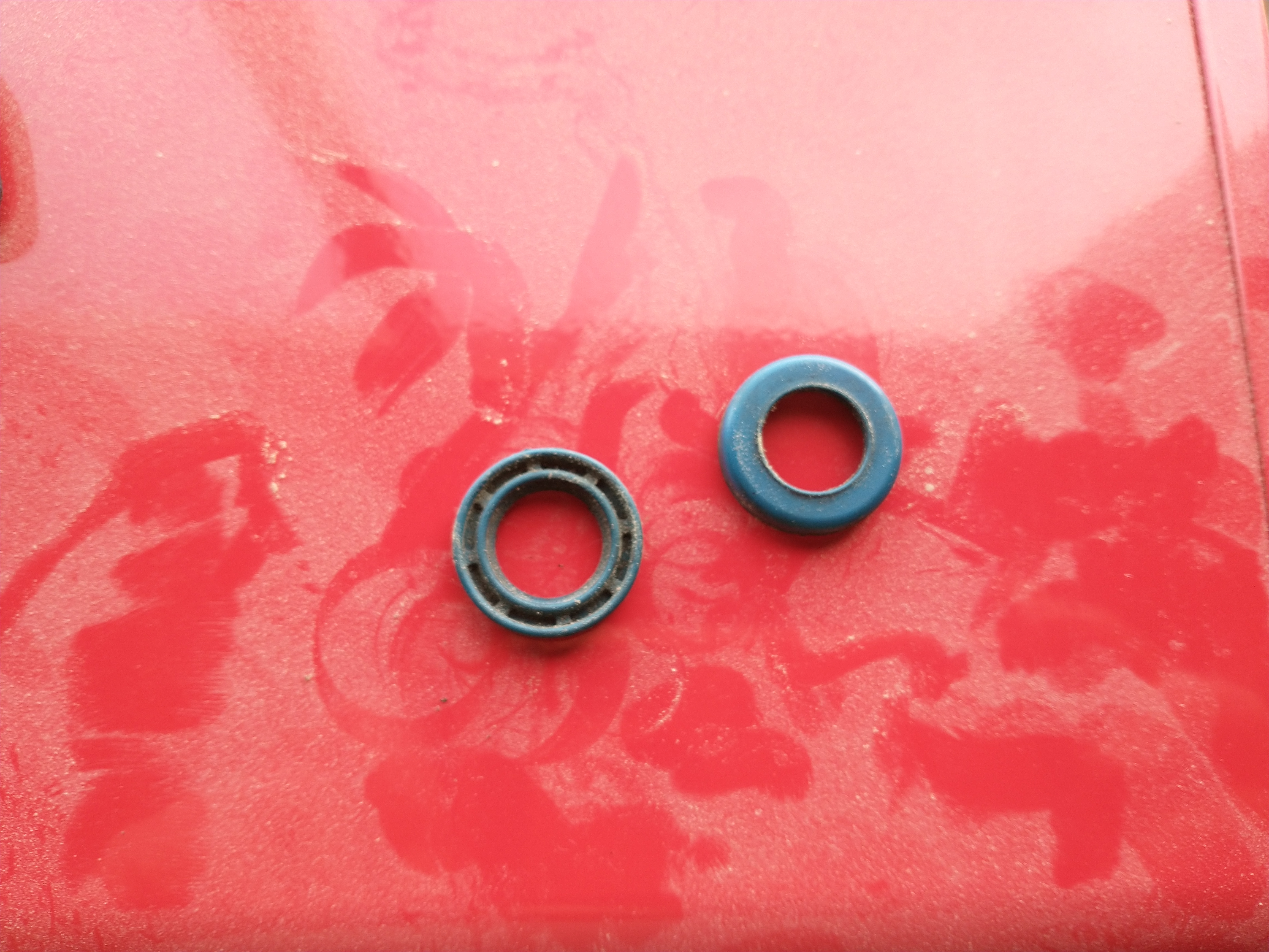

If your talking about these little gems, I could not find them new when I looked a couple of years ago.
Breaker / junkyard has them in every car, so I just grabbed a few.

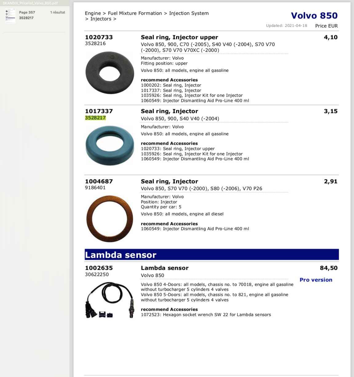

manovlov
Posts: 1180
Joined: 6 July 2011
Location: Grenoble, France
Has thanked: 620 times
Been thanked: 143 times
Post by manovlov »
I must be tired...
Capture d’écran 2022-04-11 à 21.45.44.jpg (66.29 KiB) Viewed 287 times
Capture d’écran 2022-04-11 à 21.48.36.jpg (339.24 KiB) Viewed 282 times
Available by Skandix

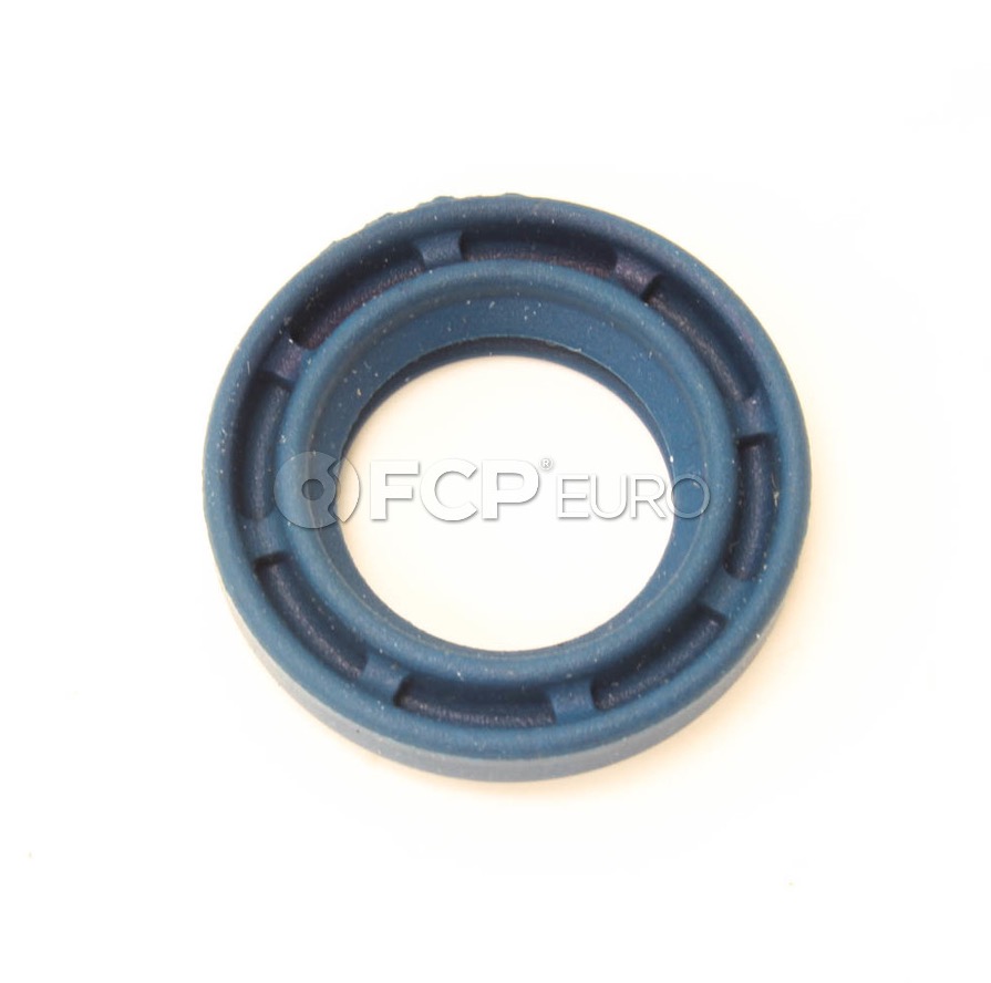

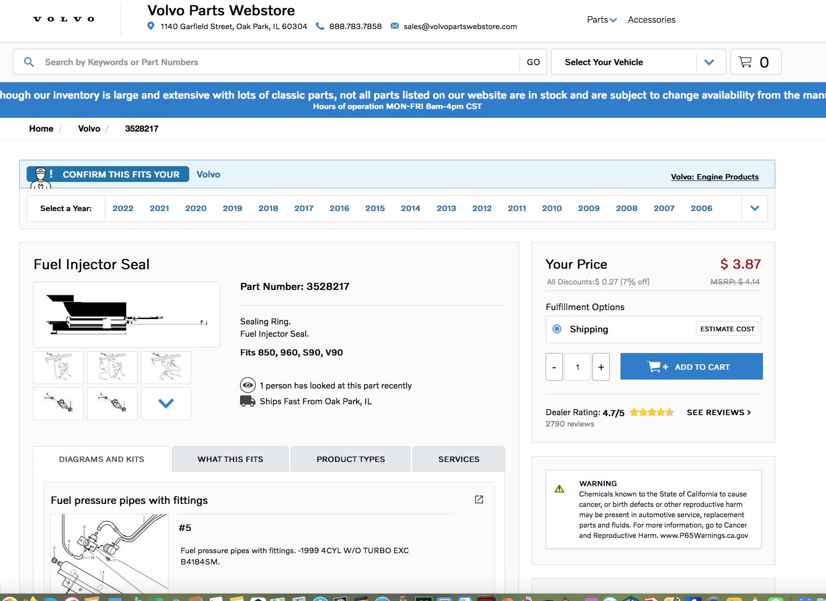

Capture d’écran 2022-04-11 à 21.49.53.jpg (207.85 KiB) Viewed 281 times
https://www.fcpeuro.com/products/volvo- ... -3528217oe

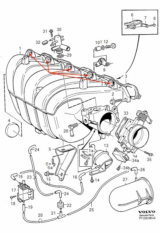

Post by misha »
Those are spacers which go in the fuel rail and then you put injector in...and there are few versions of those....also...some fuel rails didn't have them.
Injectors still have main o-ring seals(uppper & lower).
