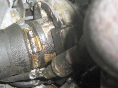

The front sensor helps the ECU (computer) control the air to fuel ratio and if it is bad the car may run too rich. The front O2 sensor on my 98 V70 AWD is a little hard to get to. Basically, you need to get under the car and find the catalytic converter, then follow the exhaust pipe forward to find the front sensor. It's below the turbo if you know where that is. I'm attaching a picture of mine.
front O2 sensor small2.jpg (22.56 KiB) Viewed 3029 times

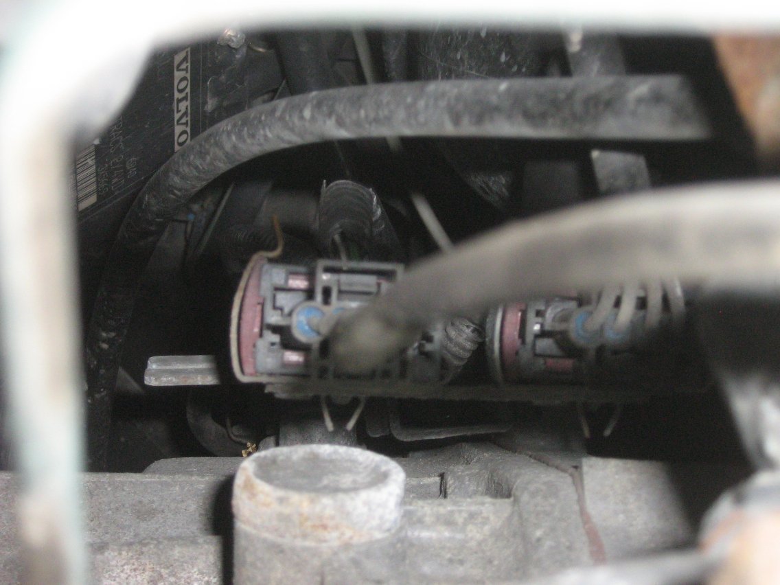

The big round thing at right is the exhaust pipe and the sensor is sticking our to the left. I suggest you go to Advance Auto or another parts store and buy a special O2 sensor socket-that will make easier to get the old one out. It's a tight space and it's hard to get a regular wrench in there. Also, another tricky part is getting the electrical connector loose. Another picture. As I recall, the connector is easier to reach from above in the engine compartment. As I recall, you need to pull the black part away from the red part. Once the red part is pulled out a little, it will free up the connector male part from female part. If this is incorrect, maybe someone else can comment. Hope this helps.
O2 sensor connector small.jpg (123.34 KiB) Viewed 3030 times
