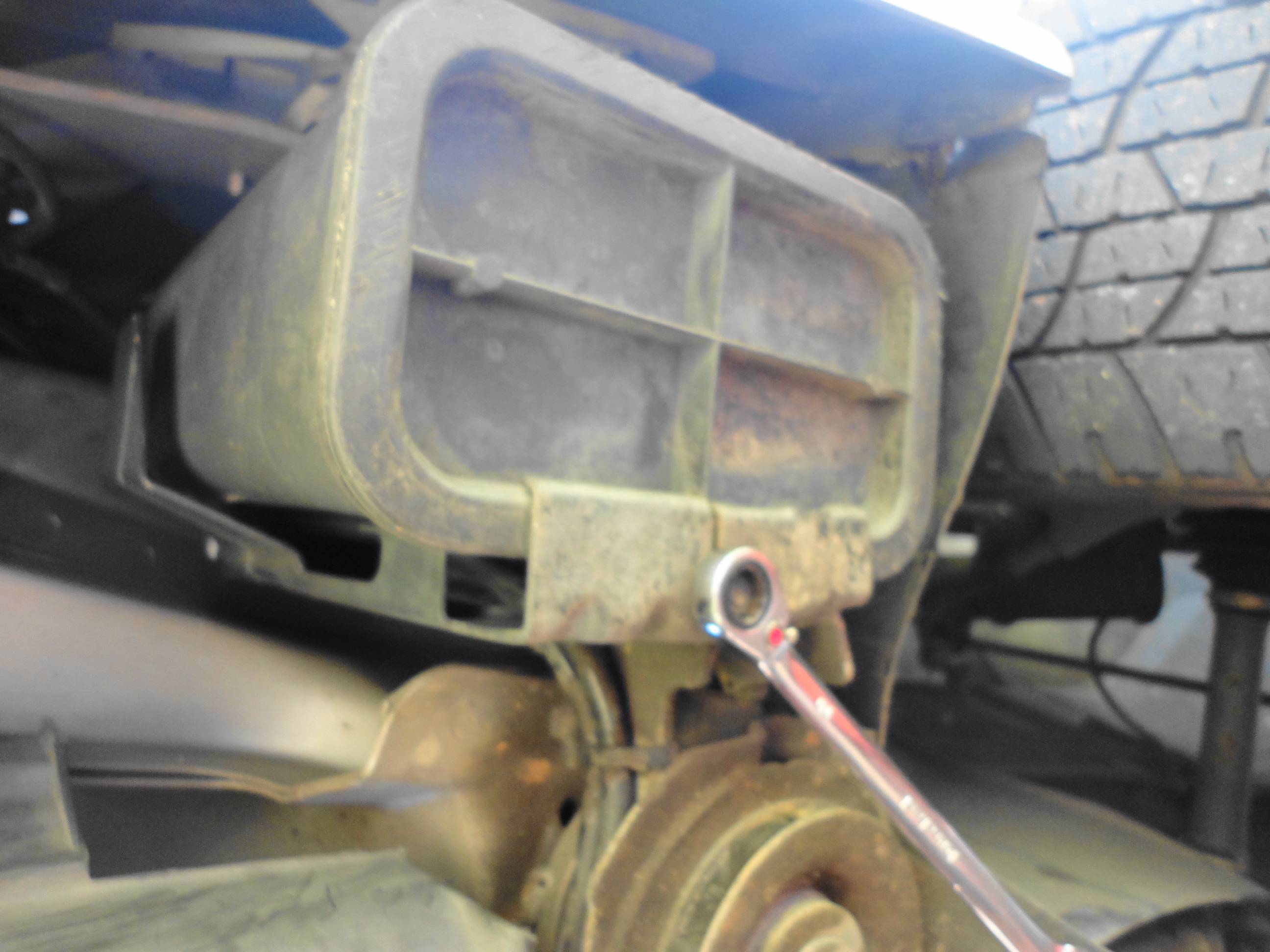

1) I started with the Evap Canister (to the left of the front driver's wheel when looking at the car head on). Use a 10mm wrench to remove the small bolt at the bottom of the canister and drop the canister down. Some folks have talked about removing the fender skirt to gain access, but I didn't find that necessary.

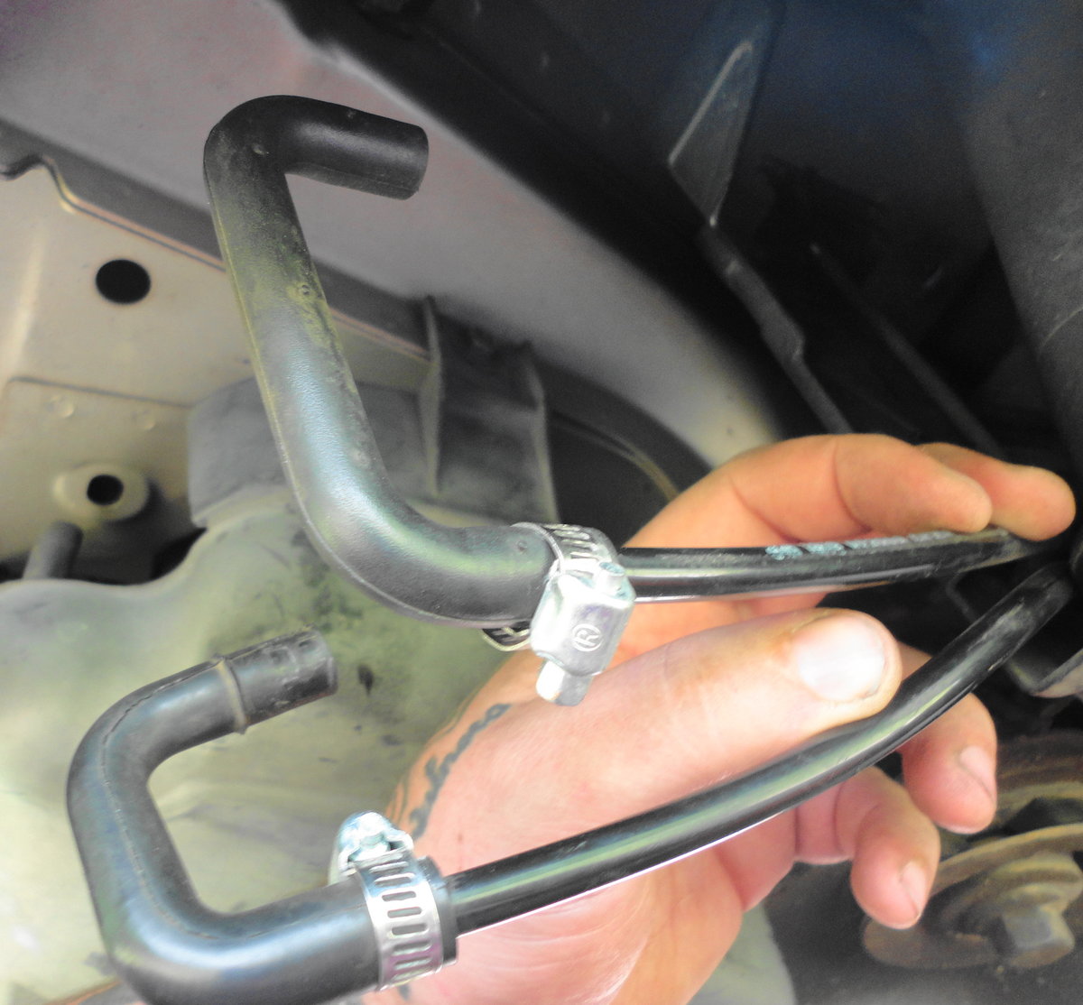

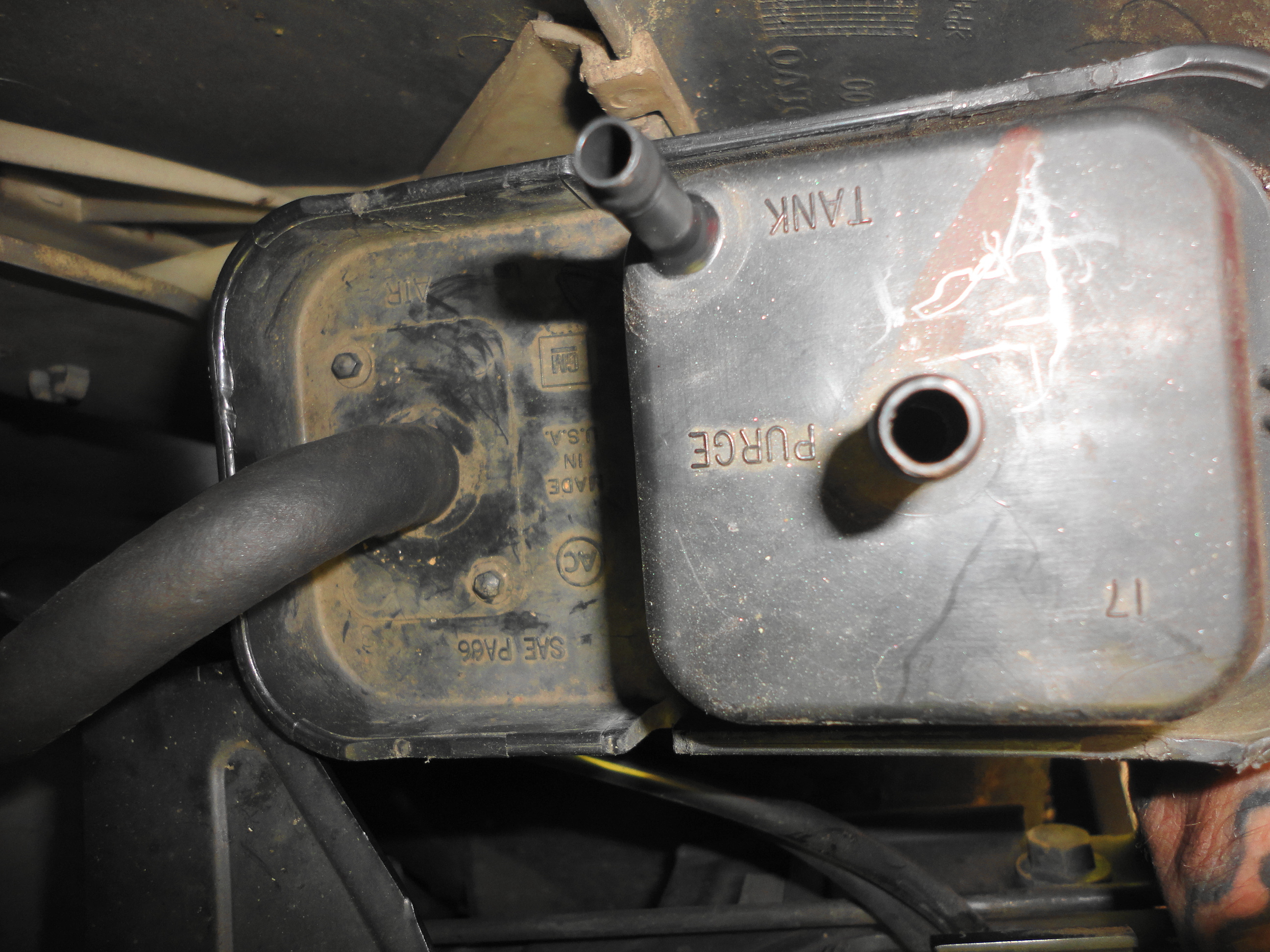

3) I used two molded molded U hoses and hose clamps to connect the lines coming from the tank and the purge valve (hoses #16 and #4).

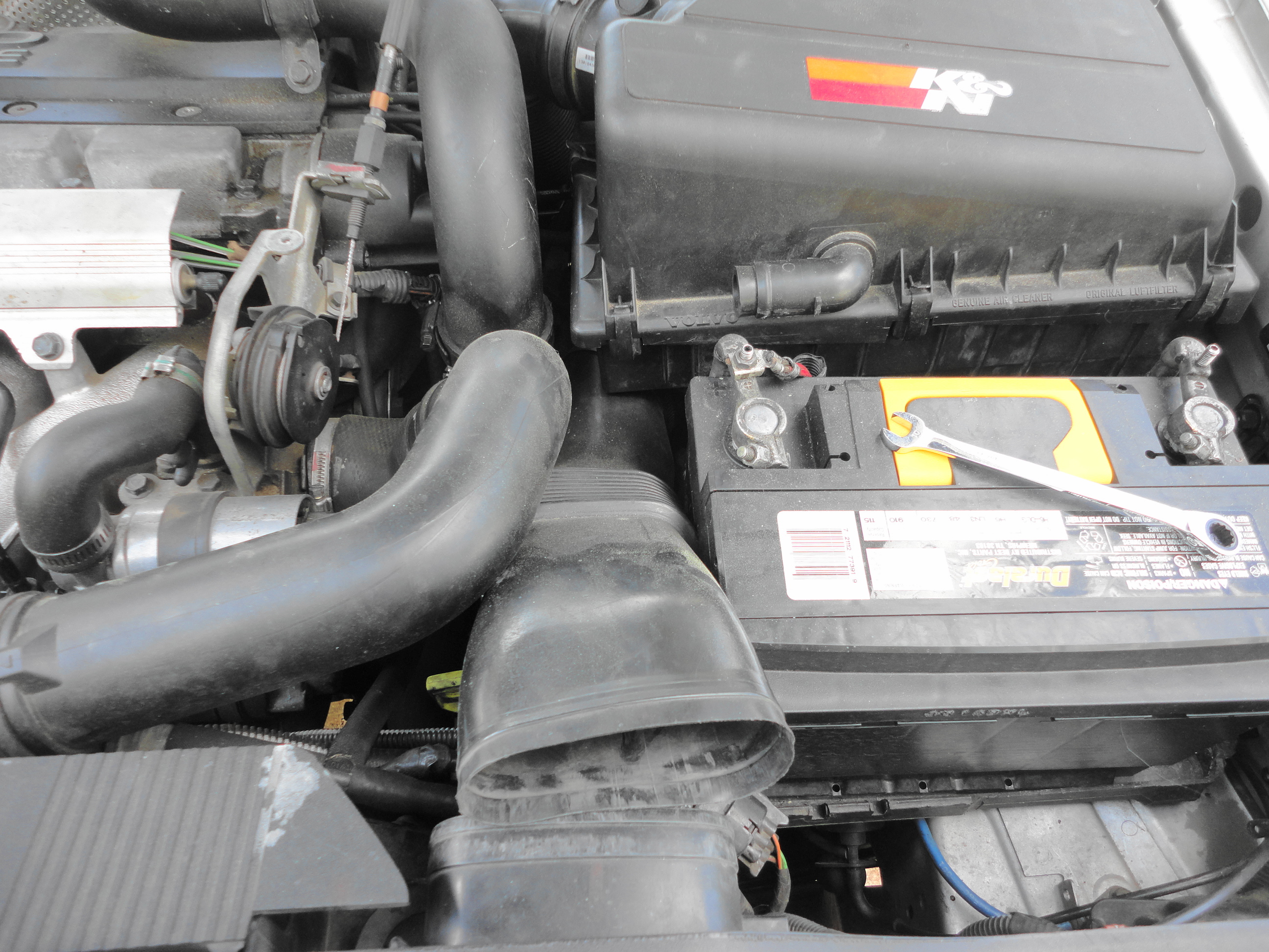

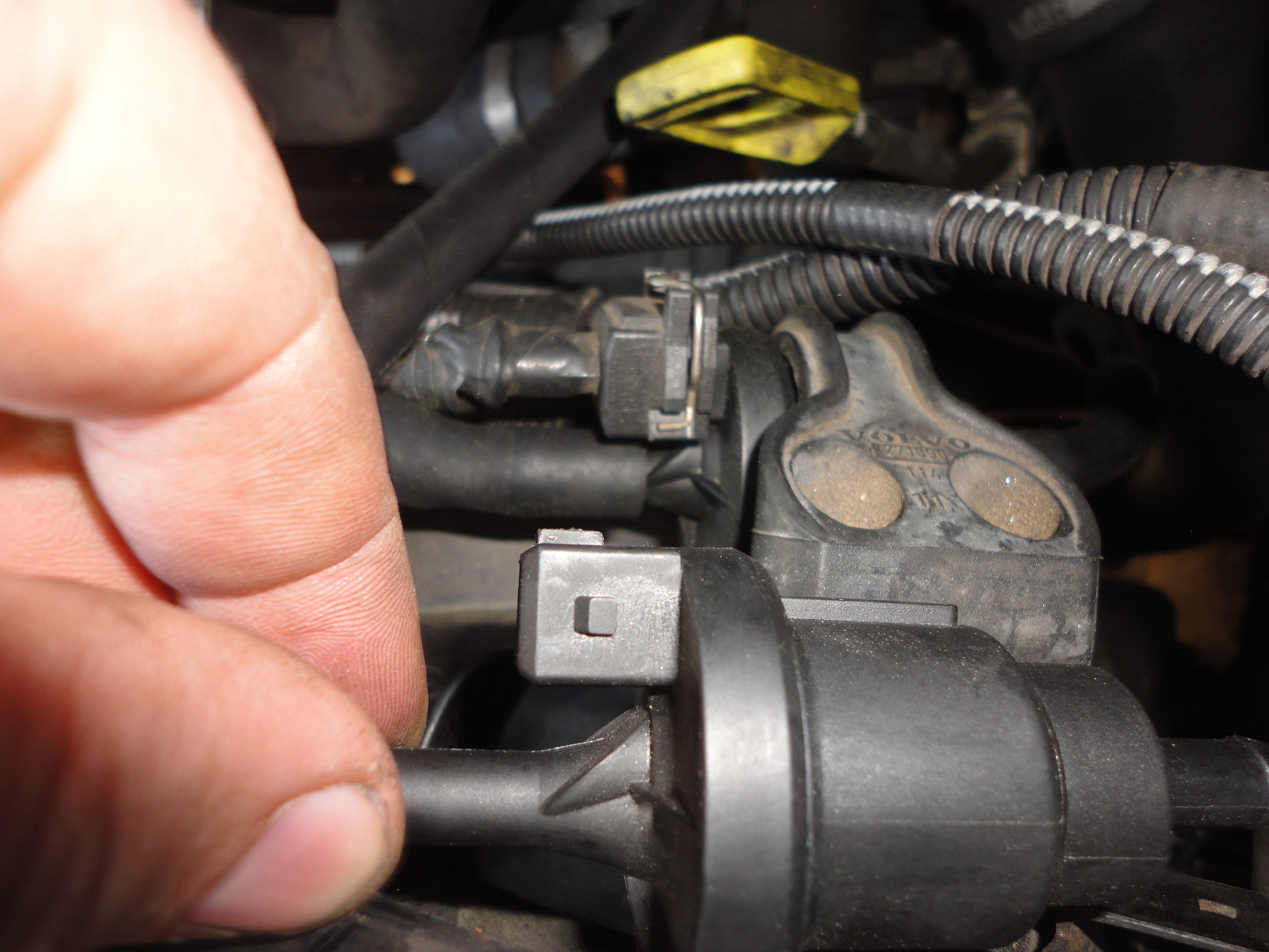

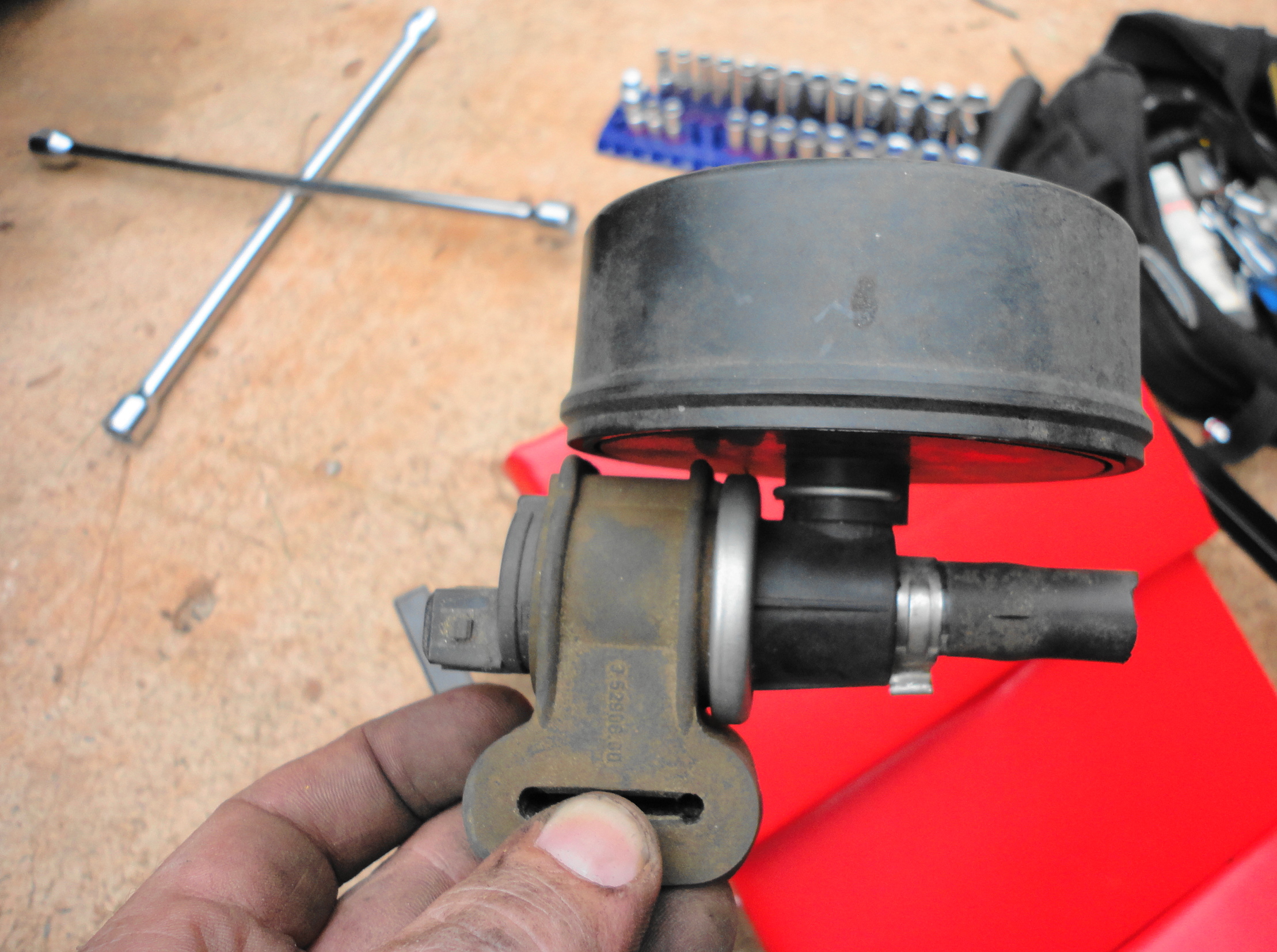

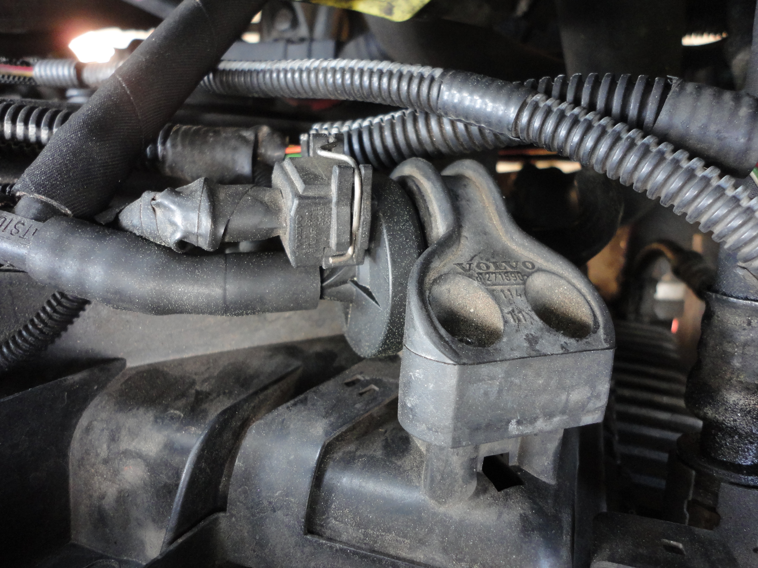

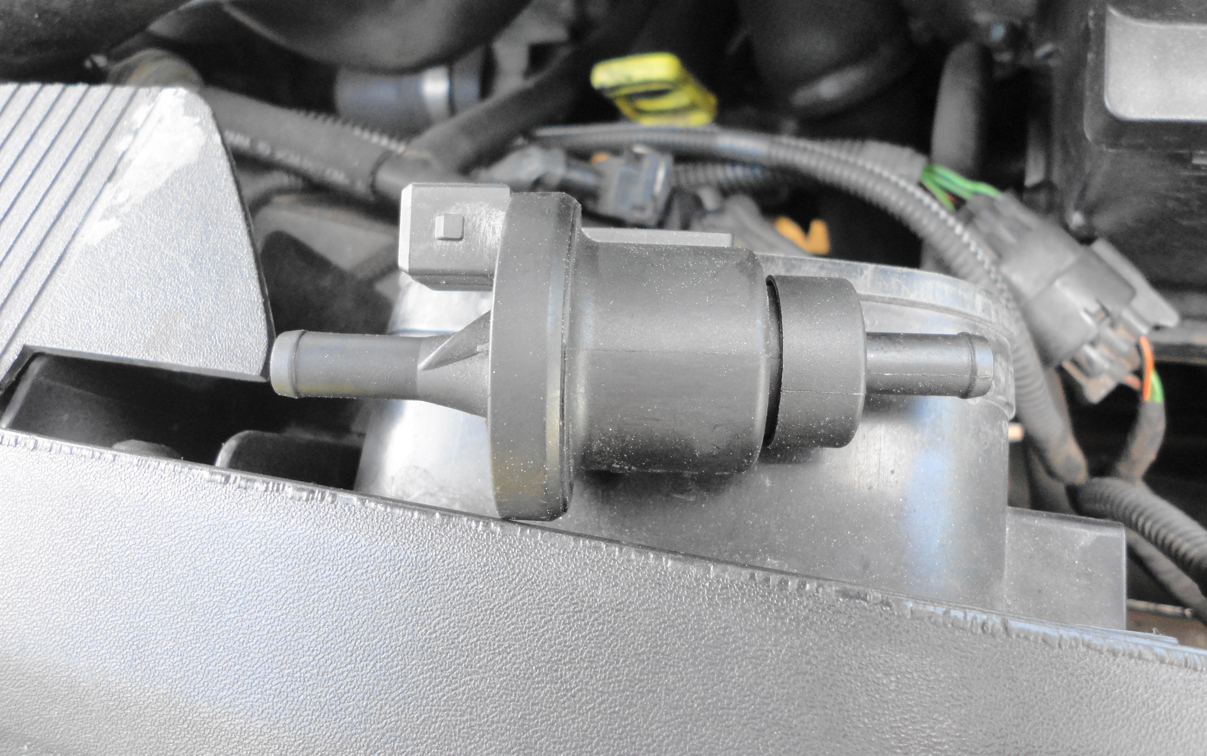

4) Next, I followed the purge line up to the purge valve (checking the integrity of the hard plastic line) and swapped it out as well ($39 part number 911-800 from AZ). The purge valve (#11) is directly behind radiator under air duct (see photos).

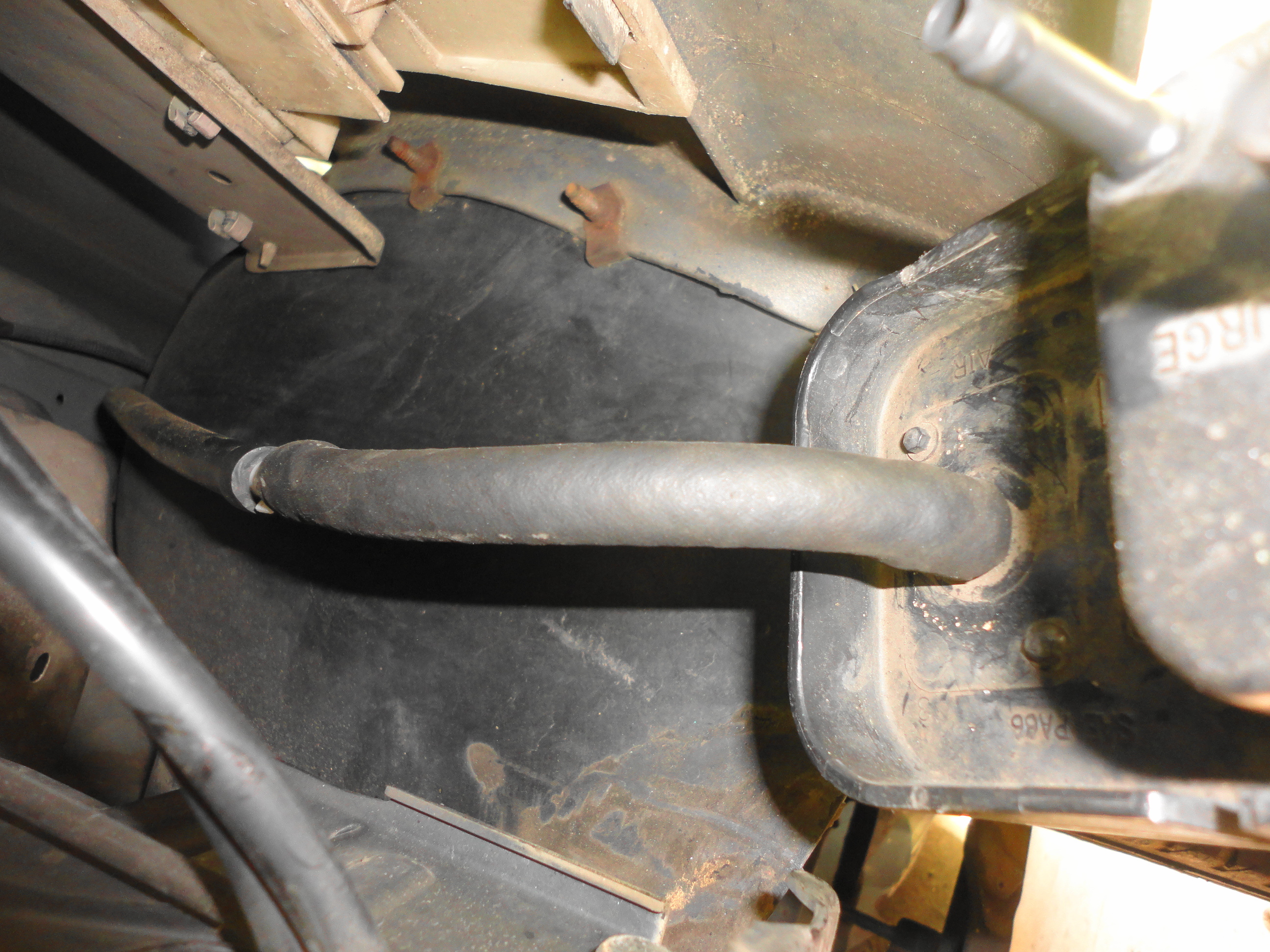

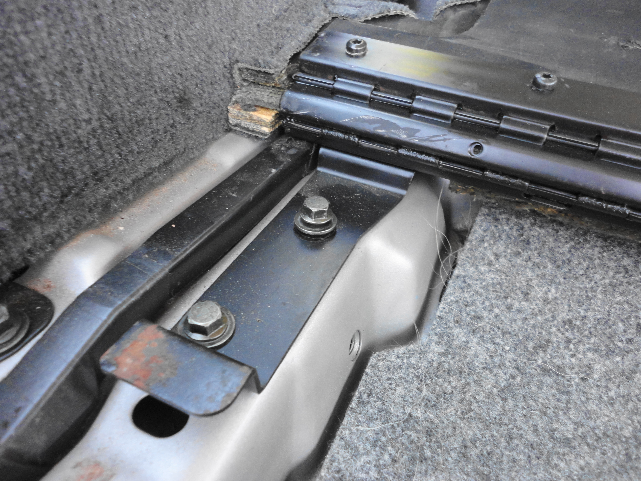

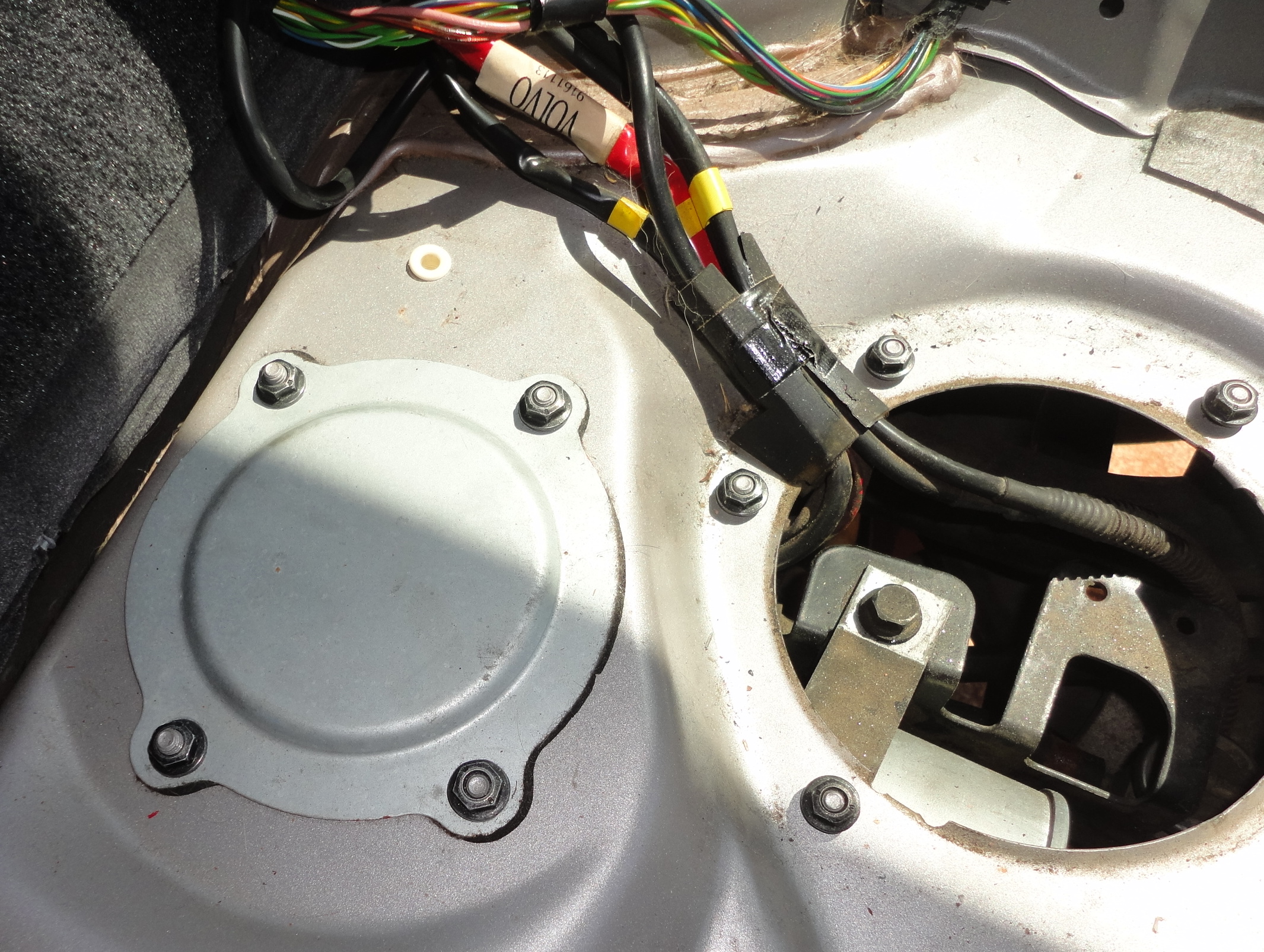

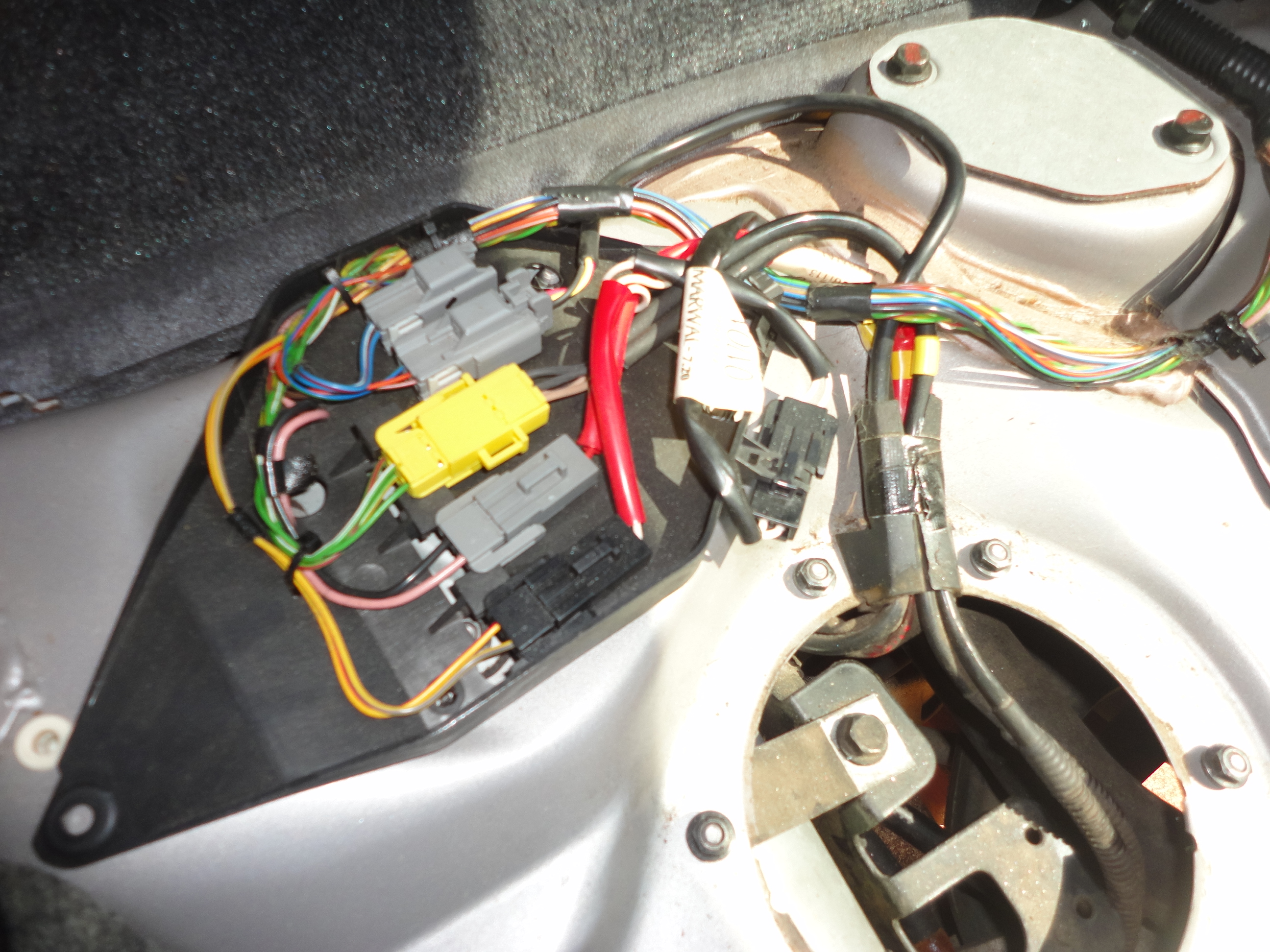

5) Next, I removed the carpeted rear doors (10mm bolts) that hide the spare tire, removed the carpet, and gained access to the fuel line/filter access panels. One of the panels is underneath the wiring harness (held on by two plastic retaining clips). Remove the retaining clips and flip wiring harness out of the way.

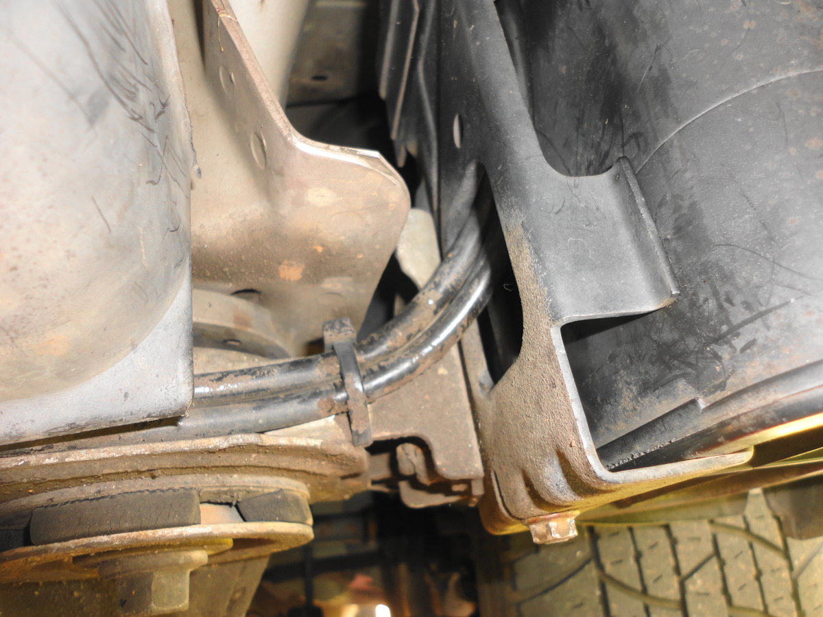

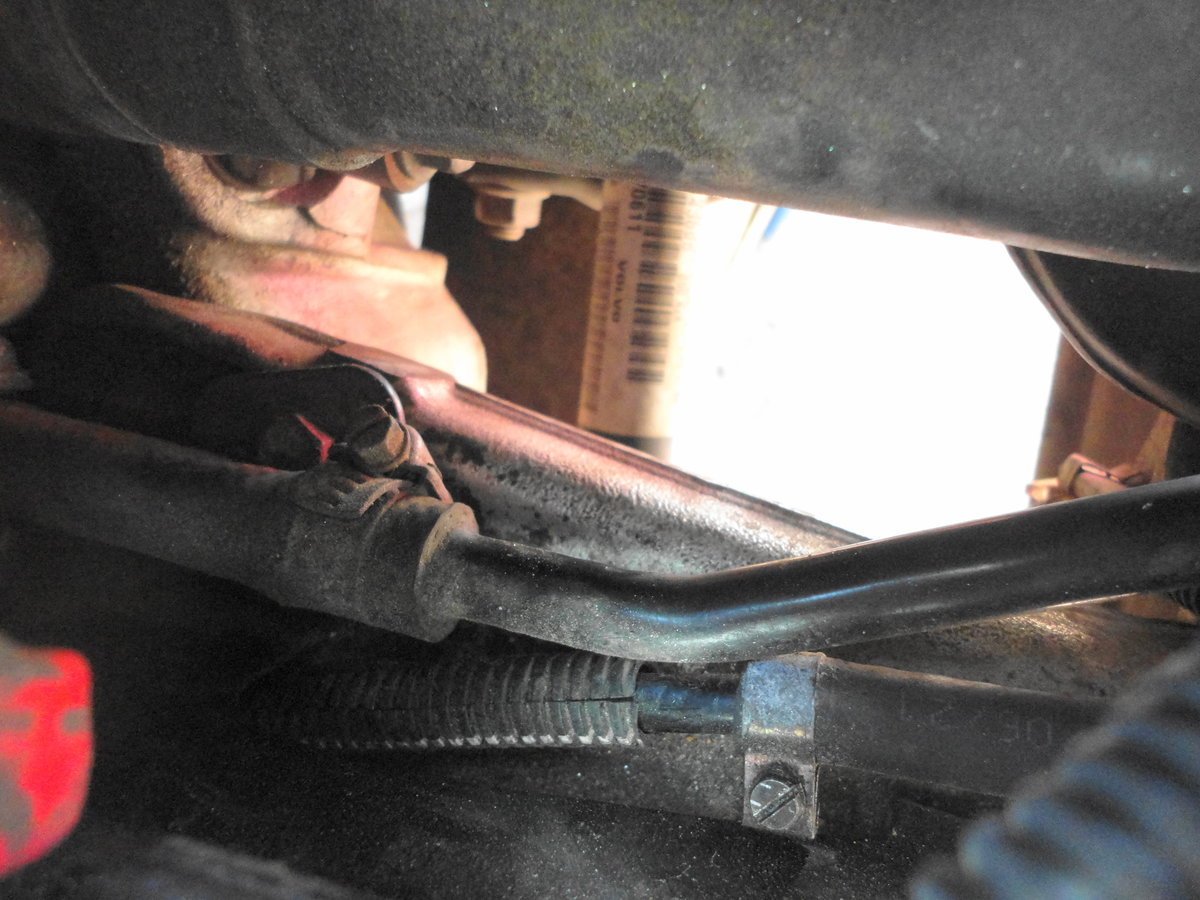

6) It is necessary to remove both access panels in order to gain access to the small piece of rubber tubing that connects the small metal vent filler tube to the plastic vent line from the top of the fuel tank (This 3" hose was a PITA to replace).

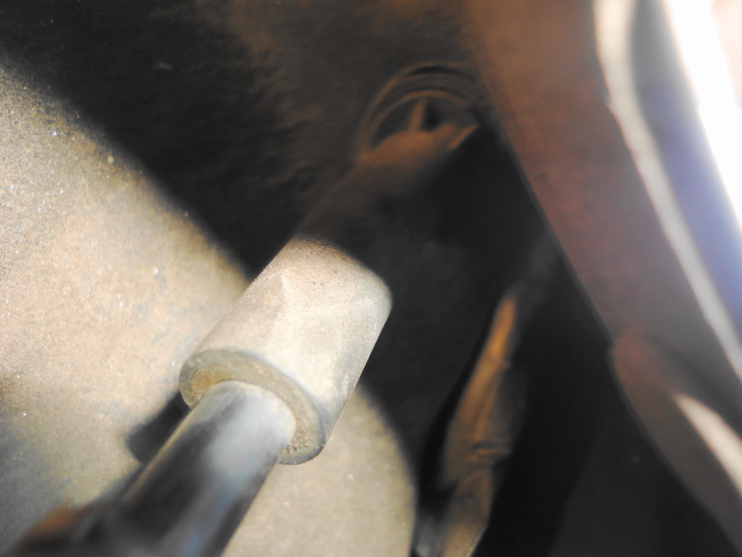

Where fuel filler vent tube enters fuel tank.  Very difficult to gain access.

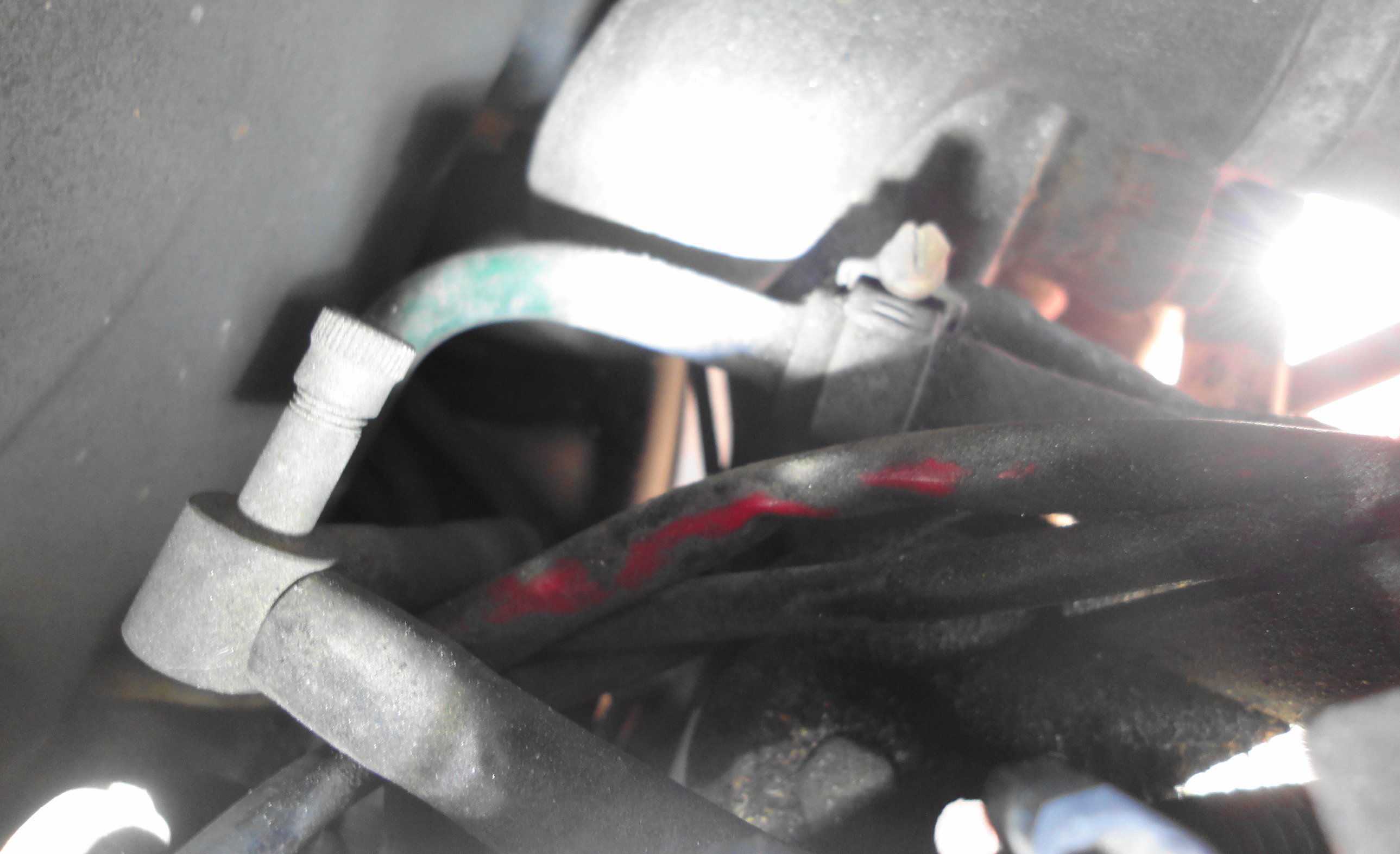

Other end of the three inch rubber hose joining vent filler tube to fuel tank line (in green).
Three inch rubber hose connecting filler vent tube with fuel tank.

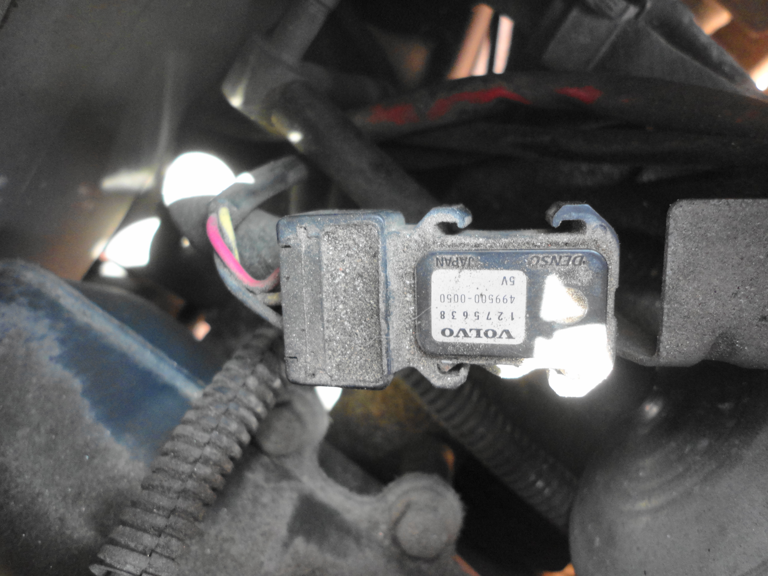

Underneath harness access door is some sort of pressure sensor held on by one 12mm bolt.  I removed this and put it out of way to gain access.
Wiring harness out of the way exposing 2nd access panel.
Second access panel is under wiring harness (held in place by plastic clips at either side).
Two 10mm bolts on each side need to come off to remove wooden trunk lid.  This is necessary to get to the second access panel.
New purge valve installed.
New purge valve next to old (still in place).
Purge valve.
Purge valve.
Purge valve is located underneath air duct.
Two lines going to canister.  The top one was my purge.  The bottom went to the rollover valve.
New U hoses and clamps.
My fix for the large hose.  Power steering line and a $2 plastic inline connector.
Top of canister.
Top of canister.
Removing canister is one 10mm bolt.

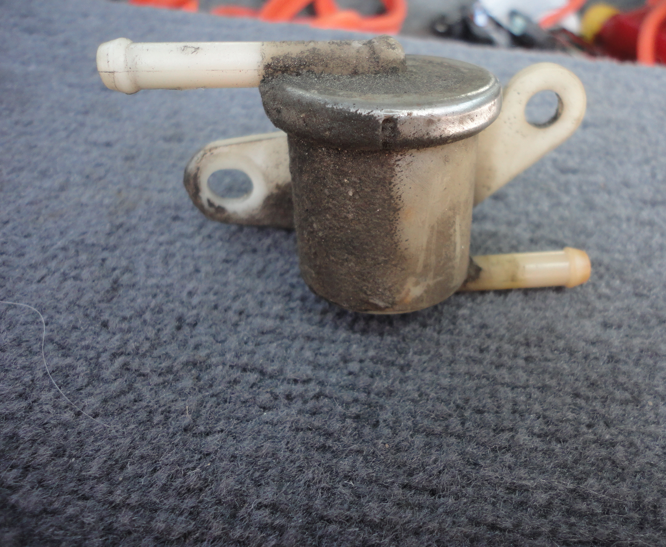

To clarify, here's how I think the system works. Please feel free to correct me if I'm wrong. :)

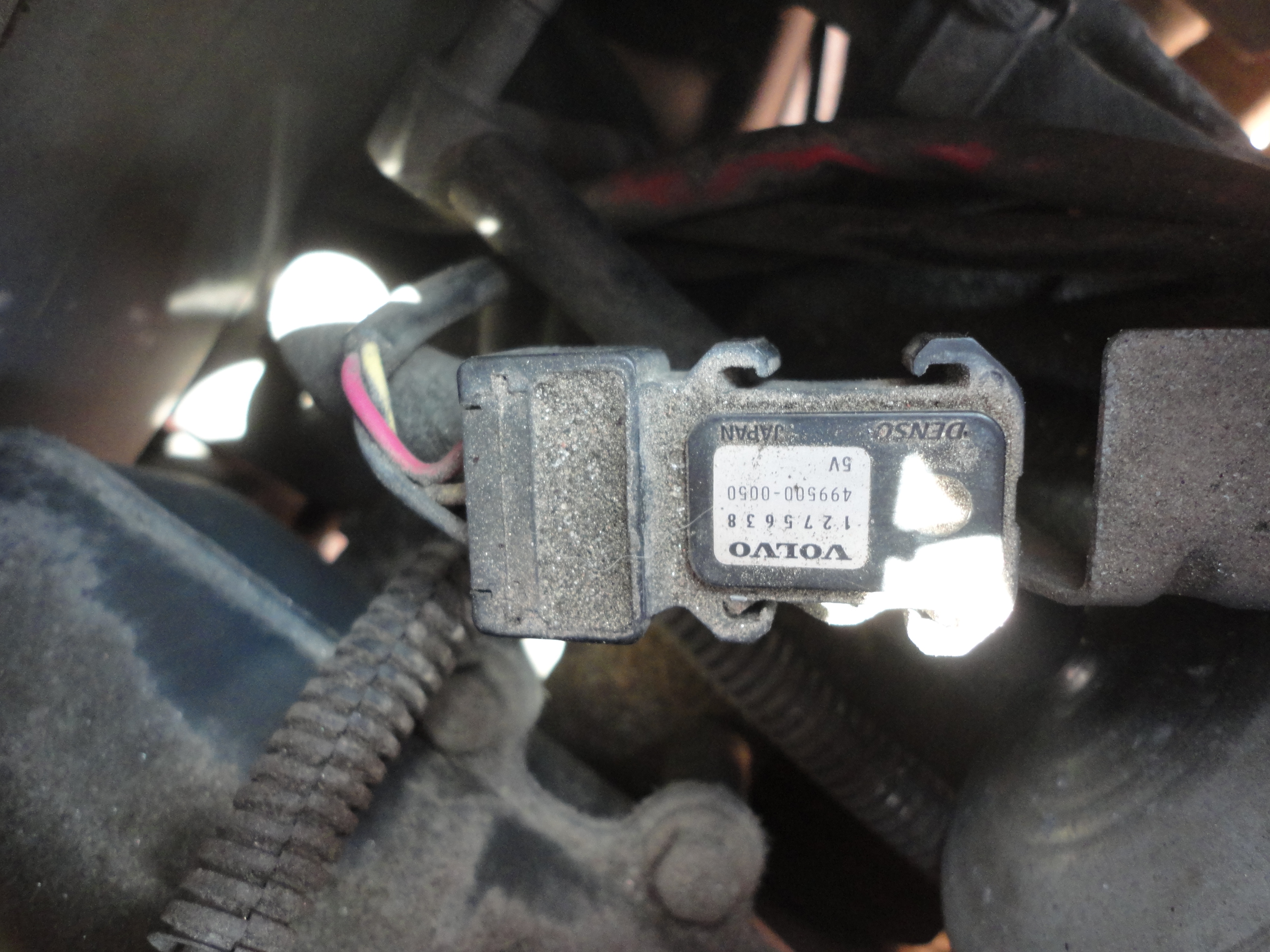

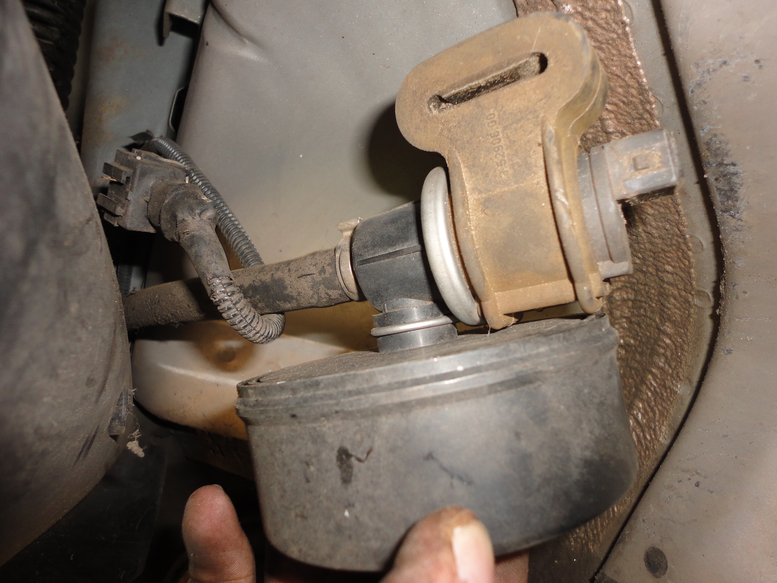

There are two solenoids in the system. One controls the fuel vapors (purge valve) and the other is used for venting the canister (shut-off valve). There is also a fuel pressure sensor (I took a photo of this in my write-up) at the fuel tank.
The purge solenoid has two lines (and an electrical connector) attached: one to intake manifold and the second to EVAP canister. The electrical connections go to ignition switch and the other is grounded through the ECU. When the ECU grounds, it opens the valve allowing vacuum draw from EVAP system.

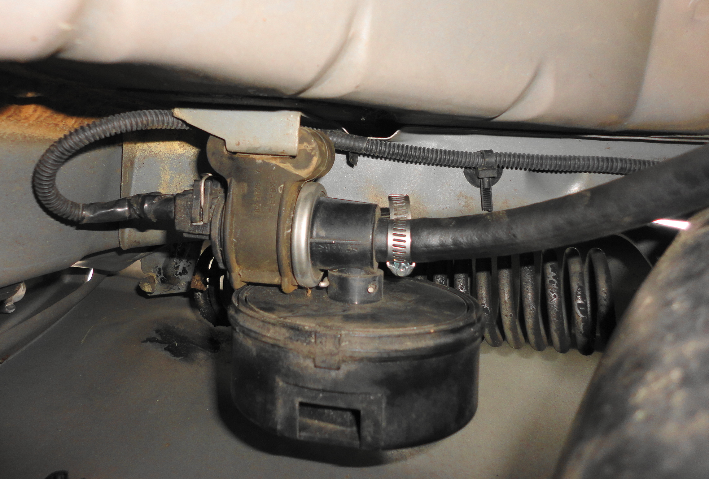

The second solenoid (the shut-off) is usually open. The ECU tests for leaks by closing off this “shut-off” valve (which seals the system) and can then test for leaks via the purge solenoid and the fuel pressure sensor.
Once the shut off solenoid is closed, the purge valve opens and allows the vacuum to draw air from evap. The ECU then receives info from the fuel pressure sensor and compares it to spec values to determine if there’s a difference (aka “a leak”).
There are many circumstances and hoses that can throw the various codes (P0455, P0442, P0440, etc). Some of those I documented in my write-up, the other involve the sensors and solenoids not doing their respective jobs.
Photos of purge valve (#11 above), shut-off valve (#18 in above diagram), and fuel pressure sensor (not shown in diagram but located under second access panel by fuel tank).
Fuel Pressure Sensor
Shut-Off Valve
Shut-Off Valve
Purge Valve
Purge Valve

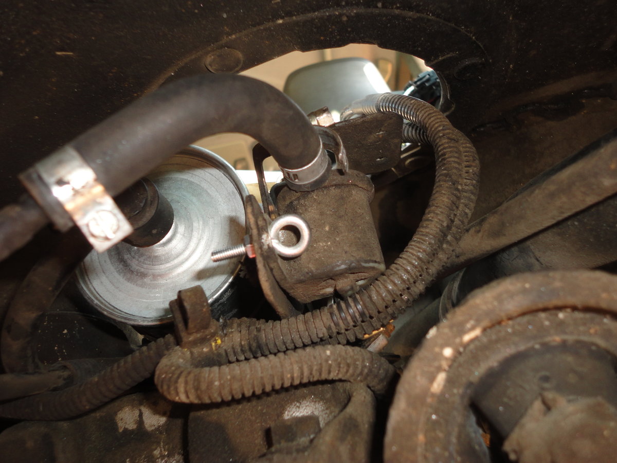

Post by deepsouth »

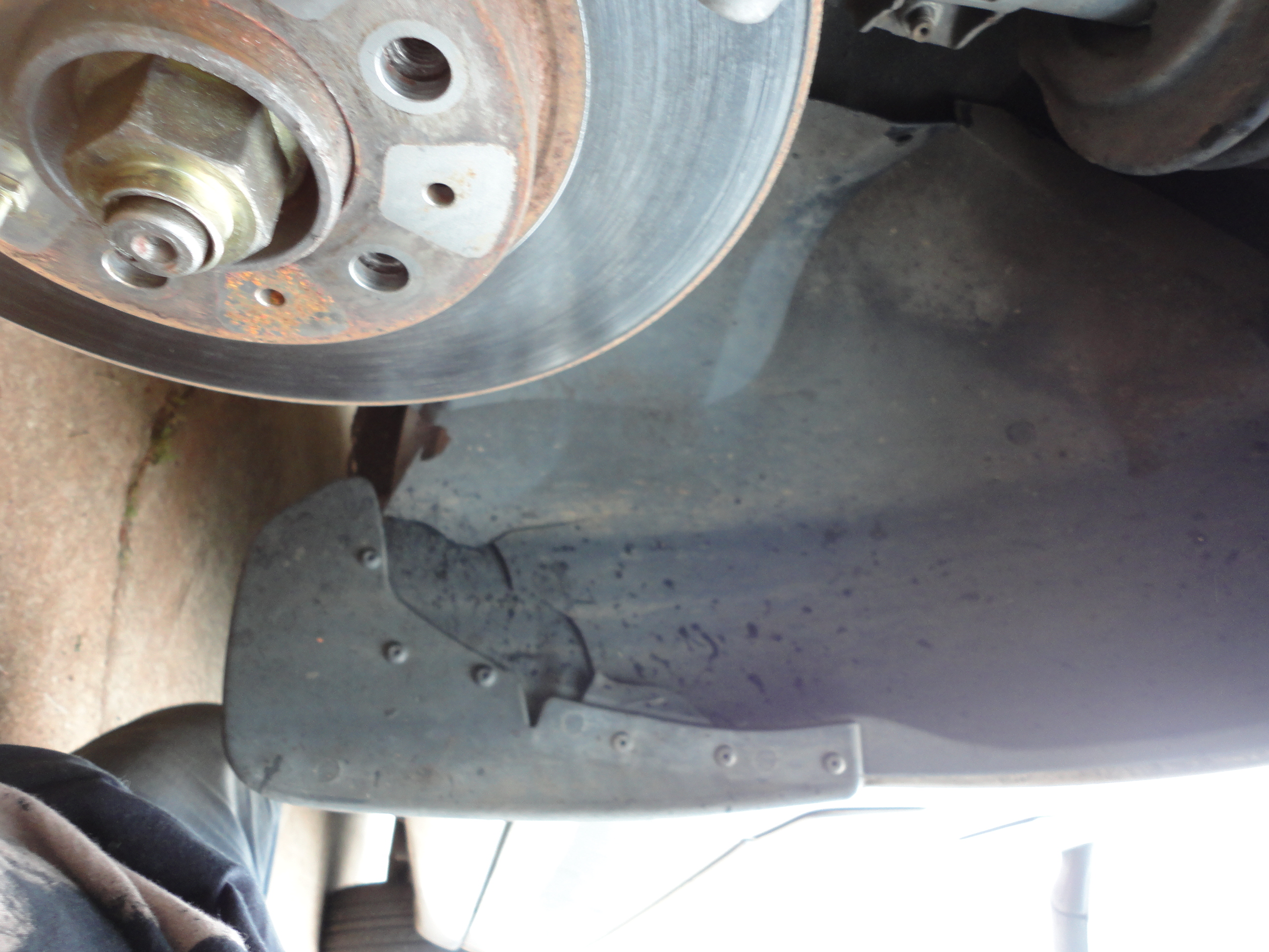

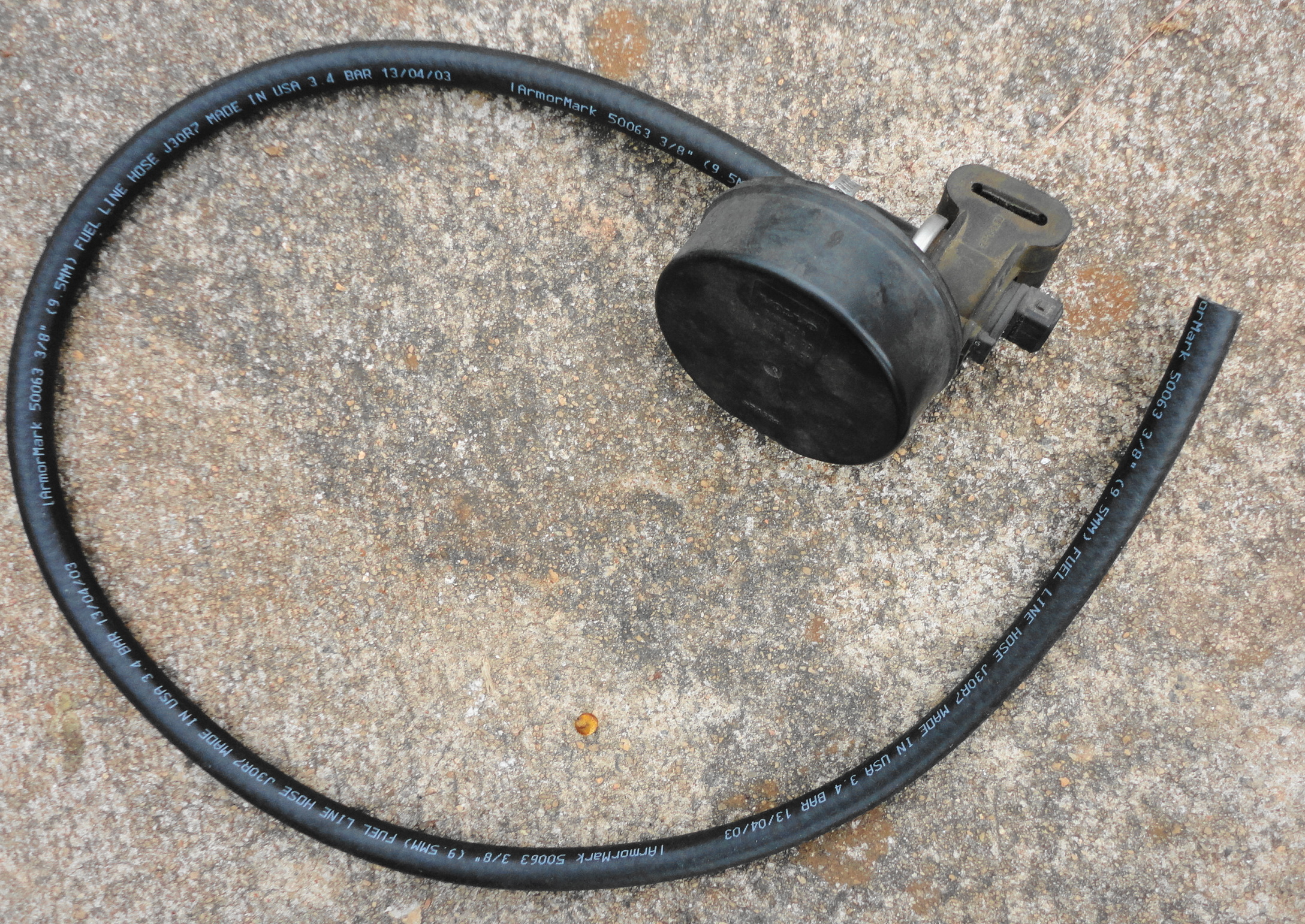

Should have included this in the original write-up so I went ahead and also replaced the hose from the "air" portion of the EVAP canister to the shutoff valve (hose #20 in diagram to valve #18). Used 3/8 heater hose from AZ. To gain access on the V70 it's necessary to remove the bolts and bend back the driver's side fender skirt. Used 3' of hose to run from the shut-off valve over the wheel well and plug into the "air" portion of the canister. Total time around 30 minutes. With the above, this completes the hoses in the EVAP system.
Eric
Old hose replaced with 3/8 fuel injection hose and clamp.
Shut-off valve with three feet of 3/8 hose to run over the wheel well to the "air" side of canister.
Shut-off valve off of car.

Peel back the fender skirt and there she is!
Removed wheel to gain access to rear of fender skirt.  Shut-off valve is behind this.
