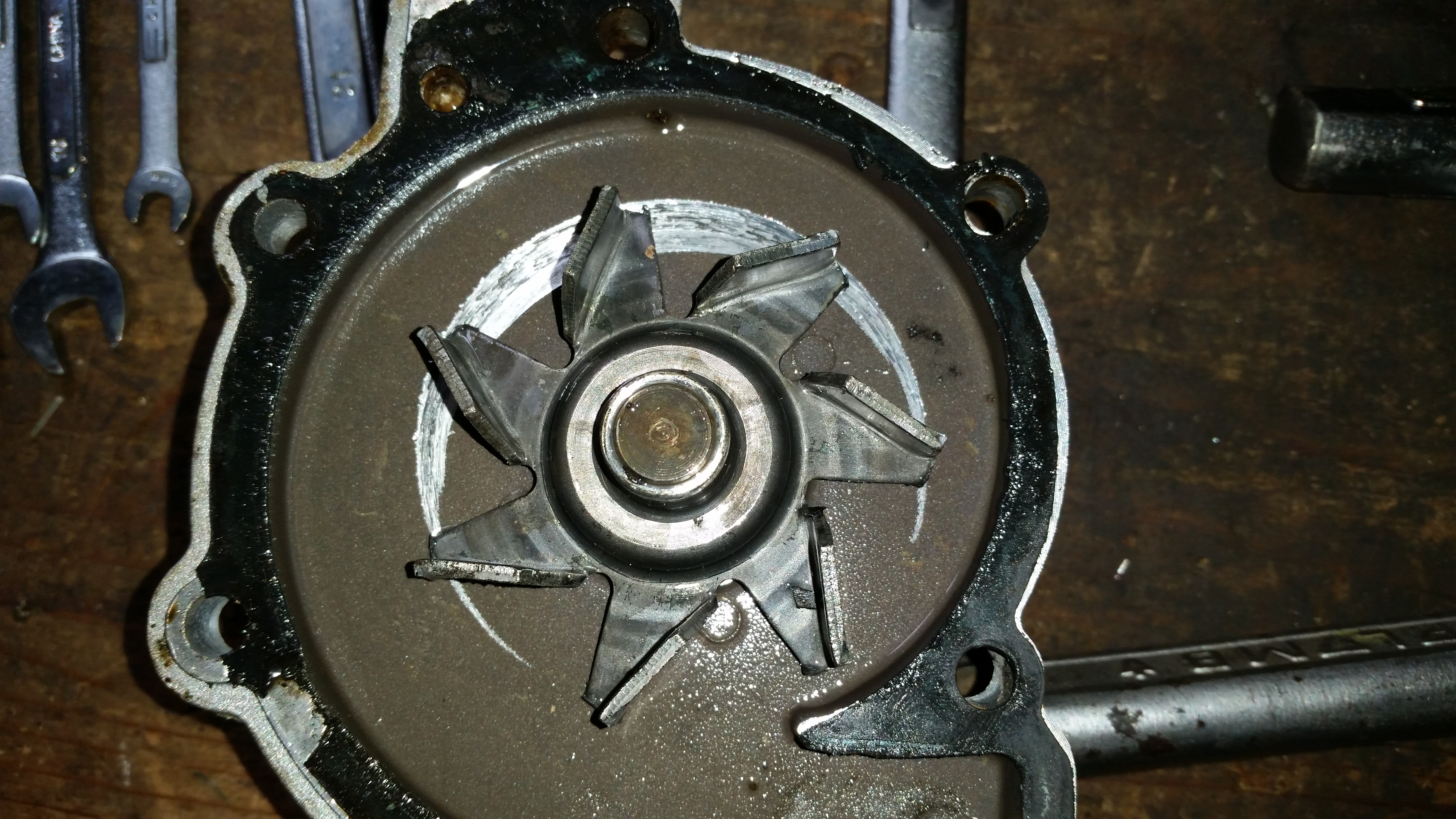

I have the water pump out. It looks like the bushing blew up and allowed the shaft to tip a bit. The blades gouged into the pump housing, got wedged, and sheared some teeth off of the timing belt. If I shake the water pump, it rattles - pieces of the bushing are still in the housing.
I'm of the mind that the bushing/bearing was packed with grease, and that grease ended up in my coolant. It also flung out all around the inside of my timing belt cover.
I'm unable to locate the invoice, so I don't know who makes it - it was 4 years ago and we've moved since then. The water pump doesn't have any identifying brand on it. On the housing, it says '1D6P', and on the end of the shaft it says "12 12 4 WR".
Bummer...we feel your pain. It is indeed heart-wrenching to hear this happen to another old car.
Beware that either TB tensioner or idler pulley can wear, allowing the TB to slide off. I caught mine before this happened thank God. You can search through my back posts for the photos. It was an INA bearing too. OEM. It was Tango Uniform before 70,000mi.
Might be a good idea to do at least a yearly inspection by removing the TB cover and having a look with a bright light.
