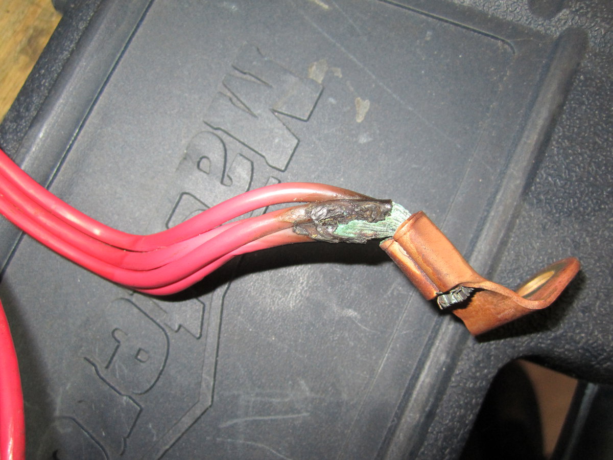

That's still a lot of voltage drop, 0.5 volts?

Yeah, that's what I thought. I'll bet that the battery and B+ cables get plenty warm after a short drive-- mine did with a substantially smaller voltage drop. I'd replace them and clean all the grounds at the same time.

Take the cover off the main kidney shaped fuse box in front of the brake booster. Look at the brass colored nut at the front of that attached to the 'B+" cable. If it is not bright and shiny then it is failing. This issues affects 99/00 models most. When I removed mine it had totally melted and could easily have shorted to ground. When that happens the worst case is the car will light up!
After replacing the car started more easily and didn't crank as hard.
