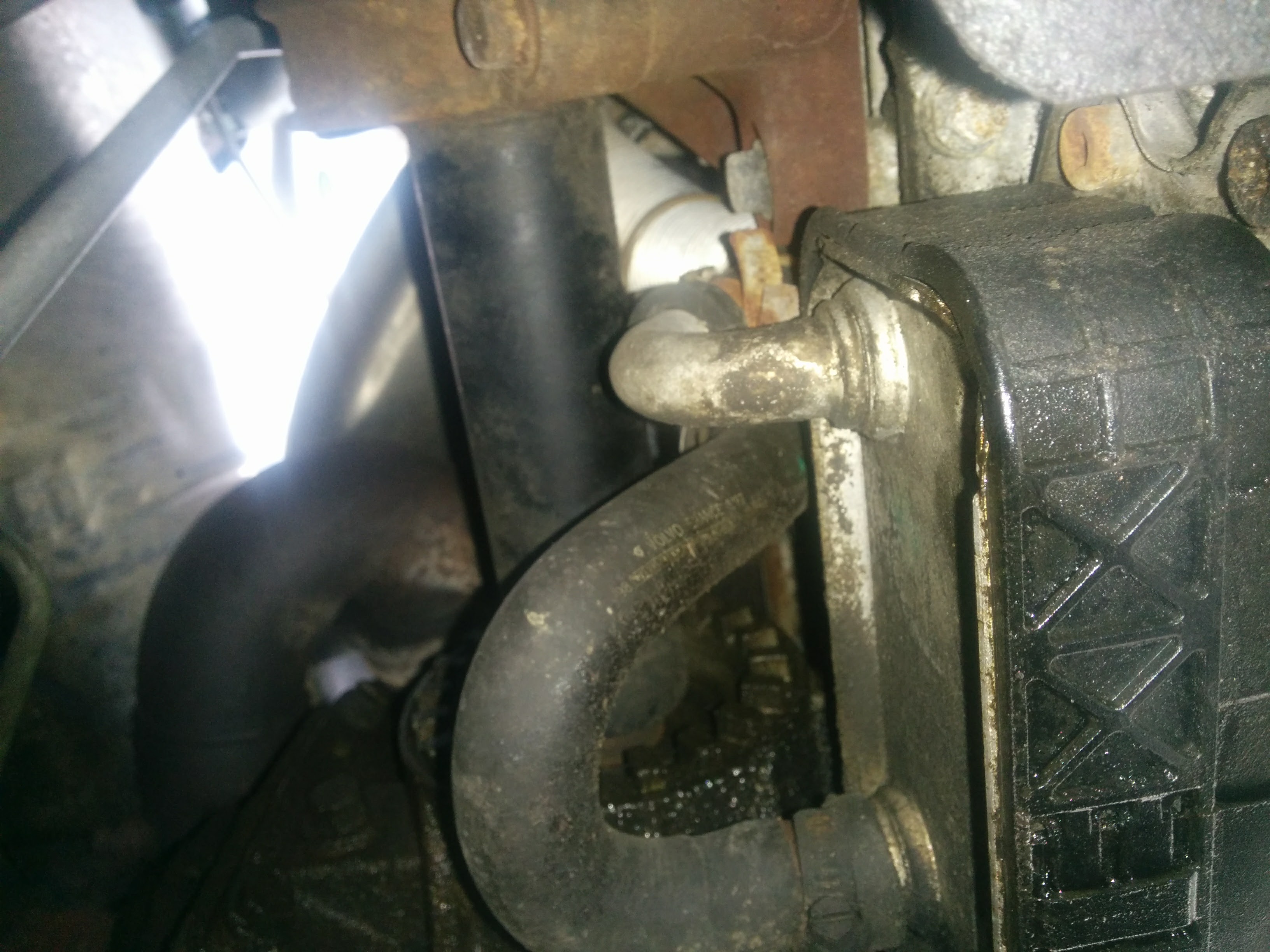

So I'm calling this solved. I noticed they cleaned up the sliders rather well and re-lubed - it hasn't dragged since. VIDA confirmed my seat of the pants findings as the pad temps stayed about even on both sides. Previously I went from both sides sticking, to just the drivers. When just the drivers was sticking there was a 45-65c increase on that side over the side that wasn't sticking while the brakes weren't applied hitting normal highway speeds.
I still wish to check and potentially order parts for the seal on the side of what I'll call the transfer case that has a little leak... I don't believe it to be an oil cooler leak as I've driven close to 2k miles on the current oil fill without losing a drop. Believe it could be gear oil, but I haven't stuck my finger in and tried the sniff test.
