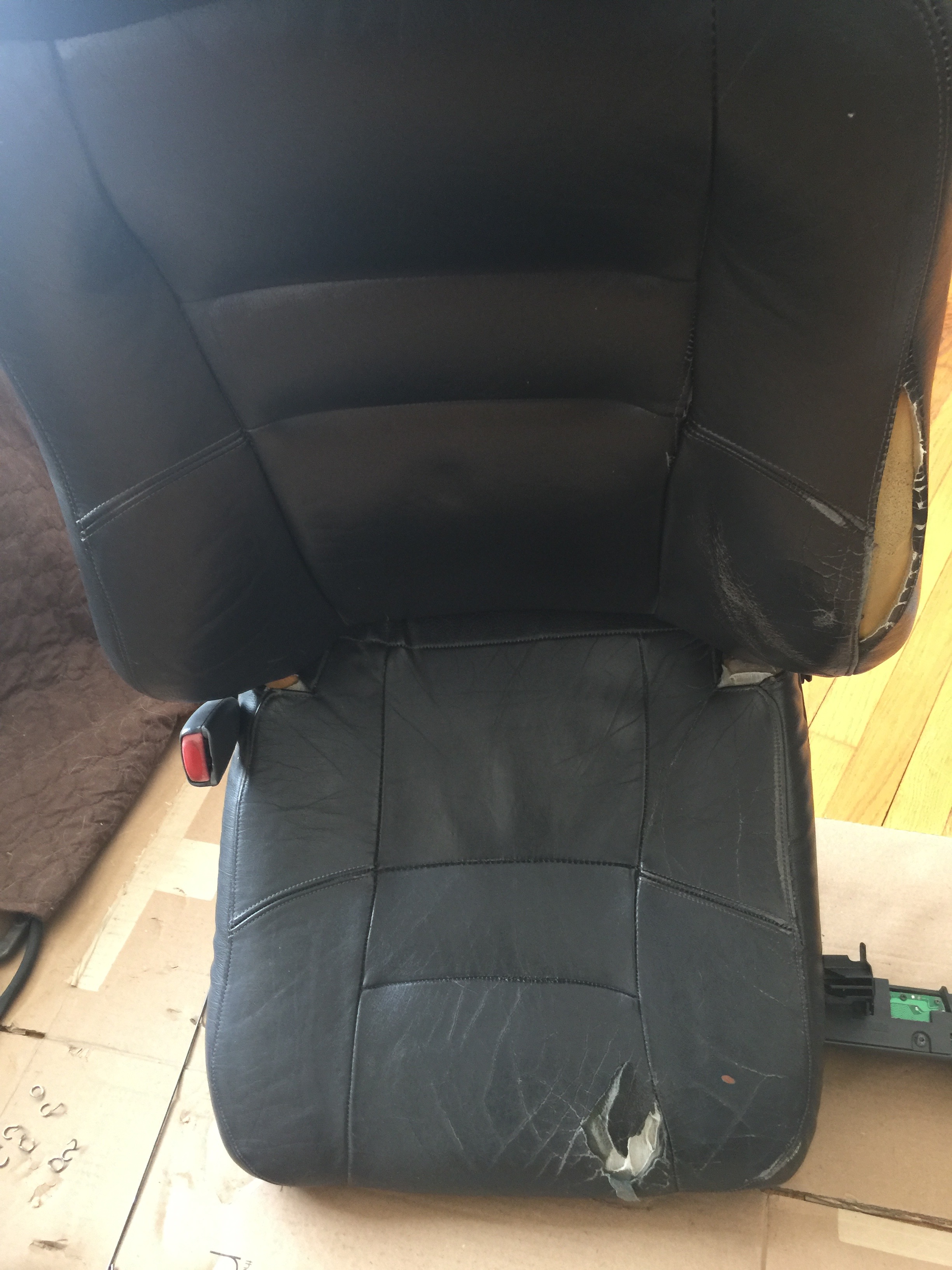

I did both bottom foam cushion & leather cover swap several years ago. When my neighbor took the sled to pickup a chair, she remarked how 'stiff' the foam was...like sitting in/on a bucket. (She even has more padding....). I've read one can 'revitalize' old foam cushions by steaming them. Problem is 20yr old foam is....20 years old.
Planned on doing the seat back leather as well....sometime. Currently buried in RF ABS harness issues....

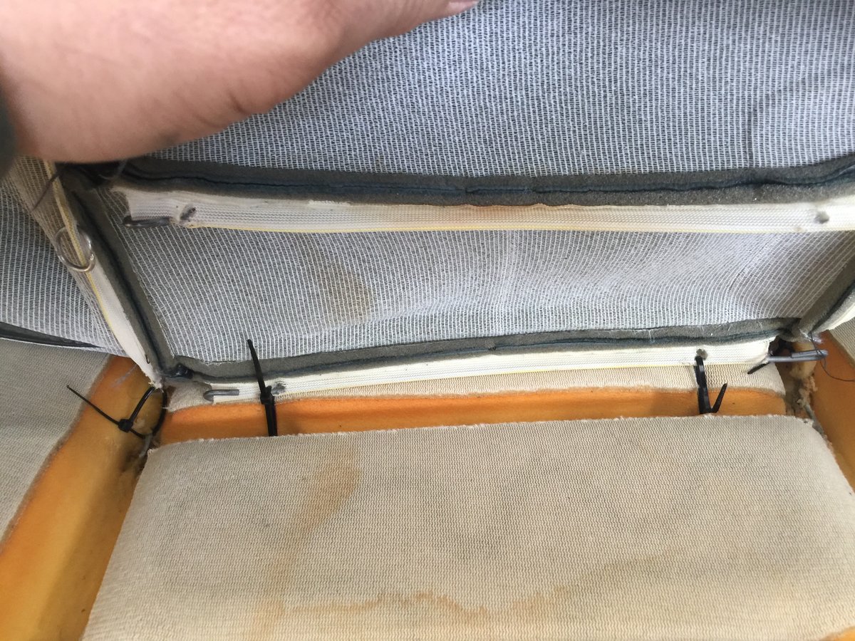

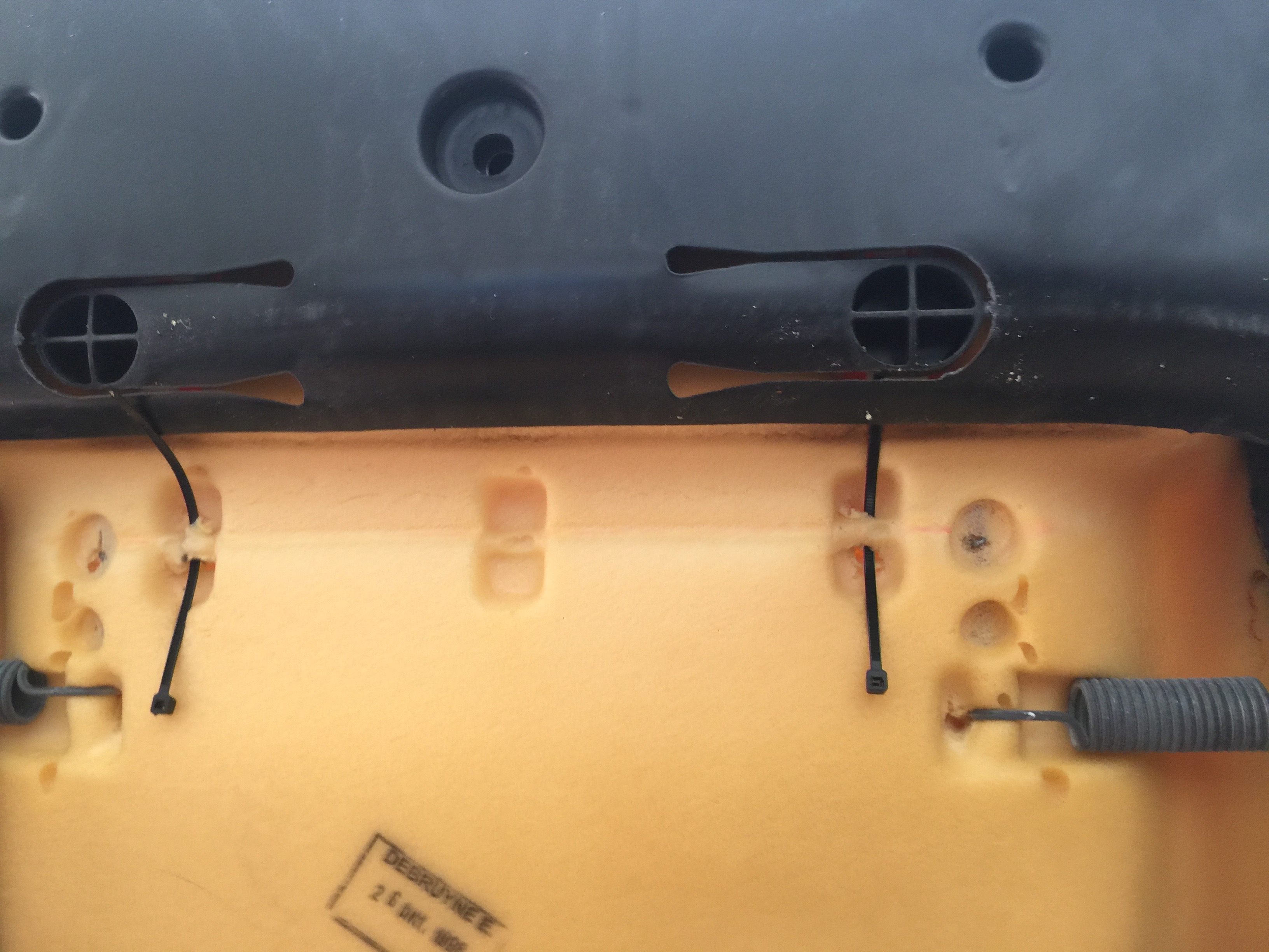

Reattaching stay to seat cover
You have to be sure the hog rings or zip ties pick up the wire stay both inside the fabric cover of the seat cover, and the stay buried in the foam. Just give it a little tug and you will feel the wire.
I used 4 inch zip ties.
DONT DO THIS
My hands are still killing me this morning from the fine manual work of fishing these through in tight quarters. You want at least 6 inch zip ties and 8 inch are probably one dime more for a 100 pack. pull them to about 1 cm diameter (same as hog ring) then snip of excess
Place the inboard ones first, loosely as shown, then place the outboards, tighten inboards, tighten outboards.
You start at the back of the seat bottom (there is enough slack to pull it over the foam.
The seat backrest you start on the backside, right under the headrest support. The next picture shows both the starting point for the seat back cover (turn it inside out to start, attach this back point first, then work it down tying it to the center stays and side stays like the seat bottom. The two cross plastic pieces are the buttons you seek to release the headrest at the start of this job
DONT DO THIS

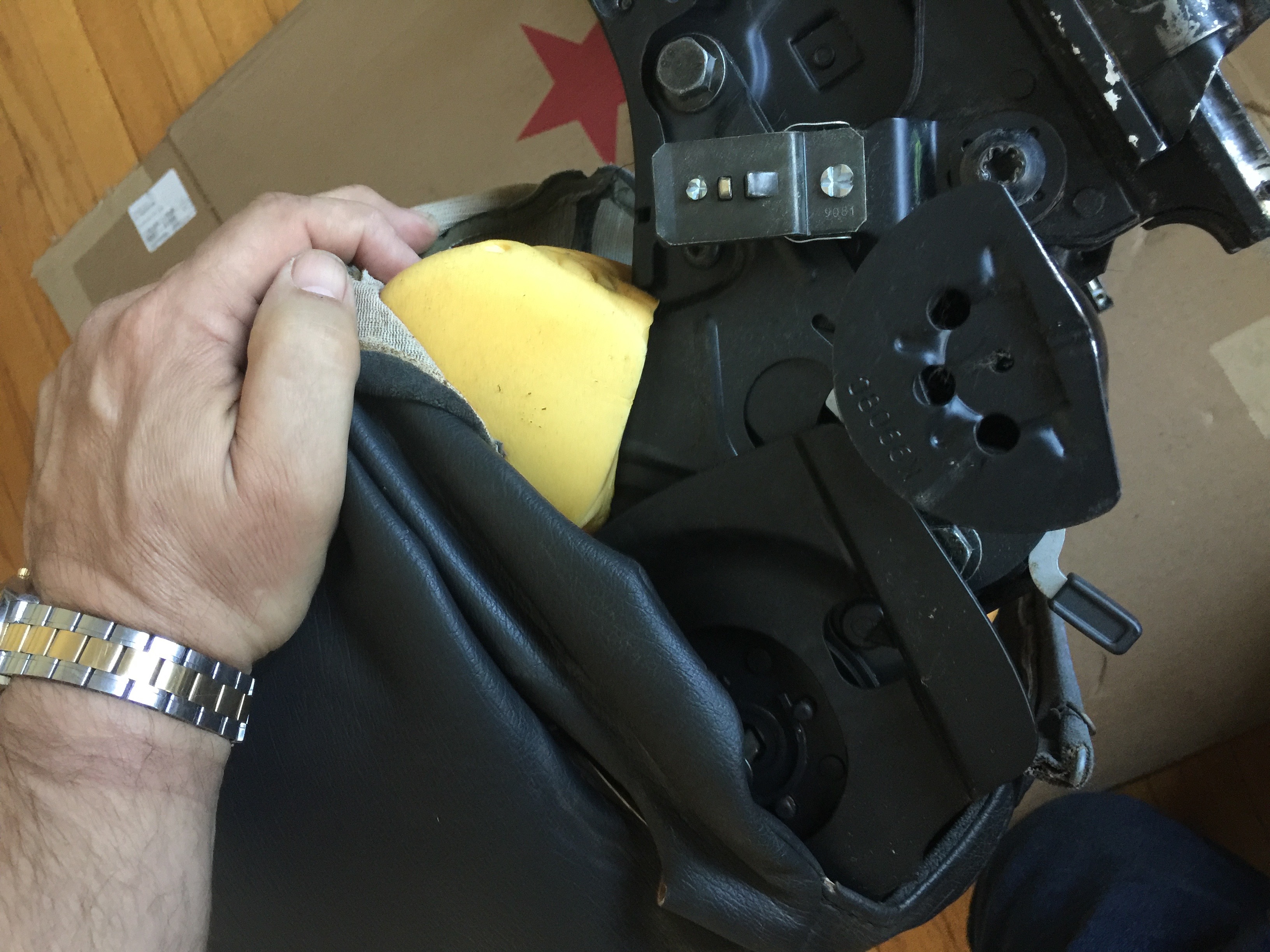

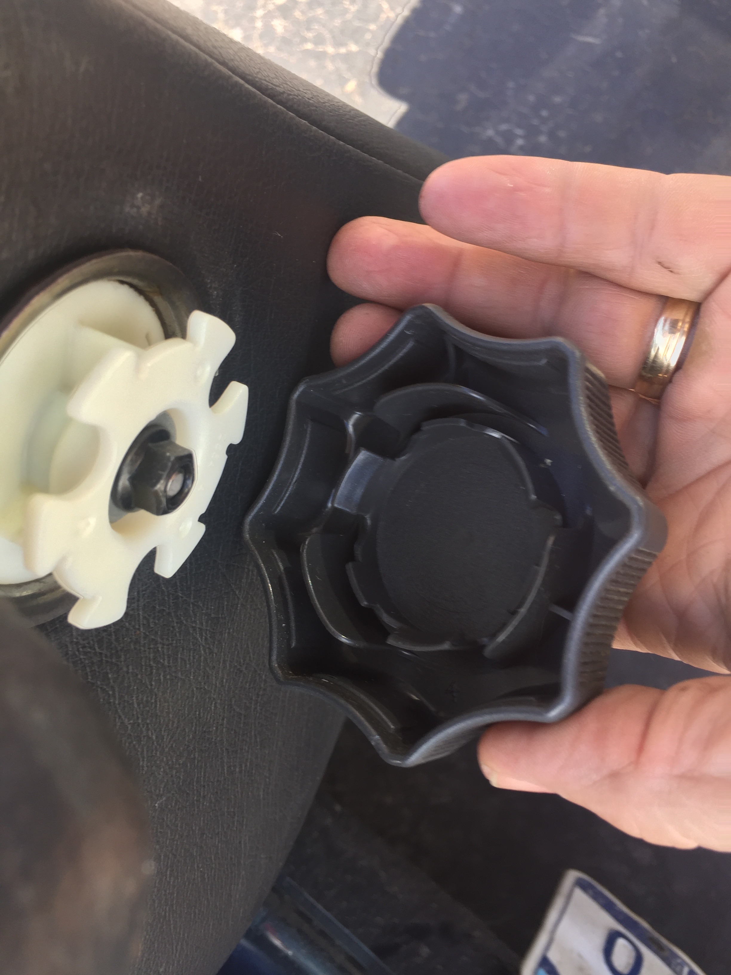

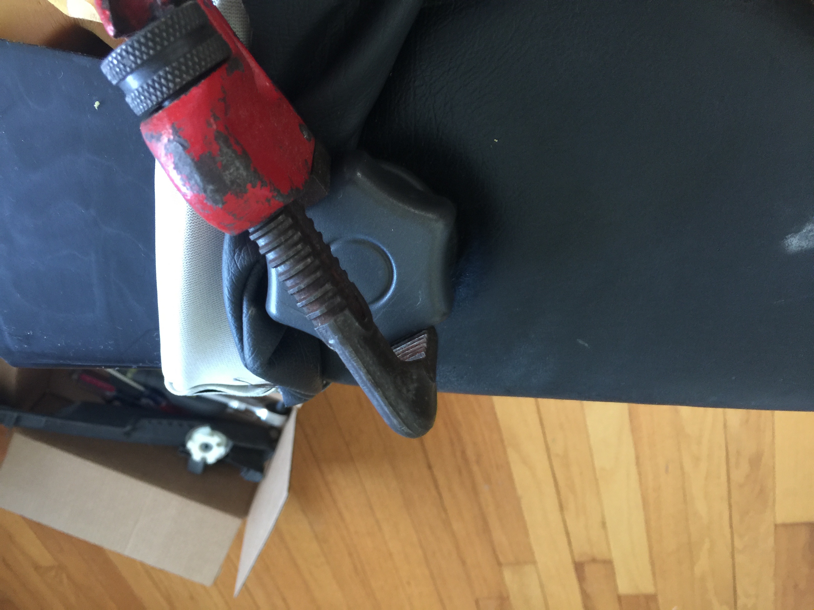

Detail of how the seat back bolster works and knob removal
The manual tilt knob pops off, and then an M6 holds on the assembly - EZPZ
The lumbar knob is bit more complicated - unscrew Counterclock wise, then use a tool to pop it off by hard CCW rotation
How the lumbar support works - the screw action just tightens the piece of taut fabric behind the seatback, pulling it forward or easing tension as desired.

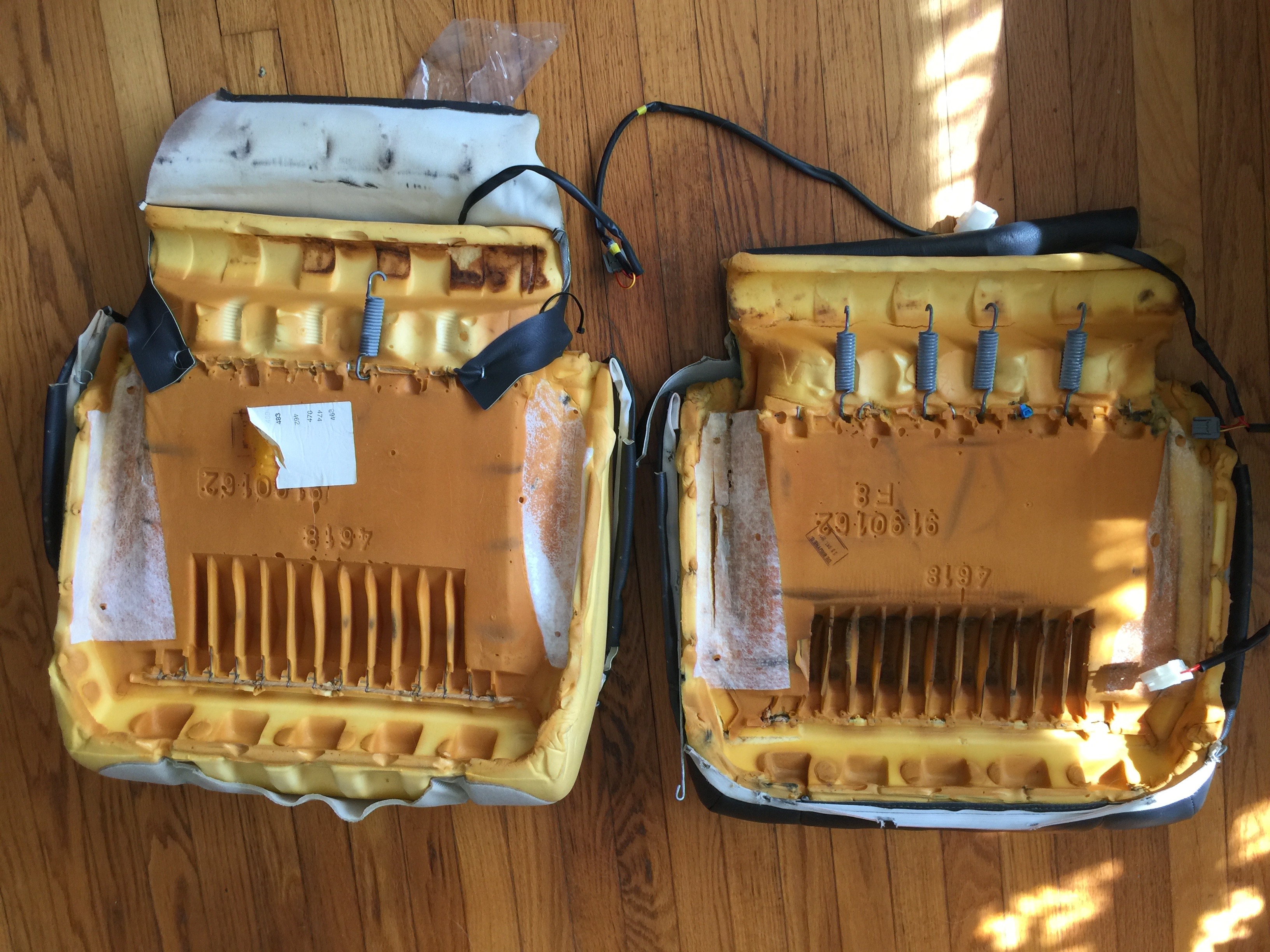

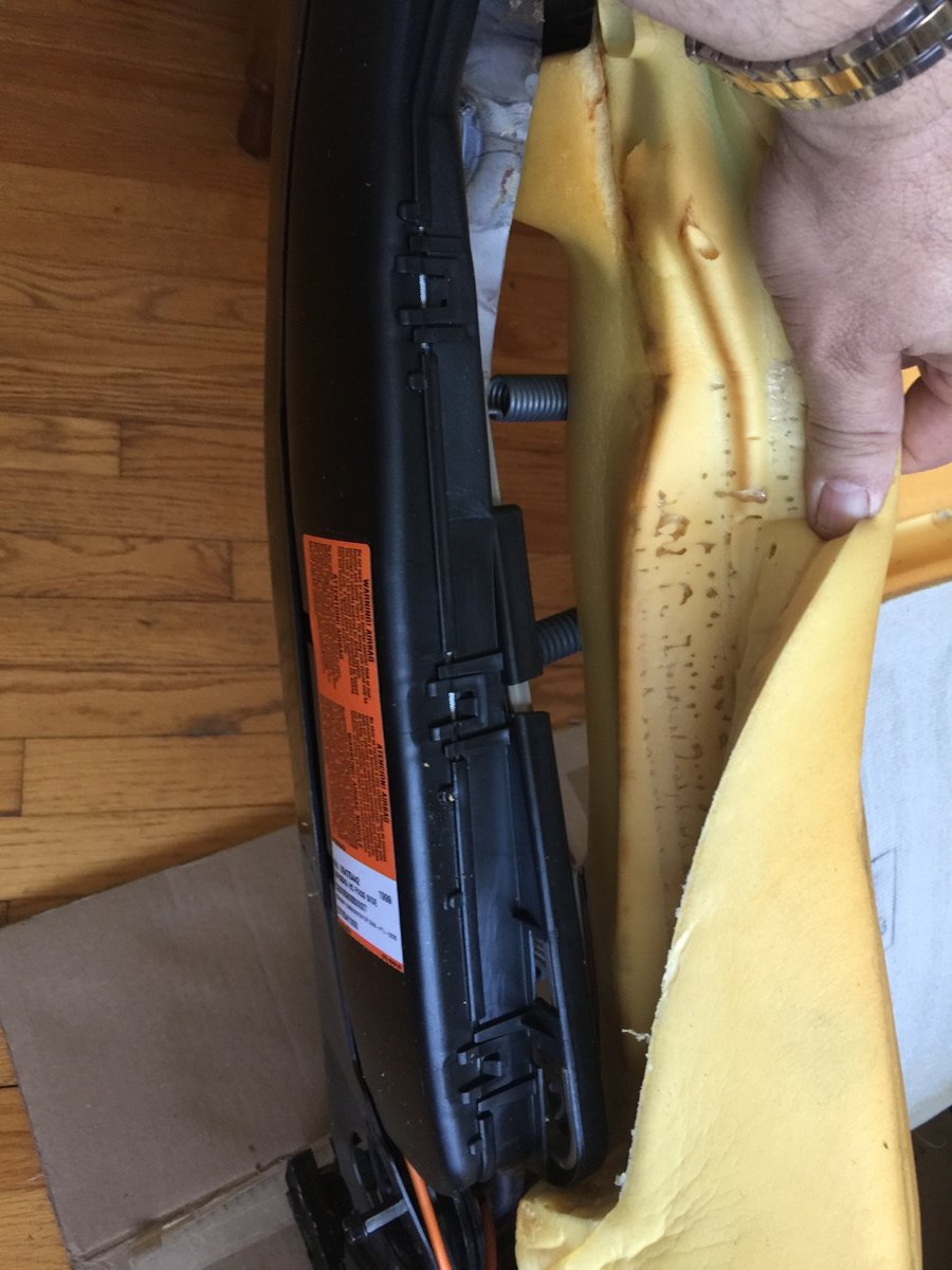

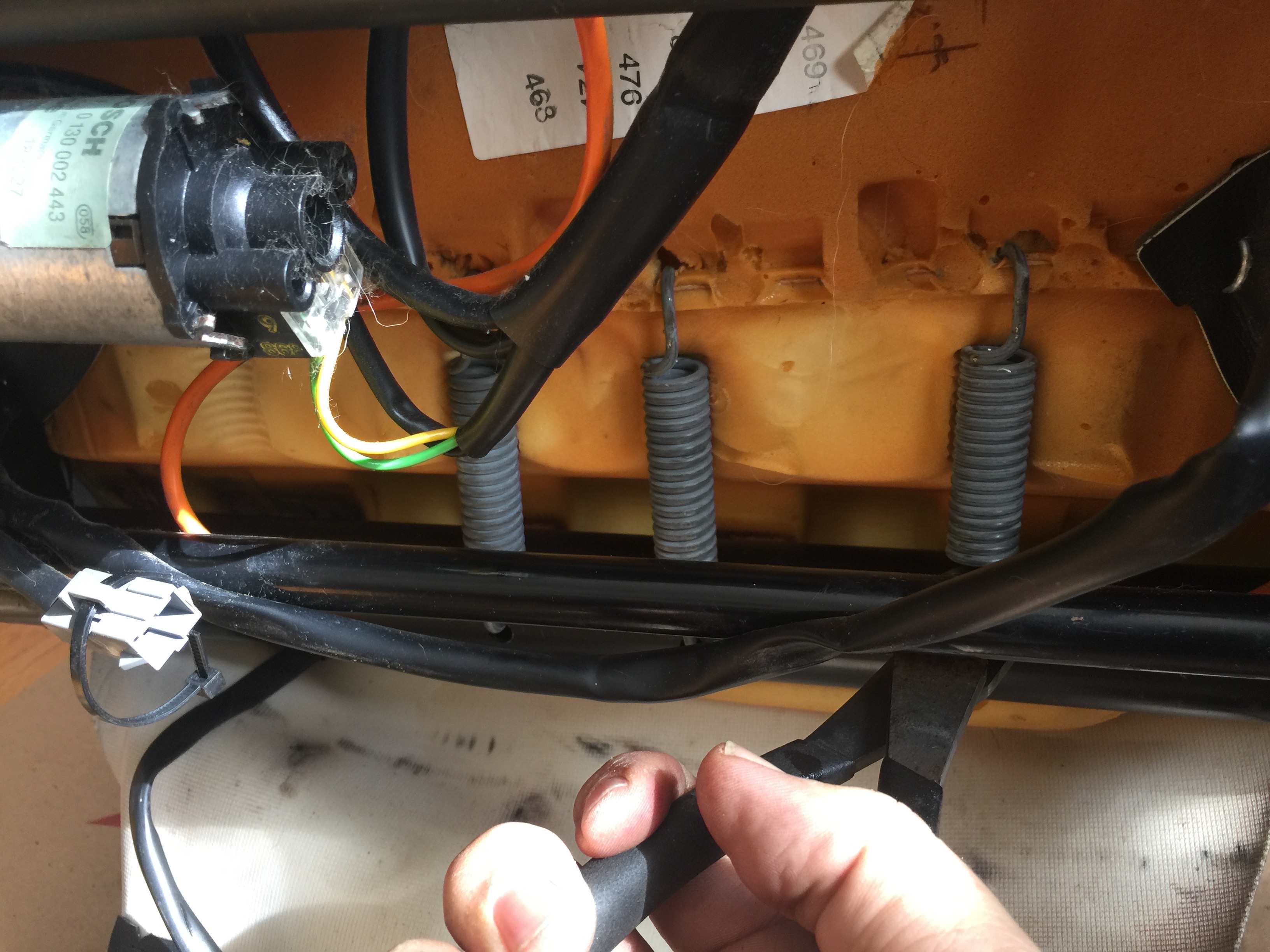

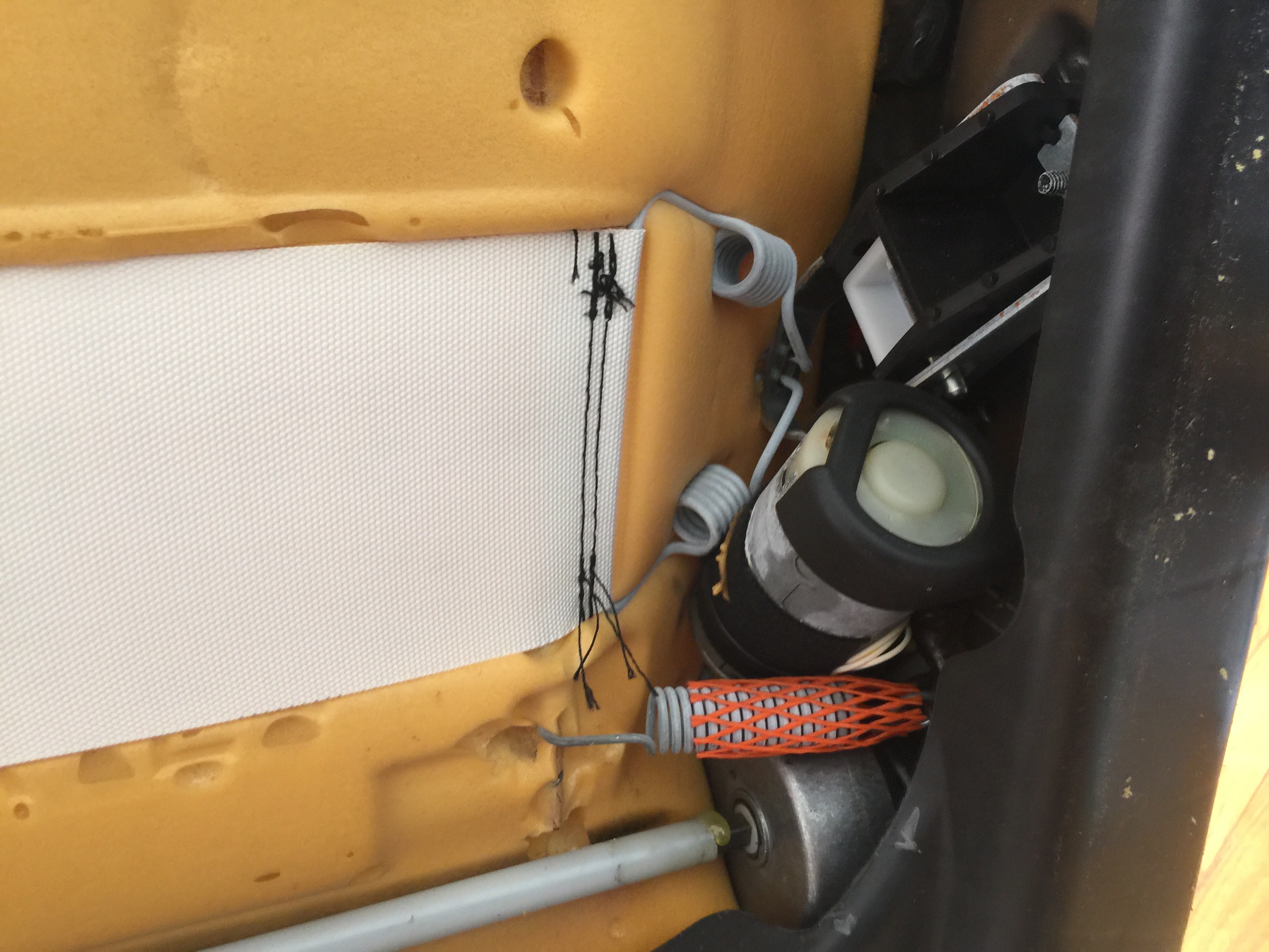

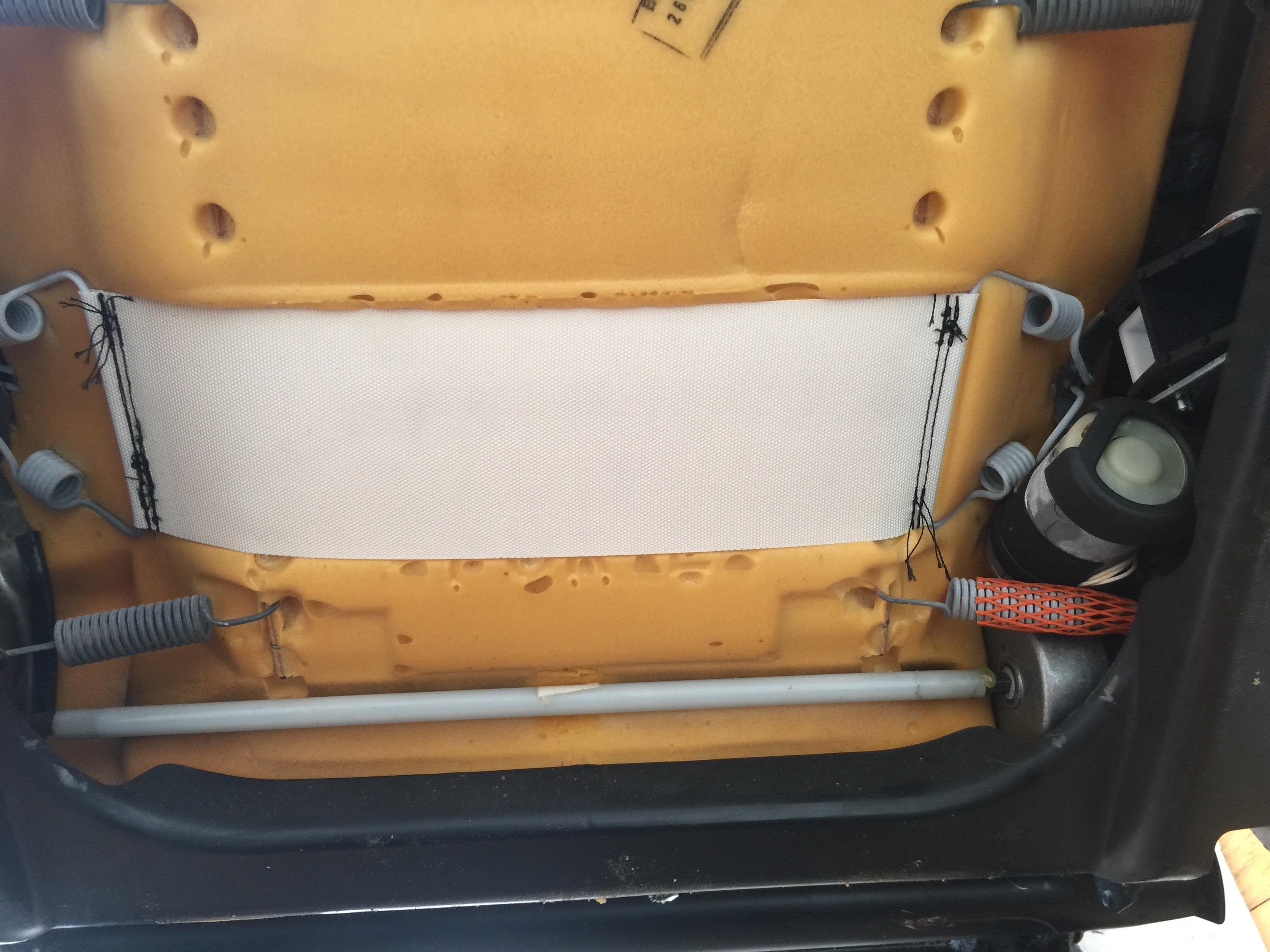

Volvo custom assesses the seat for the new owner by varying the number of springs appropriate for your size - you can adjust these if the seat is too soft or firm (MVSS (tm) )*
On the left is June's seat, on the right is mine.
You start by attaching the loose flap at top working under the seat, then fold the leather over and sequentially attach to the side and cross stays
Here is the detail of how the springs attach - I put mine back in when all done, with pliers as shown, A bit of hand strength required.
* MVS Sarcasm (c)2018

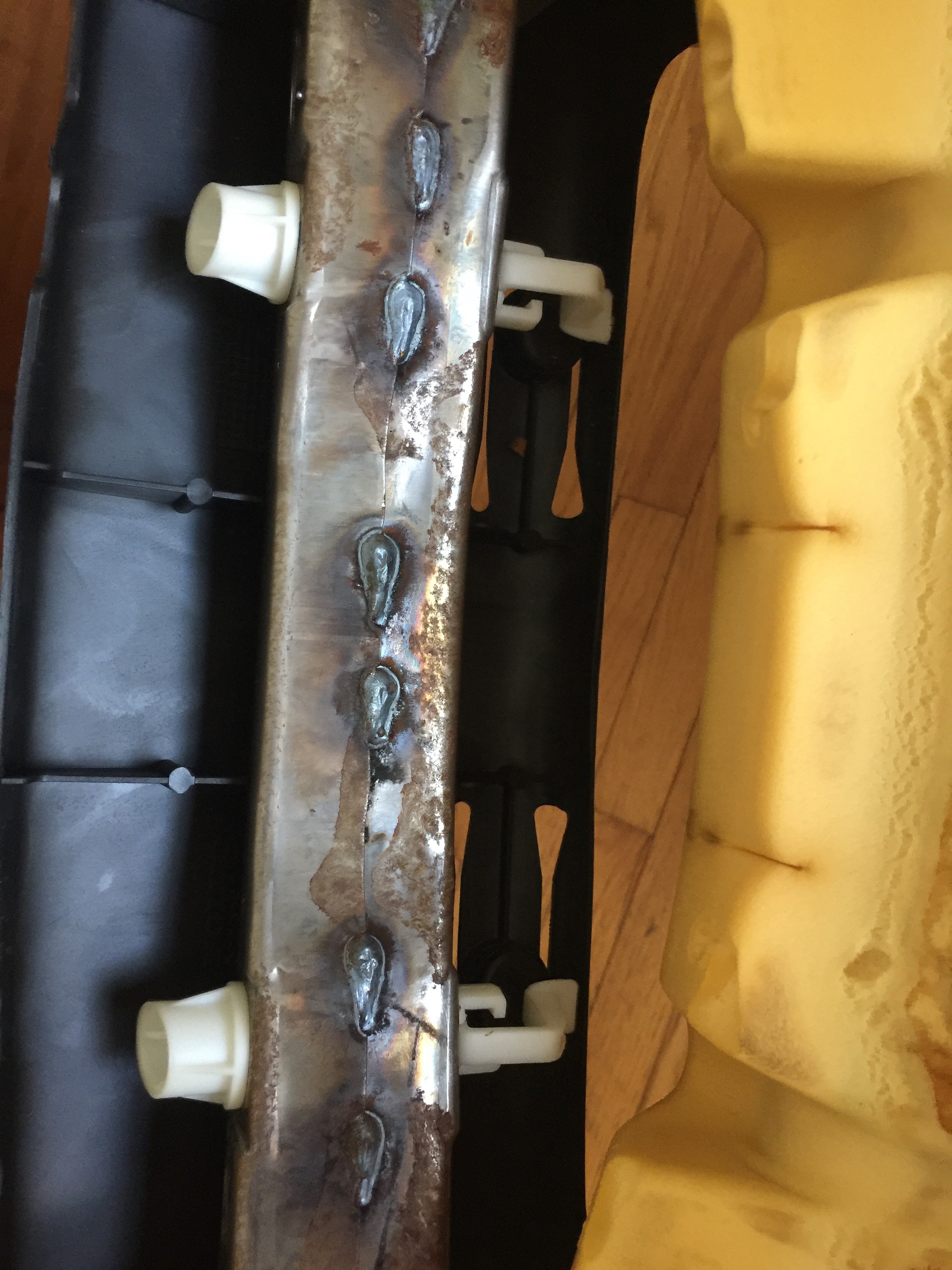

I hope I remember to install that pink retainer clip for the SRS SIPPS bag..

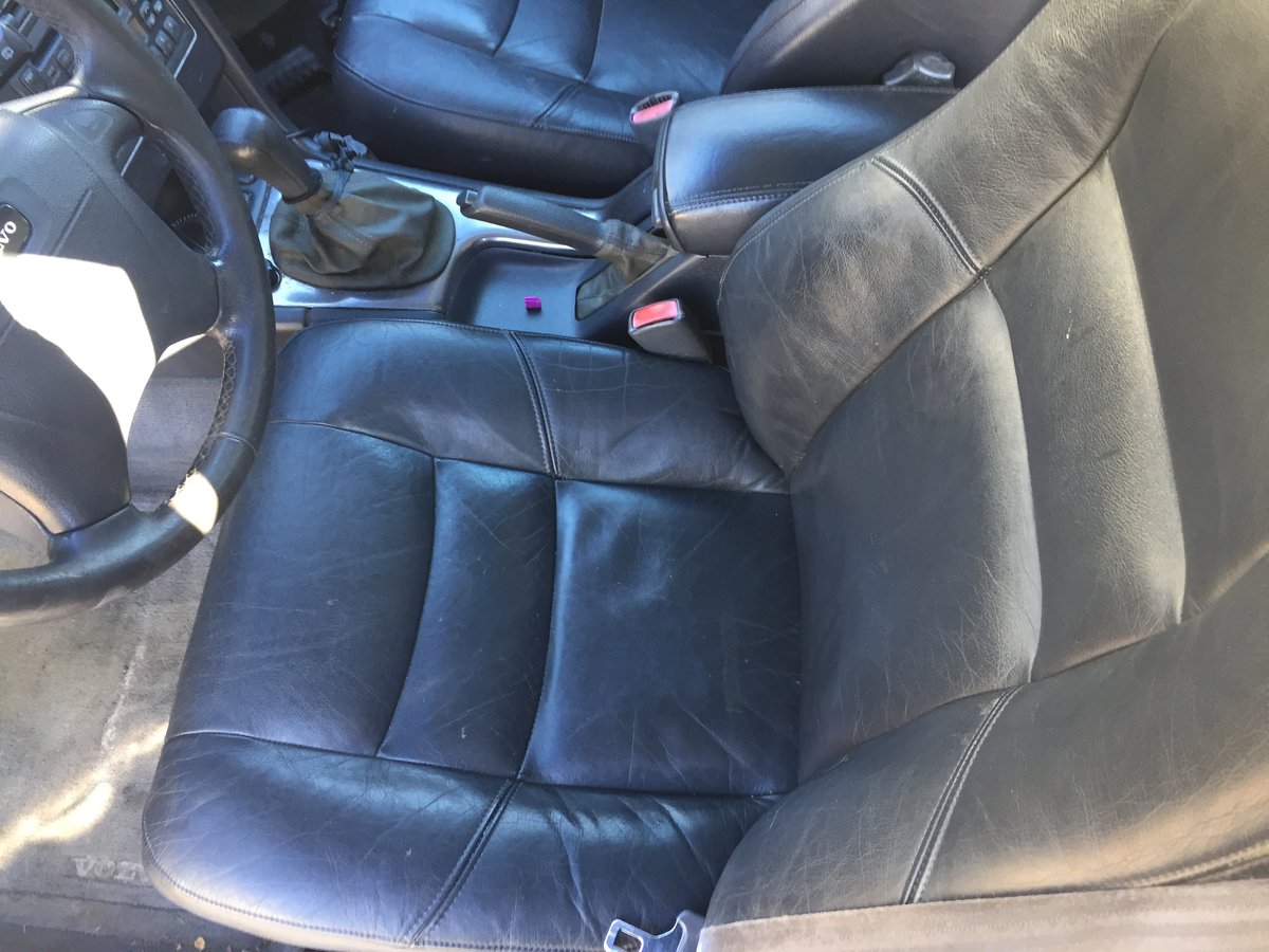

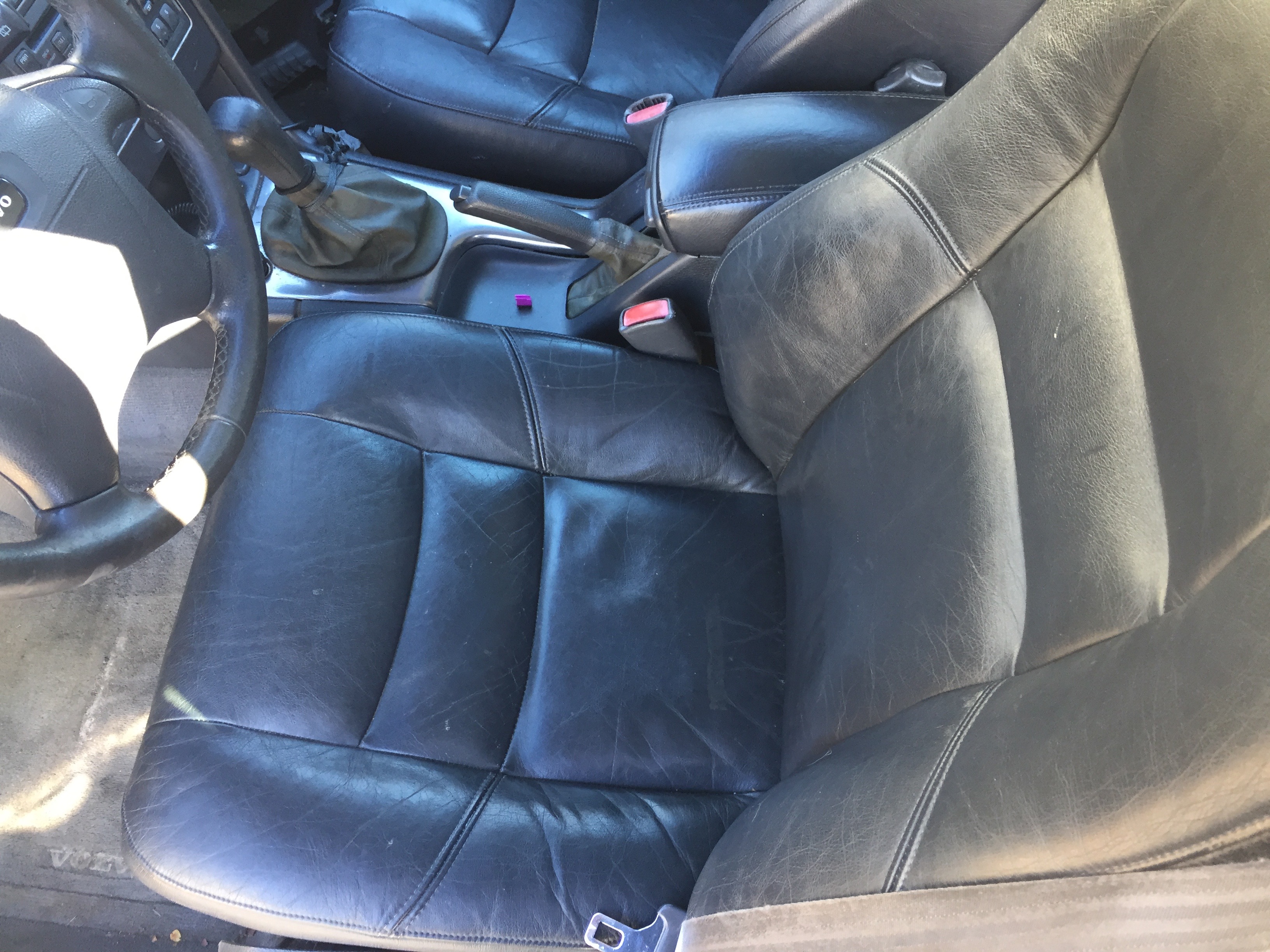

Looking good after some Connoly leather treatment

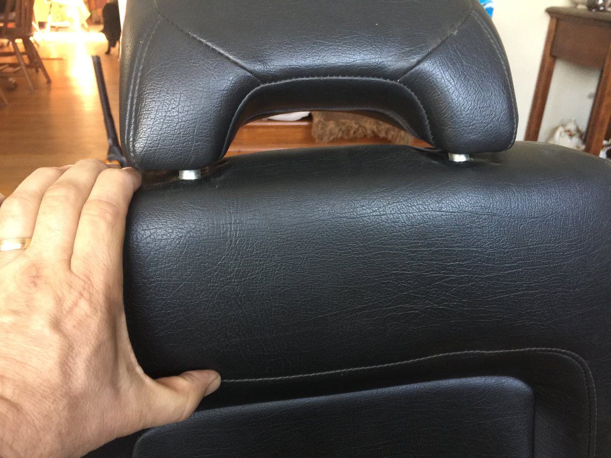

Head rest release detail - there are two places to push on roughly on the seam
Heres the actual latches you depress
This cutout for the SIPSS and the mount hardware makes the seatbacks not-swappable between pass and driver - I knew that, June had to remind me of that though...

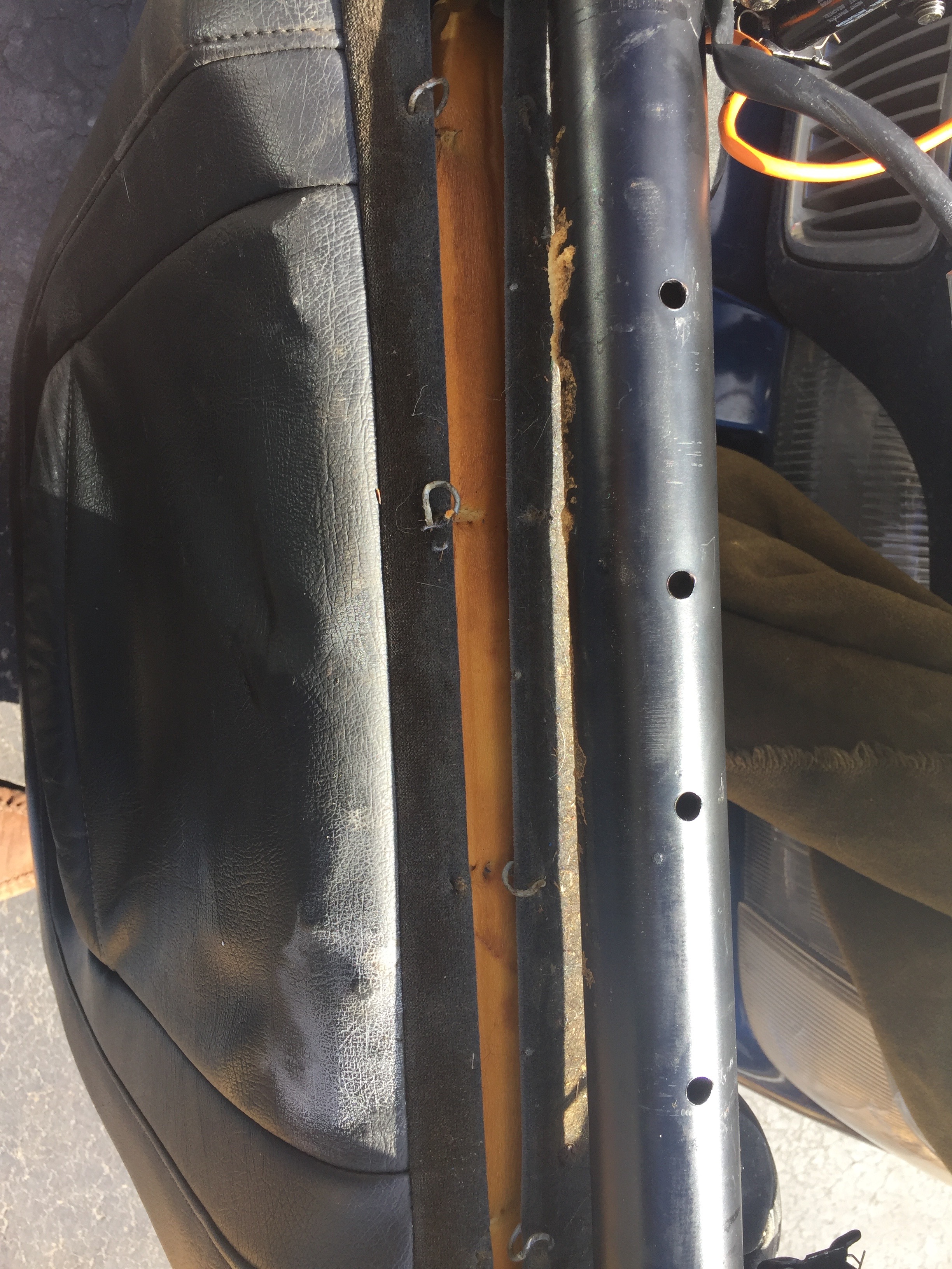

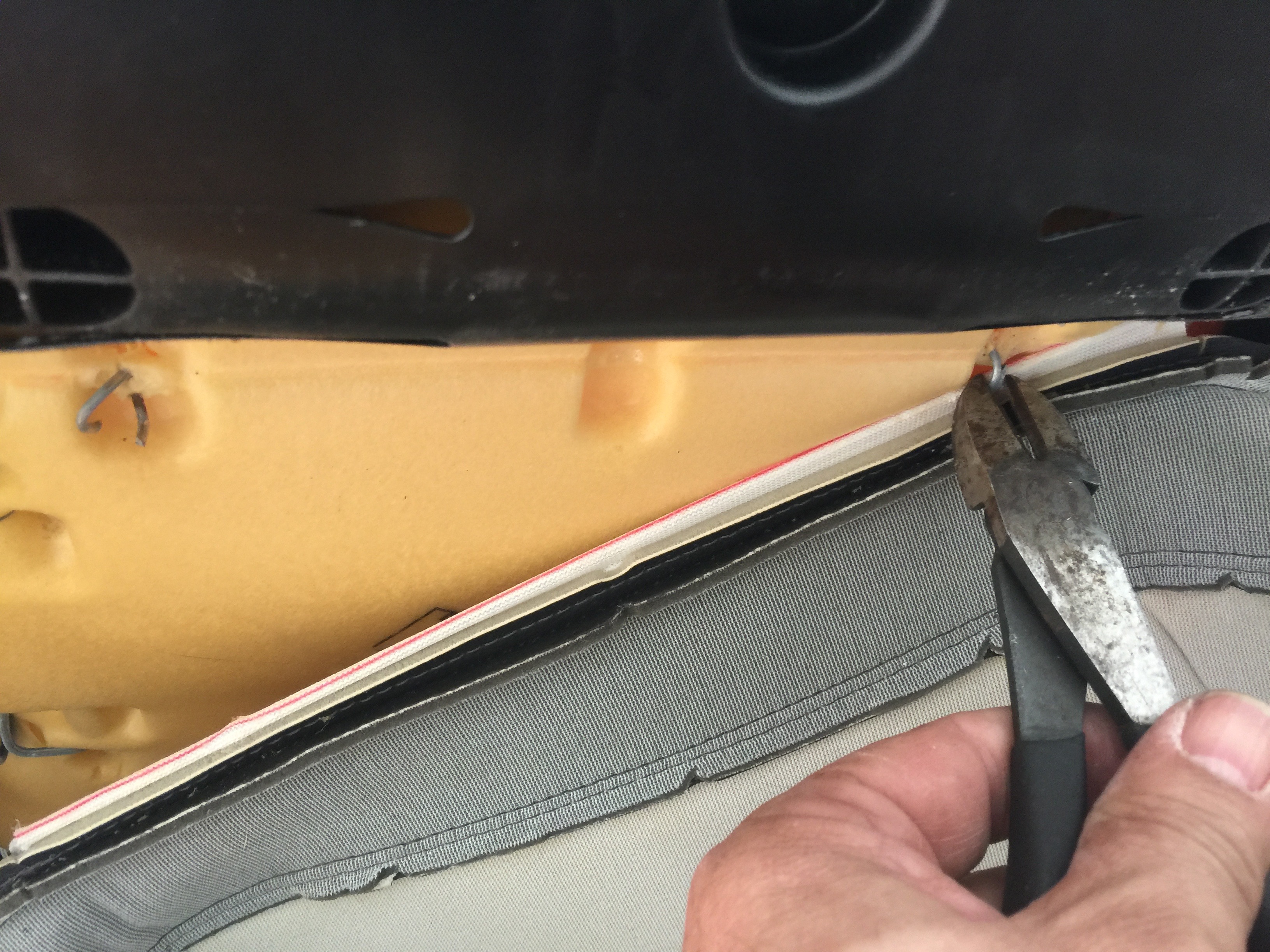

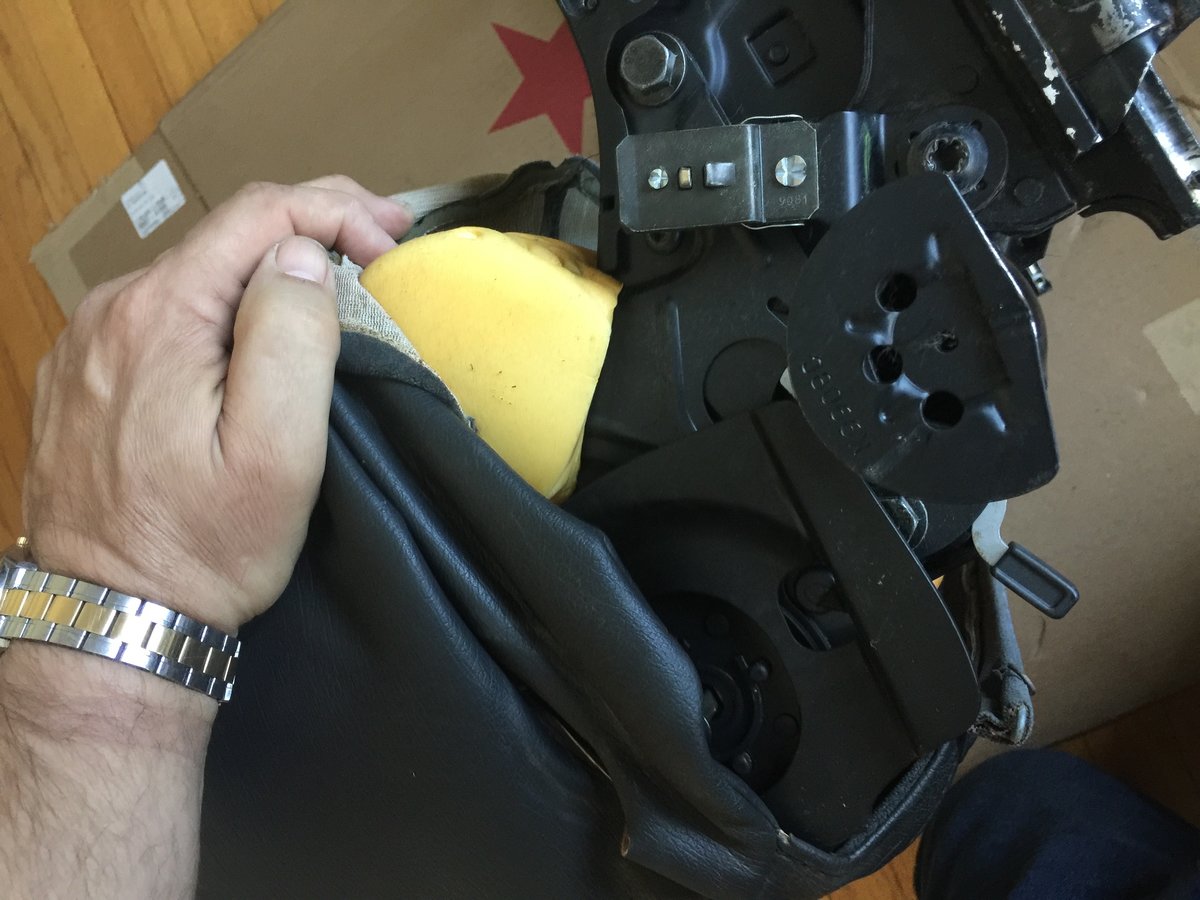

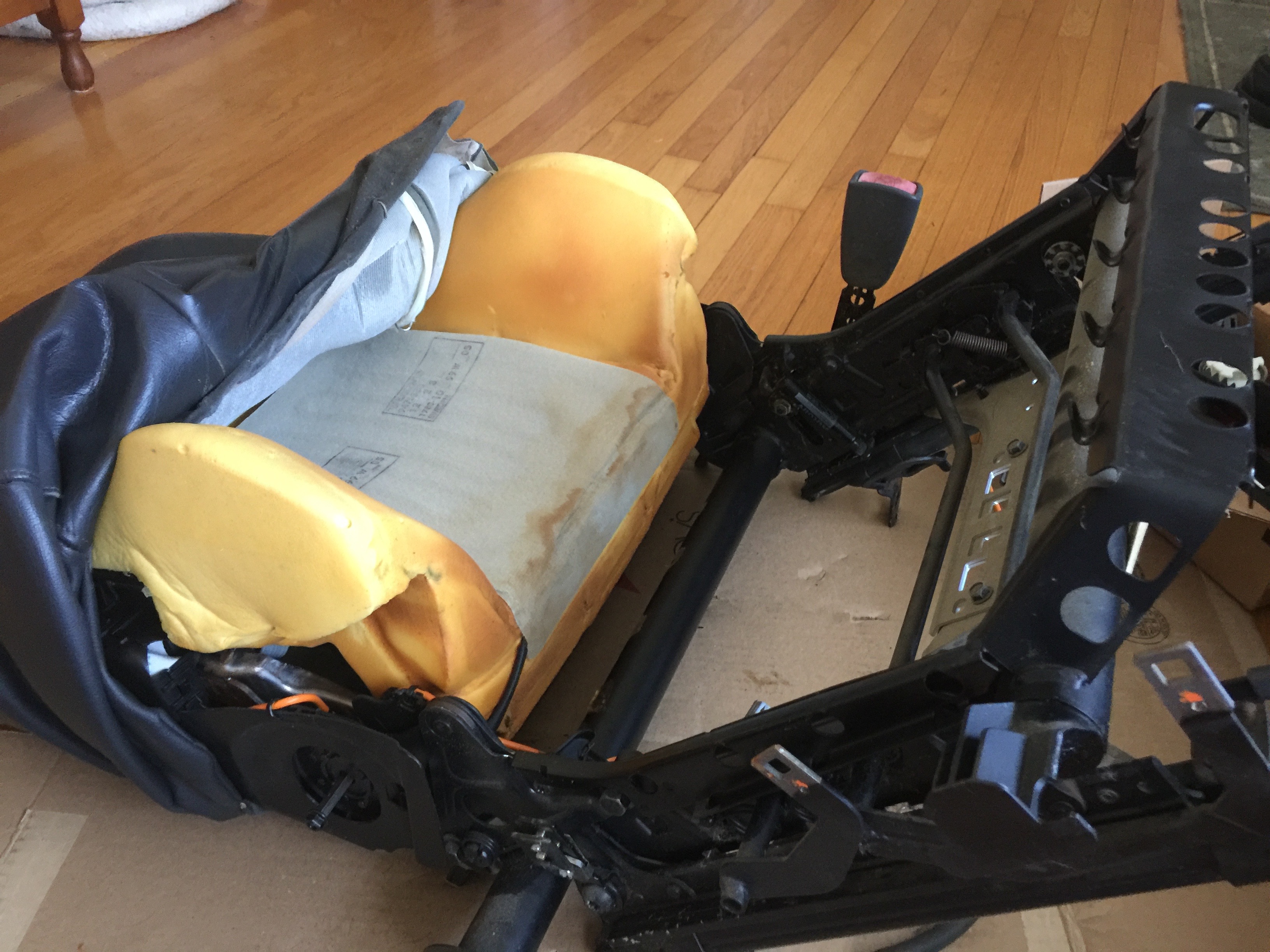

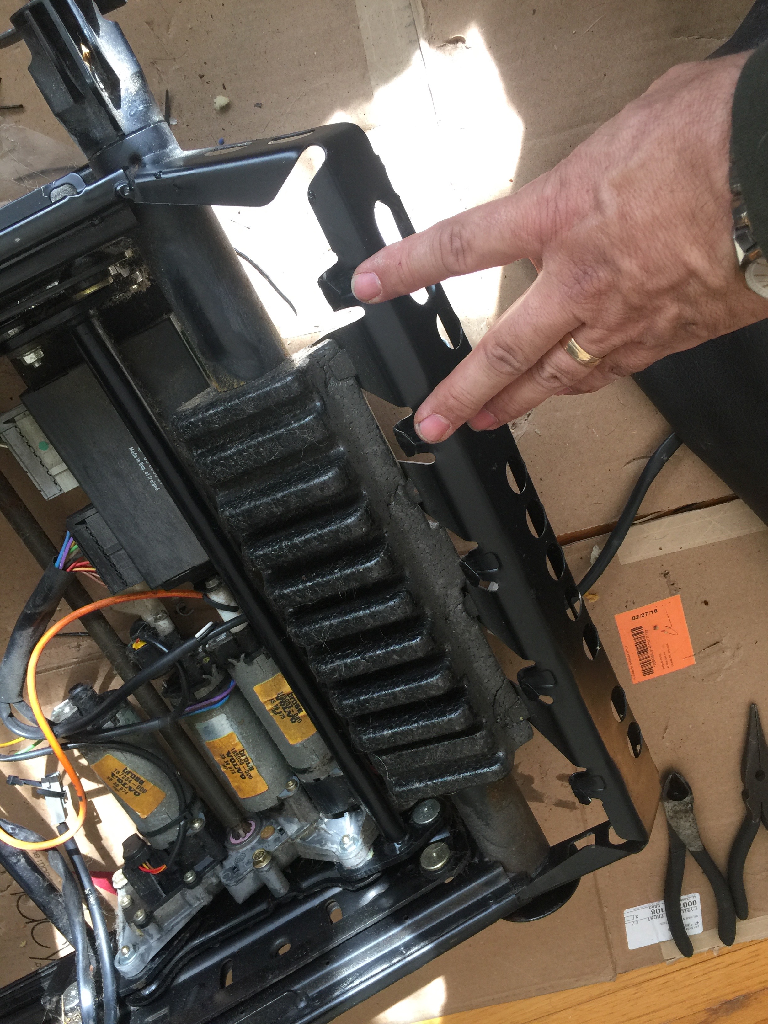

Begin opening up the backrest at the bottom of the seat
Removing hog rings - I dont cut them, I just gorilla them off with a stiff plier - two twists and they pop open as shown
