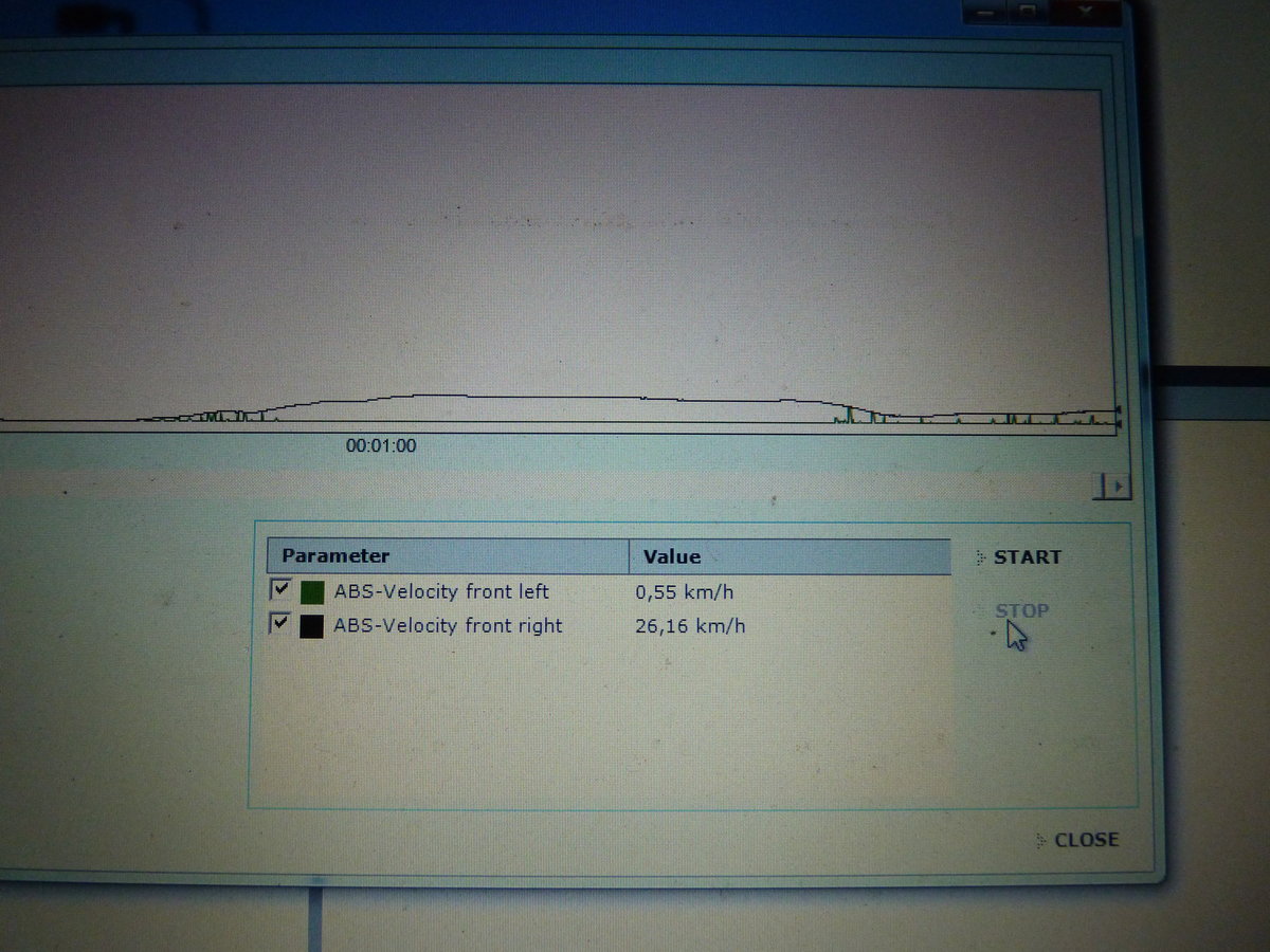

At this time I read the fault codes and took a graph of the ABS velocity on the front sensors - see the picture. When the right shows 26 km/h - the left one shows 0,5 km/h.

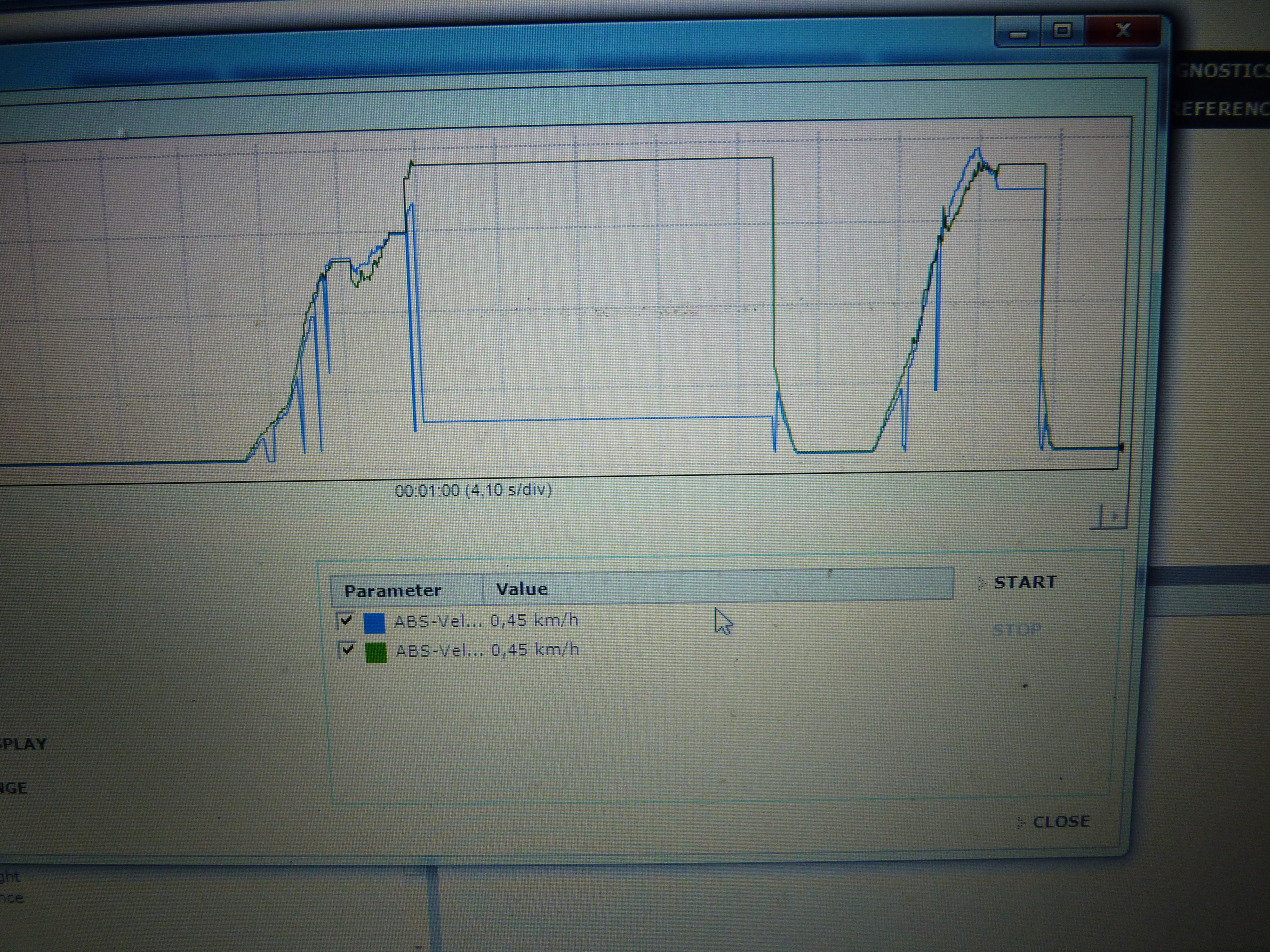

So, this is what Ive found out so far:
This is what happens during the test procedure, during the time, ABS pump sounds LOUD and the brake pedal pulses, like when the ABS is working.
The blue is left sensor and during test/start procerude the velosity goes down.
The green is right sensor.
After deleting the fault codes - first (after the above happens) the ABS light lits.
After short while also the Tracs control light lits.
We drove some 15 km to a friend.
When started there - only the ABS light came on.
And after the starting proceruder (pump tests it self and all the sensors) - then both Tracs AND Check Engine light came on.
The check engine light did not come on first time he came to me, to get the car read with Vida. At that time, only the ABS and Tracs light came on. And the pump did not make that noise.
I have tested both front sensors to have 24,4 Mega Ohms resistance at the first connector (crazy high isnt it?)
ABS box to left front sensor connectors, have 0,4/0,5 ohms resistance on both pins.
ABS box to right front sensor connectors, have 0,4/0,5 ohms resistance on both pins.

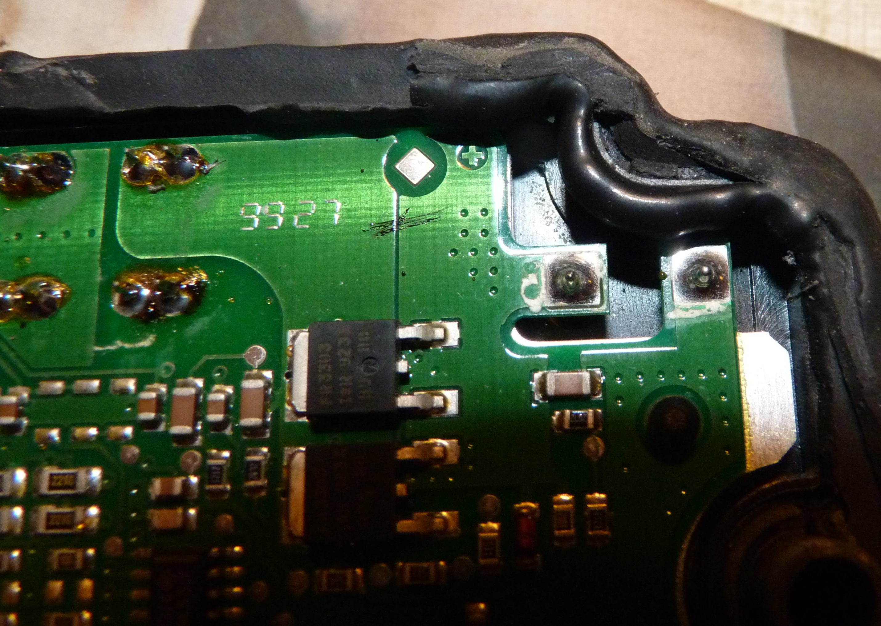

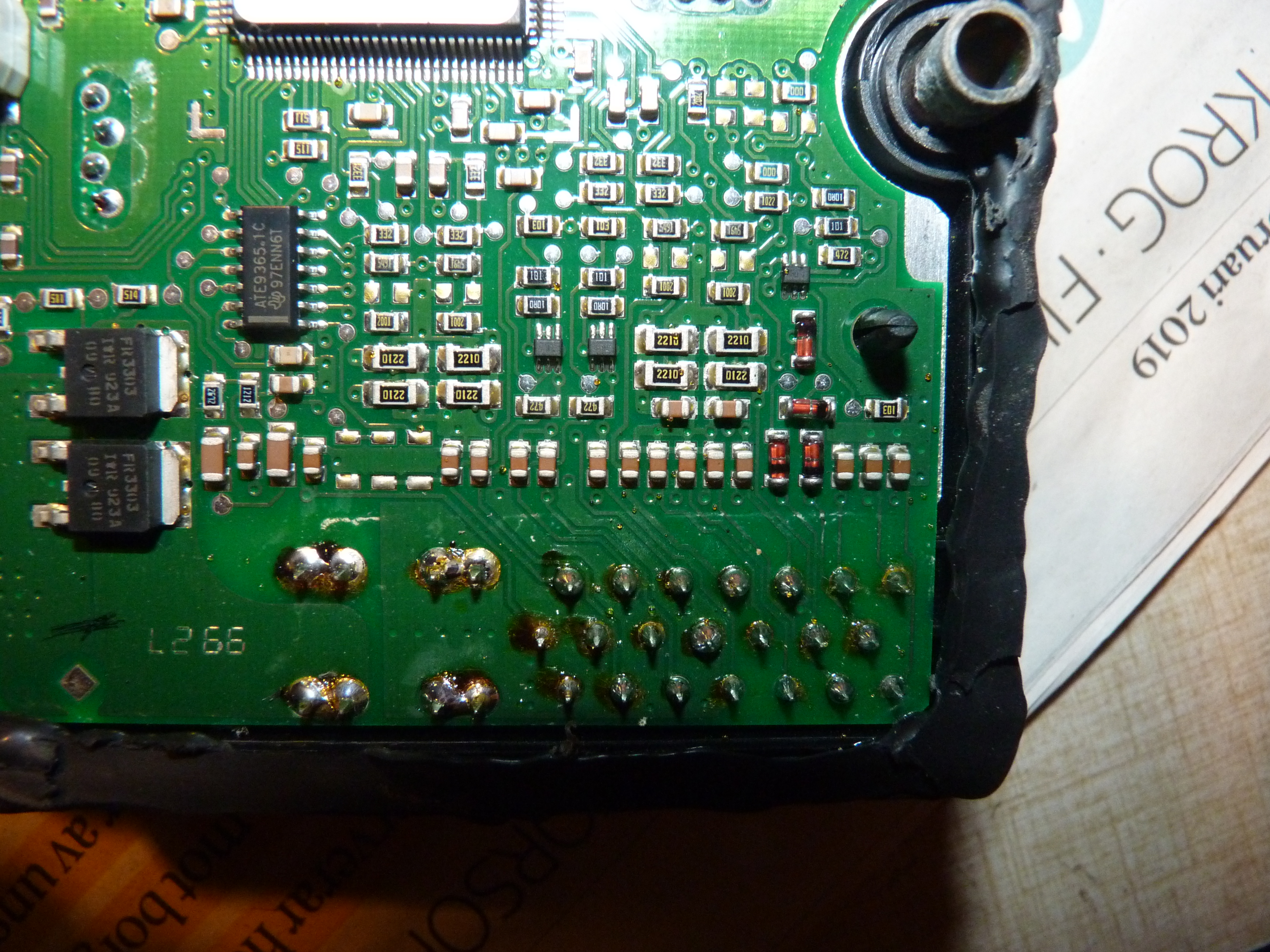

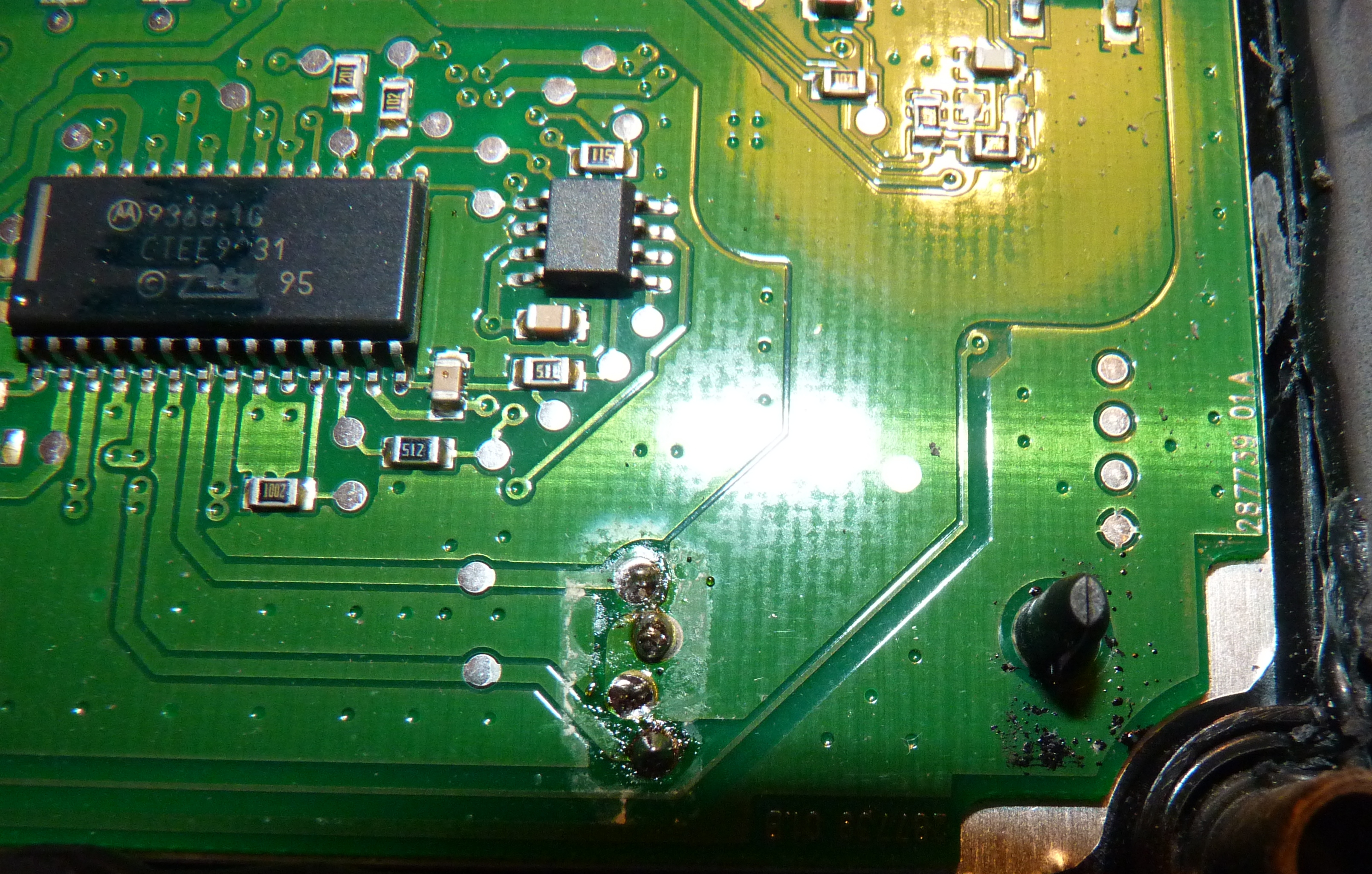

One of the ABS moxes had been repaired, so it was easy to open:
My guess is its the pump thats failing - does anyone have any idea how to test it so I can be sure?
