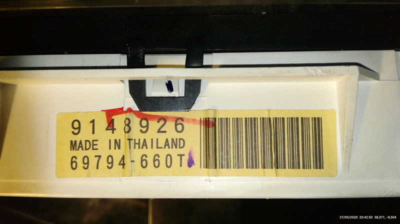

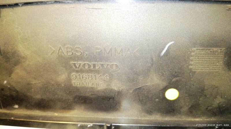

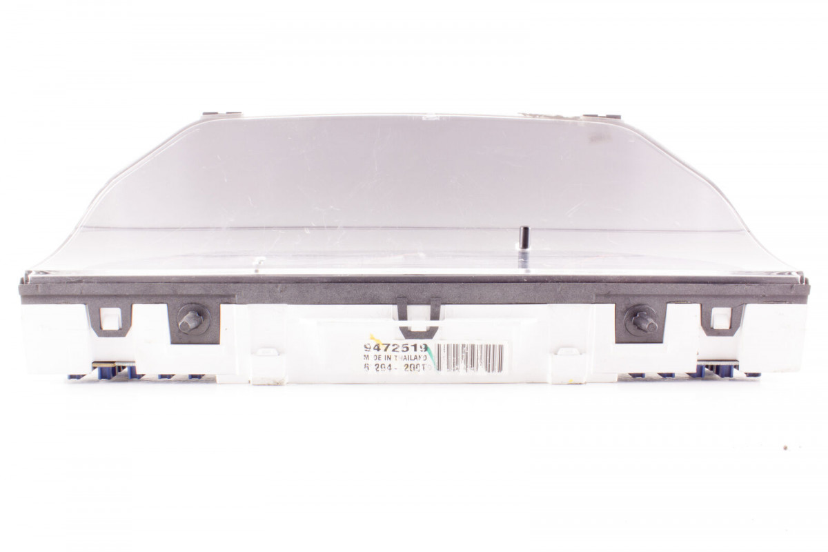

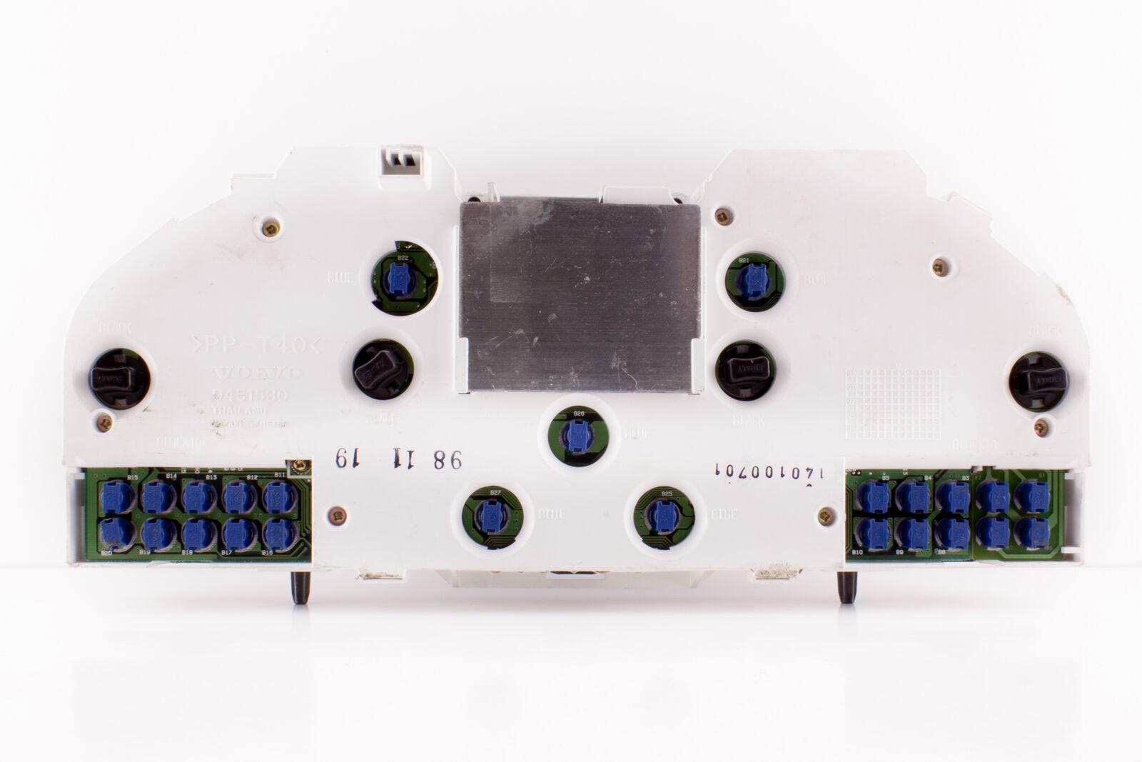

Yes, it is Kmh. And, I believe that the source of my problem: I suspect my used-car dealer to had cheated with the mileage, replacing some part of the odometer with an US one in miles.
The one I ordered is: Part number: 9472519; 9168144
Attached pictures of it for the numbers of mine:

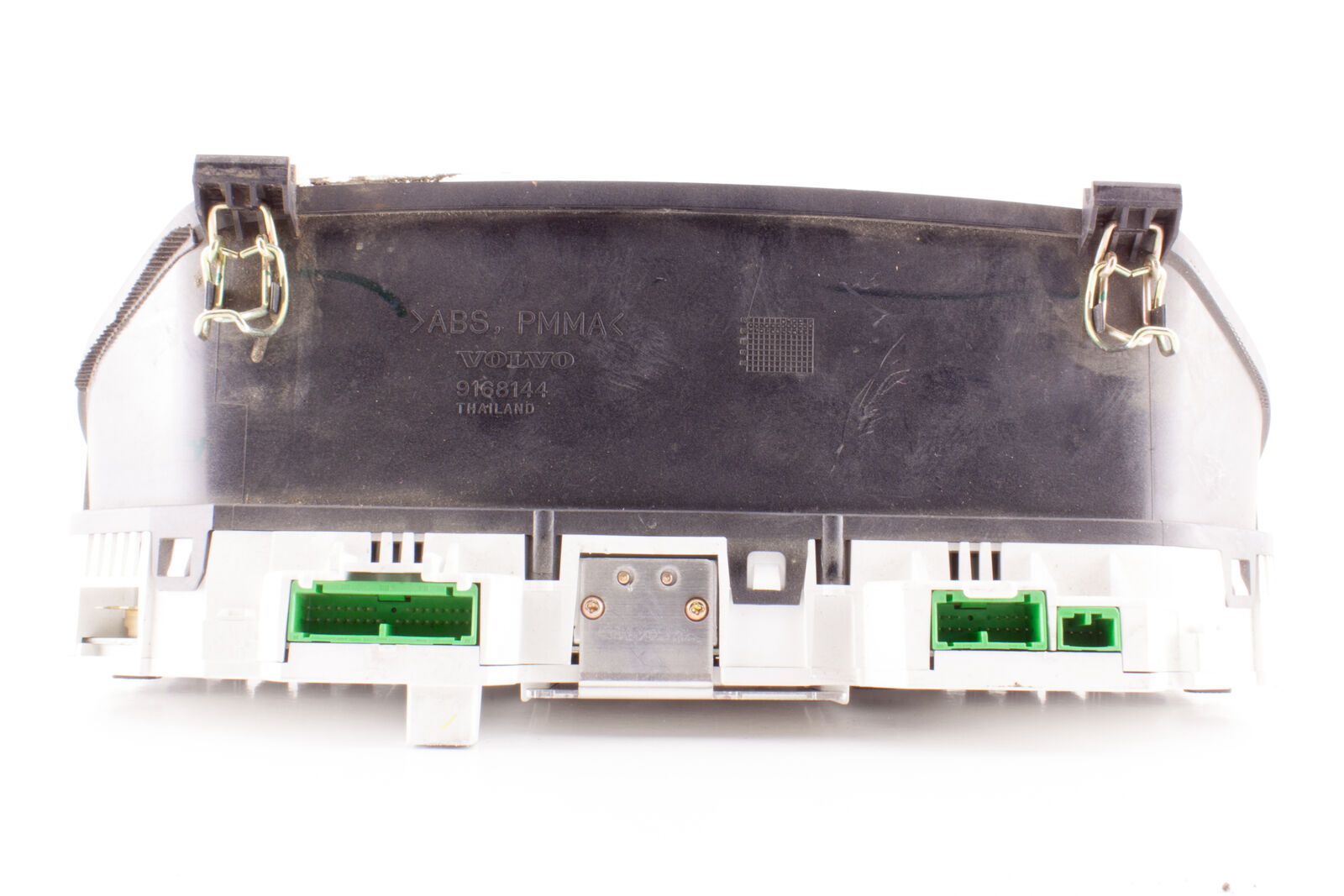

And the one I ordered ( a bulb not in the same place ):
But I can see-it in 1998 cars. By example:
https://www.b-parts.com/en/store/produc ... 1999-2000/
And I can see the same number, but with indications in miles and not the same scale https://www.usedecus.com/en/volvo/s70/v ... d-9472519/
I'm completly lost. Are -they all totally insane, in the Volvo r&d offices ?

Looks like it's from '99:
https://www.usedecus.com/en/volvo/s70/v ... 0-9472725/
At the back of the cluster...part # under VOLVO...towards the left from date production(under PP T40).
That number counts.
According to production date 19/11/98 it is for '99....since it's the end of a year.

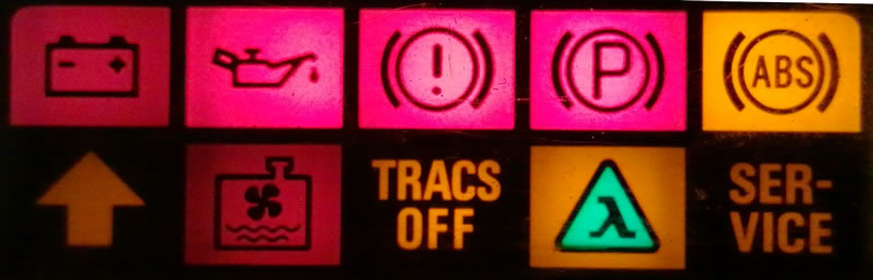

The easiest way to check compatibility is to remove the bulb sockets from right side for warning lights and with a help of flashlight to check if it have ETS light(that's for '99 & '00).
If it have Lambda symbol it's for '97 & '98.

misha wrote: 27 May 2020, 14:49 The easiest way to check compatibility is to remove the bulb sockets from right side for warning lights and with a help of flashlight to check if it have ETS light(that's for '99 & '00).

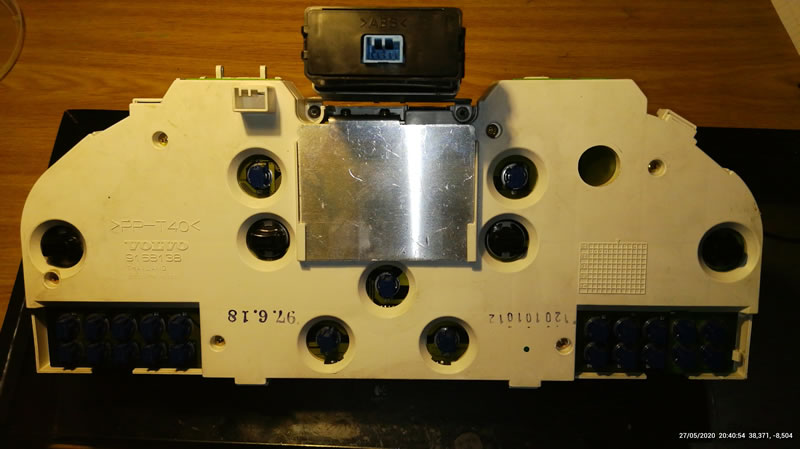

My car is 97 &98, for sure, but you never see the dashboard fully illuminated on used parts for sale on Internet ;-)
The number you refer on the piece I ordered, not easy to read on the photo is 0451580.
The printed board near the warning light is not the same neither.

esl_97_850_T5 wrote: 28 May 2020, 03:16 But it's important to know exactly what fixed your problem(s).
It is very clear: this B901 ->B2 value.
It seems obvious to me, now, that tire size tune the ratio between the frequency from ABS and the speed value showed by the needle of the speedometer, to cancel the little changes due to various wheel diameters, and that the "country code" do the same thing, but this time adapt the position of the needle to the inscriptions on the speedometer, the scales that vary, depending on the country (Miles, km) and type of the car (fuel, gasoline).
About lost milometers, it is not insane to suppose I've drive 59 Hours with my ABS warning light shining or blinking.
I will do a total scan today, and will send-it to the interpreter in the night.
May-be i could chase the last litle DTC that remain, SRS and power seat, for the pleasure to have a 0 DTC 100% working Volvo, that never happened since I own it ? One thing is strange, it is the new "battery alarm" one that appeared suddenly : I dont have an alarm on this car.
[edit]ABS problems back again (and again and again). Each time I fix something there is something else that fail. Hats off Volvo !
