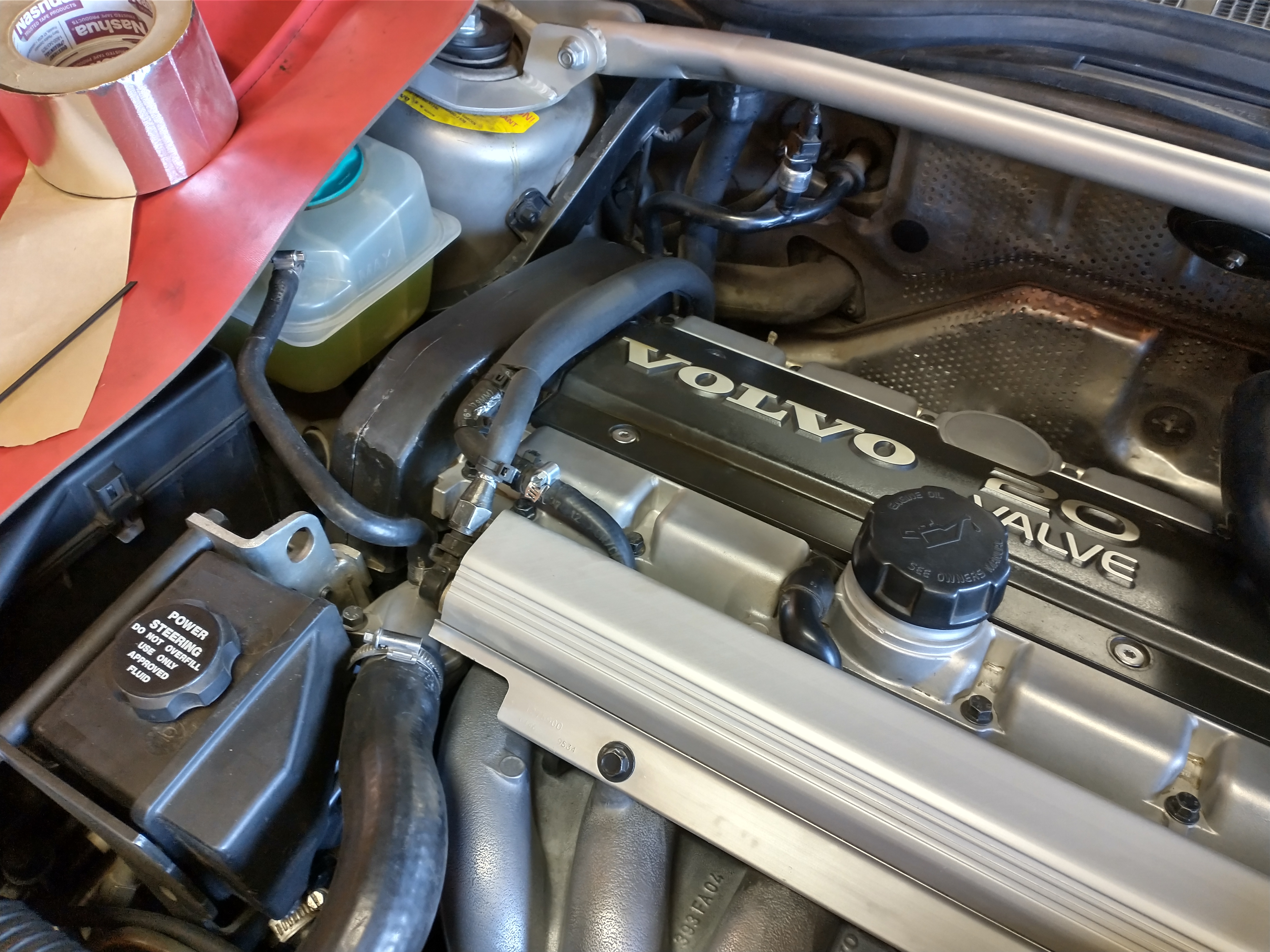

After another break-in drive yesterday, I was under the hood checking temperatures, and noticed the the fuel lines get pretty warm as they pass over the engine. Makes sense, as they are sitting between the top of the engine and the heat blanket under the hood.
On top of that, to make things worse, they are painted black. But typically you want your fuel cool, not hot.
Has anyone tried to shield these lines in order to keep the fuel as cool as possible ? Seems like it would be easy enough to do, so I'm going to try an idea or two today.

Yes the metal HVAC tape was what I was thinking of using. Specifically I was going to wrap the lines with a layer of tape, then slip a length of heater hose over that, and then do a second wrap of the tape over the hose.
I'm mainly thinking that this won't hurt on those occasions when I'm driving in the desert in 118* temps. I used to have issues with my work truck vapor locking in hot weather, and after wrapping the lines, the problems all but went away completely. But I realize this is a completely different beast.

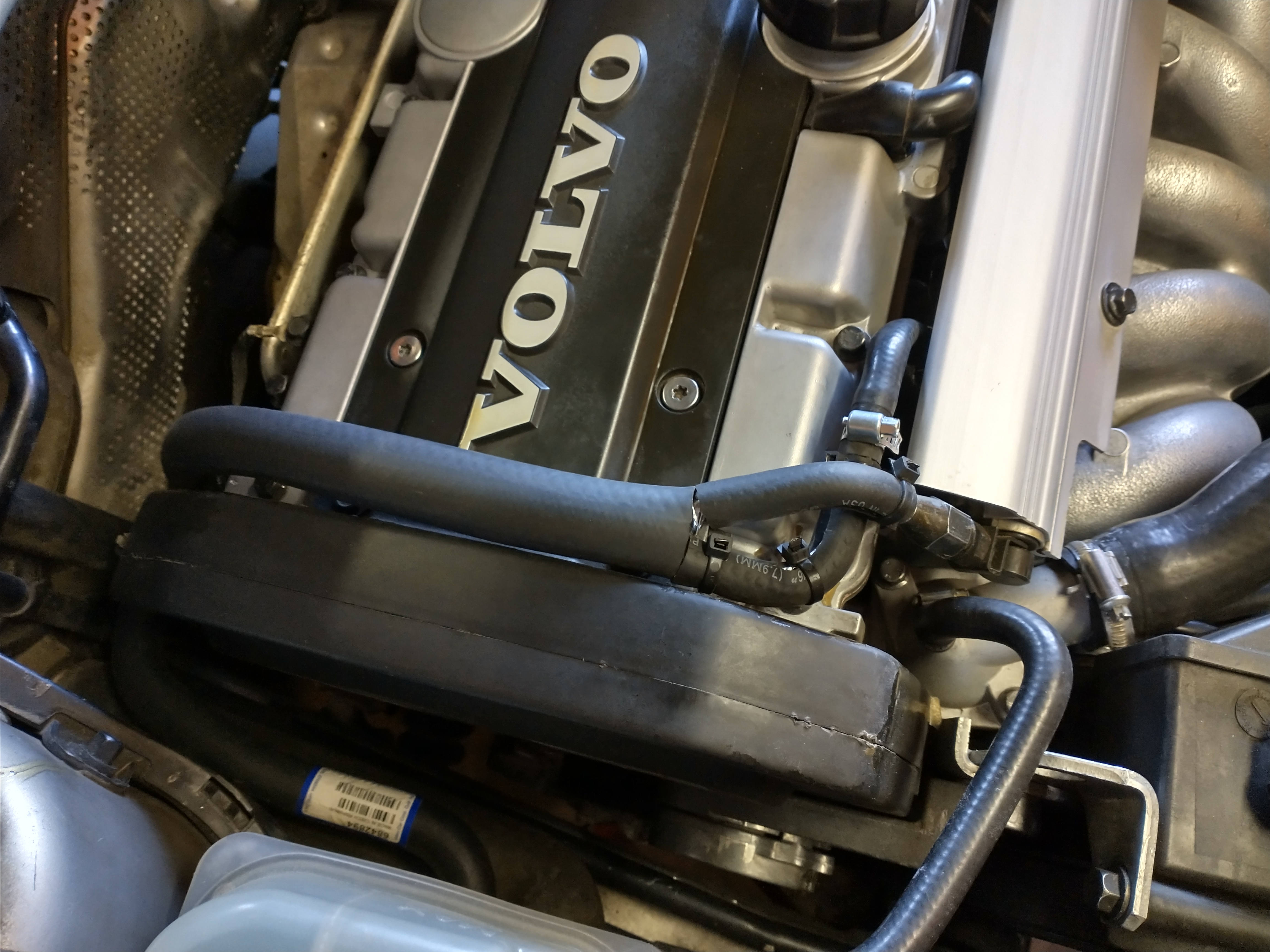

Well this is the result.
I decided that the outer layer of tape wasn't necessary ( yes I realize that none of it probably is ), and might not look very nice.
This I can deal with.

That almost looks like it should have been stock!
Nice job!

Thanks Scot ! I kind of thought the same thing when I was done. With all the other hoses over there, it just sort of blends in.
Only took about 30 min or less to do it, and logically it should be a positive improvement.

It could only be an improvement, it certainly won't hurt anything. Nicely done!
