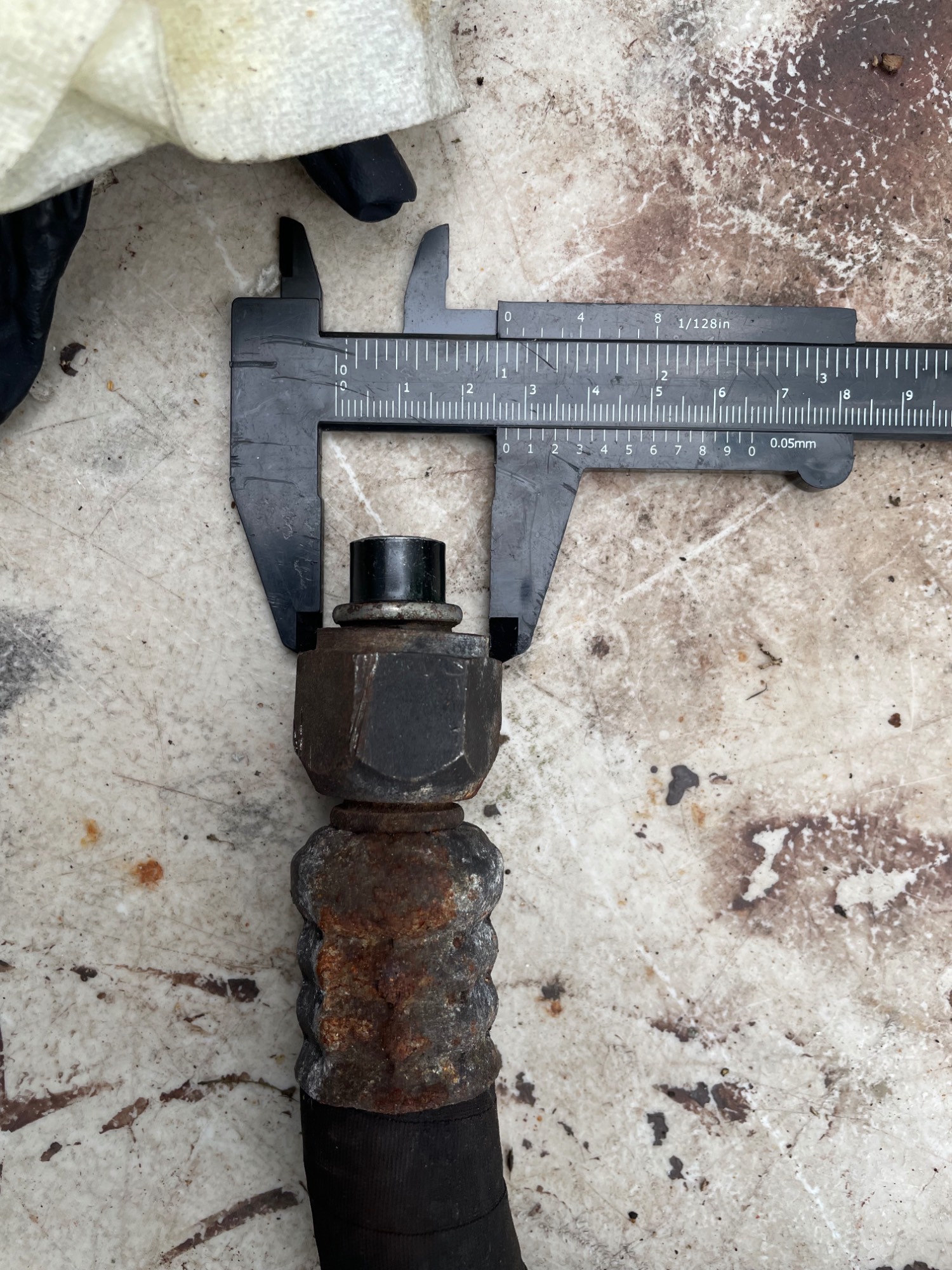

Trick - take the 27 mm union nut to tightness (cant rotate hose) then back off one 1/2 of a flat so you can nip it tight when done. Its not a flare, the o-ring does the seal work

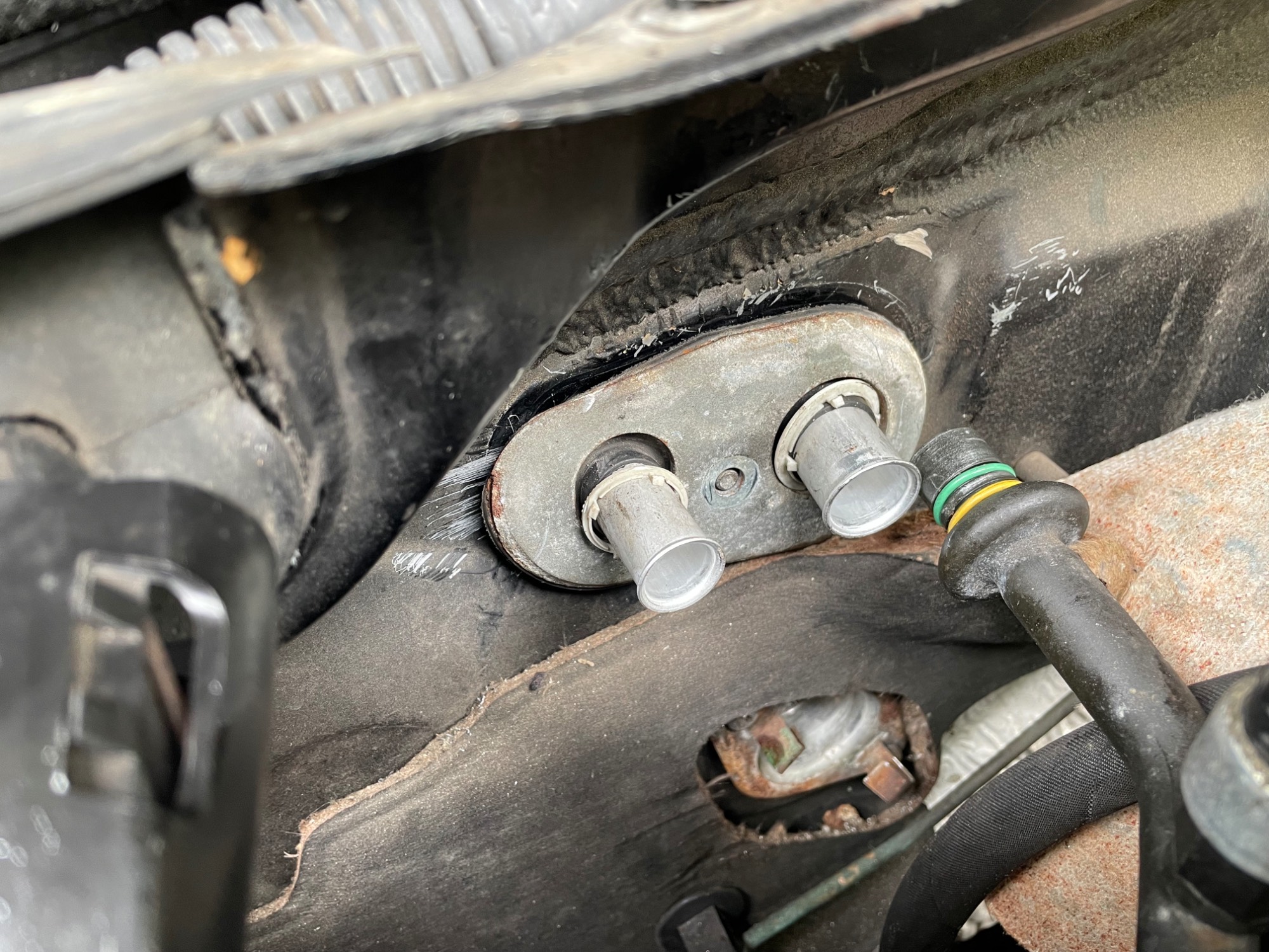

Dont forget to put on \the forward plate on the evap hoses before connecting the hard lines, then add the two plastic keeper washers, teeth facing forward too.
you can bend the evap lines 5-6 mm to get a straight push on the hard line to seal it up.

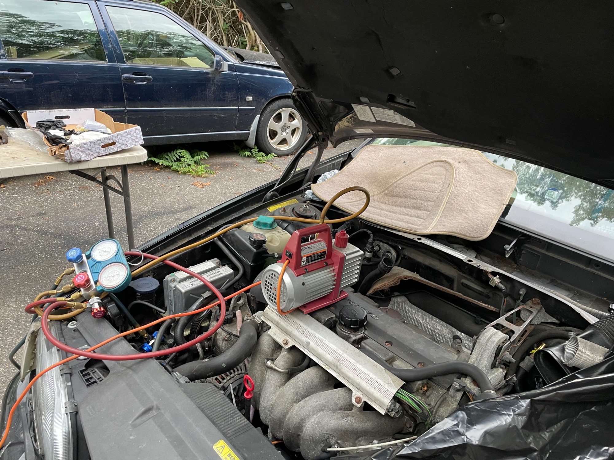

Pumped down and tested System. Home stretch!!

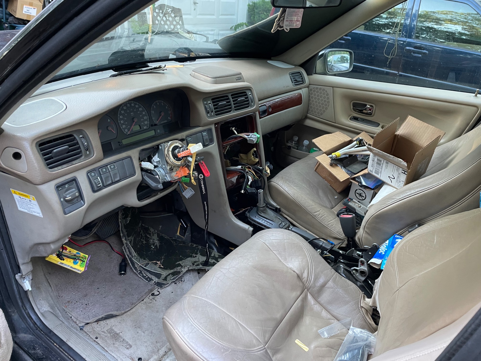

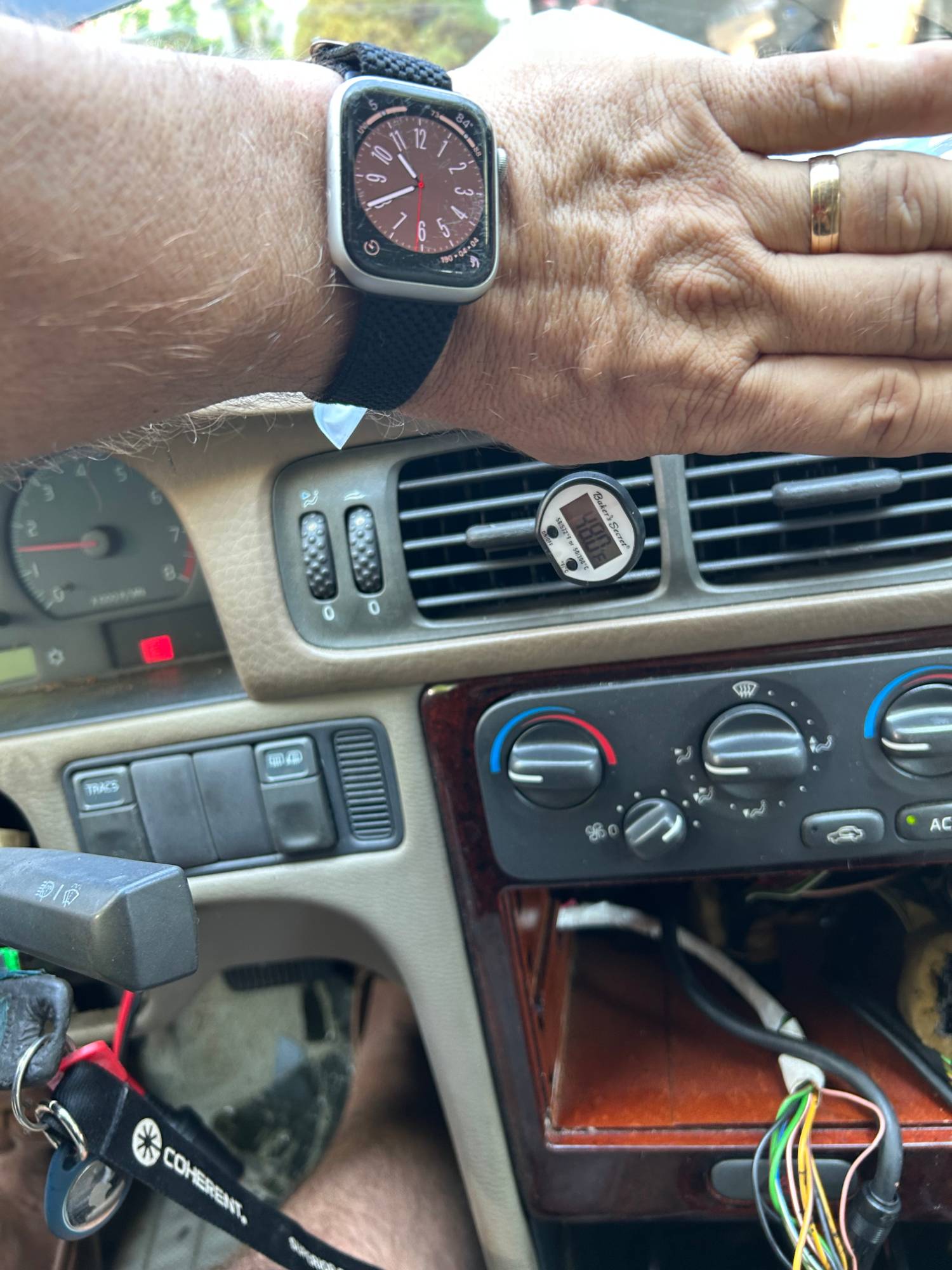

2 hours this morning electrical connections, securing stuff, coolant connections, and got motor running.
Finishing inside as I charged AC, heard the compressor cycling, then steady on.
Acheived 40F delta (RECIRC, fan speed 3, 2000 rpm) and 35F delta on outside air ambient 86F
It felt darn good.

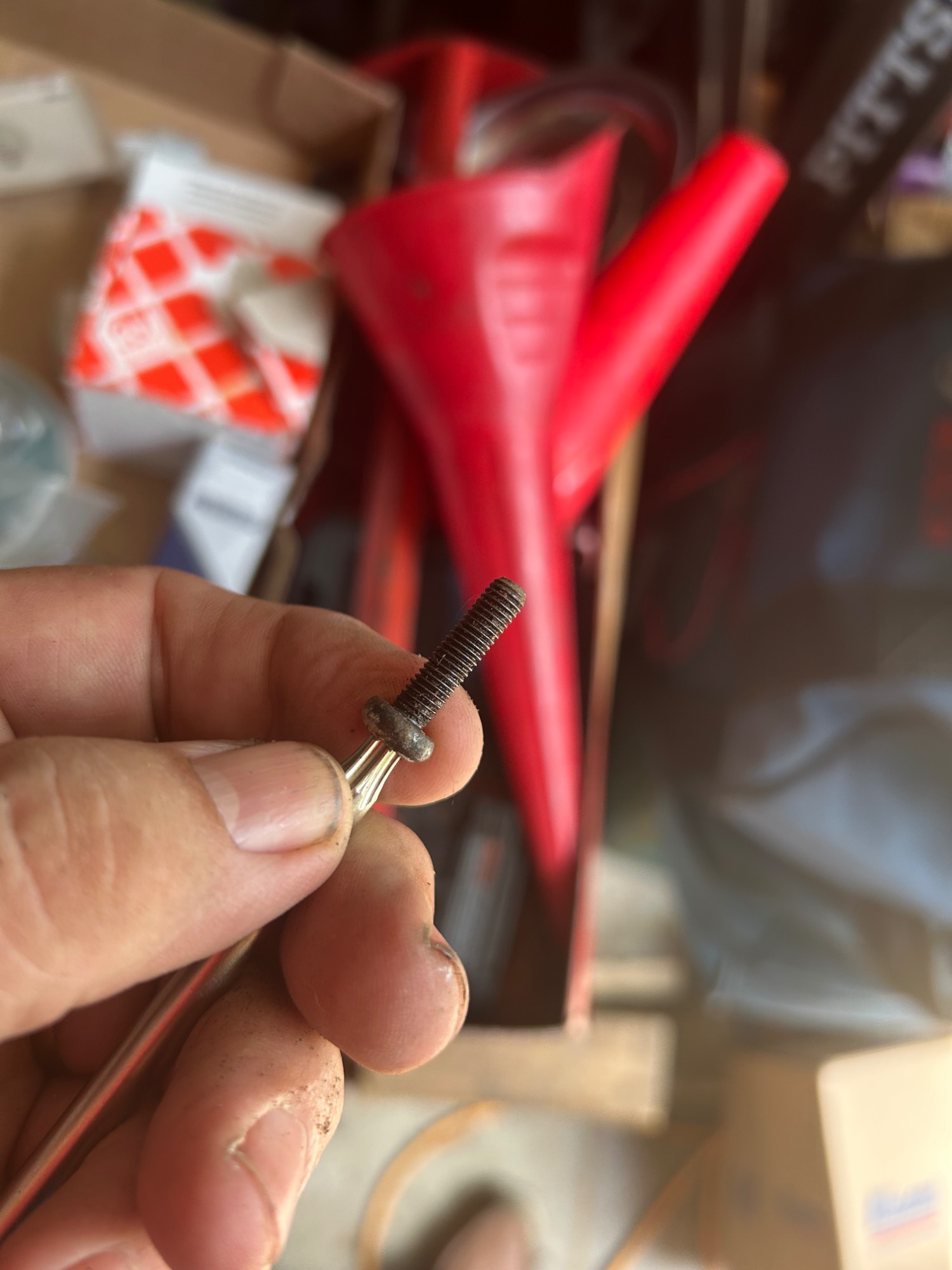

I forgot to nip the final torque on the dryer so had to pull the m6 bolt to raise the dryer enough
A 27 mm crows foot or 1 1/16” Imperial would work there but clearance is tight. Maybe from underneath?
