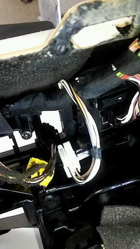

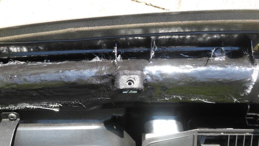

I have done 3 dashboard repairs on S and V 70 1998 and 1999. The last one on a 1999 I used another technique mentioned in another post. I use woven fibreglass sheet cut to an appropriate size and ABS plastic glue. I did not use PVC/ABS combination glue. Overall i liked this process the best. I cleaned the surface with acetone, applied ABS glue, overlaid the fibreglass piece and applied more ABS. I used the same method to rebuild the supports that hold the rectangular nuts. This included the areas around the mounts as well as the mounts themselves. I had the luxury of using a spare dash pulled from the PnP yard. This allowed the glue to cure and I could go back and strengthen any sections I wanted. So far after 18 months I am happy with the results.

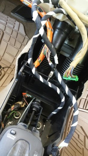

I also used a new technique for refurbishing the foam on the wiring harness. Rather than trying to clean off the sticky dissolved foam I used thin sheets (1/8" thick) of styrofoam package wrapping cut into strips. I then wound them onto the harness in a spiral. Lastly I held it in place using friction tape, NOT electricians tape due to the elevated temperatures in the car. It is what Volvo uses as well. Good luck.

Looks good and solid.

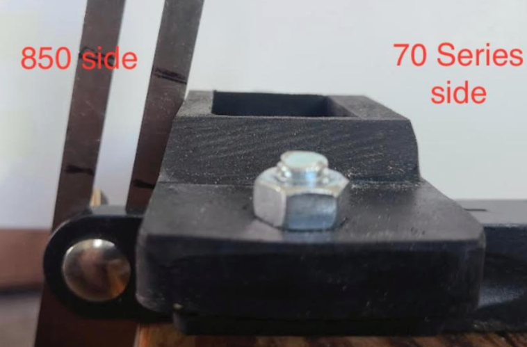

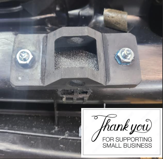

HI Matthew,
In my opinion, I came up with a much better solution to upgrade the P80 Volvo's notorious dashboard panel rattle issue. This design I came up with back in 2019 and they have kept my S70's dash quiet all this time. I sell them through Facebook Marketplace and on Amazon.
