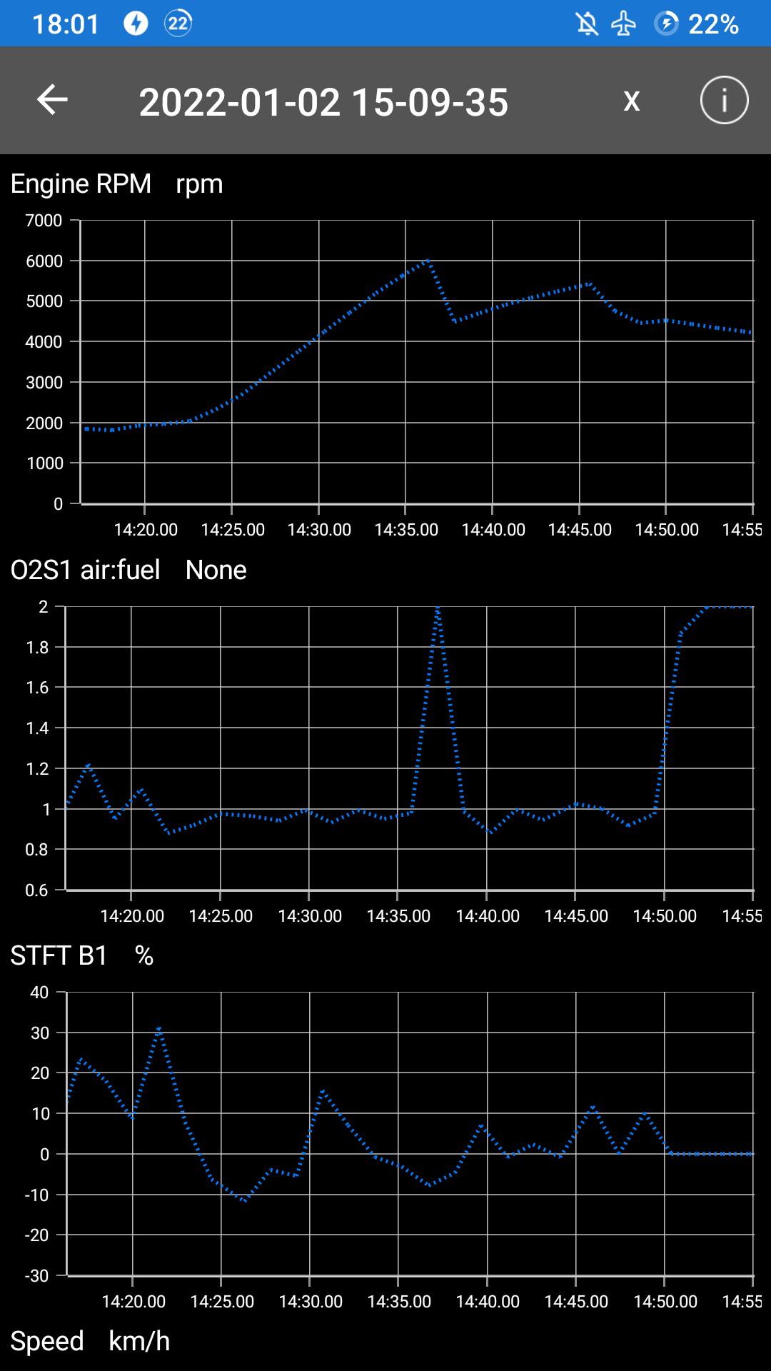

This happened 02 January 2022. Car went back on the road at the end of January and I'm still driving it.
a. 2001
b. S60 2.0T 180PS (B5204T5)
c. I think around 320000 km
d. Around 10k km.
e. LPG (propane-112 RON, so it's much higher octane that I can get from the gas stations. (max 100 octane RON).
f. EKO, Rompetrol (Greek, Romanian).
g. 50/50
h. Average with lots of WOT accelerations.
i. Three people including me in the car during the failure.
j. Highway, winter, so around 0 deg C.
k. It had. Smoked pretty bad at startup. Oil consumption around 5 liters per 10 000 km. Now is around 2.5 liters per 10 000 km
I. Was driving with 5W30 that got changed to 5W40 A3/B4 just a week before the accident.
m. Merging into the highway. WOT acceleration up to redline at 3rd and 4th up to 200 km/h :twisted: , ambient temp around 0 deg C. I saw the check engine was flashing :shock: after i let go of the throttle at 200km/h.
n. 1 valve at the 3rd cylinder (I think it was the fifth exhaust valve from the timing belt.). Cylinder #3 had 6 bar compression while the others were around 13 bar.
o. Red and clean G12+ coolant.
p. Removed head. Got it to machine shop for a full overhaul (new exhaust valve, other valves lapped, new valve stem seals, head gasked, etc...). New LPG injectors.
Log from OBD. Stoichiometric mixture all the way to redline.
