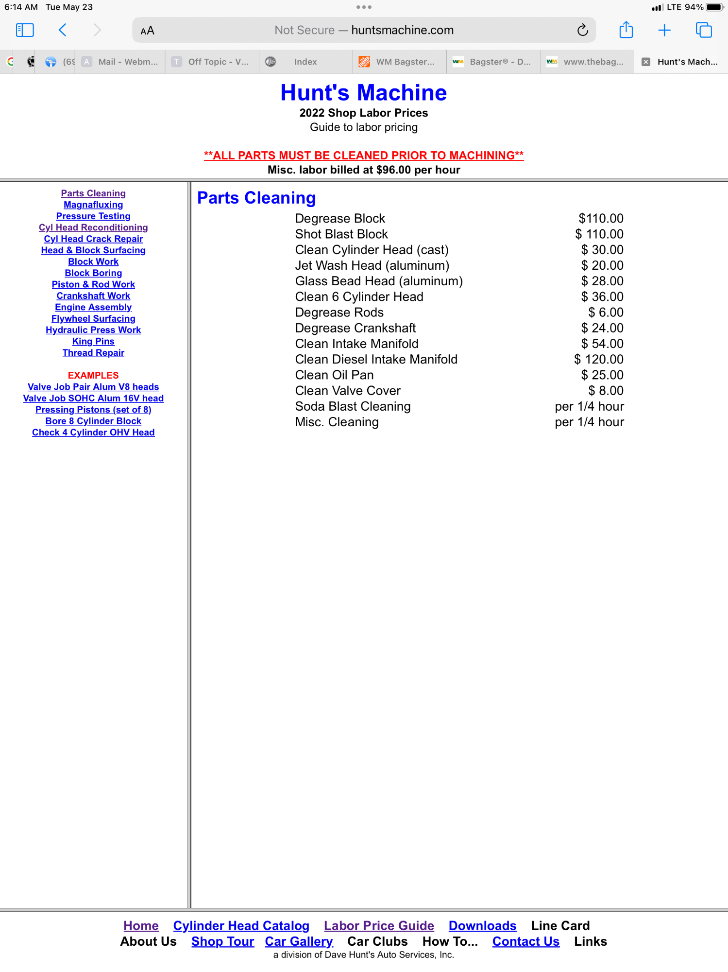

What does a machine shop do during a head rebuild? Could valves be installed at home as a DIY project (with special tools)?
Are new valves so hard to obtain that used and Skandix are our only options?

- A1D7F1AA-F0B7-4716-92EC-3431139DA633.png (559.39 KiB) Viewed 1513 times
- 627C0D76-25DB-49C0-A224-01C7B19F447E.png (775.49 KiB) Viewed 1511 times
