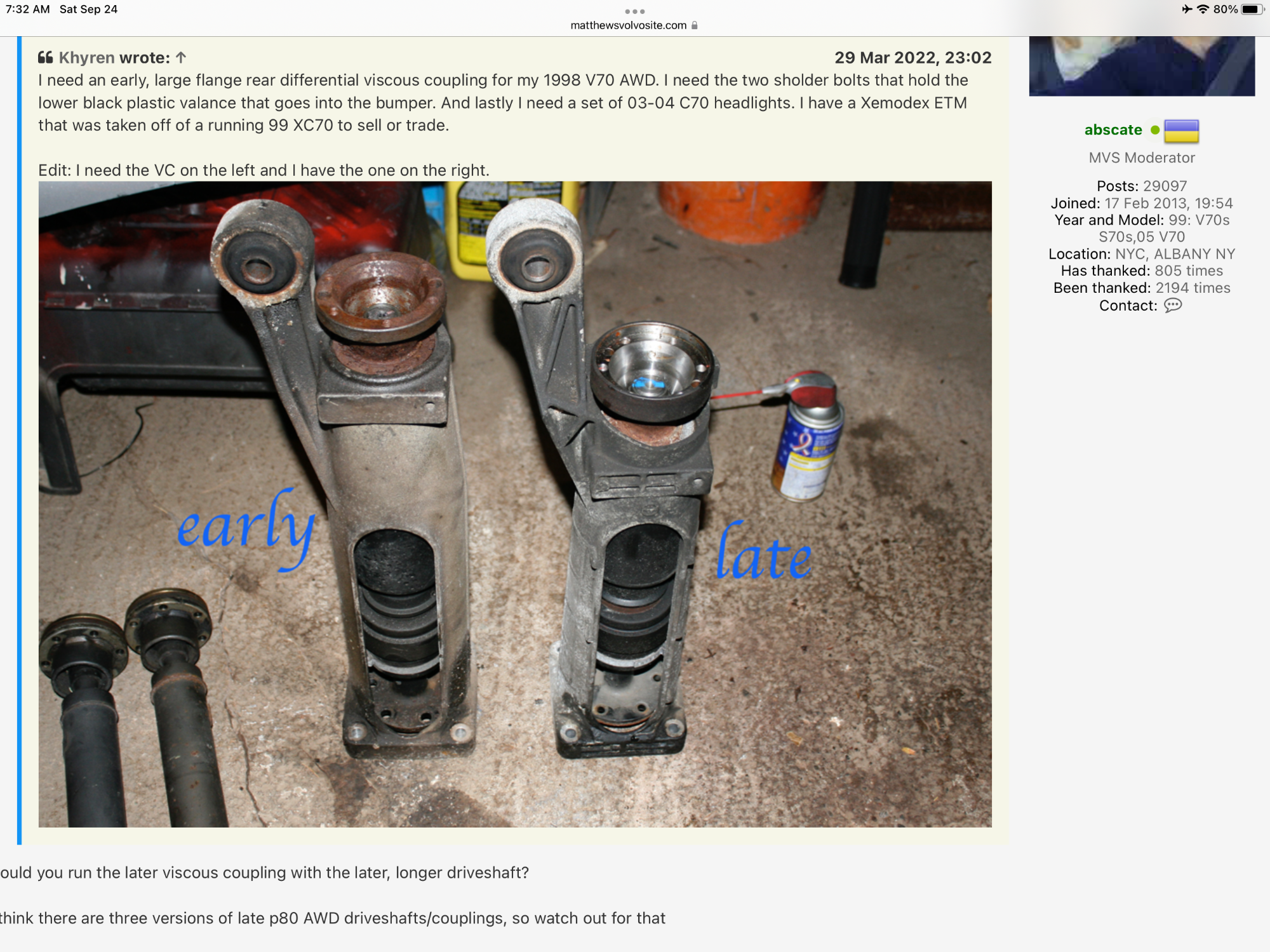

Final piece of data needed. Flange sizes and lengths of shafts and viscous couplers for each of these three options

Both the ‘99 and ‘00 variants use the same visco unit - just the early ‘98 unit is different, and is easily identifiable by its flat flanges (as opposed to cupped on later variants).

And the body is a bit longer, so the most forward arm that takes the last bolt vertical into the frame is shorter.
(Insert picture here)
