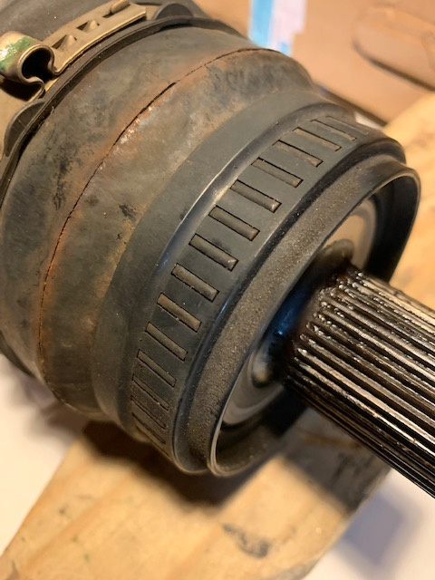

I replaced the front pair with Volvo/GKN. Here is a pix of OE axle at 155,000 miles.ogatrulle wrote: 05 Sep 2021, 20:53 160k miles. Boots are OK. I think it's just wear in the outer joint.
The last 30k miles were put on by teenaged son, however, so it's possible there has been some, ah, "abuse."
