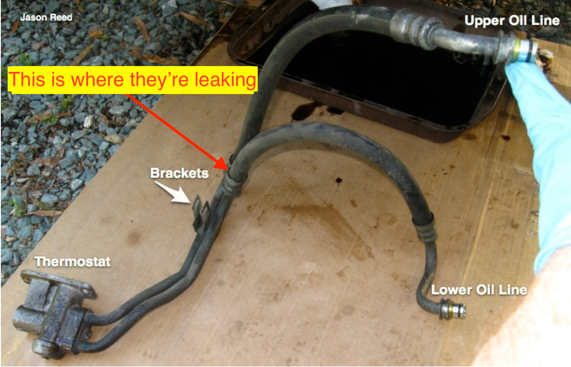

I'm reviving my memory of fixing this issue. The only reason we parked this car was because it was spraying oil all over the front of the block.

I dug up the parts diagram to understand the routing...
Read and watched Robert's DIY's.
Read through this seemingly complicated process of replacing them with new....
Volvo 855 Oil Cooler Line Replacment rev0.pdf
(6.06 MiB) Downloaded 23 times
And dug and dug to find the thread about making your own with industrial Volvo blue hoses. That's what I was going to do, seems simple.......maybe.... And LOOK, Sir Abscate, Oetiker clamps!!
viewtopic.php?t=86914
But after reading Robert's comments about no significant cooling happening with this system, I think I'll go with the cover plate and bag all this.
https://www.ipdusa.com/products/56831/O ... _jVBbEN4CZ
Sometimes these are on ebay for less.

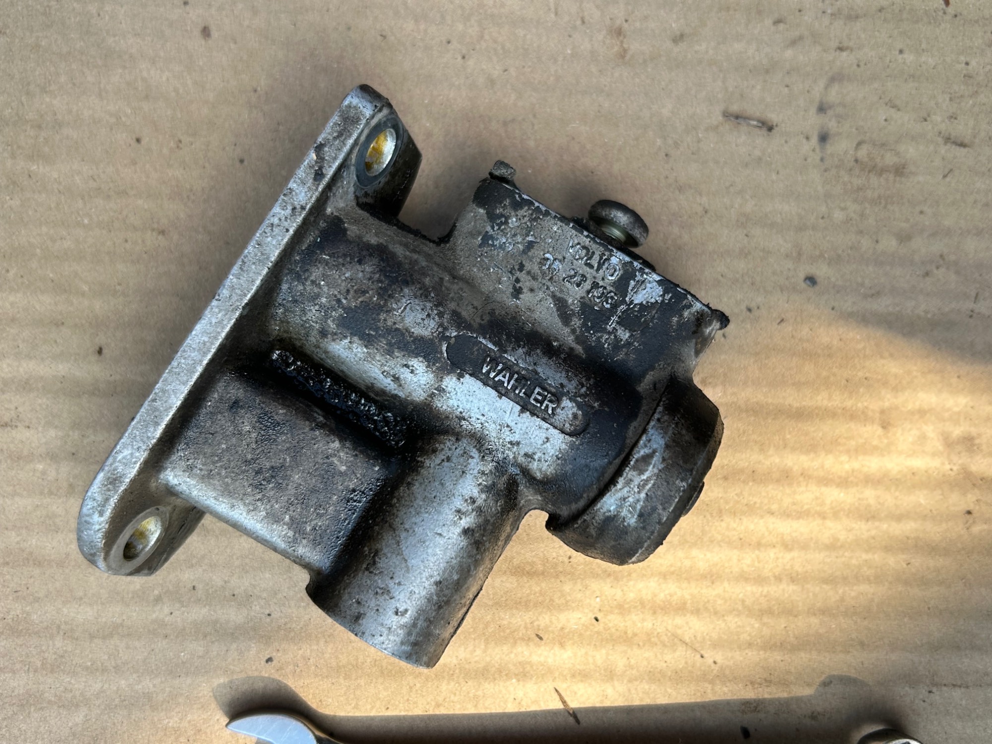

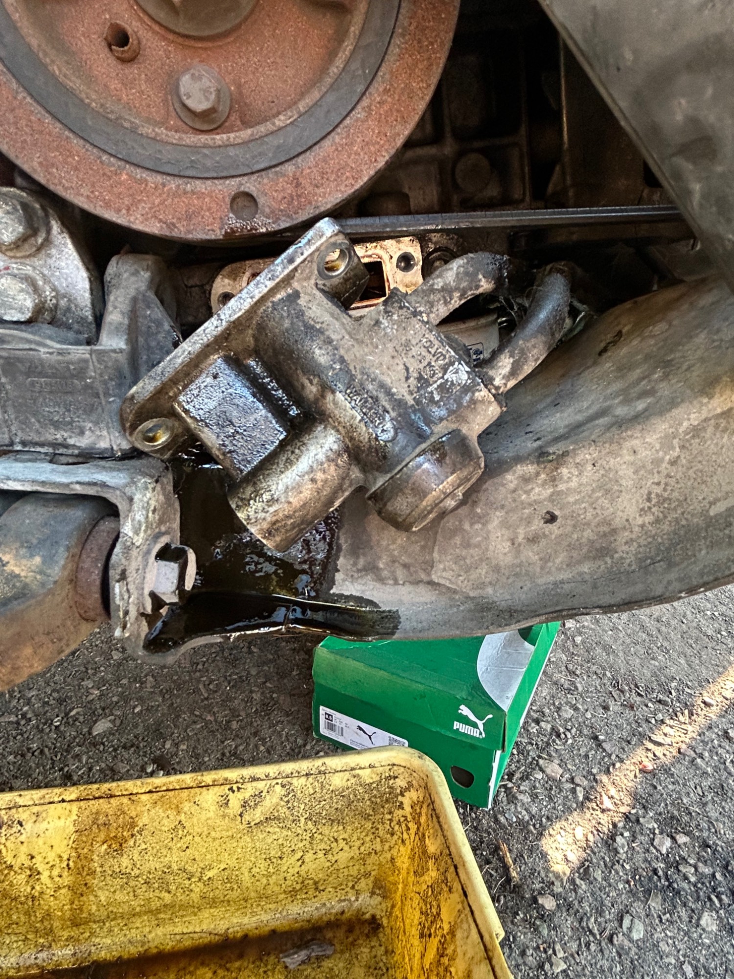

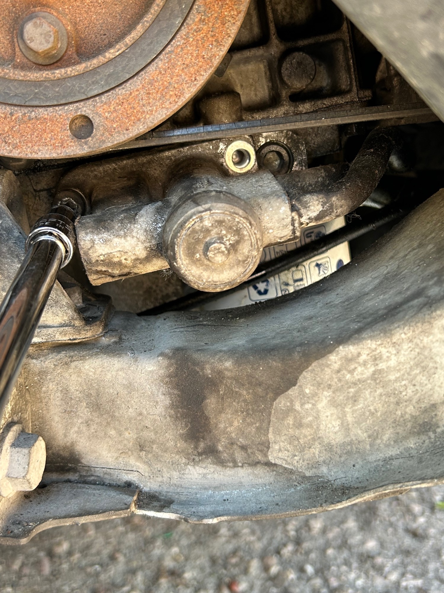

My tires still aren’t mounted, but the car is up on jackstands, so I dove in to remove this system.
There is no need on mine (‘94 T5) to loosen the motor mount and raise the engine - it’s right there visible behind the plastic fender liner.
The T40 with a medium extension popped the thermostat / manifold right off. Figured out the hose clips on the radiator, popped the lines off. Fought to get a tiny 10mm on the oil pipe bracket blind - I just pried the bracket apart and made room. Snipped the hoses so I could twist and wrestle the pipes out the passenger wheelwell.
Some oil dribbled out, medium brown. I may push more out of the radiator with an air hose. Need to find the box with the new cover and o-ring, clean up the oil, and bolt it up. If anyone wants a functioning thermostat manifold it’s yours for shipping.
