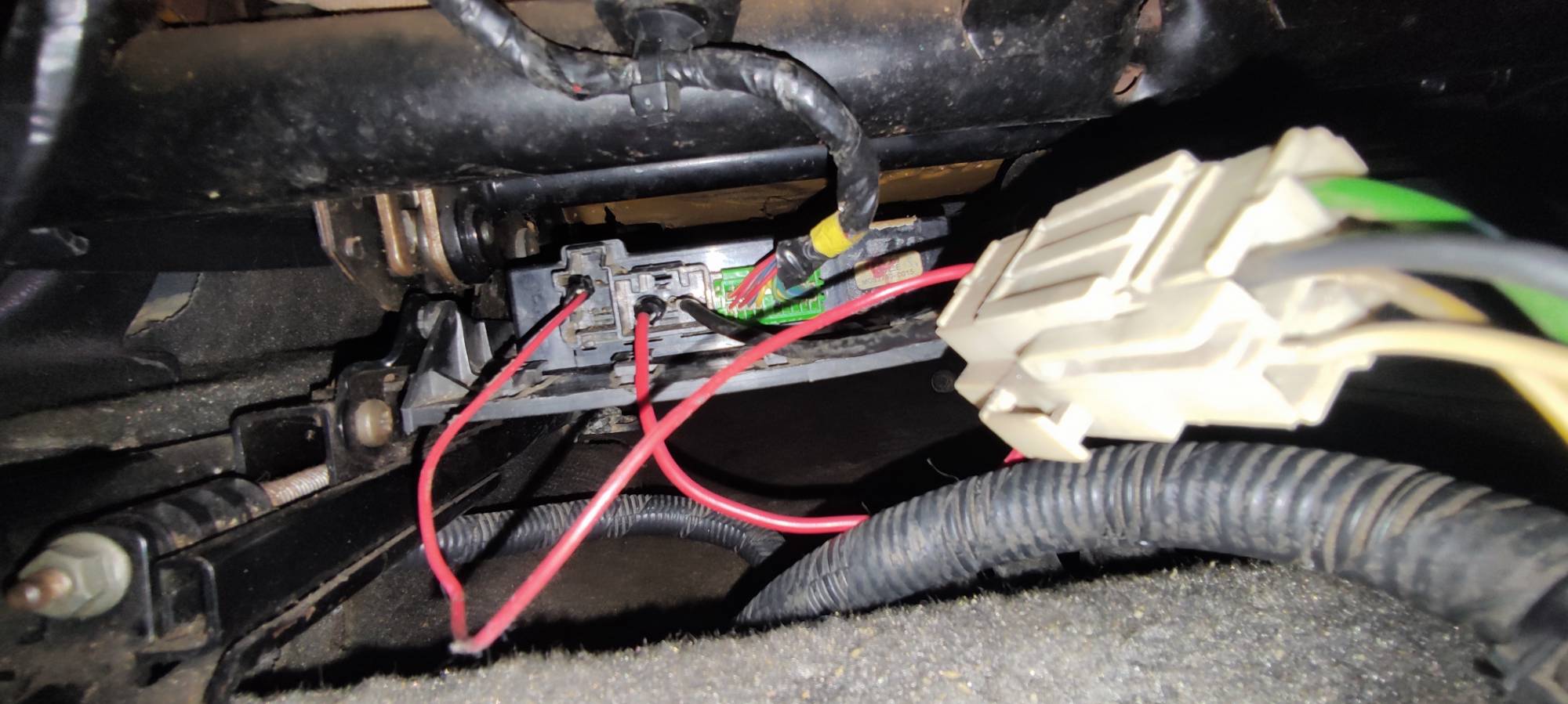

Hello, I'm installing a p2 seat in to v70 P80 at the moment, mounting done with no problem, passenger seat done all electric work.
Now the pain starts on the driver seat. Electric didn't work. Any idea what I should do to make it work? Anything pin to bypass? As seen in the picture below, my mate told me that on the left socket that B1 is (+) B4 is (-) but still not working. Help anyone?

the non power seat cars were missing the relay. Probably that's all it is.
