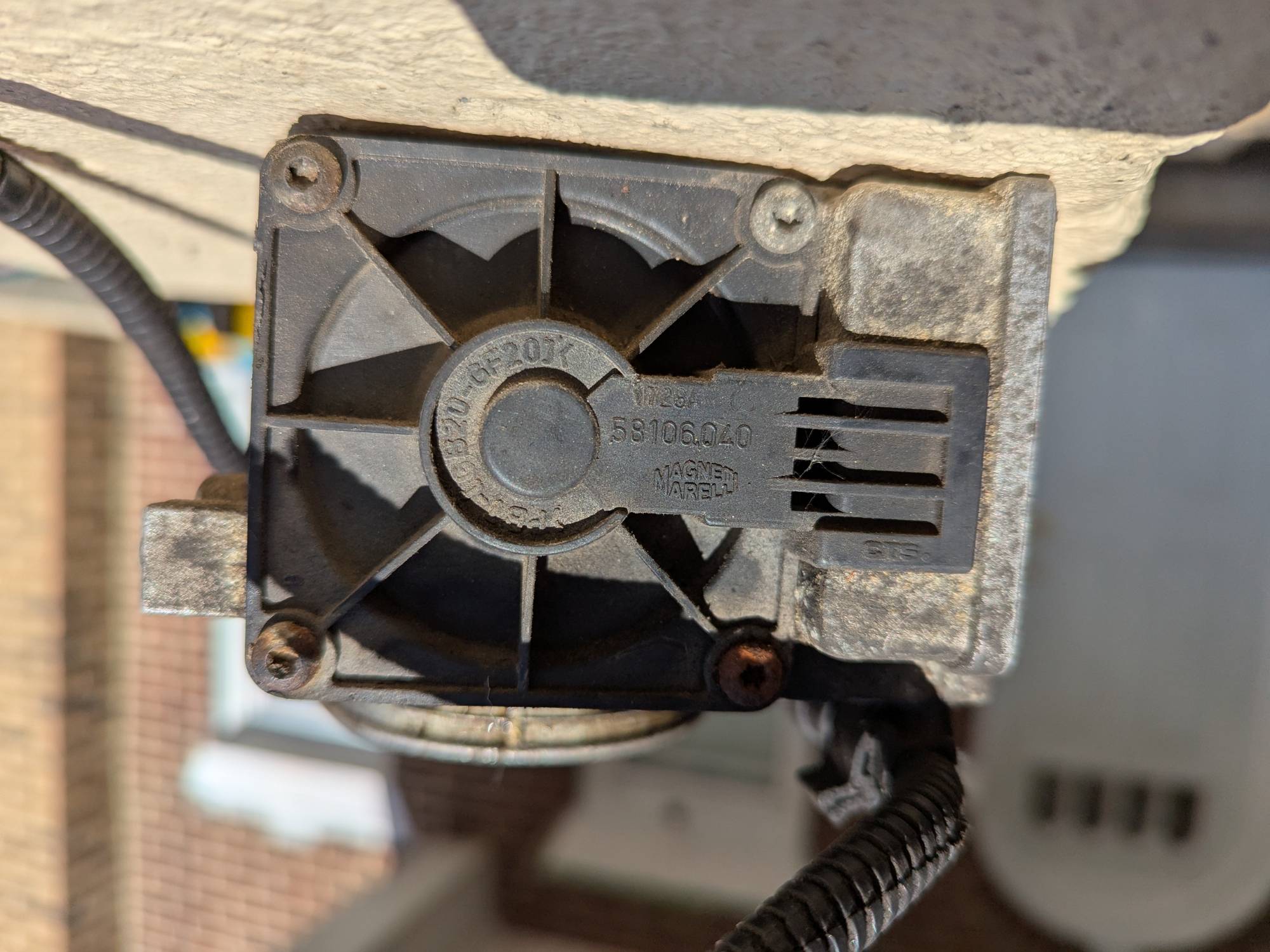

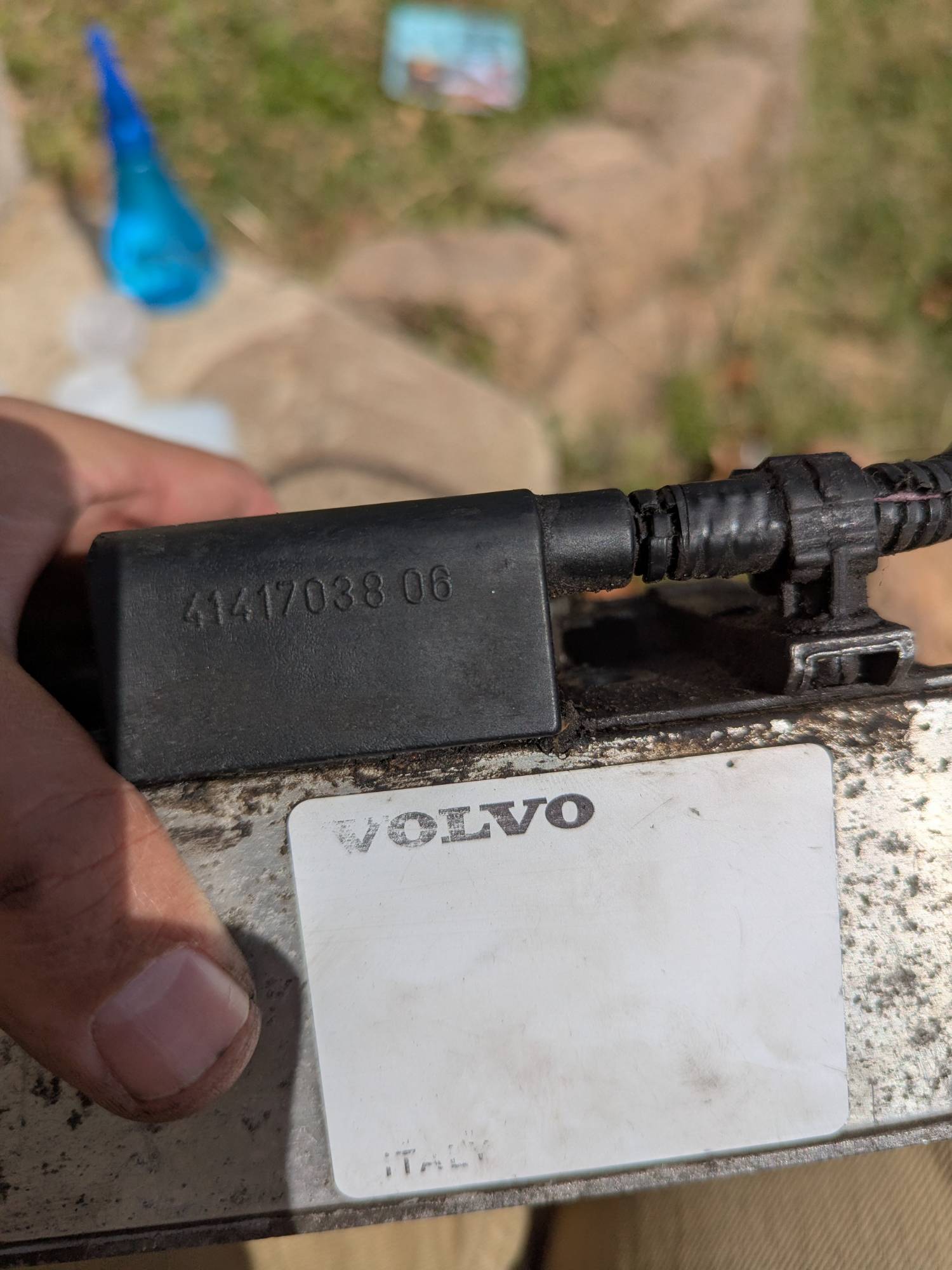

Physically, all three units fit all these cars, they mount with 4 M6 longish bolts.
Software in the ETM must match and marry with software in the ECU. There is no way to tell what software is in a junkyard ETM unless you can power it up in a car. There have been many upgrades , too, so the date and part number dont tell you what is actually installed.
Most cars wont use more than one replacment, so a yellow label ETM almost always has life left in it.

Finally got a clear shot of the label on my ETM
Seems like the original lasted longer than most

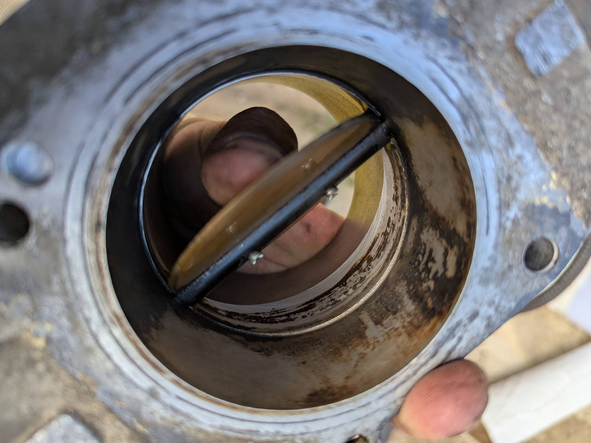

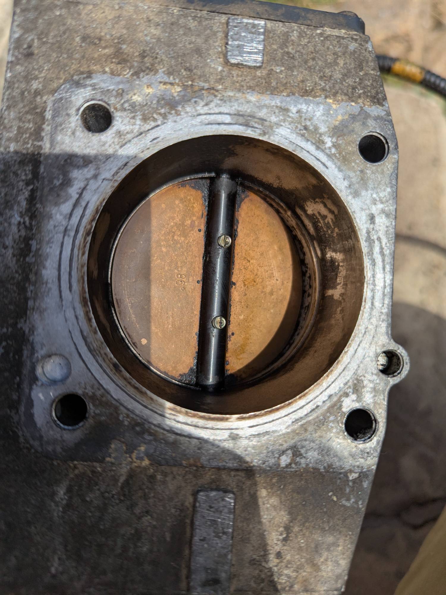

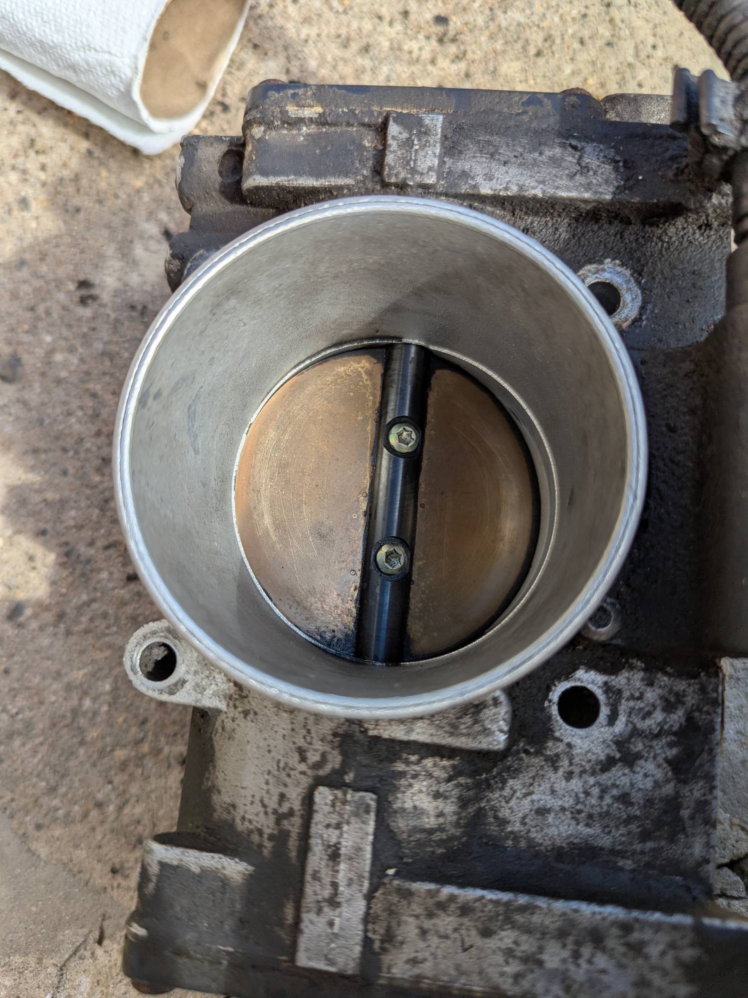

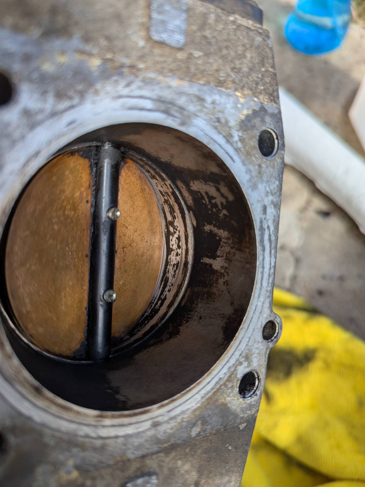

Well I made it out to Allentown and they did have a 99 S70 GLT but it doesn't seem like it was the updated part after all.
I still picked it up for 50.00.
Even though the VIN did confirm the correct contactless part number I believe this is a case of the Volvo genius superseding part numbering system where the 'replacement' etm part # is now tied to the VIN instead of what it shipped with.
I am including some picts to see what you all think about the cleaning job I did with plate and the bore and if it is good enough.
There is some staining but the plate seems to move freely.
It was very dirty. I am now wondering what will happen if if just give mine the same cleaning.
I figure between the two I should be back and running full strength( at least for a while) and I can save and send the unit I don't
use to XemoDex at some point to become contactless.
What say you all?
And-- Thanks!

That is the problem with the labels on these, that if you use cleaners the info disappears on them! The main parts to try to make sure are clean is the area near the throttle plate. Build up in the areas where that operates is where most of the issues happen. That and the wipers that determine where the throttle plate should be wear out. No amount of cleaning fixes that.
I have spent hours cleaning ETM's and have managed to get them pretty clean. The bigger disappointment for me is how rough the castings are in the first place.
It is a pain getting the connector separated at the bottom of the radiator area on the engine harness. You can plug in the 'new' on and get someone to switch the ignition on to Posn II and watch the throttle plate as it zeros. If it moves and buzzes initially it is likely going to work, but how good it is you won't know until you fit it.
Cleaning your own one may improve it, but if you are getting codes thrown it is unlikely. I guess just say never say never!
Good luck!

In that case everything is moving freely so probably clean enough but I will give it another pass.
I will test it with a 'plug in'- then probably just mount it and consider my original later.
As it is in limp home mode and ETM codes and ever since we owned in in 2010 it has thrown the occasional TPS code.
Any tips on removal? I don't mind removing a few extra things for more space but also a big fan of minimalism in removal too.
At least this is a direct 99 turbo GLT to same.
Hopefully it has some life in it or it's yellow label action next.
