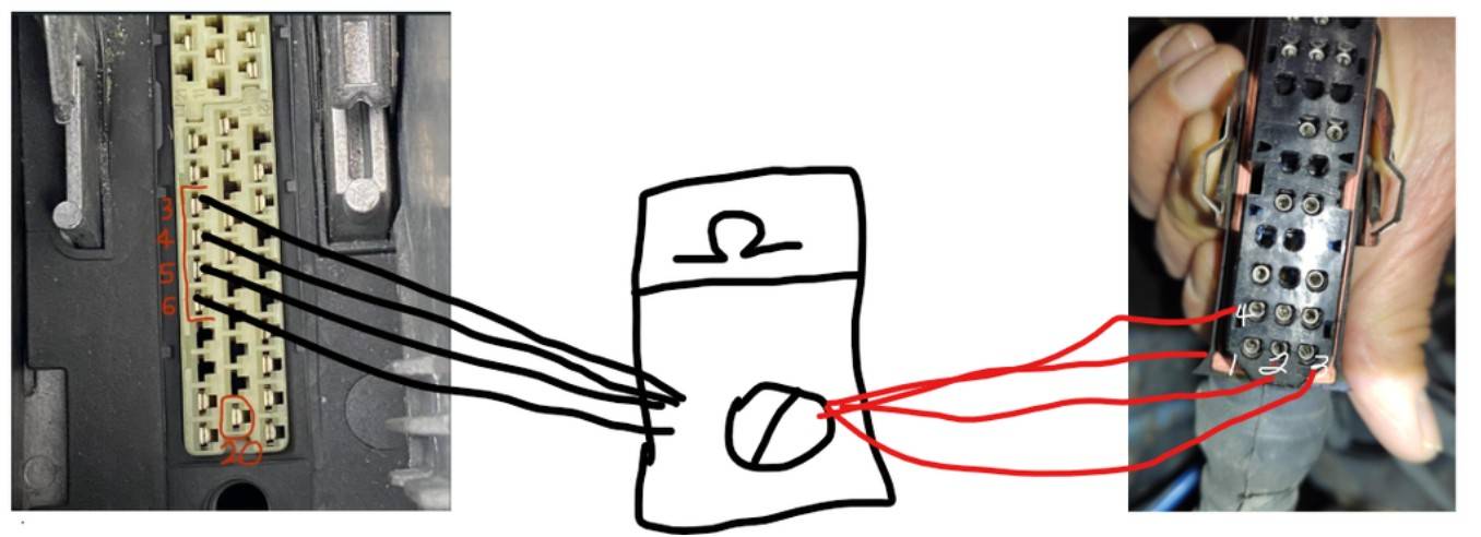

Thanks for your reply aeg. Sounds like you've had this issue yourself. I was testing at the wrong end of the TCU connection, so I retested and these are my readings. So, I'm not getting continuity on quite a few pins where the X is, in relation to the gear position and pin.
TCU continuity test.jpg (20.21 KiB) Viewed 286 times
At the TCU connection where the TCU module sits in:
Continuity between A3 and A6, I get nothing, just the '1' or 'I' displayed. ***I hope I did this right like so.
A3 to A6.jpg (105.7 KiB) Viewed 279 times
Continuity between A3 and A20, I get nothing, just the '1' or 'I' displayed. ***I hope I did this right like so.
A3 to A20.jpg (105.13 KiB) Viewed 279 times
Continuity between A20 and A29, I get a reading of 001 (and the beep). ***I hope I did this right like so.
A20 to A29.jpg (105.6 KiB) Viewed 279 times
At the wiring harness connection:
Continuity between pin 1 and the metal casing of the PNP switch, I get nothing, just the '1' or 'I' displayed. ***I hope I did this right.
Continuity between pin 6 to pin 7, I get a reading of 001 (and the beep) and I connected my multimeter like this:
Screenshot 2025-12-29 160550.jpg (44.76 KiB) Viewed 278 times
When you mean Another thing worth checking is resistance from the metal casing of the switch to the metal casing of the transmission. If this is open circuit, then the TCM won't see any of the gear selector inputs. do you mean place one probe on the PNP switch case and the other probe on any metal part of the transmission, as indicated by the blue line?
Screenshot 2025-12-23 151832.jpg (93.46 KiB) Viewed 286 times
I also checked the connections between the TCU connector pins and the plug with the pink gasket (which plugs into the connector next to the PNP switch. I connected my multimeter like so:
These are my readings (TCU pin number on the left, pink gasket pin number on the right). I get a continuity beep each time.
3 and 1 = 002 ohms
4 and 2 = 002 ohms
5 and 3 = 002 ohms
6 and 4 = 002 ohms
I really appreciate your time with this.

OK! So the switch contacts for C, PA, 50S and BL are good, but A and B are open circuit. Also, the wiring between the ECU box and the transmission is OK. You need to replace the switch or redo the repair.
No need to measure across the blue line. Now that we know A20 to A5/A6 are OK, we know the ground connection of the switch is OK.
