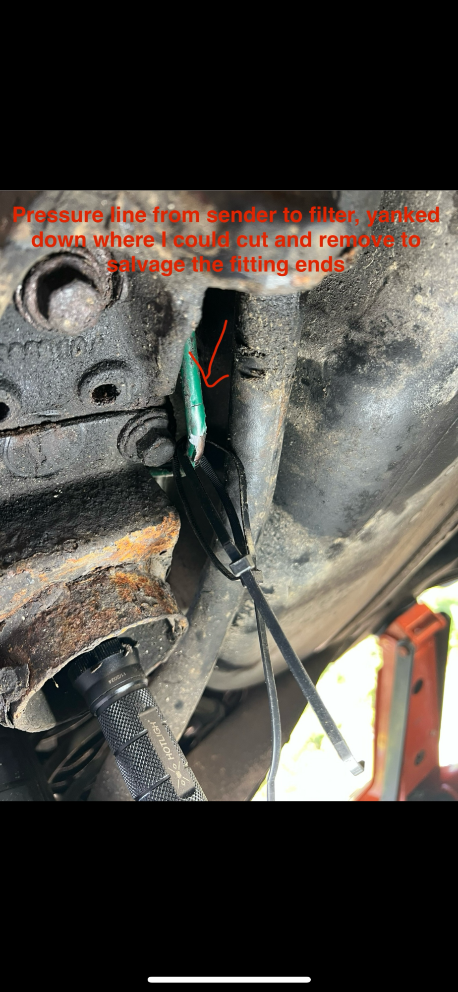

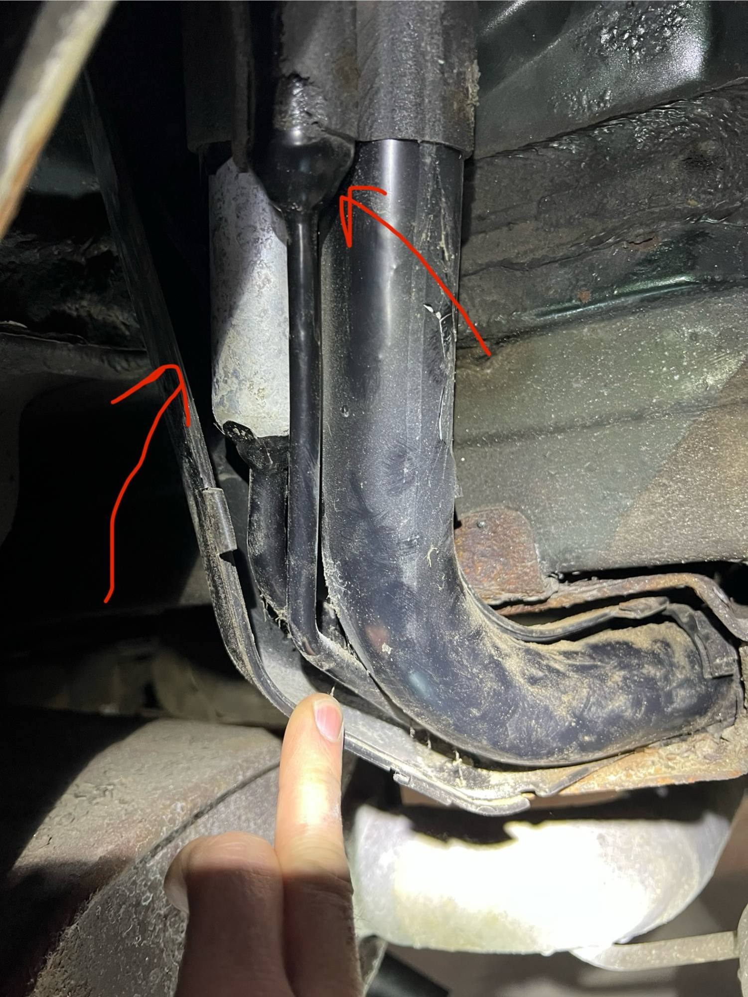

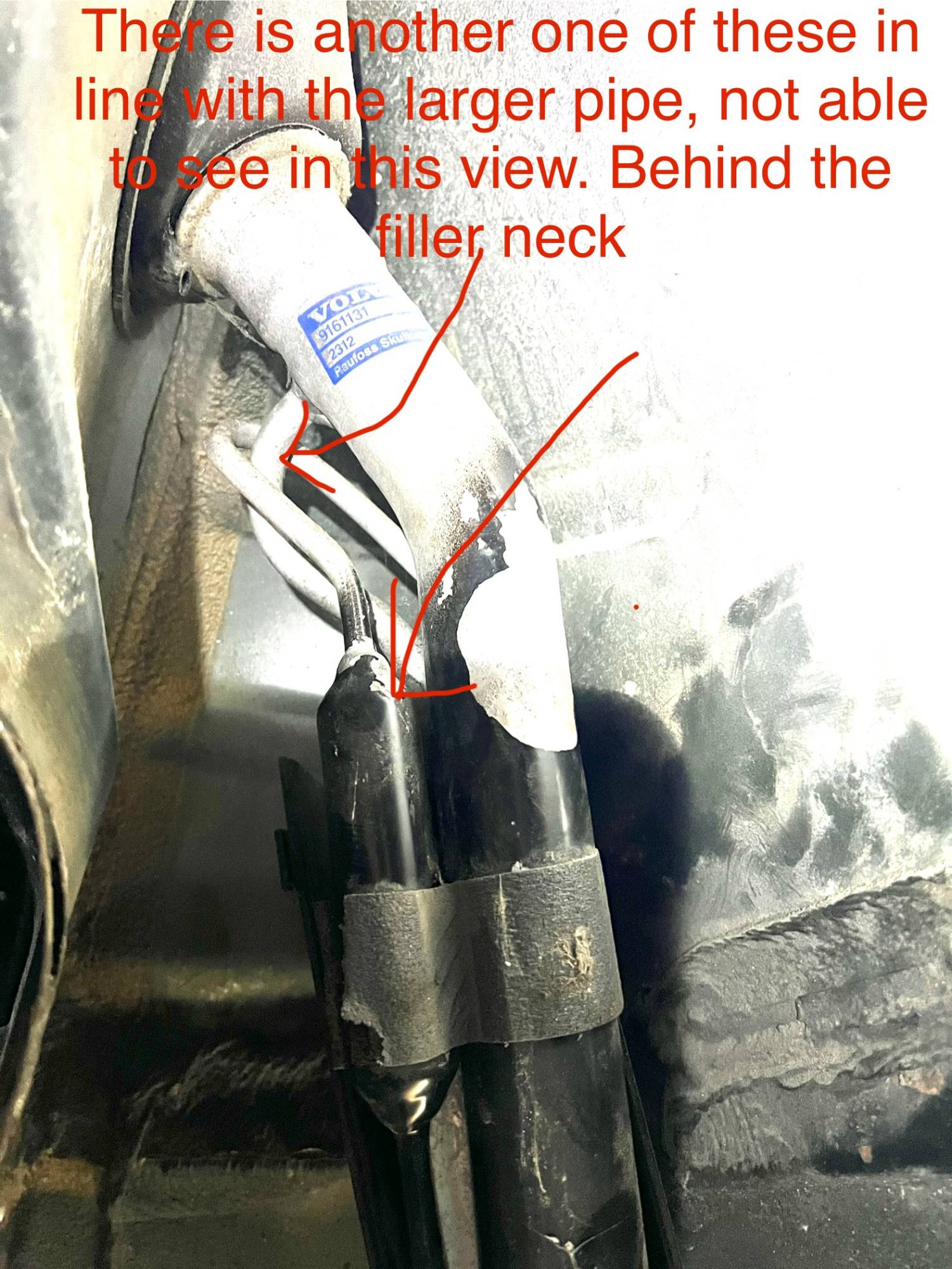

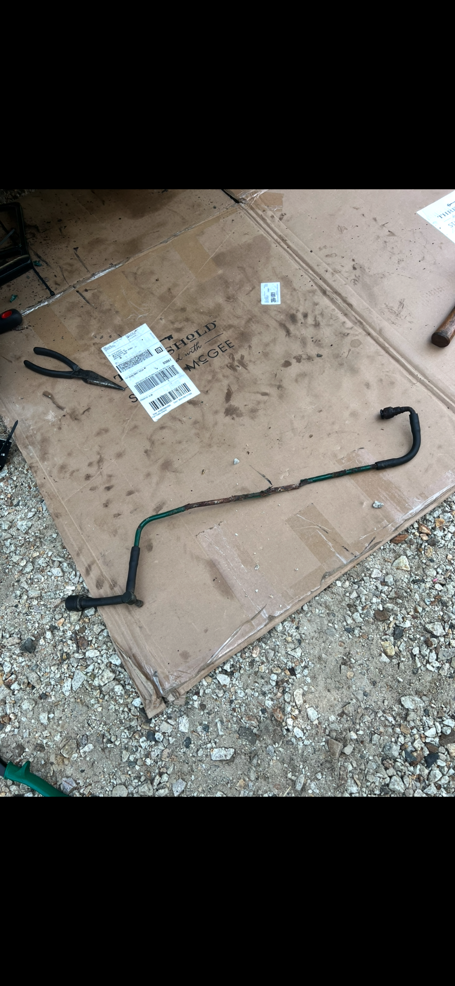

Now that i'm thinking back to when this began, it was shortly after I had replaced the pressure line going from the fuel filter to the sender. My car is in rough shape so dropping the subframe to get to the fuel lines running above the tank was not an option, it would total the car (it is held together by rust, lol). Long story short I had to forcefully remove this fuel line sandwiched between the frame and gas tank on the passenger side in order to salvage the ends with the fittings. I just looked under the car and the hard plastic line that goes up to my charcoal canister labeled “tank”, follows the pressure and return line to gas tank and then disappears above the tank back to the access hole area in the trunk. I disturbed the pressure line aggressively, so I wonder if I pinched that plastic "tank" line somewhere that I can’t see. I might try splicing in a new section with rubber hose to test this theory. See pictures below which might help explain things.

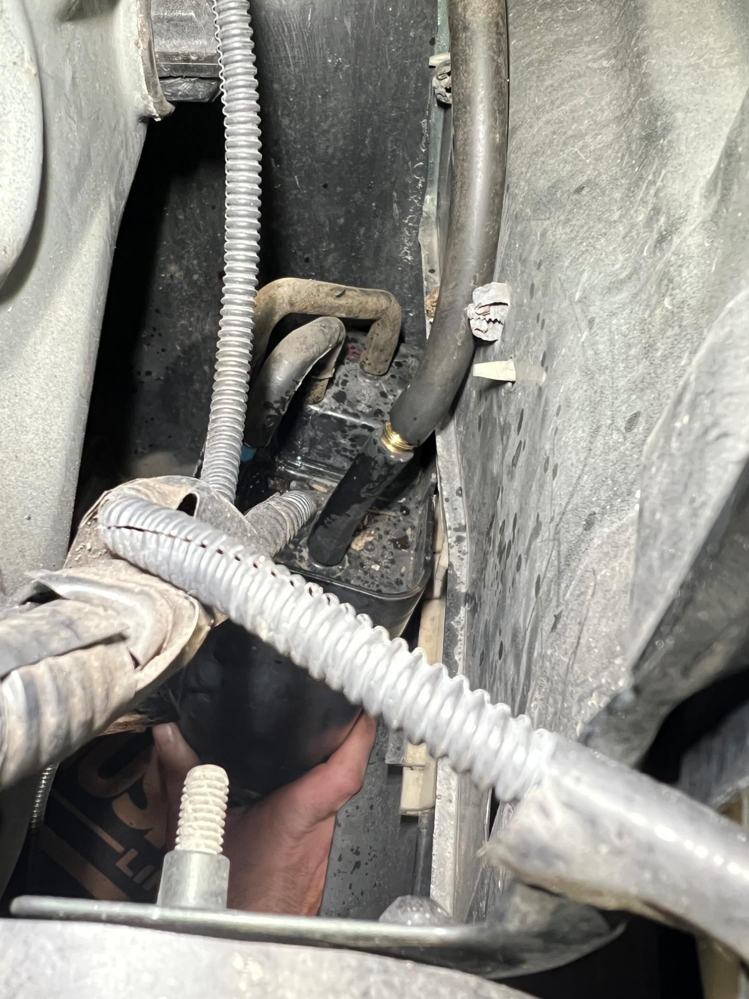

abscate wrote: 04 Jan 2026, 18:51 I have never heard of an xc70 with the charcoal canister up front. Look from the rear of the car underneath amd confirm you don’t see the canister back there.
It’s real. And it is very easy to access the connections by removing the driver side blinker. If I need to remove it it’s one bolt and it drops down. This picture is looking in through the blinker

Wow. That’s truly a bizarre hybrid setup. I looked on online Volvo parts and found no corresponding diagram.
That looks like the late model rectangular carbon canister mounted in the earlier driver fender location.
Jimmy57is probably your only hope as to how that it plumbed.
There are pictures and diagram on the Ekaterina resurrection thread but those are all the later rear canister models from 99 on
