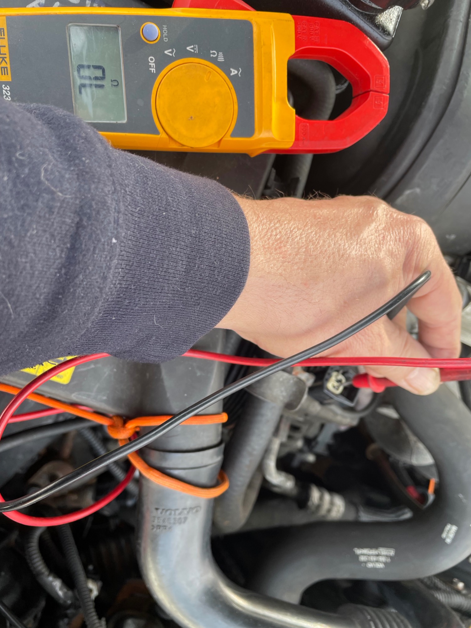

Hard cold start. Engine rough running for about to seconds, then fine. Temp gauge on dash normal.
At 37F ambient , ect connector shows infinite ohms, open circuit

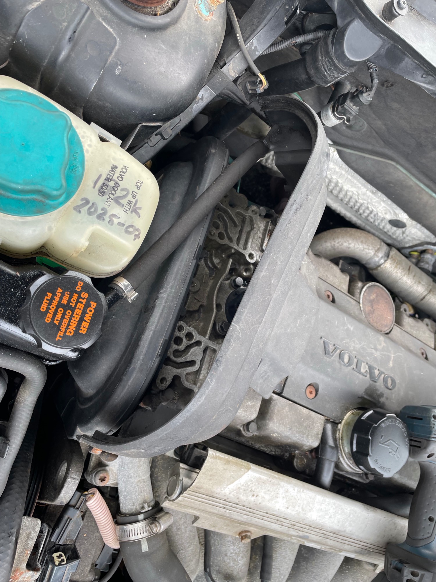

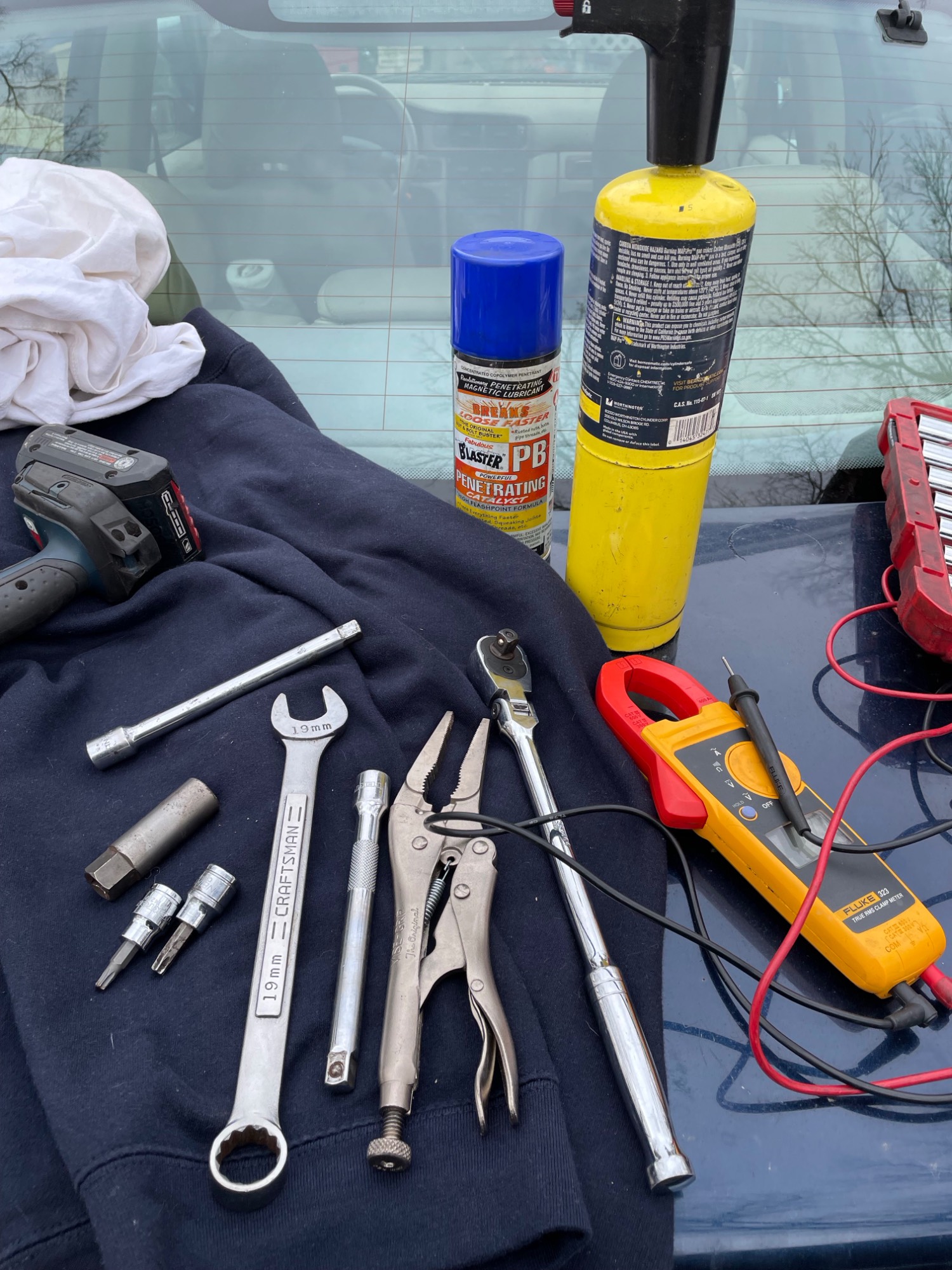

Off we go , tools used
T40 torx thermostat cover bolts
9/16 fluted extractor socket
T27 torx cam cosmetic cover bolts
19mm open end
Pb blaster
Mapp gas
New ect sensor
2 new bolts
Posts: 35267
Has thanked: 1497 times
Been thanked: 3809 times

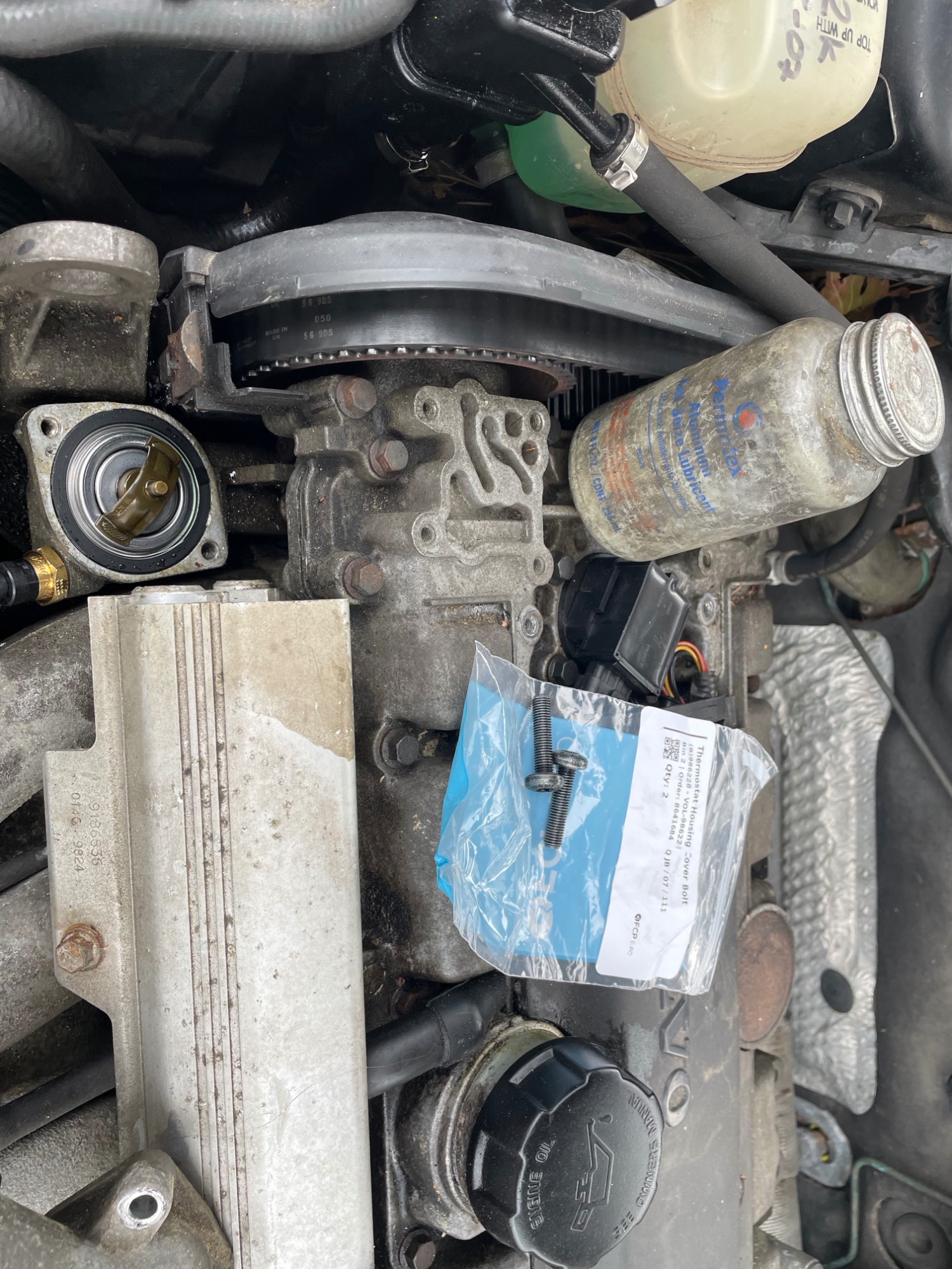

T 27 and clips release the cover, nice access on the RN motor

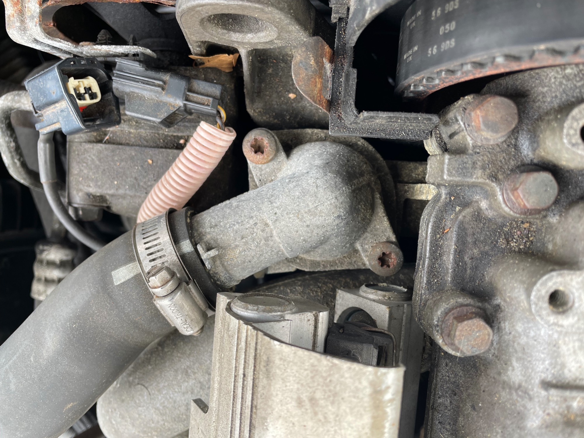

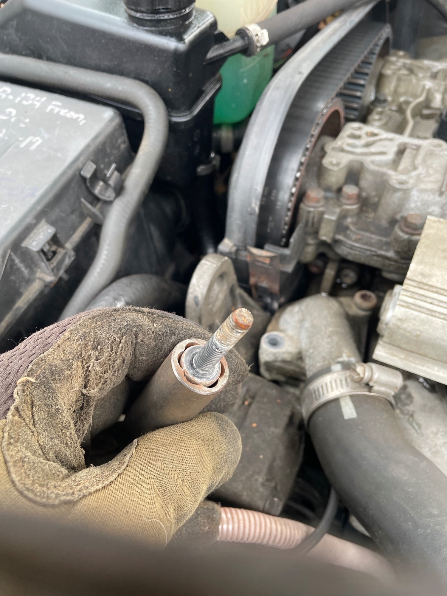

Bolts looked hood, so I put a bit of PB on them and they cracked….. but I grabbed the T40 R bit by mistake and snapped it off
Used Mapp to warm for 30 seconds and the 9/16 fluted extractor

Ect comes out with a 19 mm open end
Reuse those old bolts, no thanks

Lots of no seize on the bolts , top off coolant, and get Juno the dog to sign off on the paoerwork

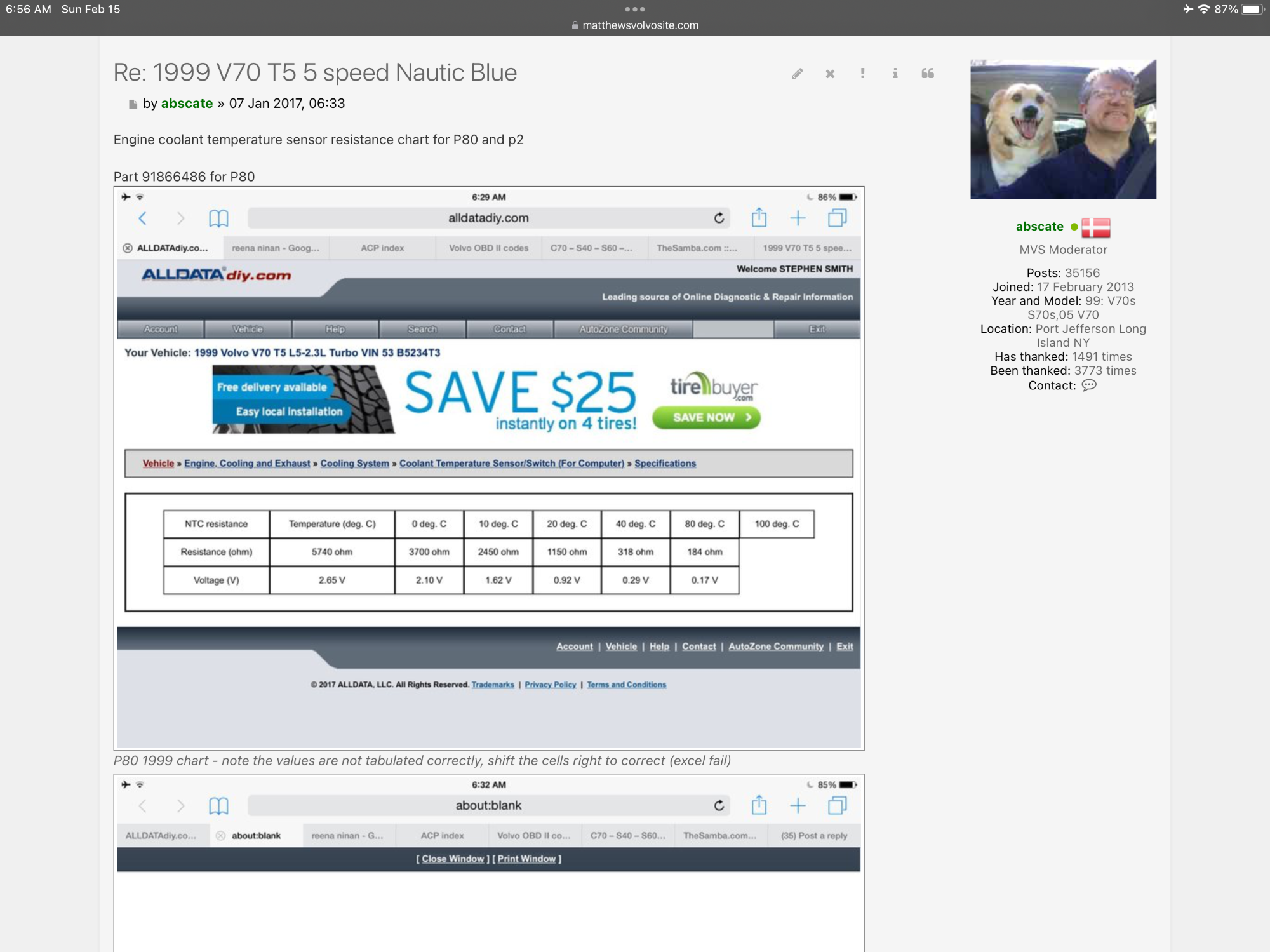

New sensor showed 4300 ohms at 35-40F ambient
Volvo chart calls for something like this
Note chart values are shifted by one column , editor fail

abscate wrote: 15 Feb 2026, 04:44 Bolts looked hood, so I put a bit of PB on them and they cracked….. but I grabbed the T40 R bit by mistake and snapped it off
Thanks for sharing the snapped off bit picture -- I appreciate the reminder to use strong bits!

jreed wrote: 16 Feb 2026, 05:07
That is a 'security Torx' with the hole in the middle - I think the only place you see them on Volvo is the MAF unit to housing bolts?
I just goofed and grabbed it from the kit, instead of the T40.
Its a Tekton, so lifetime warranty.
