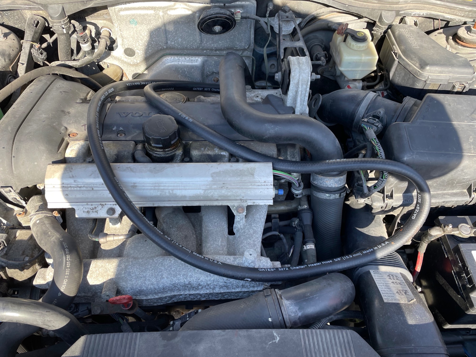

Also, I ended up using silicon heater hoses. The OEM hoses I ordered turned out to be URO! Returned them and went on a frantic search when I came across a hose shop just south of me that services farm machinery. They sold me blue silicon hoses for $4 per foot. I used these along with the original metal ends from the old hose.
Anyway, in the end I ended up with a better setup. I should be good for a long time.
