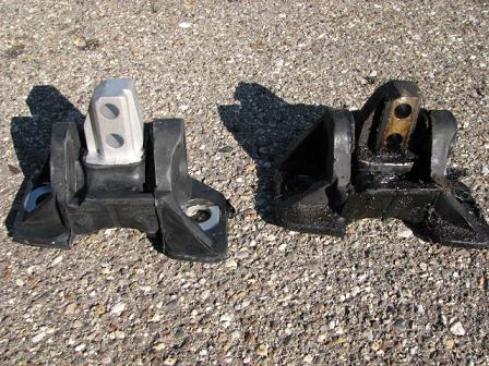

Yes, and like I said, I know I have a bad spring seat/strut mount. But the lower right engine mount colapses on itself. It won't matter at what speed, there will be metal to metal contact over bumps of any degree.
I have added enlarged images .
Once again, Good luck.
- Metal to metal contact can be seen underneath.
- lower right mount underside.jpg (59.13 KiB) Viewed 819 times
- The old mount on the right is colapsed and visibly shorter.
- engine side lower right mount.jpg (62.56 KiB) Viewed 819 times

Is that an OE Volvo mount? It looks real close where as mine from FCP looked so different that until it was installed it didn't look even close.Ben850 wrote:Yes, and like I said, I know I have a bad spring seat/strut mount. But the lower right engine mount colapses on itself. It won't matter at what speed, there will be metal to metal contact over bumps of any degree.
EDIT:
WOW, Perfect description for a totally collapsed engine mount!azv70 wrote:At low speeds it hammers. It gets worse till 25+ and then goes away.

I think I got that from IPD last summer. I don't recall if it was OEM, but it was designated for a '93 850 and looks to be an exact duplicate. I've seen them look different, but I was pleased to see the part I recieved looked the same.
