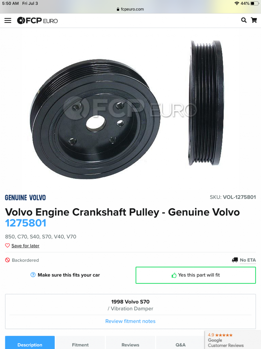

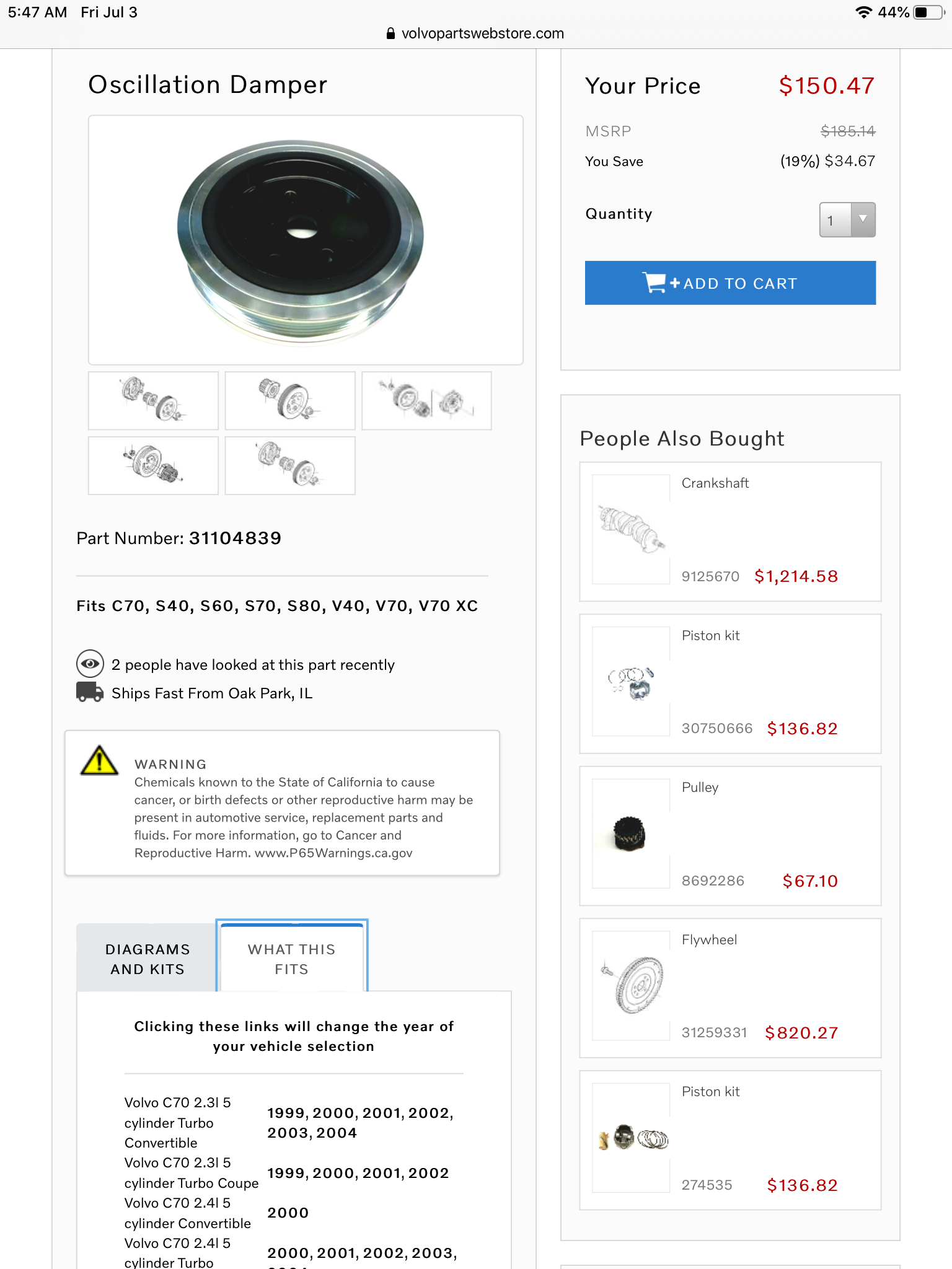

31104839 Is 1999 2000 only at FCP, BUT volvo we store says it is basically a P2 part
I think your 1999 must have the earlier -1998 part
1275801 harmonicdamper -1998

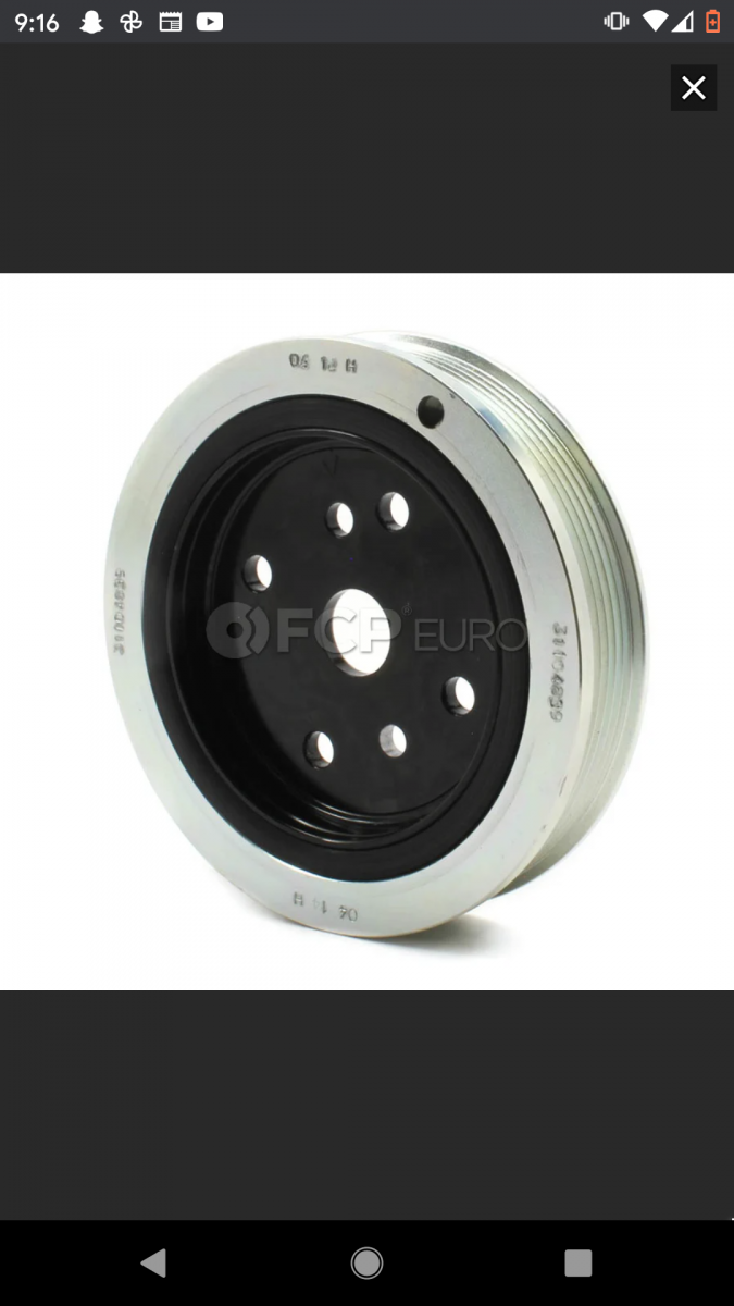

The index hole looks right in that one.

That would make sense that I have the 98 part here since I don't have variable valve timing and other things that people say should be on my 99. The thing is FCP also has the Volvo blue box part (VOL-31104839) which seems to have both centered and offset alignment holes, where the Corteco only had the offset hole. When I called my Volvo parts department they noted that the original part had be replaced by a new one, so it all adds up. Hoping they send the replacement asap. Thanks for the investigation as always!
