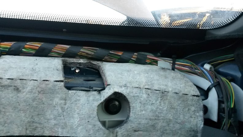

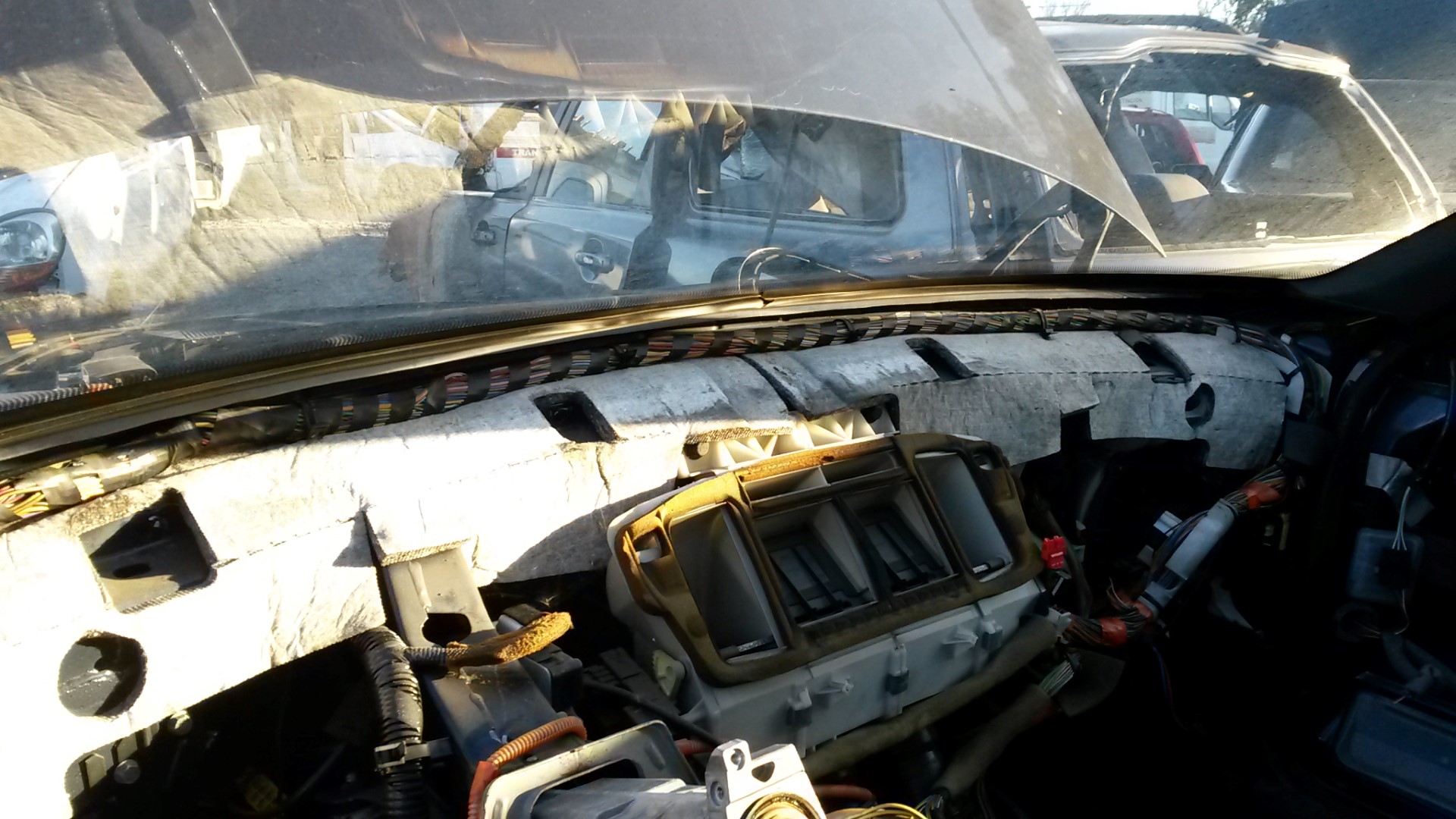

This seems a very interesting way to solve those horrible rattles. I started to suffer them a couple of months ago, but they have grown very fast and I´m fed up. 850 R´s hard ride doesn´t help, of course.csbrianp wrote:I know that elsewhere on this site is the correct way to fix our rattling dashboards, but for most of us that's a big job that takes many hours. Here's another way to fix the squeaks.
(I have pictures but don't know how to load on this site.)
Open hood and remove the 5 torx bolts holding down the cowl cover. Remove the windshield wipers. Lift out the plastic cowl cover.
After removing the cowl now would be a good time to replace that cabin filter located on the passenger side.
I´m planning to make a pair of holes in the firewall and screw two bolts in the noisy passenger side , just like csbrianp says. Yesterday I was in the junkyard and I notice there was a 850 with the dashboard removed. I took some pictures, and I saw that the holes where the stock bolts go are rather long (8 centimeters- 3.15 inches). I saw, too, that perhaps it would be safer (in order to avoid the wiring harness) to dig about 3 centimeters- 1.18 inches to the right, at the same height of the stock bolt.
Does anybody have a dashboard picture, right where the dash mounts are? I wouldn´t be very happy if a made a 8 centimeters hole in a wrong place, or if I screw a bolt in a weak place and the plastic shattered.
Thanks!
(Sorry for my crappy English)
