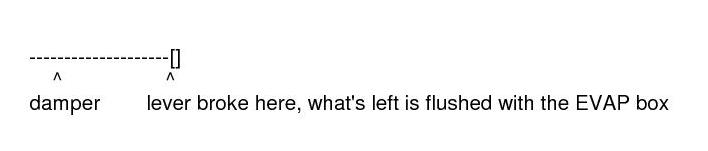

Dang it! I was hoping that the damper shaft can be removed from outside the EVAP box
I'll definitely hit the yards to pull a EVAP box to see the inner workings and see if I can ghetto rig something up in the time being.
So, since the lever is broken off the damper arm outside the box, perhaps I can put in a self-tapping screw with threadlock, then remove the glovebox liner and manually turn the damper with the screw during each change of the seasons?
my poor attempt at a diagram:
- damper.JPG (8.88 KiB) Viewed 3479 times

It sounds like it is worth a try, as brittle as the plastic gets I think I would drill a pilot hole even with the self tapping screw. At this point I don't think you have anything to lose.
