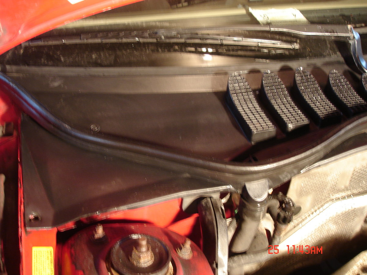

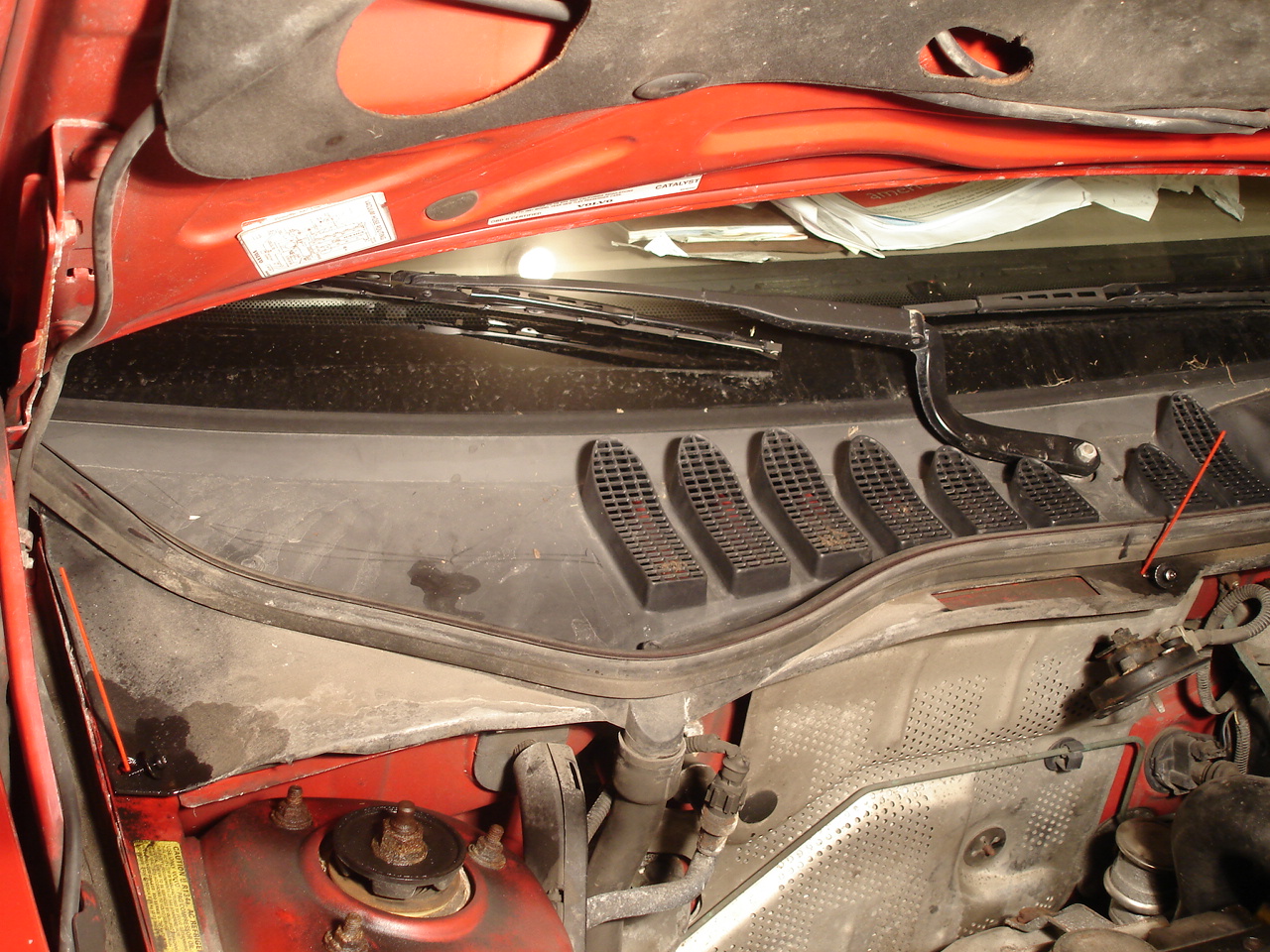

Actually, the filter loads from under the hood and is pretty easy to access.
Pull a couple of torx screws from the plastic shroud under the wipers and have a look.
Passenger side. You don't have to pull the whole panel, just lift it up.

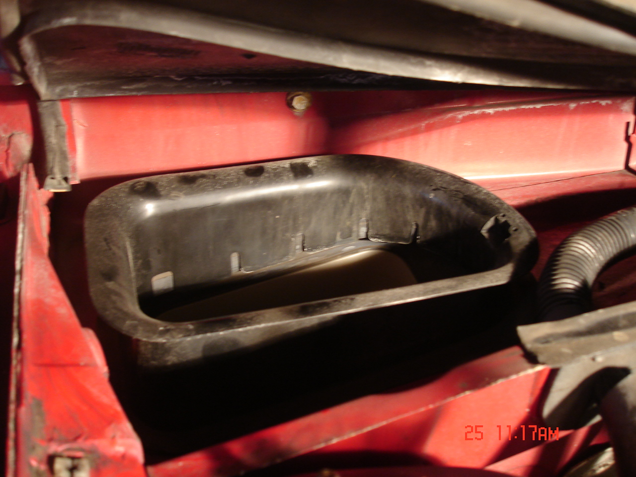

Finally got around to checking if I won the lottery with regard to a cabin air filter. No luck.
I see the insert at FCP Groton. There are several air filter inserts of different quality and cost.
Any other sources recommended by the group?
There are three cabin air filters available at FCP Groton. The carbon is $14, Then there's a $11 and $23.
I don't see much of a difference in the non-carbon filters. Is the $23 OEM?
Someone also mentioned in another thread that some filters don't fit in the insert properly.
Any experience with filters that don't fit is welcome.
Easy to get to.
Volvo just forgot to install my retainer and cabin air filter.
The retainer is just one screw to install? Hopefully the hole exists and the install is as
trivial as it sounds.

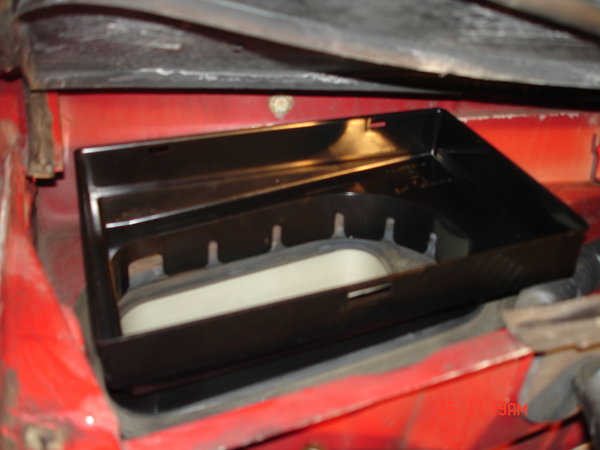

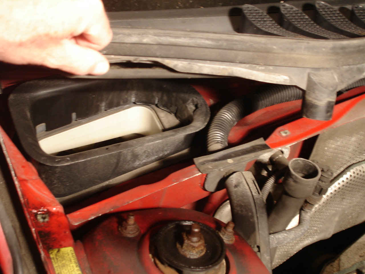

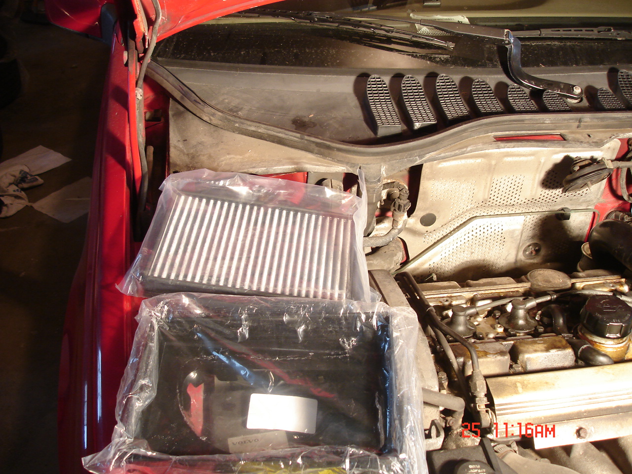

I received my cabin air filter retainer and carbon filter so I thought I'd finish out the
thread. This follows the other photos I uploaded earlier.
Just lift the rain diverter...
Insert retainer
Insert filter...snaps into place...
Replace two screws...I felt guilty and did some cleaning...
