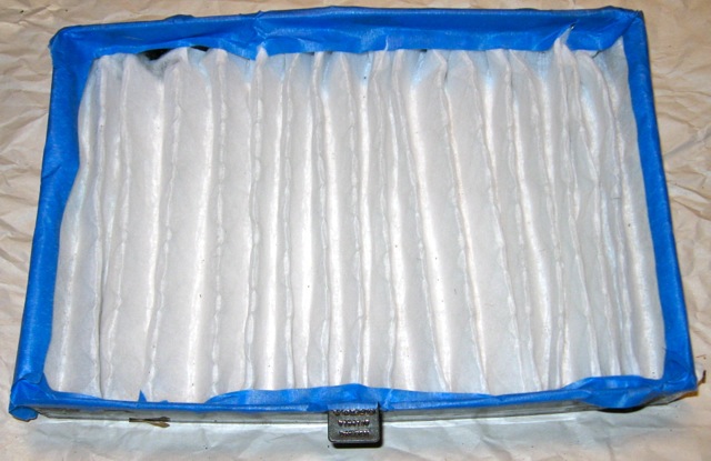

You can remove the old filter media from a cabin filter. I strung some fine gauge copper wire through the frame to help support the filter media, but I don't know if it's necessary. You can probably skip it. Then get a big household HVAC filter:

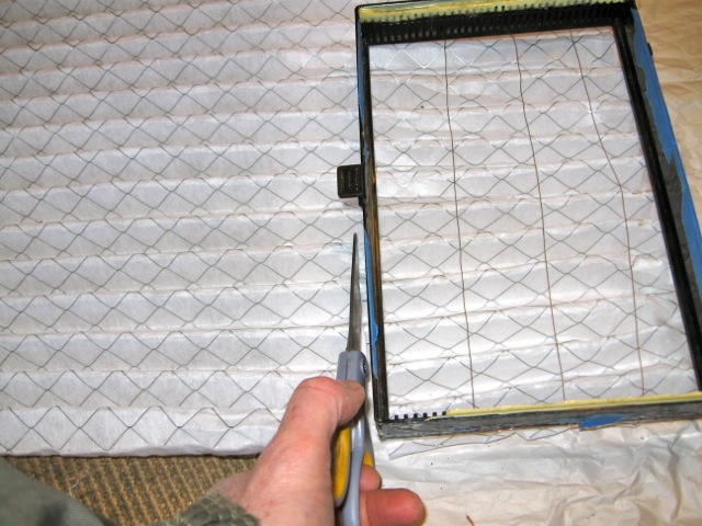

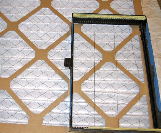

Strip off all the cardboard and then cut the filter to the width of the filter frame. Use the wire pattern to keep your cut straight:

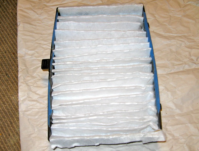

Fold up the media and place it inside the frame with the wire side down. I wrap the ends of the filter over the edge of the frame to make a good seal:
Wrap the edges with tape to hold the media in place and reduce leaks around the edge:
Reinstall the filter in the box. The frame has clips that fit into the box and hold it in place:
This could help save some money over time. I've been doing it for about 5 years, replacing the filter about every six months and it works well. Good luck!
