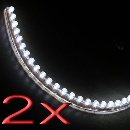

Step 1. order and receive your LED strips.
essentially this is what you are looking for.
2x 24 LED strip white

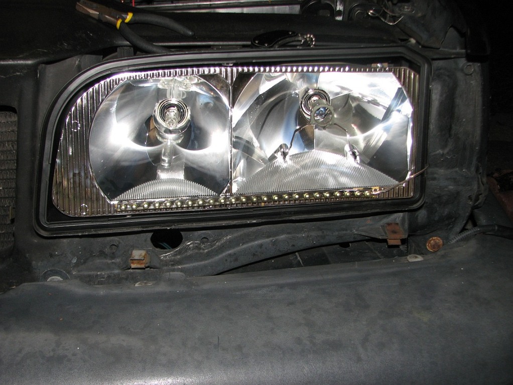

now that your lenses is off,

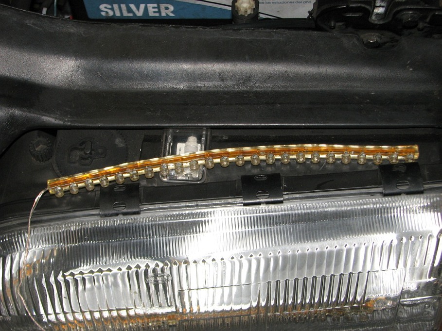

Take the red film side of the tape off, relieving the sticky side, carefully place on the bottom part of your headlights as shown below. *this is recommended but you can really put them where ever you want*
I centered mine and made it flush with the inwards shelf of the headlights.
lights
lights
Step five.
Now that you have it on, its almost done.
notice how the cord goes, there should be a small piece that dips down, simply allow the cord enough slack so when you put your lenses back on tight it doesn't pull the lights off, and ensure it goes thru.
from here you can go ahead and put your lenses back on if you want, if not its fine just make sure you do it when you get done with the rest of the steps.

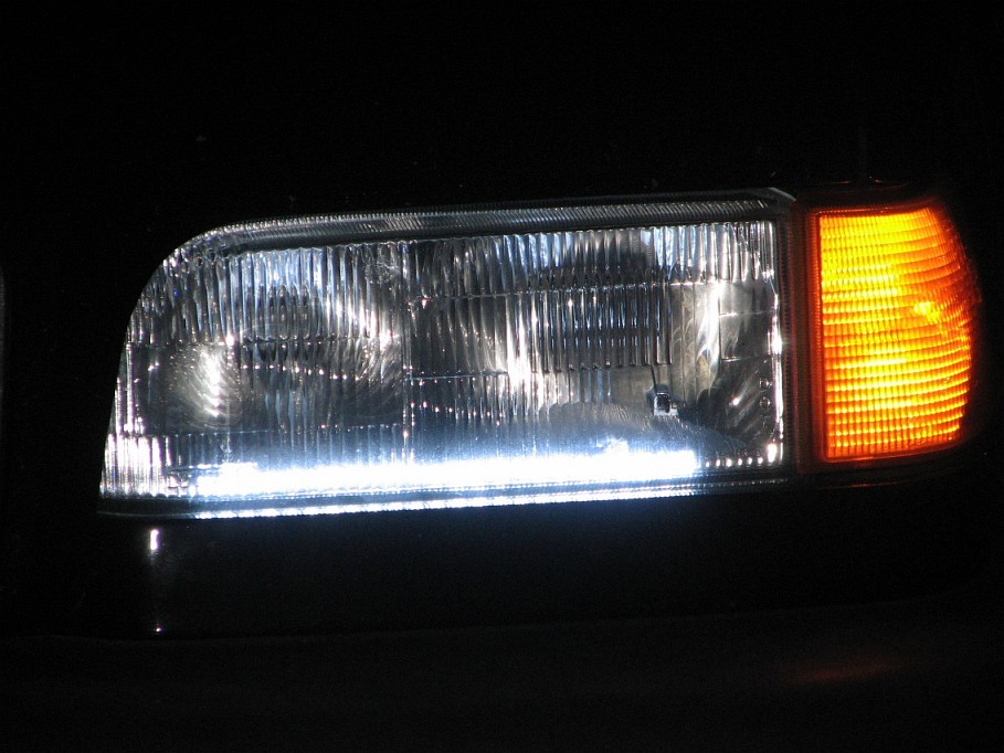

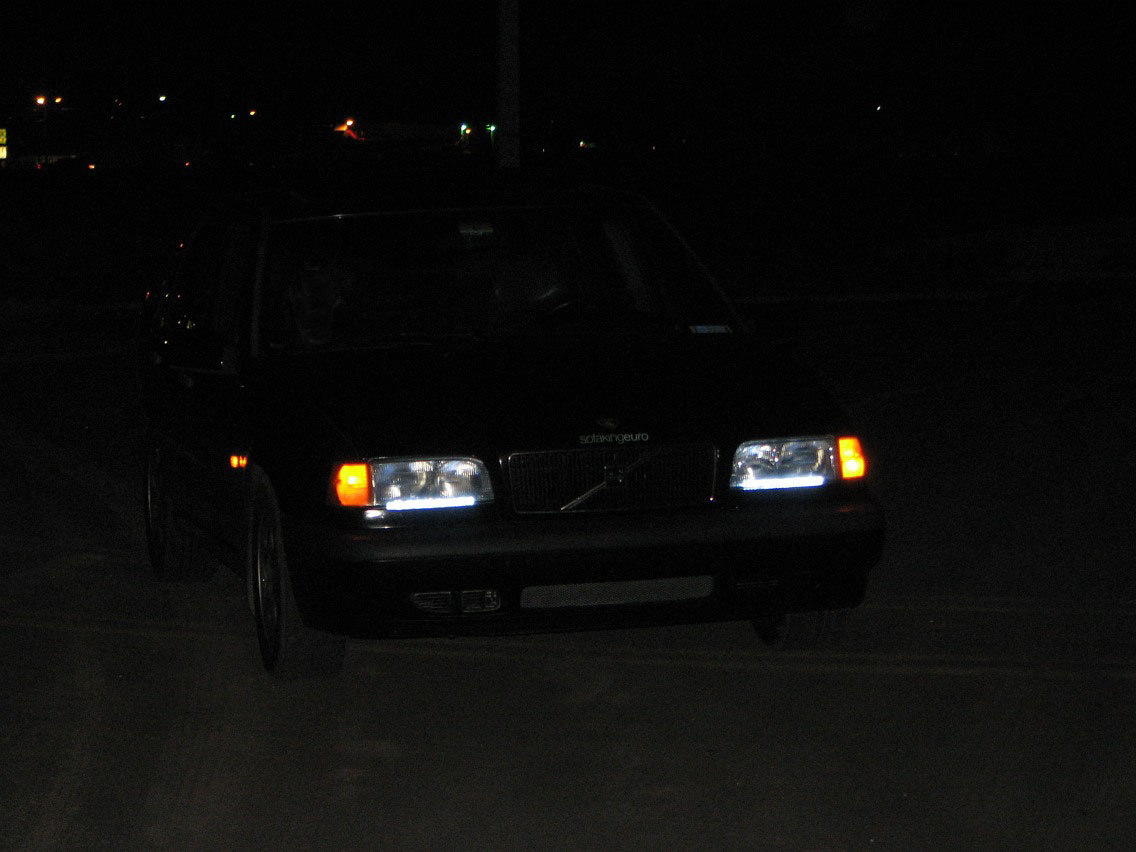

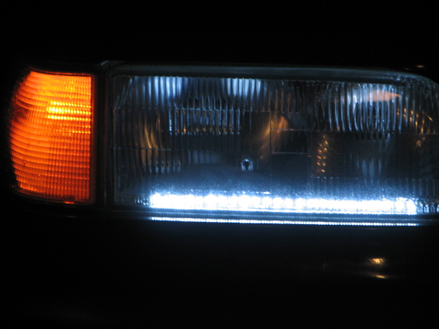

Here are some photos of what the finished product looks like.

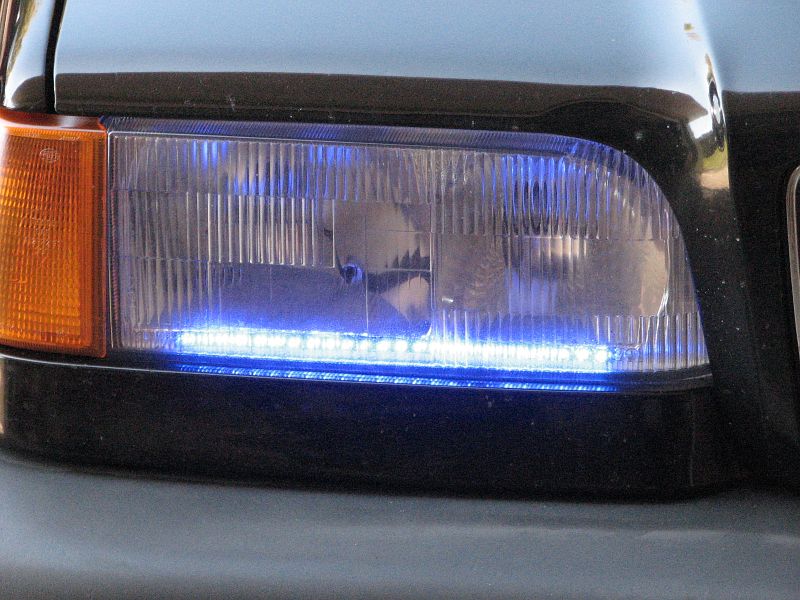

I have some in blue aswell, I decided to swap to the white, since blue is illegal.
Photos.

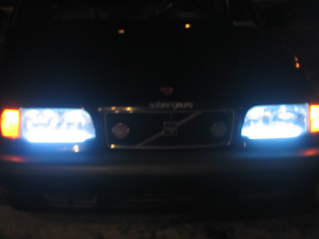

these are back when I had blue..
those you could use for driving lights because they were that bright.

it looks ALOT better in person, but my camera cannot capture those lights. its either full on brightness or close up. going to see if someone with a better camera can get a few photos so I can really show you guys what they look like.
